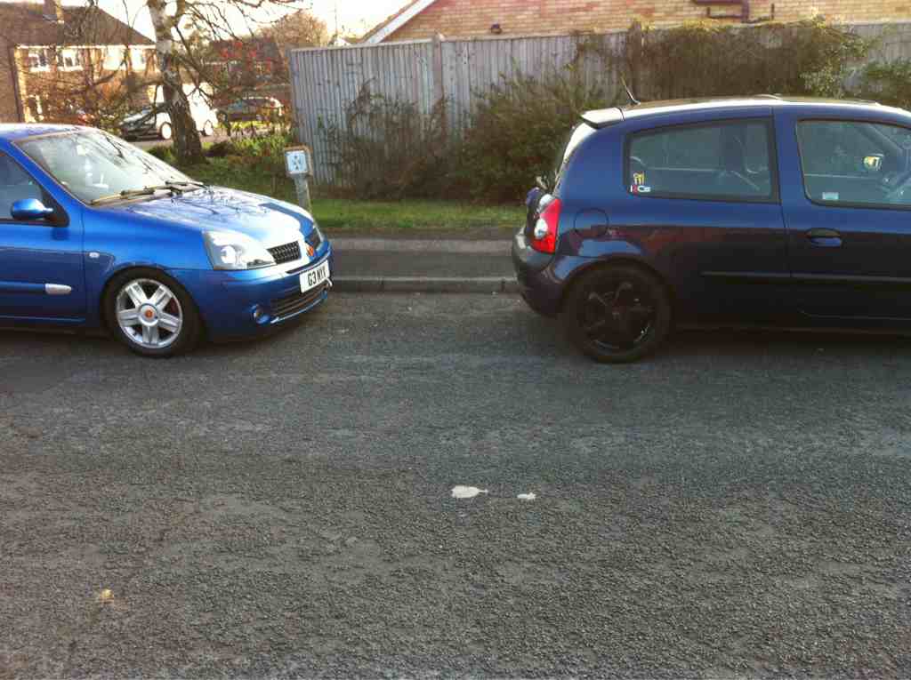

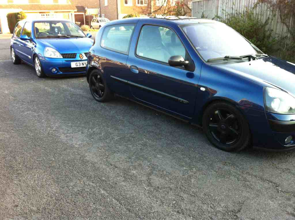

My rear is higher than my front.
But for example this ^^
Mine is just about practical, I can't go In some car parks as ramps are too steep. And I can't park on some curbs. I'm only 60mm
I can drive my car, Adam can't :p
But I can't really talk as I'm getting coilovers too. Haha
Knuckles
ClioSport Admin
what kind of ridiculous car parks do you have down there? the only time ive not been able to get into car parks was when i first got the coilovers on, i wound them down too much (by accident) and scraped on the camber of the road lol!
still, after i got it sorted my car was lower than yours and i could still drive everywhere haha
the trick to getting on curbs is to get parallel and whack full lock on :p
The car park I park in for work has a massive dip!
And one of the multi story car parks is silly steep. But apart from that it's fine.
An there's a curb at my house which my exhaust ect catches on. Te rests fine :p
But I'm not going as low as Adam! Haha.

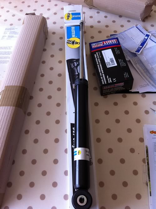

I've ordered some Bilstein B4 shocks for the rears, a low entry trolly jack and some latex
(gloves)

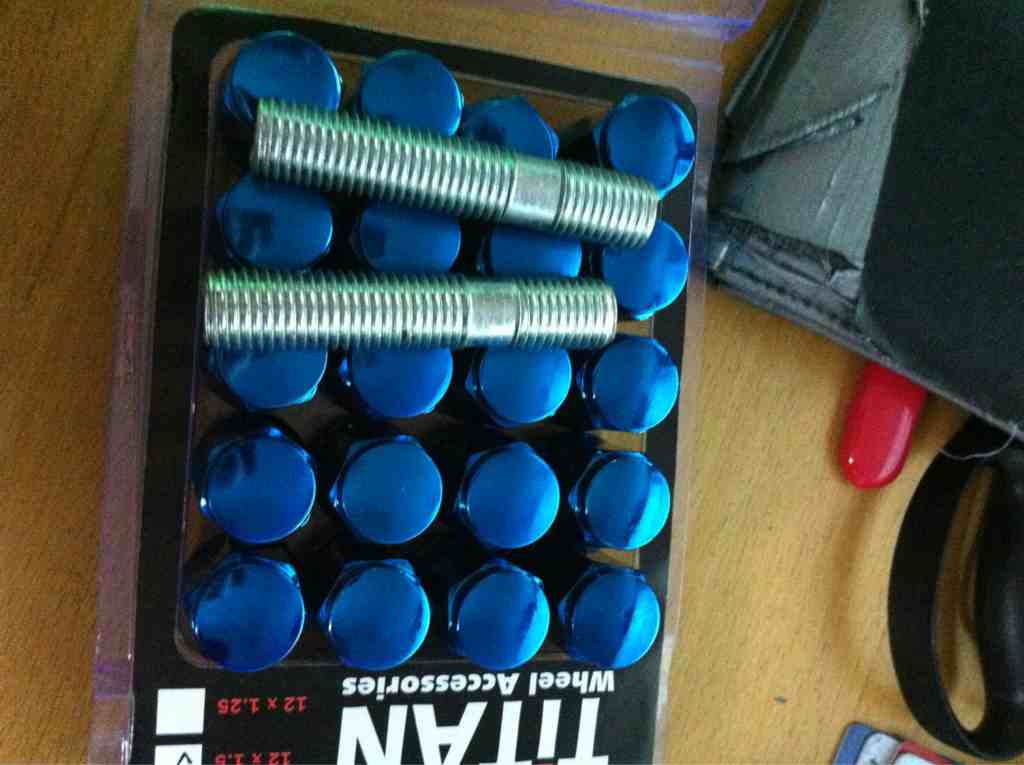

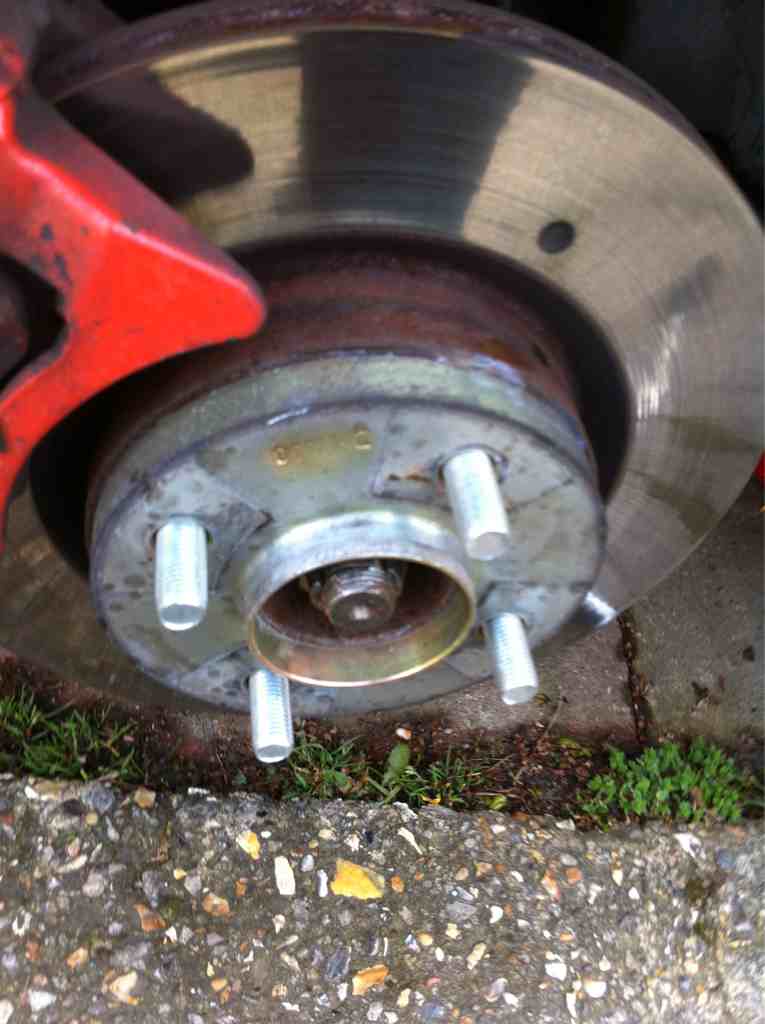

Where did you get your spacers from, I need to acquire some for mine :)
  Toyota MR2 GT Turbo
Anymore progress mate?
Yup!

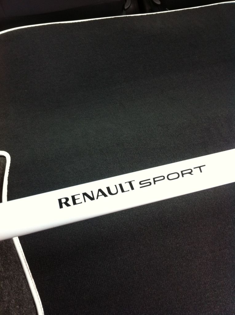

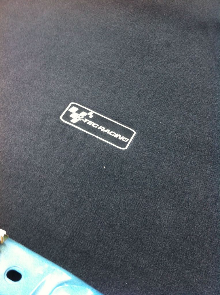

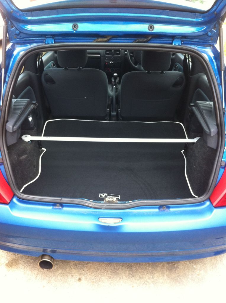

Homemade Renaultsport strut brace and K-tec boot mat!

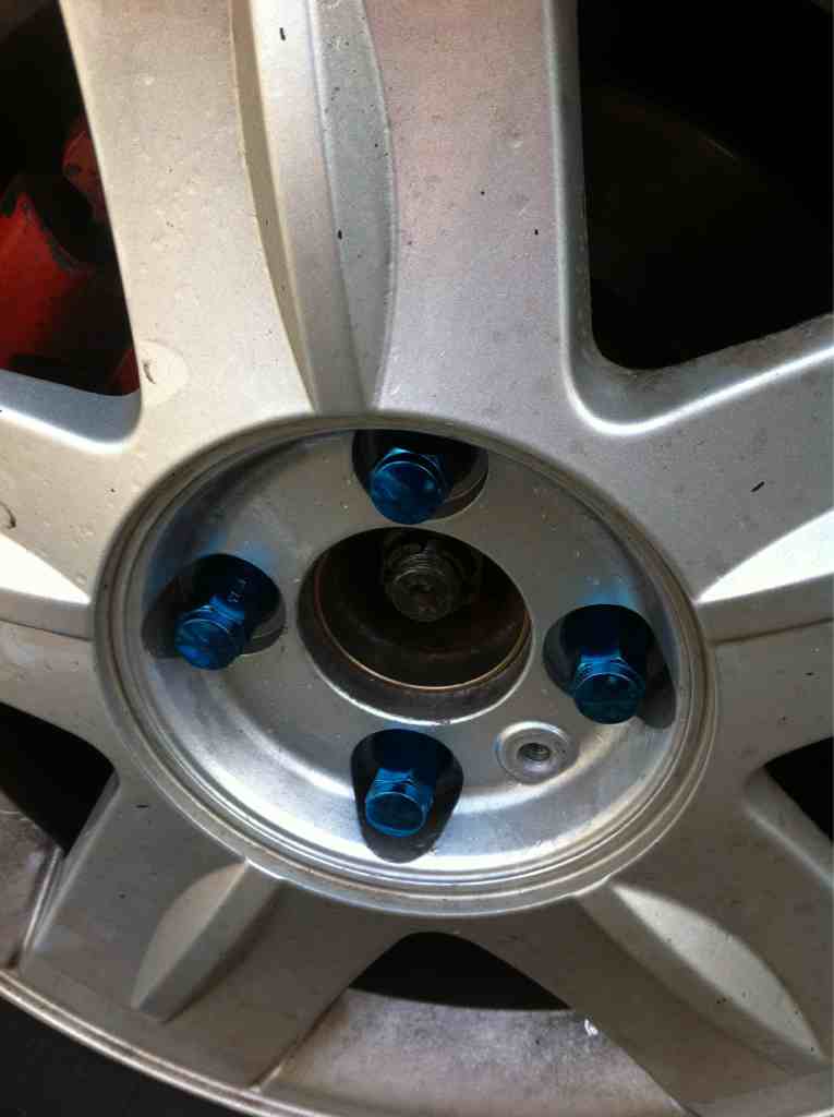

I got my spacers off a company called 'Essex Stlying' lol, they were £120 and the rears don't fit properly!
I'm going to be getting some eibach ones soon.
  Toyota MR2 GT Turbo

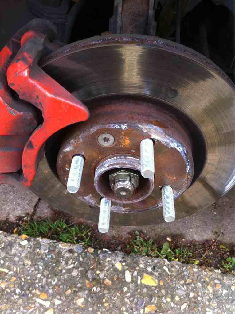

Sorted out my spacers! For the rears you have to take the cap off the bearing, put the spacer on and then glue the cap to the spacer!
Works a treat now!

I stopped the strut brace from knocking, just put a piece of microfibre between the rubber mount and the brace.
