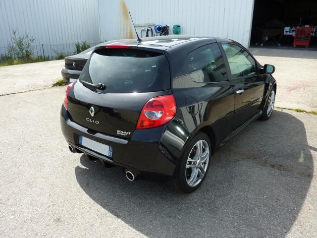

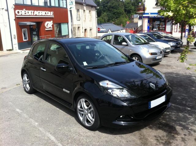

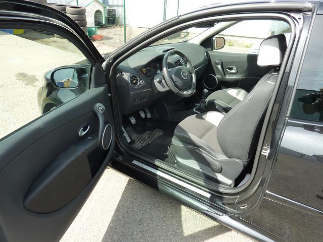

Here is some pics of my ride before starting working on it :

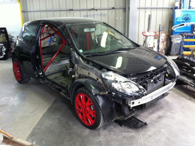

And now, after one mounth of hard working, 7 days a week, and above all... Alone !!!!

Yes, the first days of work were very hard lol but after few hours of work, I was no longer disturbed about what I was doing
