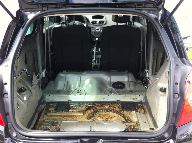

05/24/11 - 16h30 : Let's begin !!!

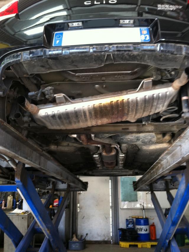

Lucky that I took time to weight the car before to start working on it !

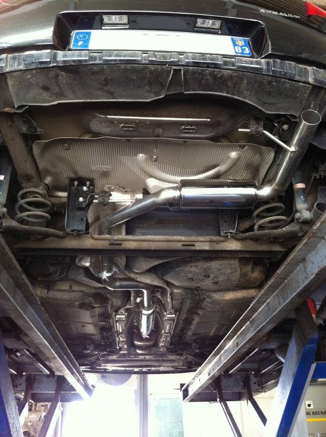

The following day, I was installing my Inoxline exhaust !

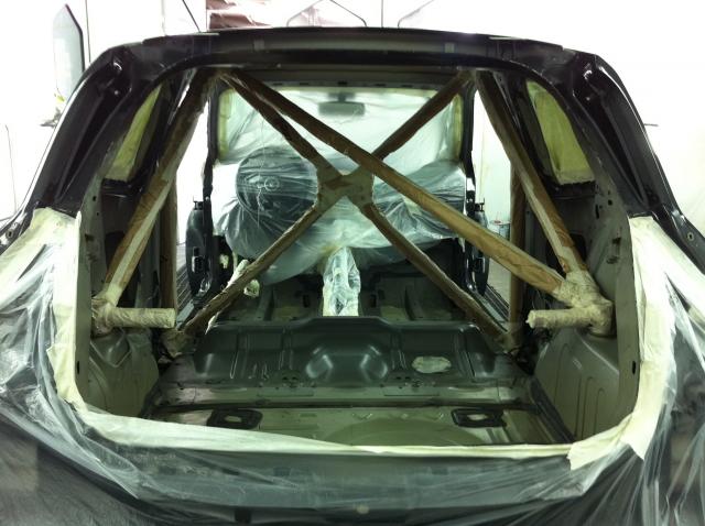

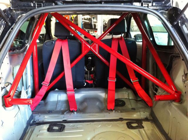

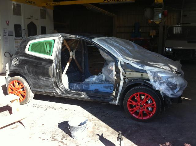

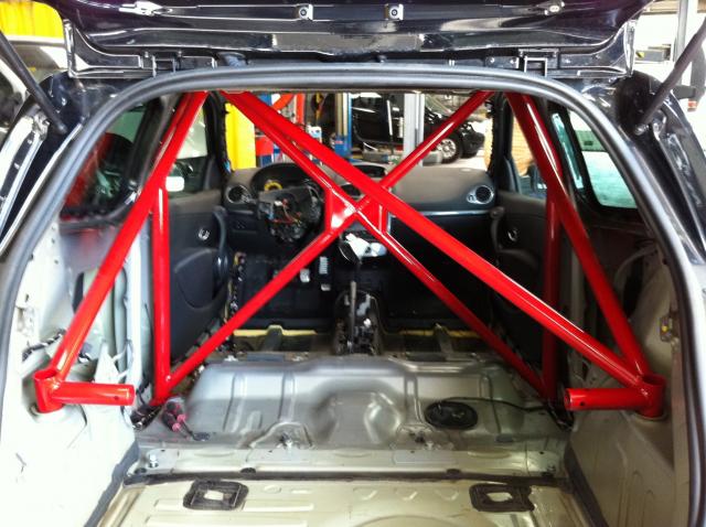

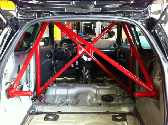

Painting and installation of the modified cup roll cage.

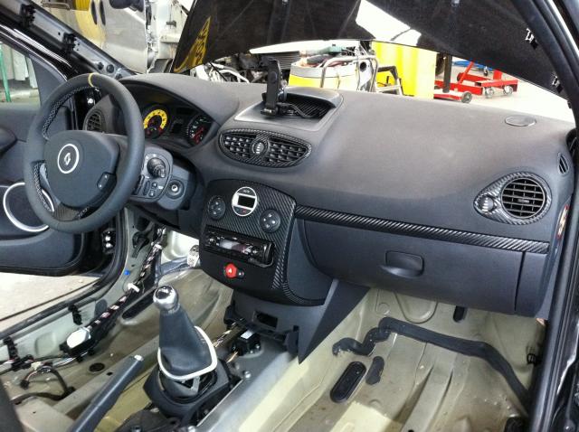

Let's continue the emptying !
Installation of harness with the Renault seats.

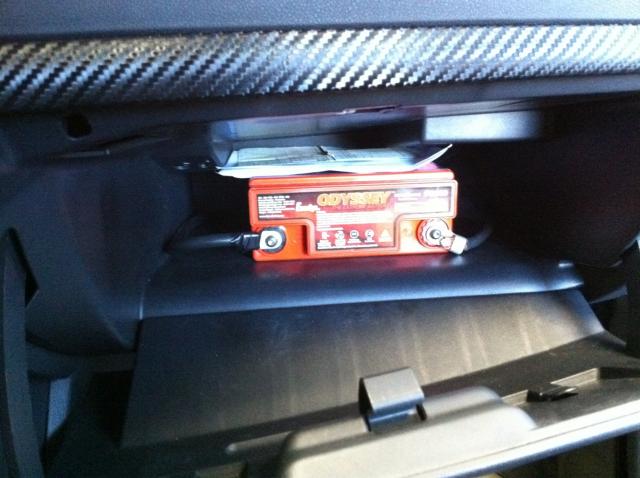

Installation of the lightweight battery…...

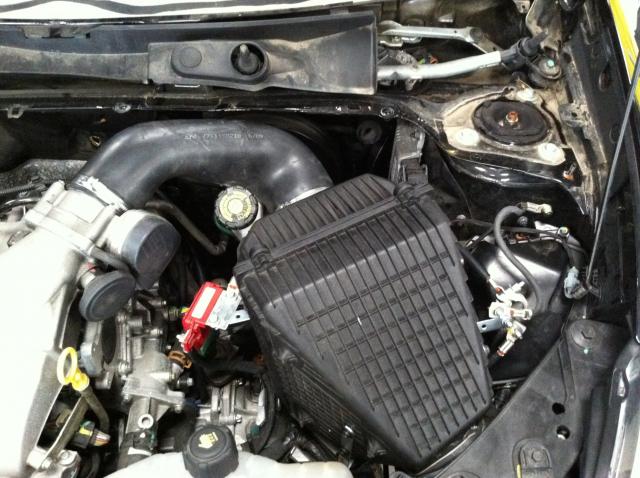

Installation of the Clio V6 / Cup air box

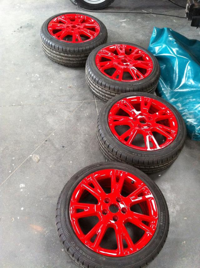

Painting of Clio Cup wheels !

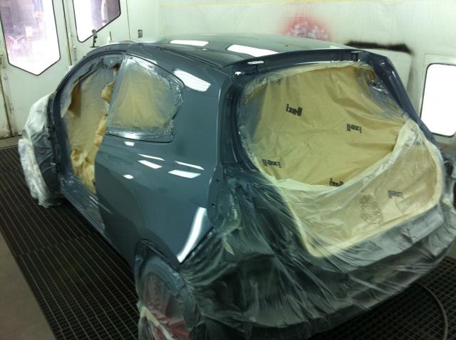

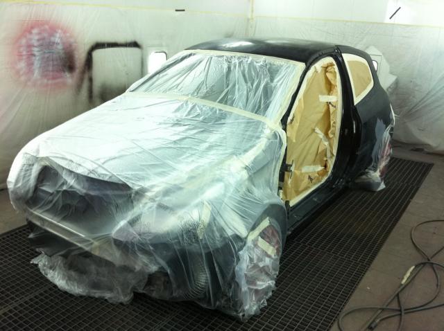

So now… Let's spay the car !!!

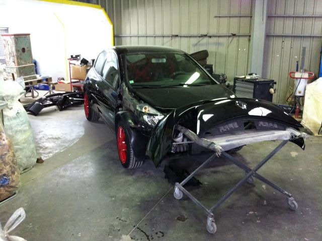

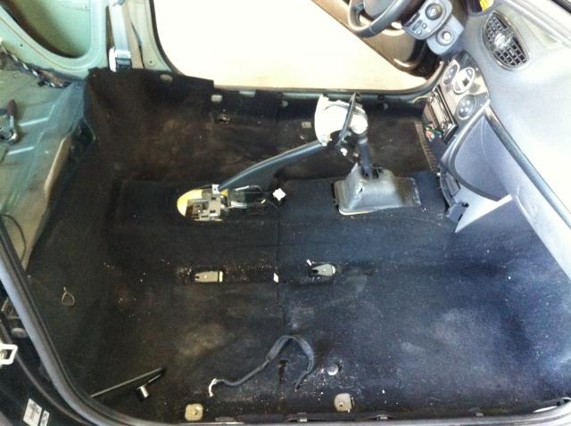

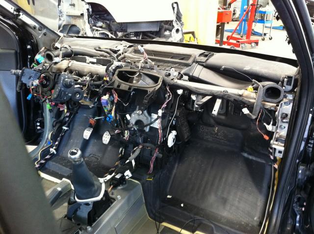

Beginning of the total dismantling of the car !

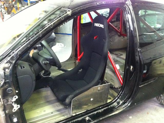

Let's install the new seats !

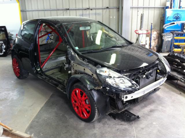

After dismantling...

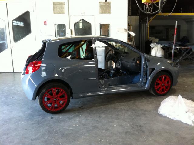

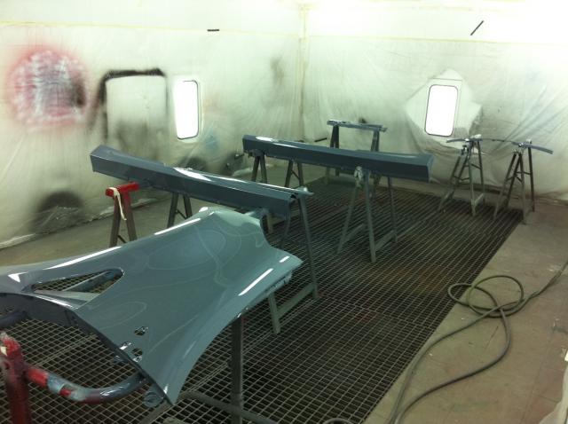

Let's spray first parts.

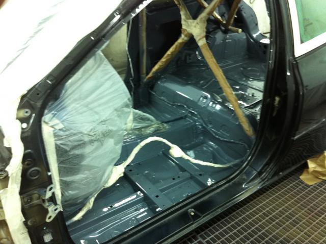

The worst step of the job…!

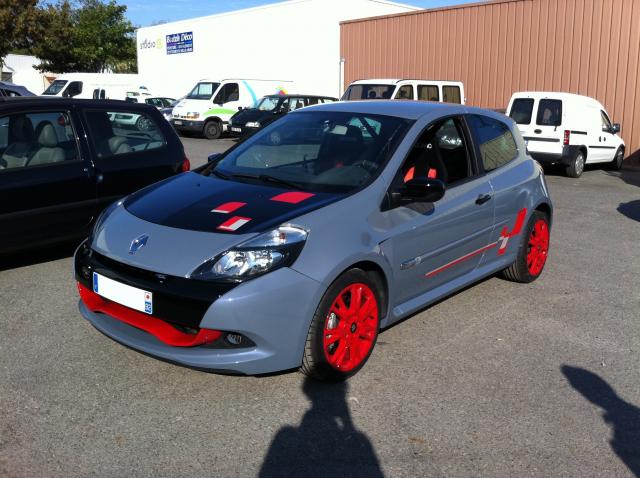

Last step, spray the car !

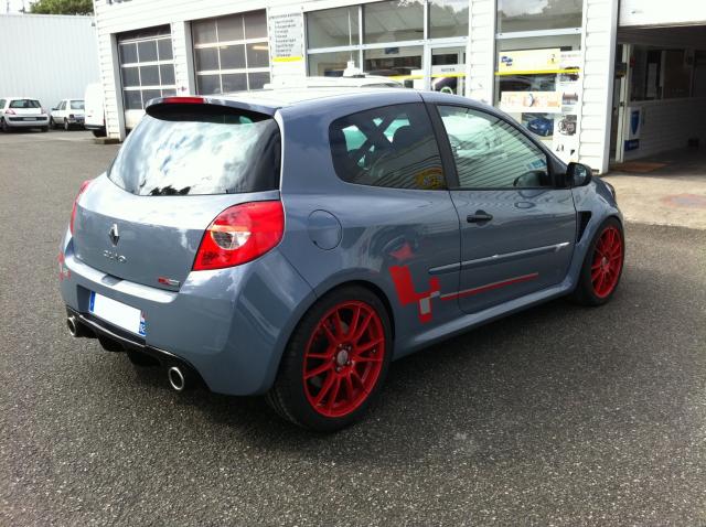

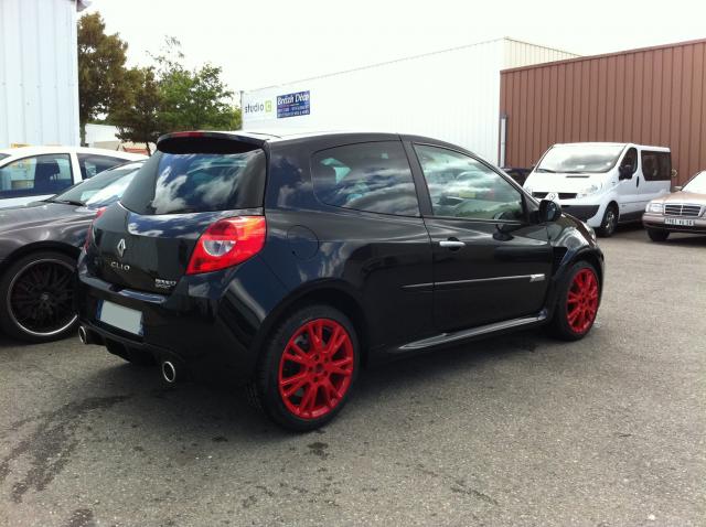

And finally…
Let's apply makeup !!
