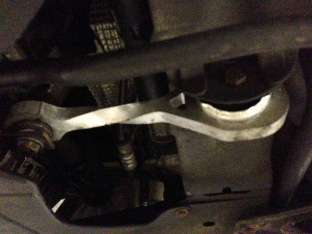

Upper engine, upper gearbox, and the stabilisation 'dog bone' mount.
The dogbone takes a lot of the flack so people stiffen up by updating that.

Dogbone doesn't make it harsher ime, just more controlled.

Make sure you go poweflex on the dogbone mount Kev, it's the only one worth doing IMO. I'd go with a full set of stiff mounts if it were purely a weekend/track car, as vibrations and the like don't matter, but not for you.

Understand your not wanting to make it harsh, when you fit the dogbone mount you may get a little more vibration coming through on idle, but after about 300 miles it settles down and you can't tell it's fitted.
Difference is when (more like if with you) you're hooning it around some lanes, the GB won't be rocking all over the place knocking on anything in site.

Dogbone? It's new anyway...
Excellent. One less thing. Didn't think there was much movement.

Its well worth polybushing the dogbone, makes the change that little better, i had slight vibration for about a week before it went or i stopped noticing..
