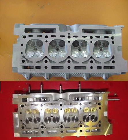

it was done almost two years ago by my mate anthony who works with a le mans gt team now but at the time he was just finishing his university degree we done on the road mapping over a weekend of playing around. i've had a TD04 turbo sat in my garage for as long as i've had the map, i'm waiting untill the engines a bit older closer to 100k miles before i justify myself spending more money on forged internals, TD04 install and a frankenstein with the 1.4 tce head (although i have not looked at both to see if this is possible, although i'd assume it would work in theory) always had a keen interest in having fun with smaller turbocharged engines

1.4 TCE 130 head will be a mega challenge, maby better just flowing the standard head better, I know it has VVT so management would be an issue unless you locked it out.

this is true but it would be an easy enough object to get around. already discussed it with cat cams in regards to having the GT cams made, to keep it basic they said when i'm ready with the cylinder head and all just to send it too them and they'll develop the cams for me (at a price) and also have agreed to do a set of stage 2 GT cams once i track down a cylinder head so that's an equally good option as the first cylinder head for the standard GT was cracked so i sent it back and none have became available since and as we know realistically martin this would also require aftermarket management to be able to properly handle the mapping requirements. i'm certainly not out to become a deathknell towards twingo rs owners, it's actually more to satisfy my curiosity. currently i've just ordered the honda jazz mugen spoiler so that i can extend / shorten and modify it to take the shape of the twingo's boot lid. as you can see, i don't like being told stuff can't be done with a bit of old school determination anything can fit anything. i just bloody hope it looks half decent lol!

Didn't Renault do a fair amount of internal changes to the D4F when they created the Tce from it?
  Twingo Gordini RS133
The casting looks to be different for the exhaust side. Possibly to improve cooling of the Ex side. Could still be interchangeable...
Are the valves the same size.
Is the cam position, valve gear etc the same, to keep the same valve lift ratio
Are the valve spring seats the same height and same springs/caps used
