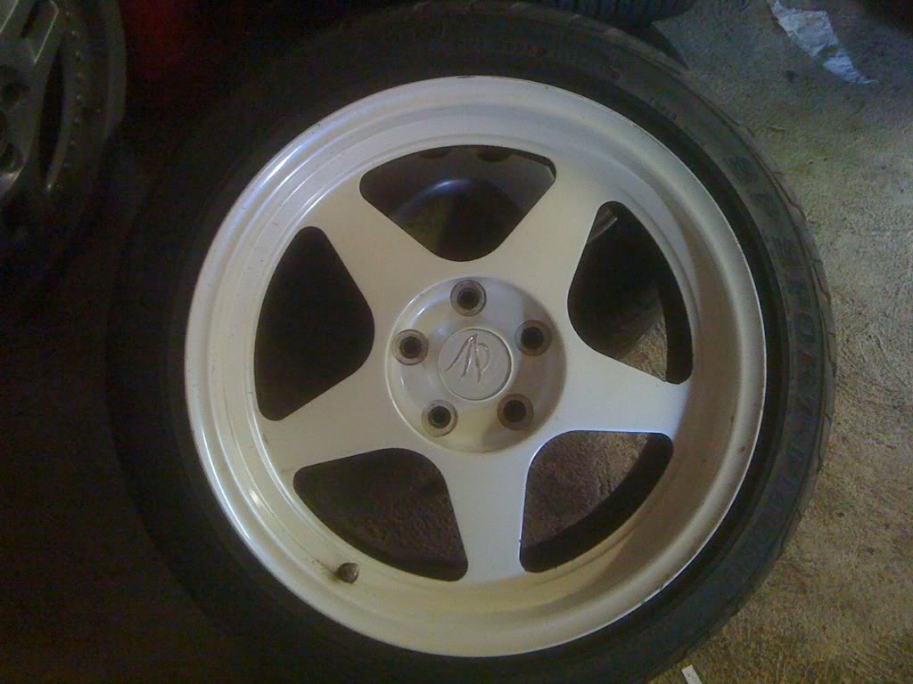

Just paid for these babies, some Regas in 17x10...

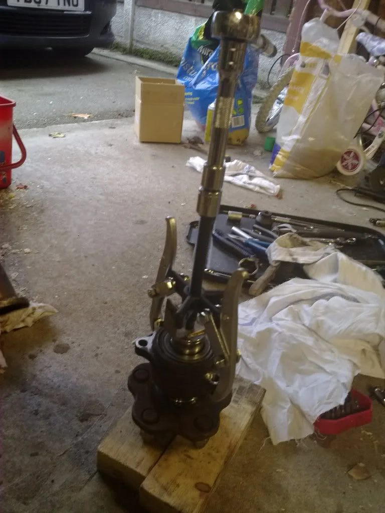

Rear Wheel bearings = What a day!
Snapped 2 1/2" extensions, and broke a 1/2" breaker bar within 5 minutes of owning it (Halfords Pro, when they going gets tough, they break).

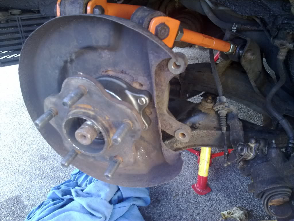

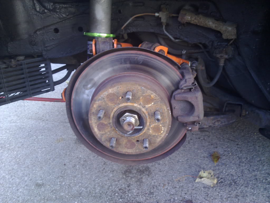

So anyway, N/S/R hub nut is still on and tight. O/S/R freed off no worries, so I cracked on getting that all off...

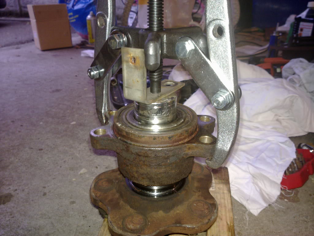

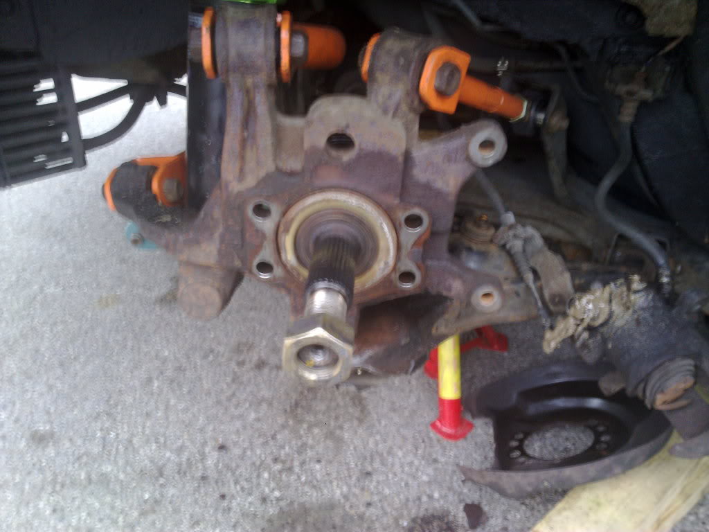

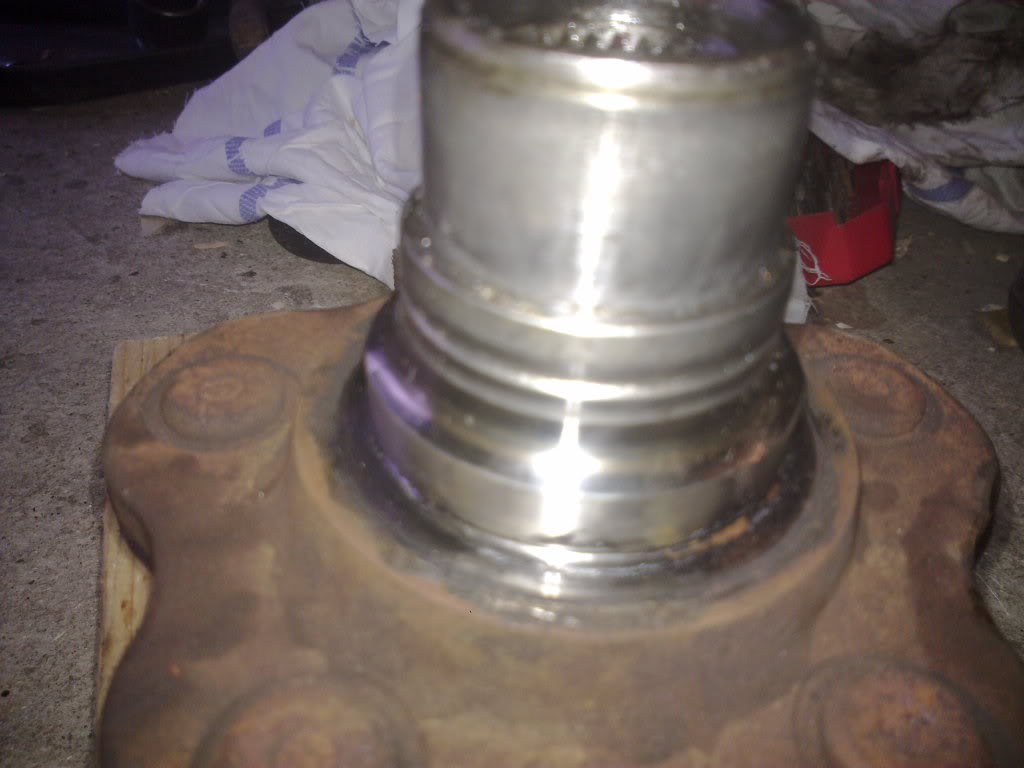

Hub Assembly pulled off driveshaft.

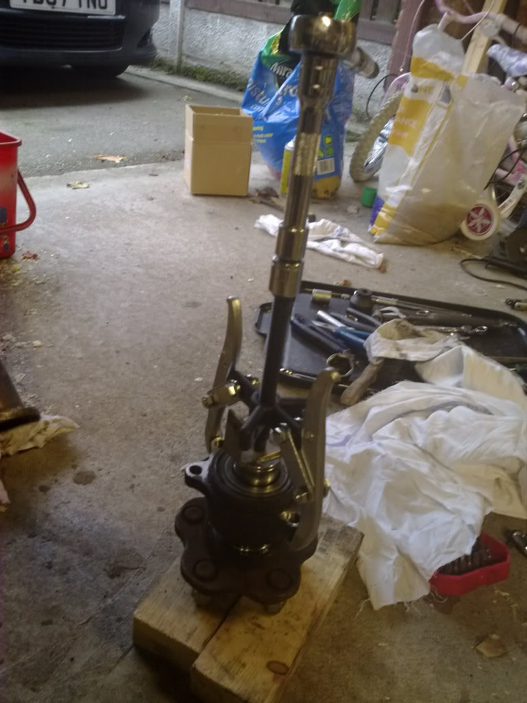

Bearing puller & 32mm socket utilised in a nice controlled (LOL) rig.
Close up of it coming off.

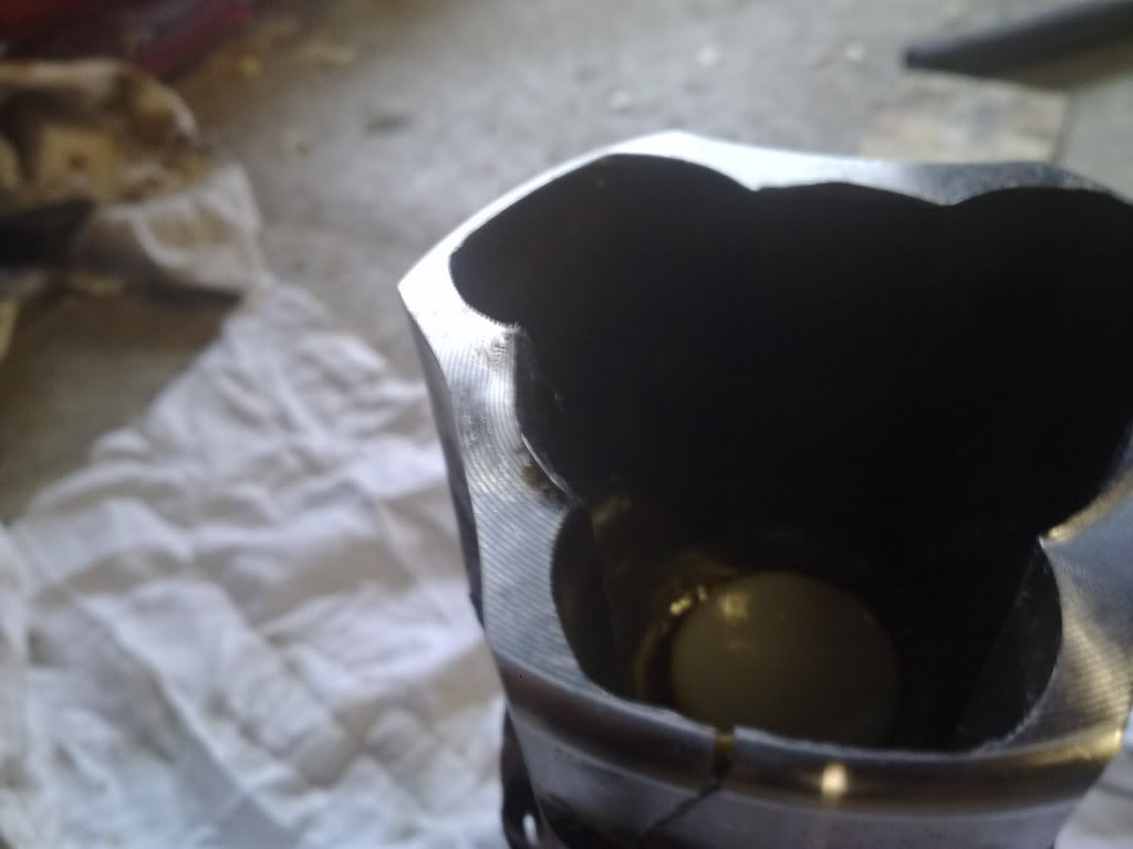

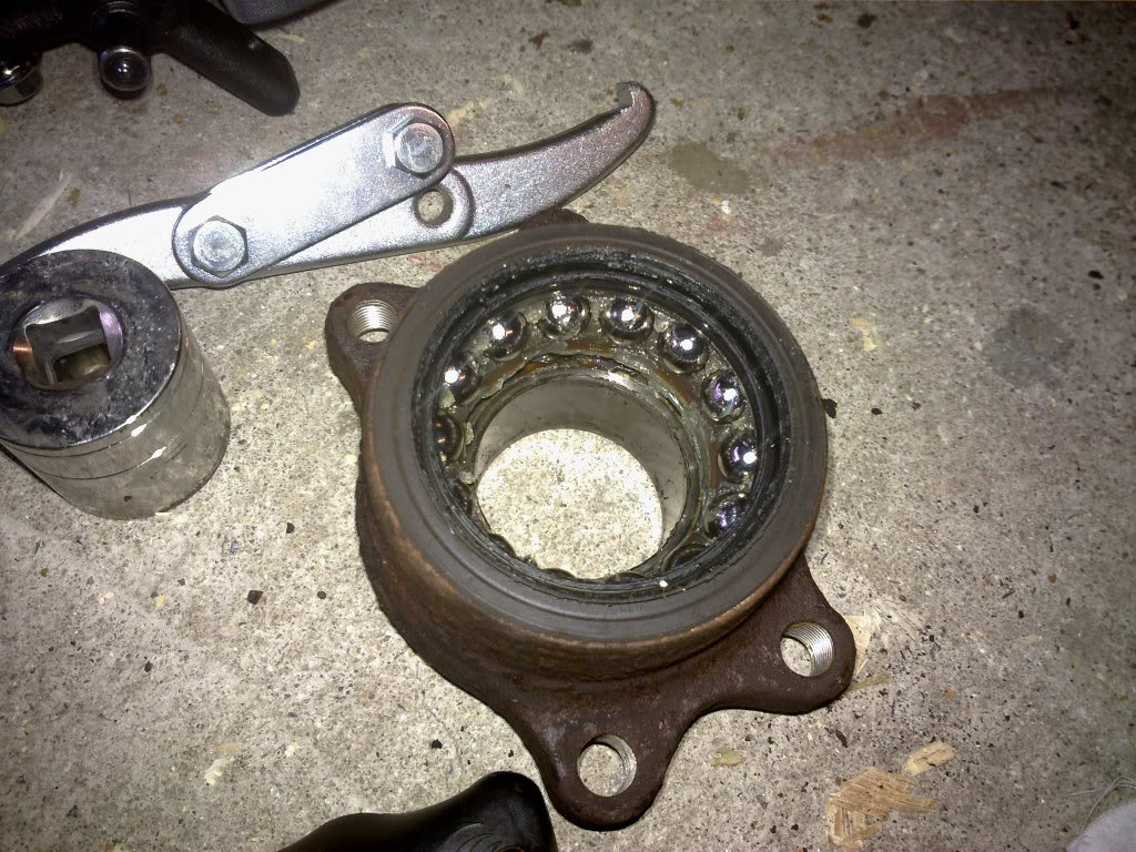

Leaves me with the inner race stuck on, will have to get a garage to pull that off for me.
Exposed balls from the inner race being stuck on.
Hub assembly is down at the local garage waiting to have the inner race removed and the new bearing pressed on. Guy said it might take them 30 minutes, I thought Christ, if I had the right gear I could do it in 5 minutes :rolleyes:

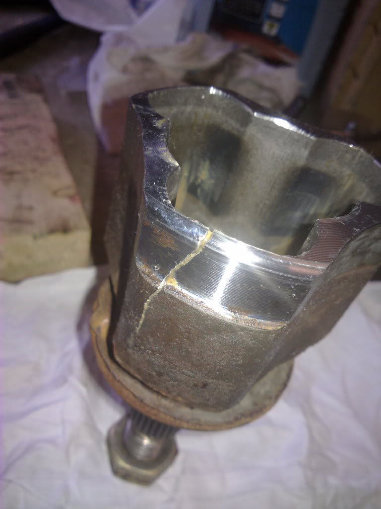

Anyway, started to resecure the CV boot, then as I cleaned it all up I noticed a crack in the outer casing. So driveshaft is off...

Off side fixed. Had a test drive, can't hear any noise from the near side. Going to leave that one for now, and I'll use a windy gun to crack the hub nut off. Easier that way.
New bearing & driveshaft on (yes, the seal on the brake piston is fucked, not massively fussed as they'll get replaced before the MOT)
All built up, torqued up (did that with it on wheels) and split pin on.

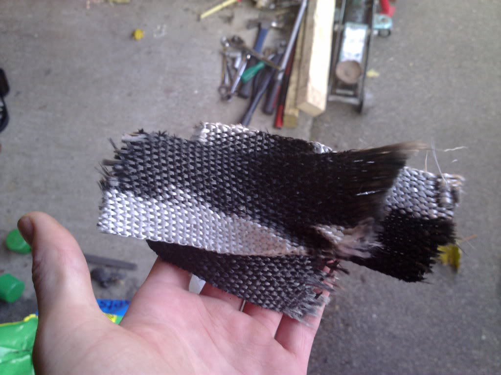

Heatwrap from the downpipe, due to having spent a lot of time going into a friend's estate with speedbumps recently, the exhaust has been catching due to the mount sagging. SO it's torn the heatwrap off. Oh well, not wrapping it again.
