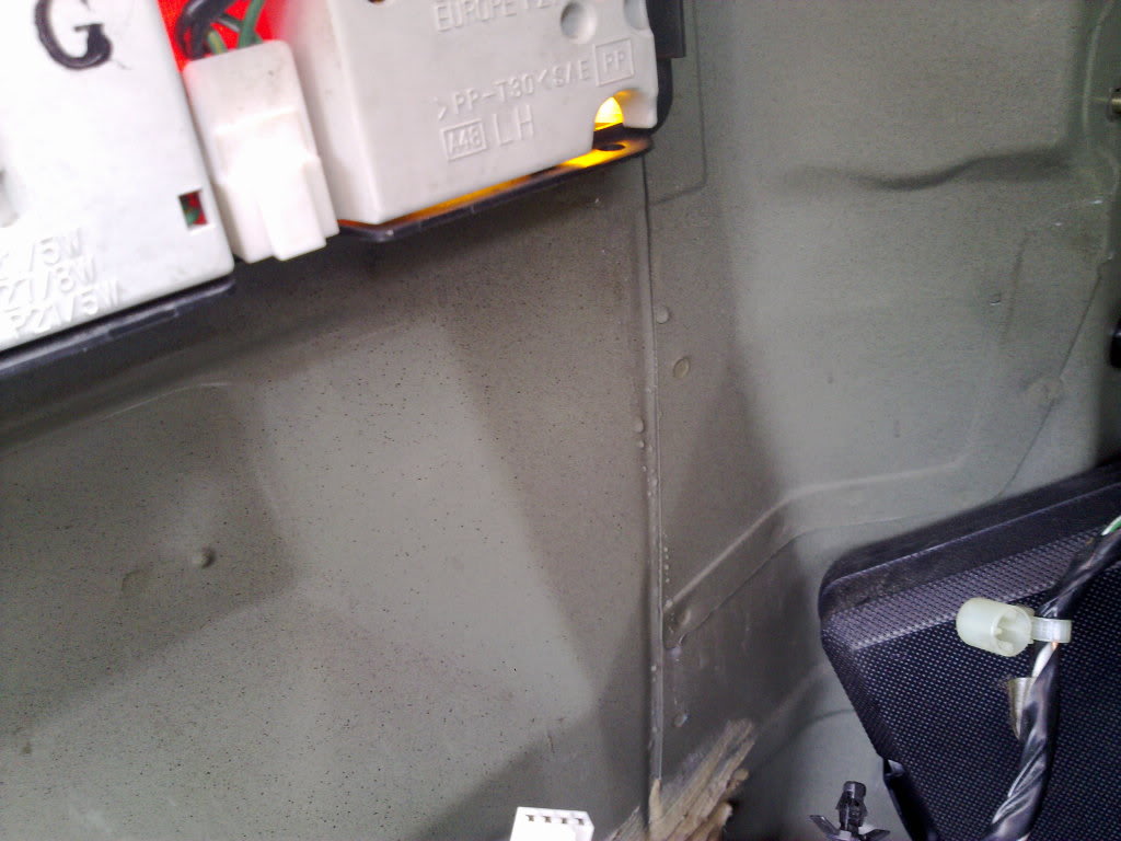

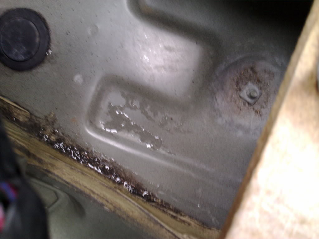

Been having a leaky boot problem (yes, another leak to go with the coolant & exhaust gases). I'd found loose rear lights the other week so nipped them up, checked again today and it was still leaking...
So I thought I'll have a look at the seal. Well, there isn't one, somebody has attempted to bond them in with some horrible flexible black gunk. The same gunk the front end was plastered in to hold the N/S sidelight, which is actually horrendous. So I managed to pull the light out, scrape it off and have siliconed it up.

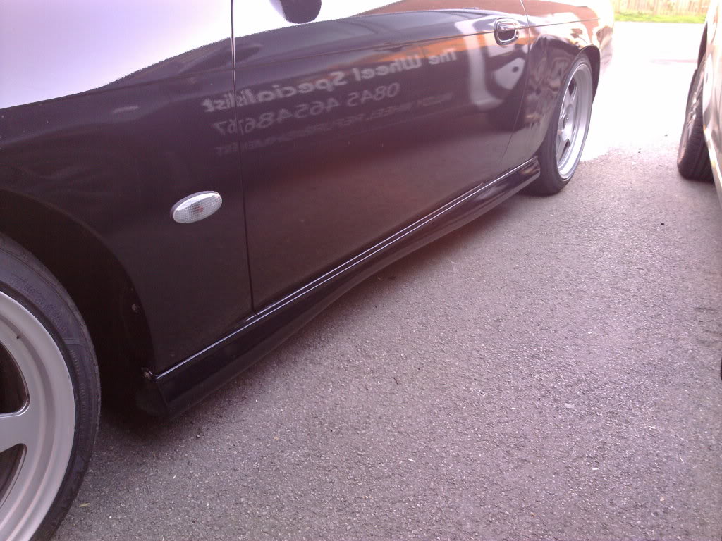

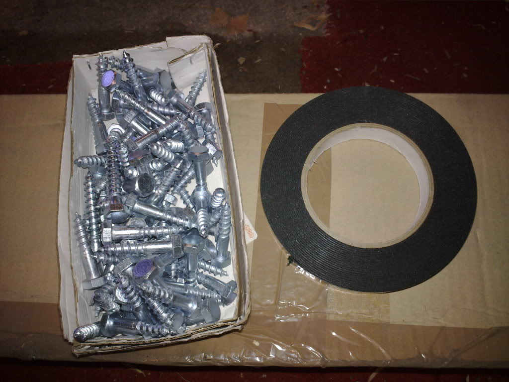

A bit more niggle sorting this afternoon. Passenger sideskirt dropped off weeks ago, so with these...
I ended up with this (yes I know about spacers, money's tight this month again)...

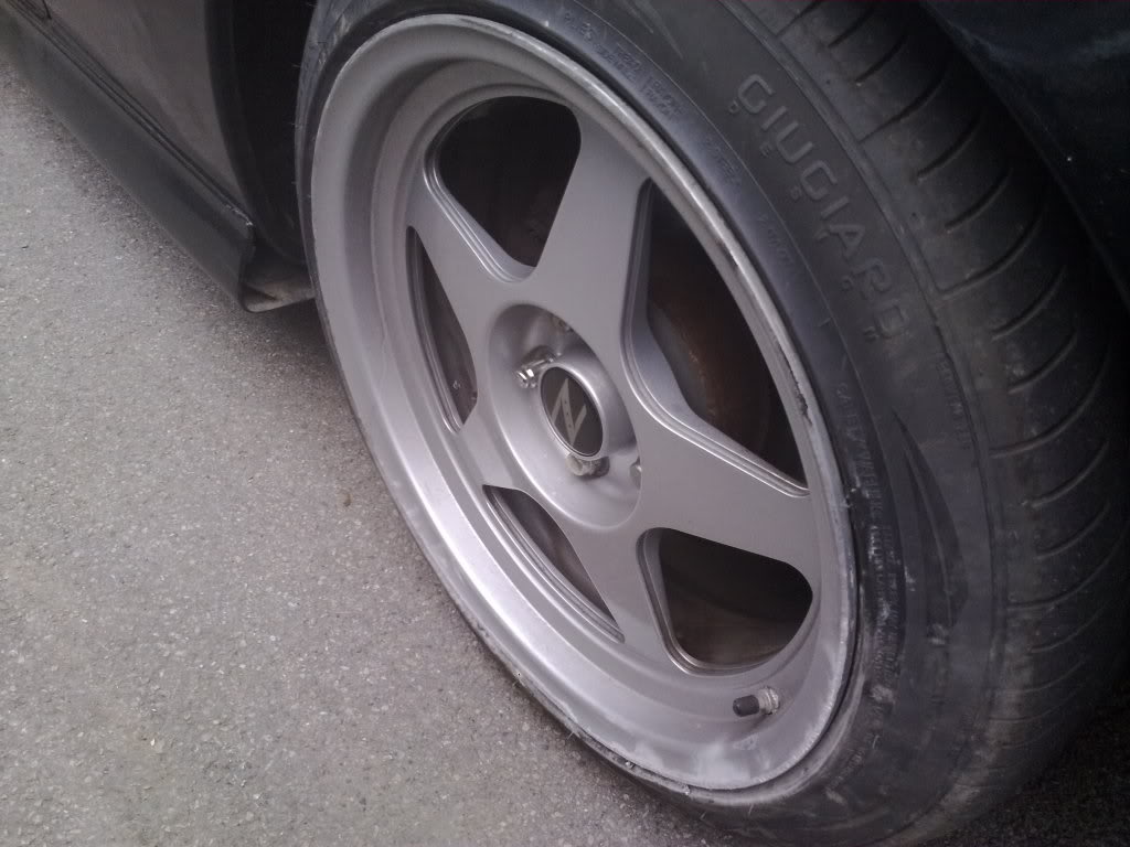

I broked it. All my own fault, involving 2 kerbs on some private land. What's done is done.
So anyway, the death toll so far is...
  • 2 x Desmond Regamasters in 17x9 ET38 (I need some!)
  • 2x Rear Lower Arms
  • 2 x Outer Toe Arms
  • A lot of CV grease
Rest seems to have held up to the smash at least.

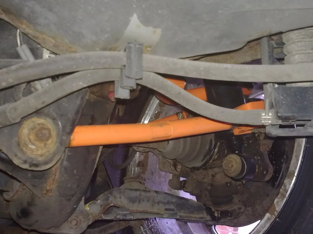

Plan is to probably put the front wheels on the rear, and put standards up front. To get it back on the road I can't decide whether to swap all the control arms back to the originals, or just the outer toe arms. Already have 2 lower arms waiting to fit.
Anyway, something for you all to gawp at ;)

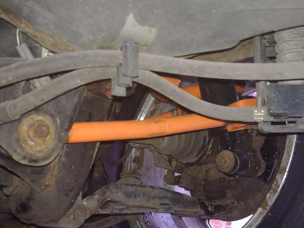

A fair bit of Positive Camber

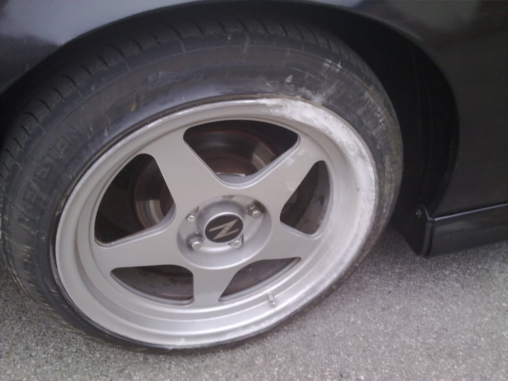

Driver's side (took the main brunt)
Passenger Side
Outer Toe arm physically bent on driver's side.

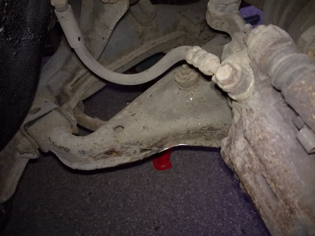

Passenger Lower Arm

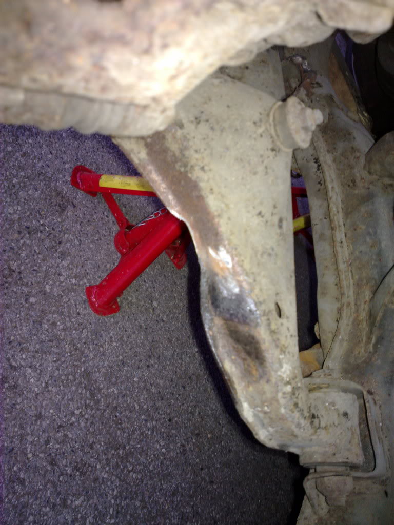

Driver's Lower Arm (The Worst bent)

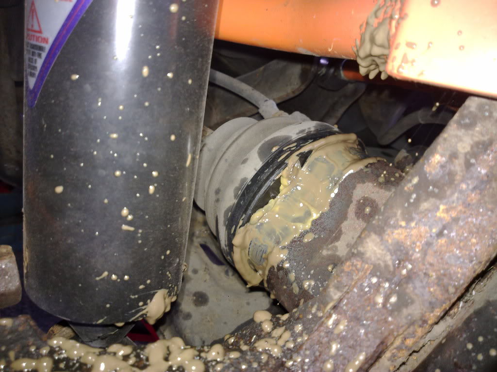

CV Grease all over on the O/S.
