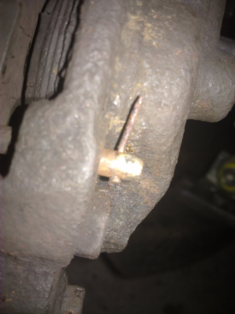

Had a sticky front caliper causing the vibration, as it did it to me the other night and I kindly got the glowing red disc to indicate the fault. Had the caliper off today and tried to free it up for the time being, but I don't think it's worked.
So that leaves me basically with a car I daren't drive, yet need to drive to fully fit my GTS-T setup :rolleyes:. Not sure how I'll combat that, may just mean a drive with no handbrake, which isn't such a big deal.
Also found this awesome bodge keeping the brake pad pins in...
Keeps them in, can't deny that. Unfortunately, the little nails didn't come out, so had to be sheared off. Now the holes need redrilling so split pins can be used.

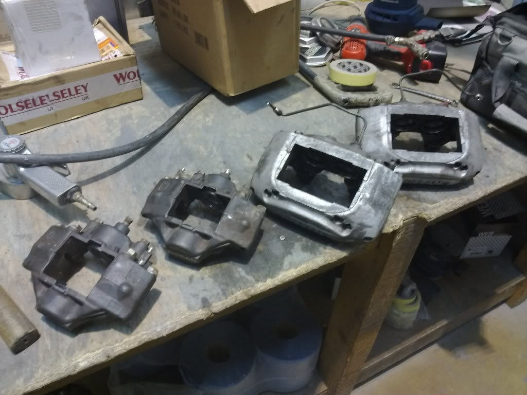

Got the Calipers stripped and ready for powdercoating, which will get done some time this week.

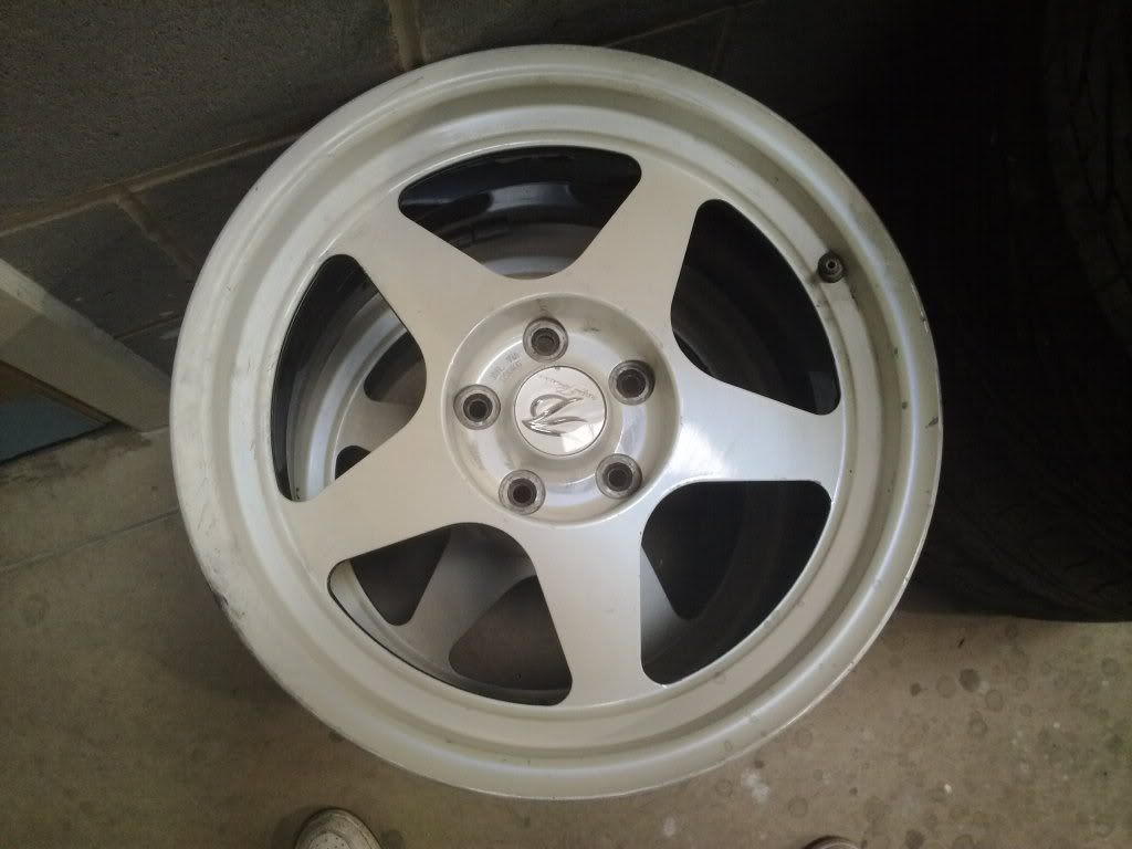

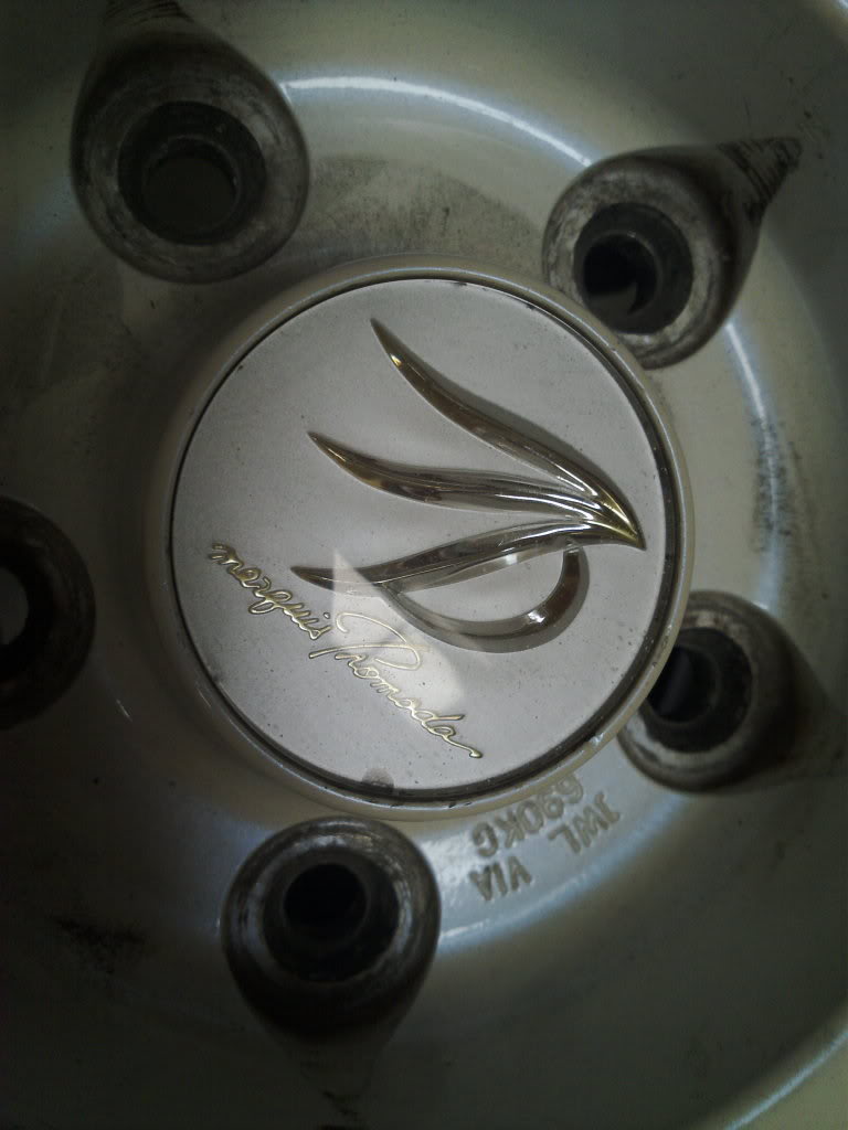

Whilst I was over at my stepdad's place, I finally go to see the pair of Regas (<3) for the first time I bought back in October! Can't believe my stepdad spilt thinners on them, clumsy git lol.
So once the calipers are coated I'll rebuild them, and take a bit of time off to get them fitted :D

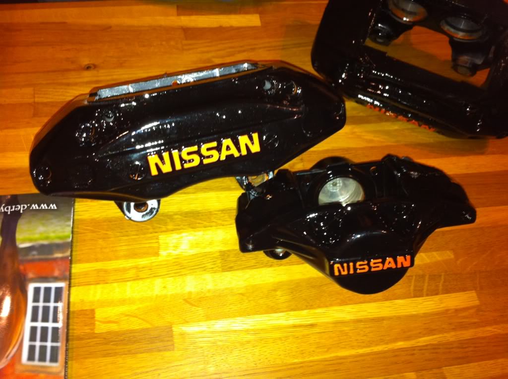

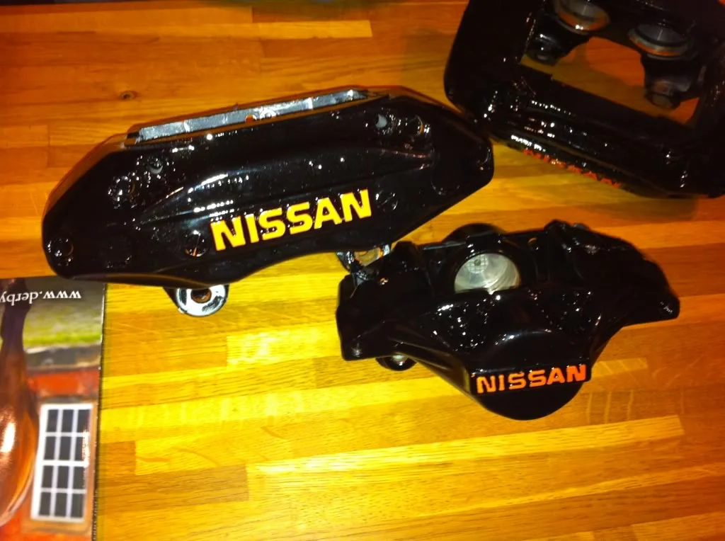

Minimal progress. R33 GTS-T Calipers powdercoated orange, metallic black paint over that, rubbed off to expose the orange, then 2 pack lacquered as we thought powder lacquer might not sink into the writing between the gaps.
Just waiting on rear seal kits and discs/pads to arrive now.

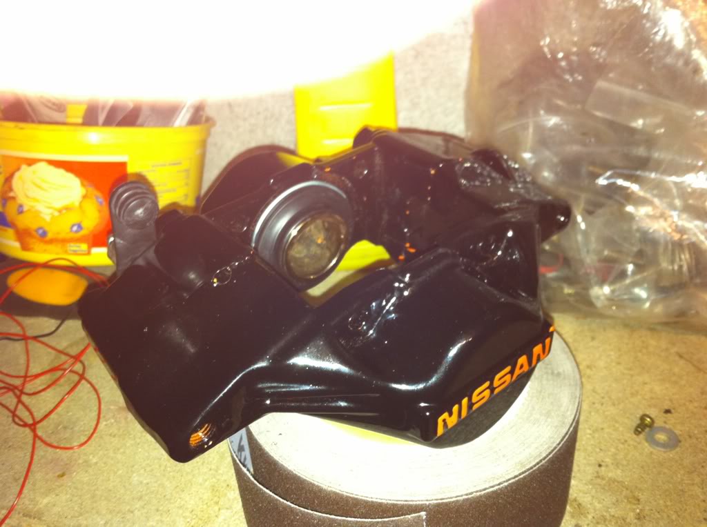

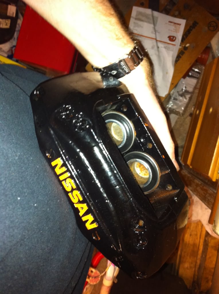

Got a bit done today, calipers are rebuilt. Thanks to my slack friend's masking, I spent a few hours cleaning powdercoat and sand out of the calipers :rolleyes:
A front caliper built up.
A rear caliper built up.

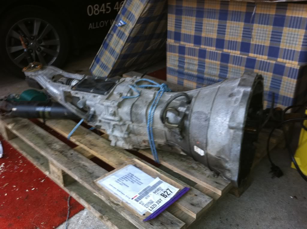

Nipped over to Garforth last night too to pick this baby up, the 350Z gearbox, prop and crossmember.
Surprisingly light, 2 people can easily lift the pallet and manoeuvre it.

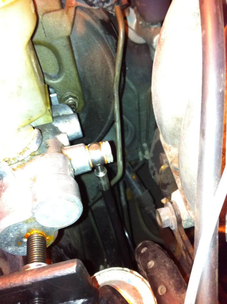

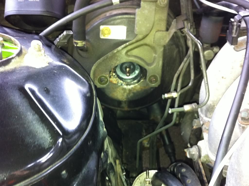

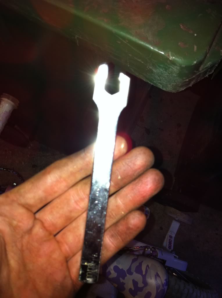

A bit more progress, but I've hit a wall again for the time being. That wall is I need my front pads, and front and rear discs to arrive (only ordered them on Monday.) I also need some brake pipe union spanners, as the unions are very rusty, so once one started to round off I gave up and decided it was best to use the proper tools. Hopefully I'll pick some up tomorrow in town.

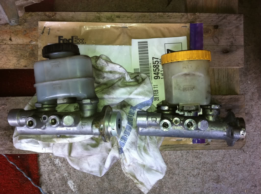

So anyway, this morning I whipped off the Brake Master Cylinder to replace it with a Z32 one (BM57.)
S14 vs 300zx, not much visual difference bar the reservoir pots.

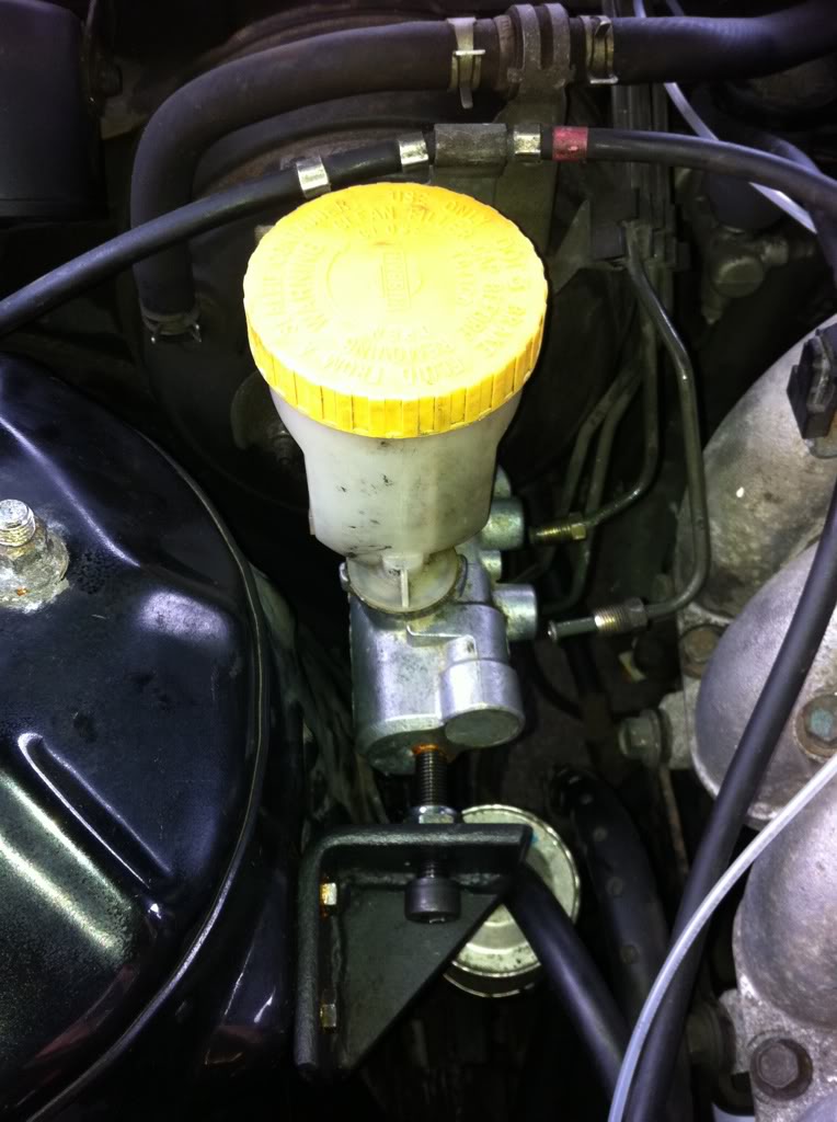

What a Brake Servo looks like with no master cylinder attached to it.
Z32 BMC and a BMC stopper fitted in place.
Noice! What's the deal with the 350 box? Straight fit?
Nowhere near a straight fit...
Spacer plate and custom shorter prop (350z has a different yoke to the S14, so a crossbreed of those 2 is needed) as per Malice's post, but it's a Z33 not Z32 box. Also, crossmember needs altering, shifter needs shortening to fit the trans tunnel hole, longer clutch line (it's on the opposite side to the SR box) and bell housing needs machining due to the plate. Might have to tweak the clutch fork a bit too. No sensor for the speedo either, so have to convert signal from rear ABS sensor to run the speedo.
But it's very strong, 6 speed (shorter ratios with the S14 diff, and still a nice cruising speed on the motorway) and a lot fresher than my box.
That's a big compliment coming from you :eek: Will be more heroic when I get the Regas coated in my secret(ish) expensive powder (£80 for 6oz, FML), and spaced. Tyres are sat waiting for the fronts now, I sold the last ones off for being too small really. Sump would have to touch the floor to hide the arch gap.
Fook that! Dedication to the cause! Haha! I think I'd just fit a S15 box and change it if it ever blows.

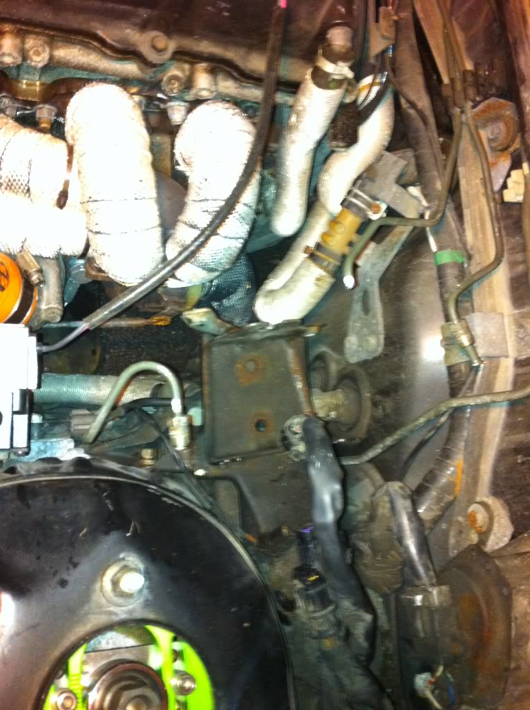

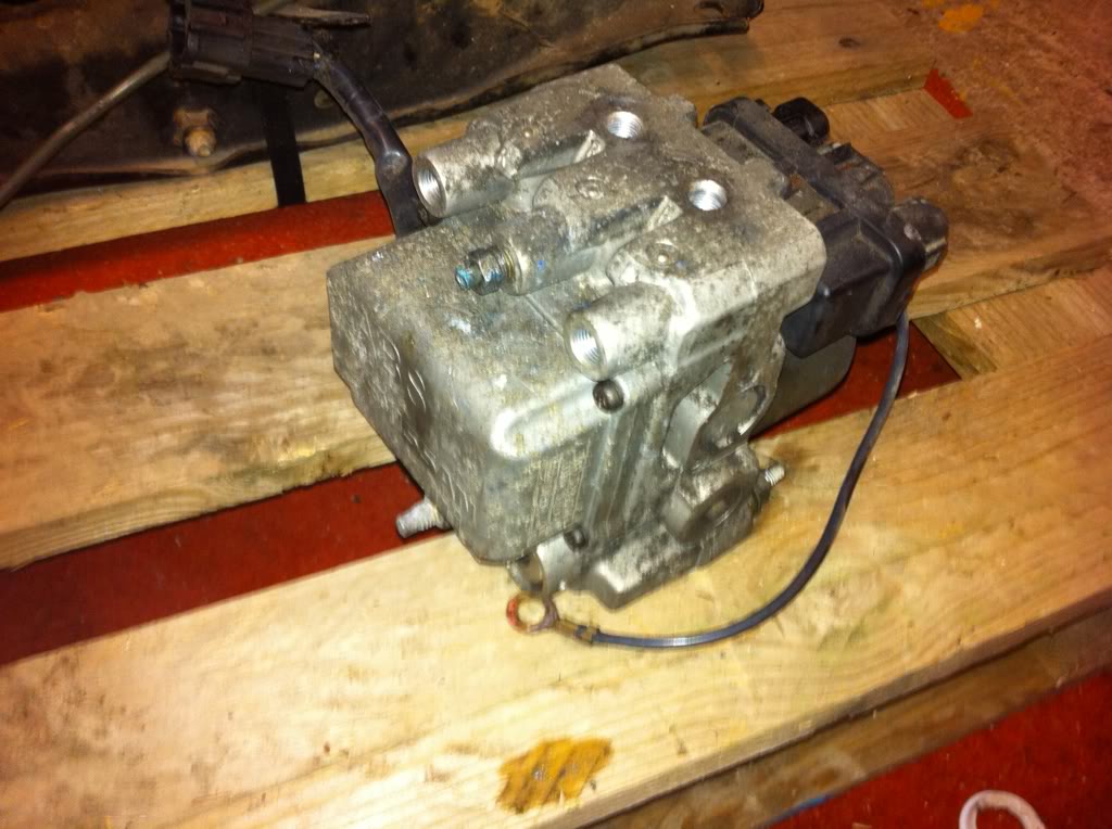

Some more progress.
Ripped this crap out on Saturday...
Which left me with a big hole...
Did nothing Sunday, then today the final pieces arrived. So I started fitting the lines/calipers...
The rear brake line unions required some major butchery of my newly acquired brake union spanner...
But I got it all sorted...

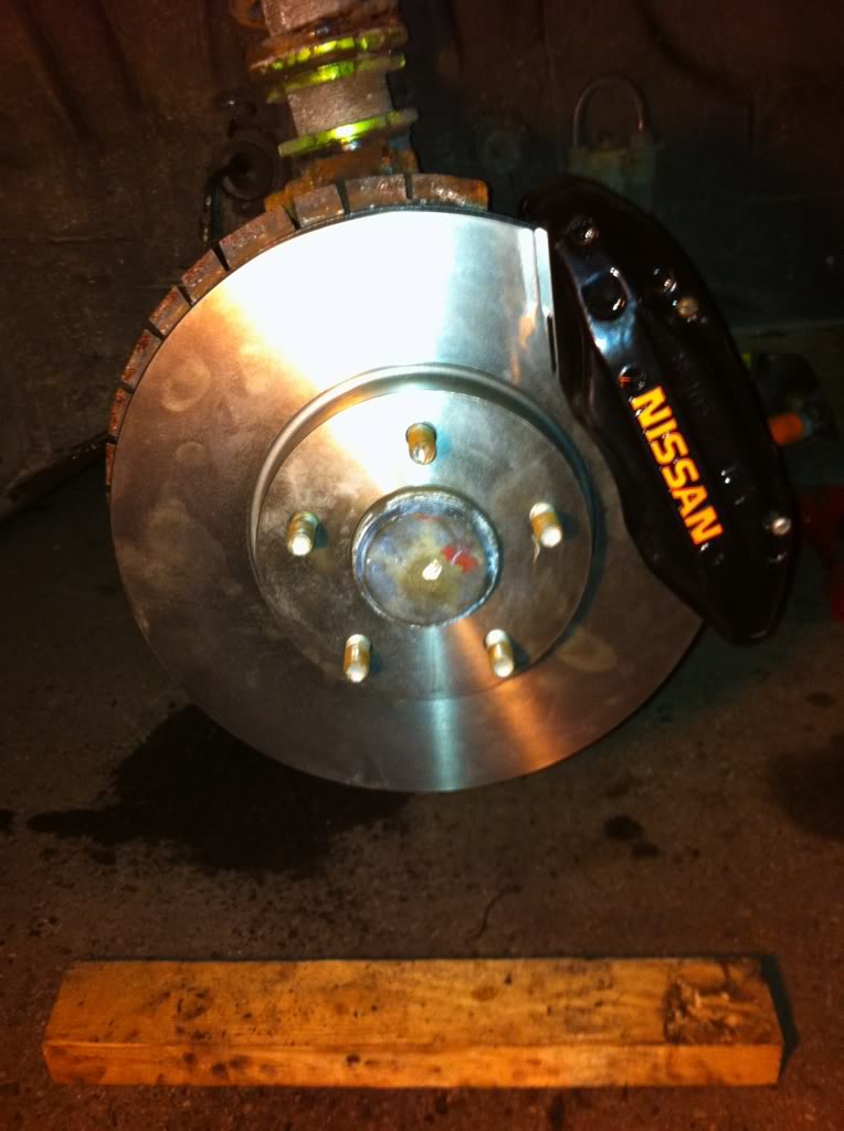

Then finally, before retiring for some tea and rest, I got the O/S/F caliper and disc on.
Disc and pad wise, Brembo Plain Discs all round, Mintex 1144 pads up front and Mintex OEM pads out back.
