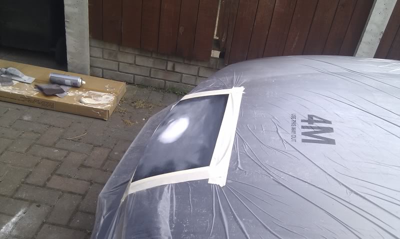

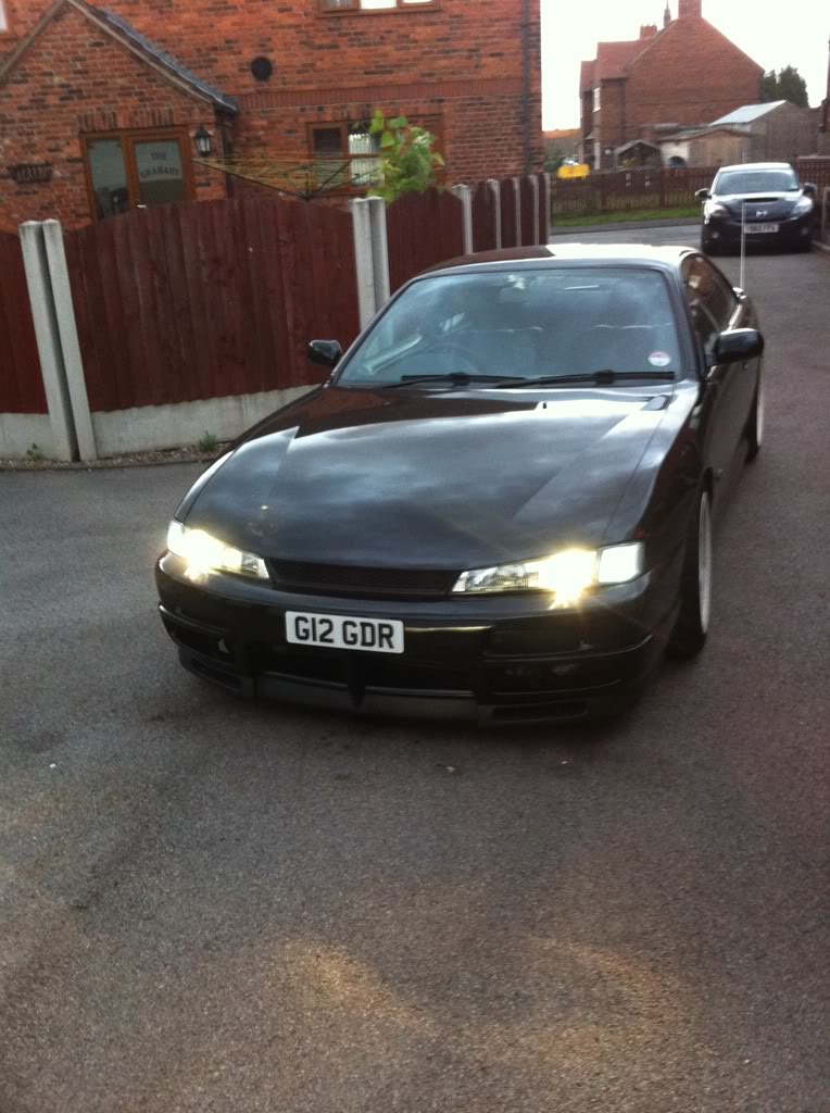

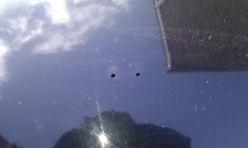

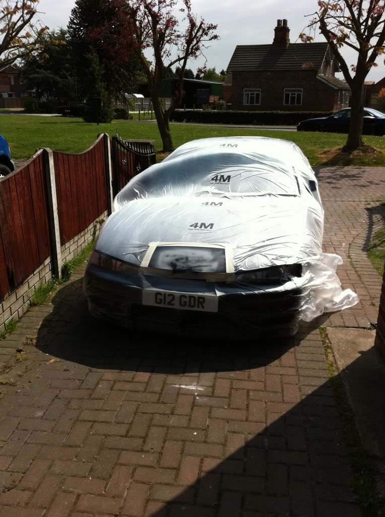

Here's some pictures I took when I went round to strip mirrors and handles off and raise it yesterday...
Wearing a shower cap.

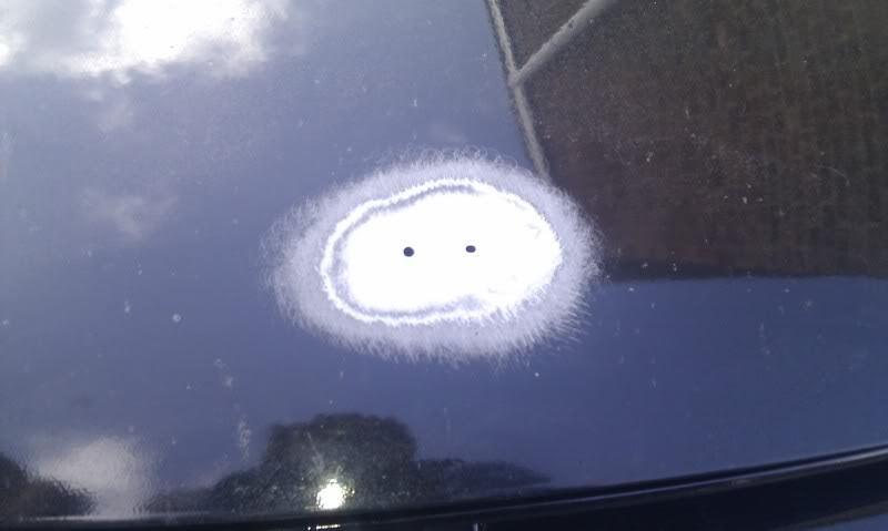

Bonnet badge holes smoothed out.
Hiding my moment of rage.
He also took some WIP pictures that I'll post when I get them, and it's all finished, but I need to wash it before I unveil the shine. Needless to say, I'm well and truly back in love with the car now, despite it's horrendous handling issues. Still a bit to do, we're going to do something with the rear bumper, and the spats need fitting.

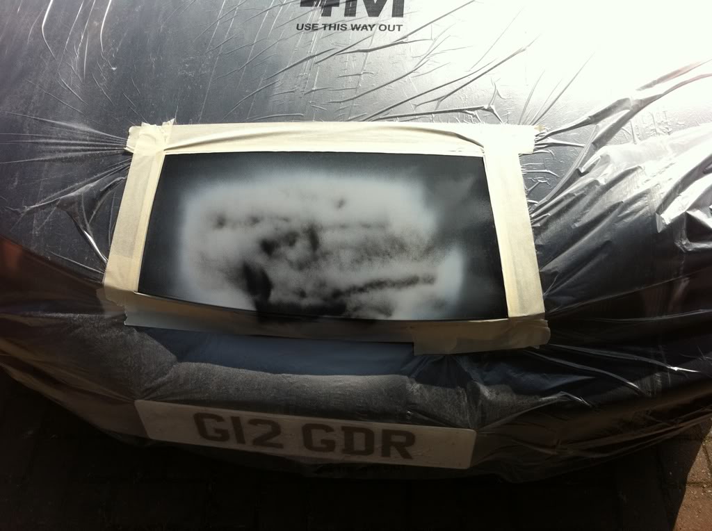

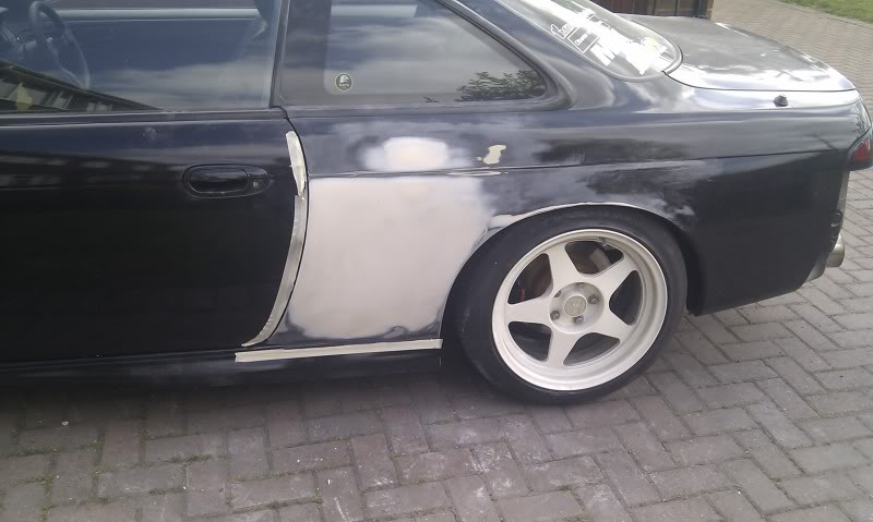

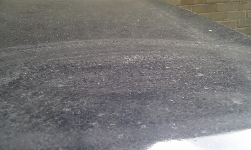

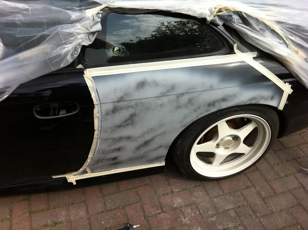

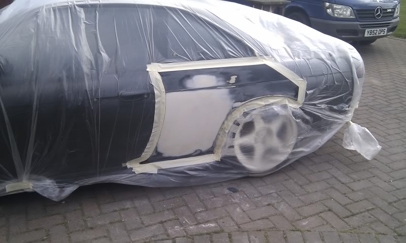

Got some WIP pictures. Unfortunately, there's no spray booth pictures as his phone died.
So bonnet...

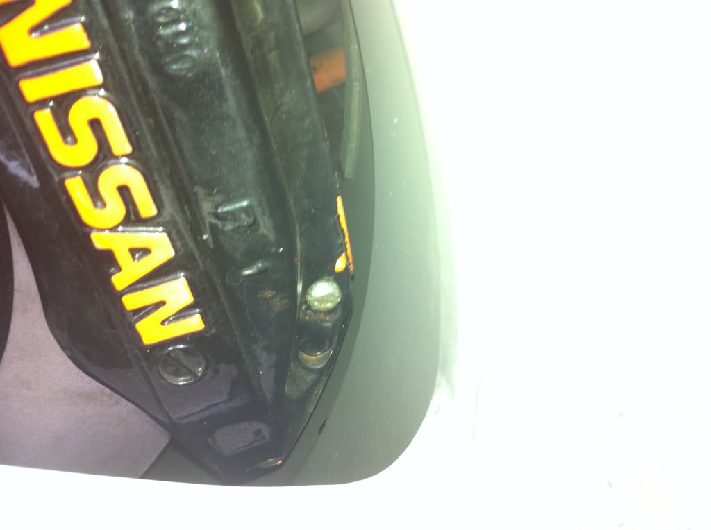

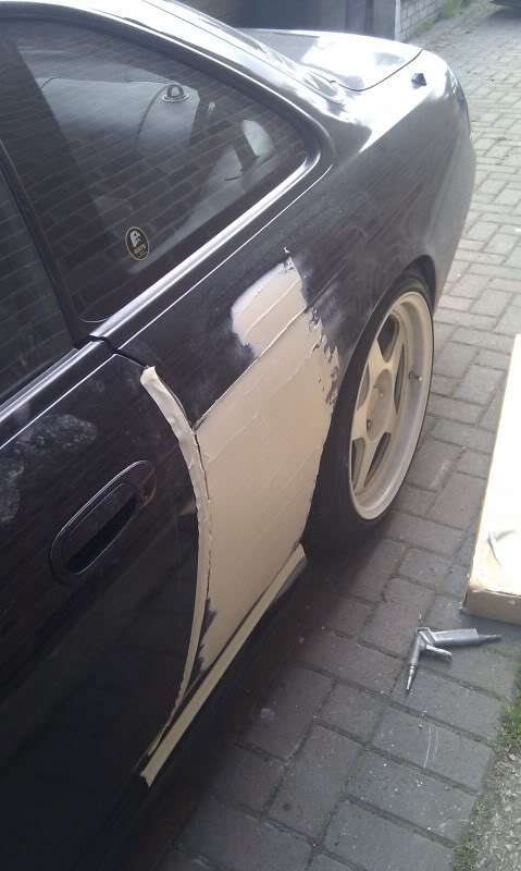

Bit of rust on the wing..
The rear quarter...

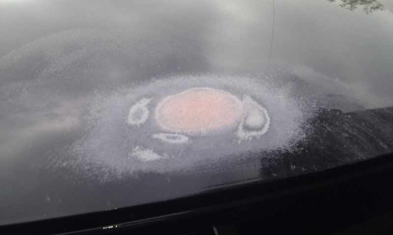

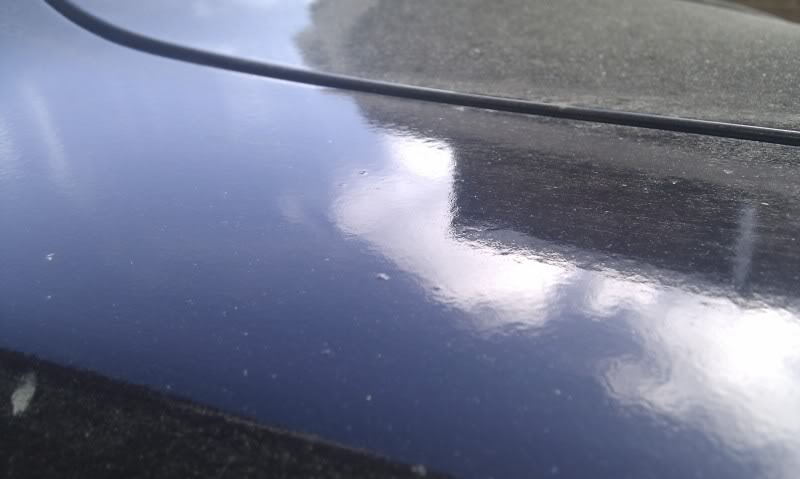

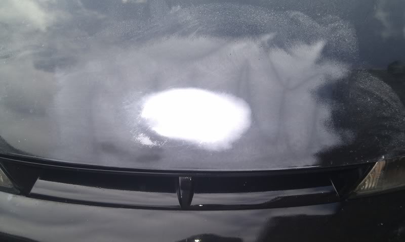

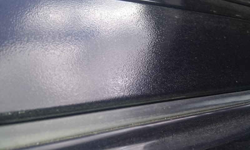

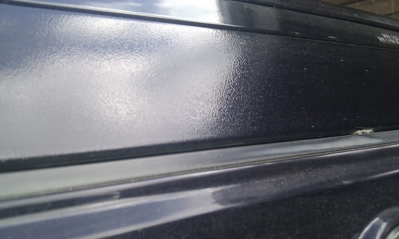

And the orange peel/defects that dogged the car previously...

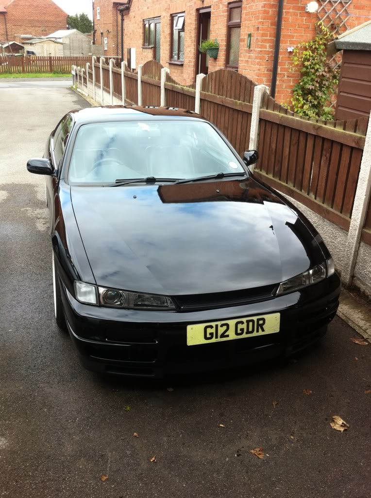

Gosh, been 2 months nearly since I updated. Well, not had a lot of time for the car with being on outage at work, but it's pretty much over now! Excuse the iphone snaps, didn't realise the DSLR battery was dead.
Did a few little bits to keep me occupied. First up, I got something sent in from Japan. A Kouki grill. I didn't like how it sat at first but it's really grown on me.

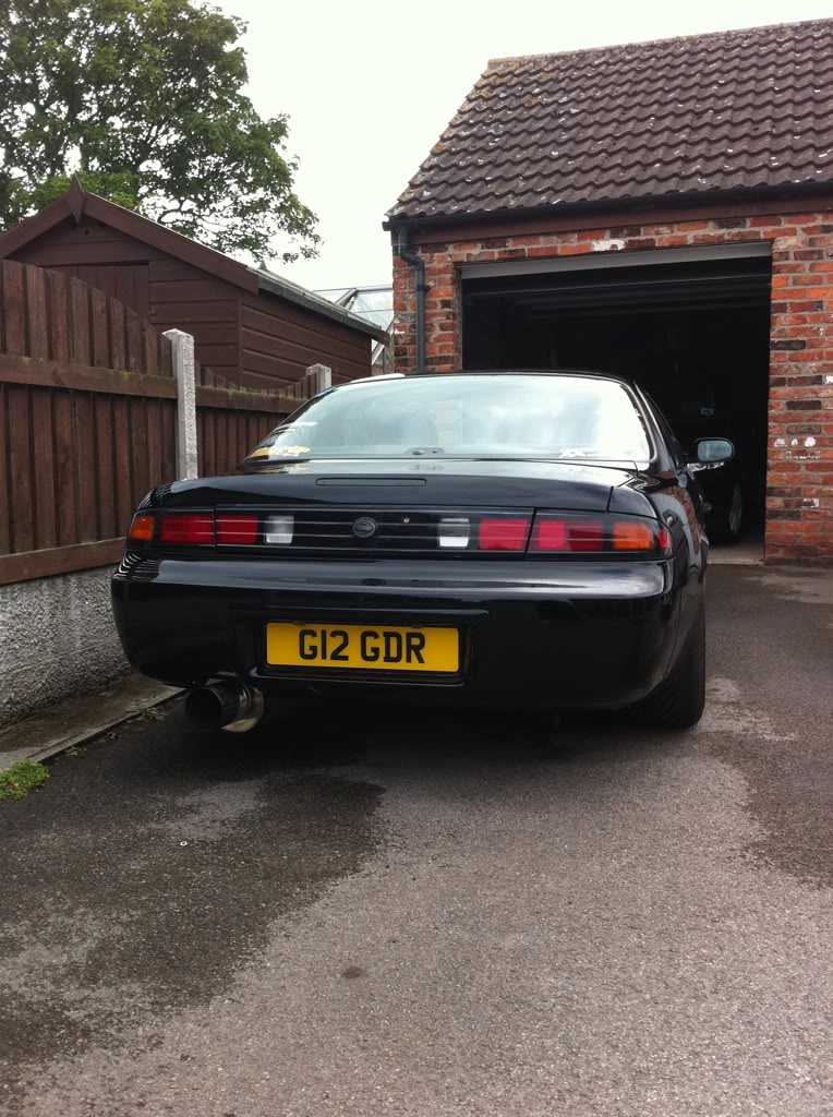

Then I got my rear bumper modified by the same lad who painted the car. It's had the reflector/fog removed, and is colour coded and kind of smoothed in. The fog light is now in the driver's side reverse lamp. Vast improvement.
Not much left exterior wise now. A smaller plate, the spats, the 18" Regas, possibly modified rear lights and de-chromed headlights, maybe a tad lower too.

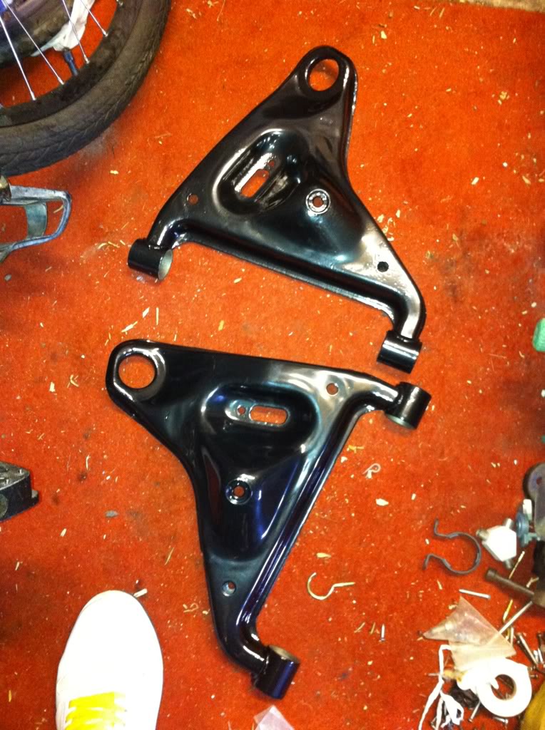

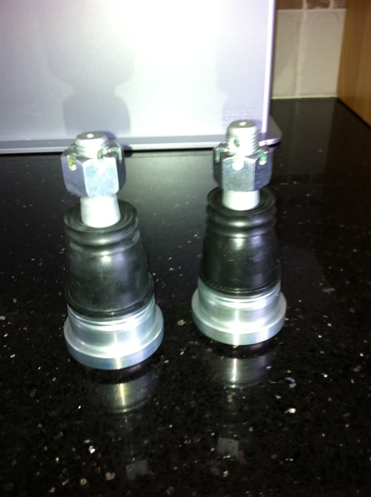

On the sidelines I'm working on polybushing & building up the back end. So there's a blasted/painted and bushed subframe in the garage. I've all the polybushes for the hub uprights, which I'm modifying some R33 GTS-T HICAS ones into non-HICAS. I've also got these puppies to go in the lower rear arms.
Nagisa Auto rear roll centre correction ball joints, fresh from RHDJapan. Love Jap parcels lol.

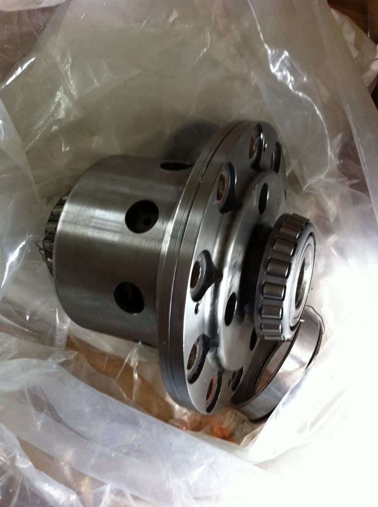

Also got myself a spare VLSD. It's going to be ripped apart, and I've got this Kaaz 1.5 way LSD to drop in it.
So once I get some holiday time off, I'll build it all up and get it fitted. Also debating whether to drop the fuel tank at the same time and protect all that part of the chassis.

wow! you are doing some big work on this now gaz! impressed!!
make sure when you fit the diff you do it propperly and not just slap it in lol, use plastigauges to check for bearing clearance etc... tbh it was the one job i didnt want to do myself and got someone else to do it for me as last thing i wanted to do was stuff my nismo pro 2 way

It's just a bevel gearbox at the end of the day, I'm well versed in adjusting them thanks to my profession ;) I'll be making sure the backlash, runout and contact patch are acceptable. I'm not just dropping it in like half the people who fit them. As for bearing clearances, there's nothing to really measure on a taper roller bearing dude. It's totally different to a journal bearing like you'd find in the engine.

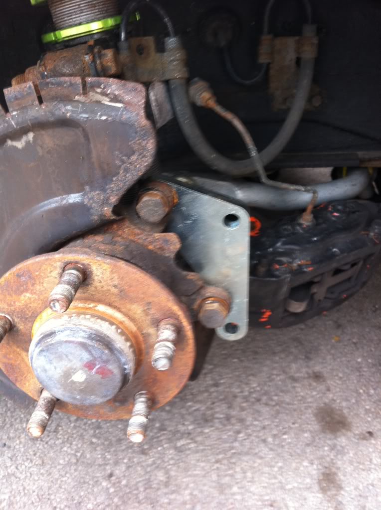

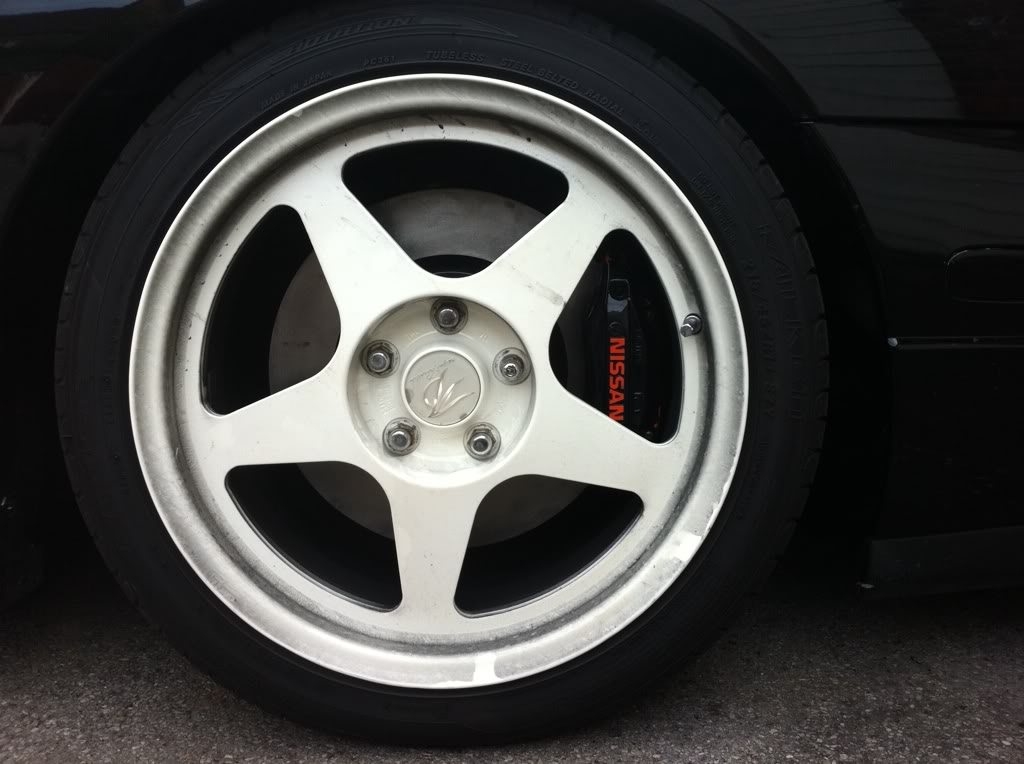

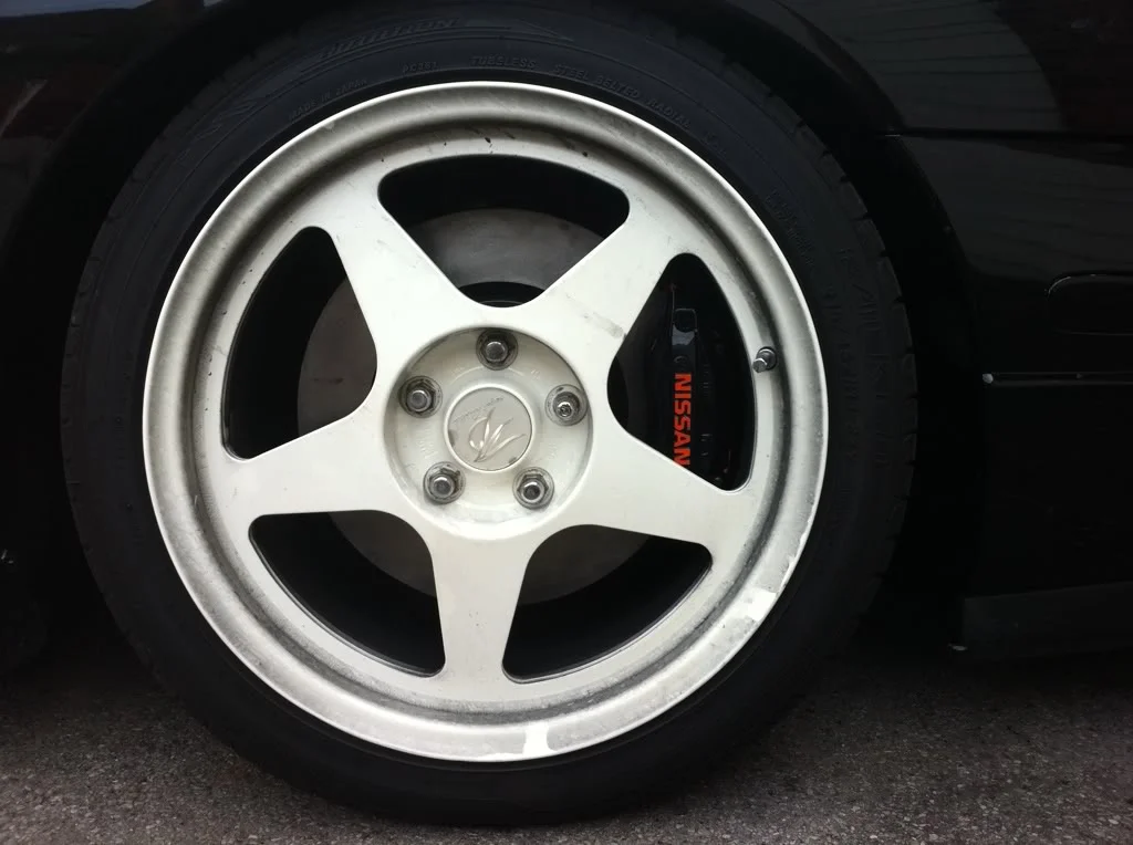

Did this though. Fitted some 330mm front discs, as I felt the 296mms were a bit lacking on a long thrash. I've kept the 296mm discs for winter though, as they fit under 16" Wheels.
So, they're DB-Power's brackets and discs. Could have done this myself seeing them, but why go through all the hassle of finding discs in the right offset, modifying the PCD (as nothing with a 114.3mm PCD is 330mm and the right offset it would seem) and making up the brackets when somebody else has already done the hard work?
So brackets on...
Oh, finally go the right spacers after god knows how long, 3-4 months! So they went on the front after the discs (30mm spacers), then the wheels did too. Fill the wheels much betterl...
Quite tight under there now mind, seeing as these 17s are now promoted to track wheels, I couldn't go any bigger...

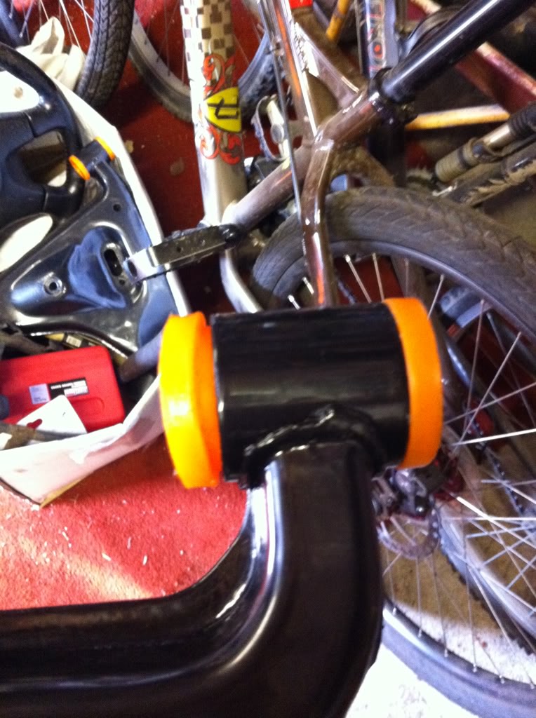

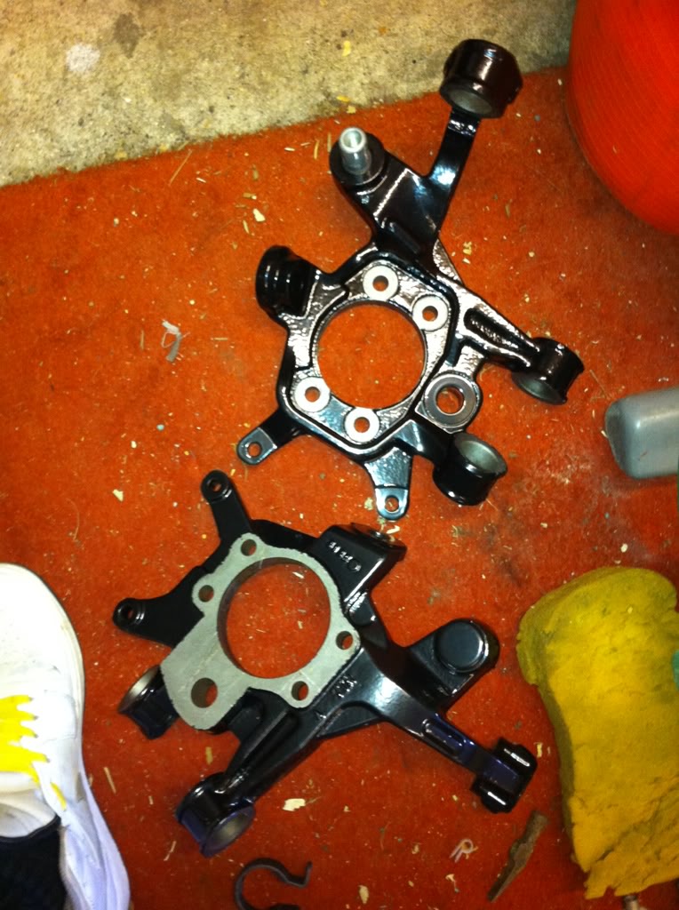

Also, got these done yesterday. Tried getting the 4 ball joints out in a vice (yes 4, those are Hicas hub uprights from a skyline), I failed. Ended up paying to get them and the bushes pressed out, was less hassle, rather than sneaking back into work on my holidays and doing it.
Only problem is, turns out Driftworks bushes aren't up to much, which I didn't search before buying them. So this will hold up progress for the time being, until I decide what to do. So much for thinking bushes would fit properly eh?

Right, by now, I should have had my new subframe built up, polybushed and the kaaz 1.5 way fitted. In reality, the diff is half stripped, and the lower arm bushes are driving me mad. So that hasn't happened.
Not impressed with the Driftworks bushes, just can't stop them from doing that.

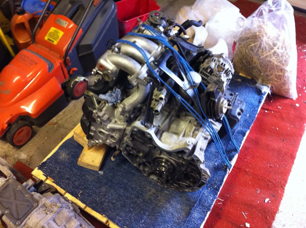

An SR20DET from an S15. 30,000km on it, fitted with Tomei Cams and pulleys, Rocker arm stoppers, Metal headgasket, and probably uprated valve springs. It'll be getting some uprated headstuds, forged and maybe some other bits in the future.

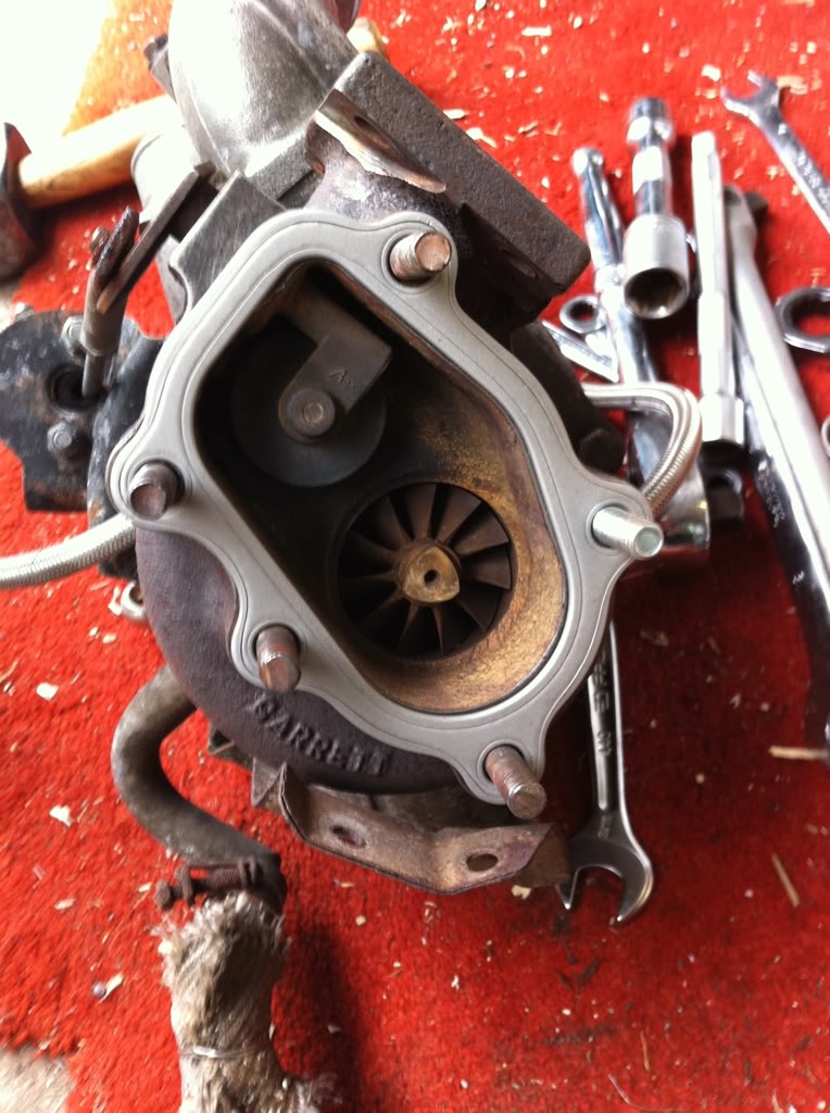

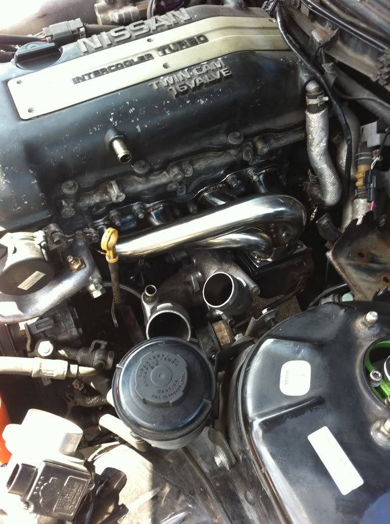

So I got up today and thought I'd finally fit my new manifold and fix some small coolant leaks.

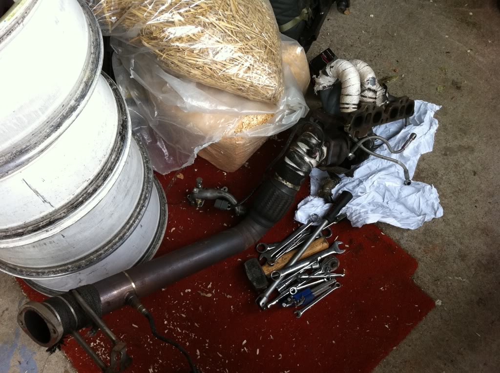

Got all this and the crap in the way off this morning...

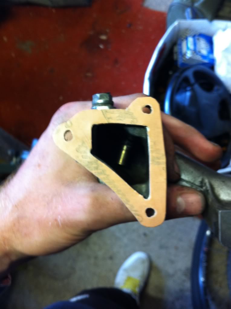

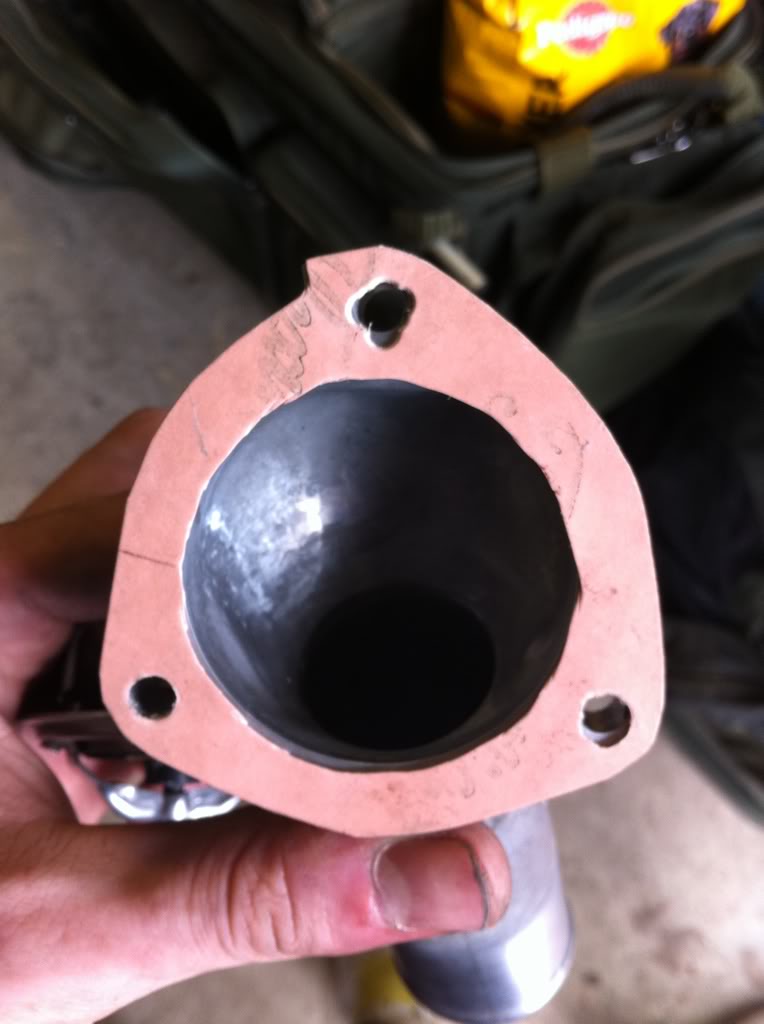

Knocked up some gaskets to hopefully stop my small leaks on the thermostat housing and coolant outlet...
Ripped the turbo assembly apart, new downpipe gasket and downpipe refitted to it.

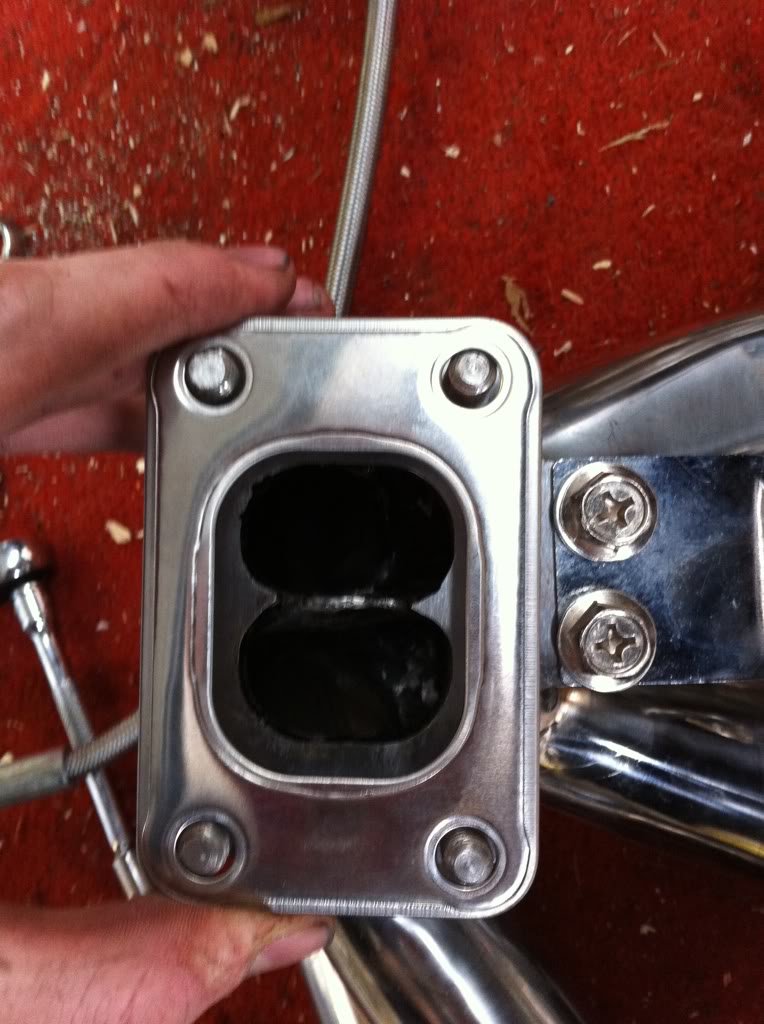

Then went to fit the manifold. And the studs have been drilled and tapped slightly too large...
Tried drilling out the turbo flange, and ruined 3 decent drill bits. Good job work paid for them. So now I'm at a loss for the time being unless I refit my old manifold. That is something I don't want to do, as I'd want the flanges skimming for piece of mind. No car = no skimming. You can see the predicament. Bloody cars!

lol was gonna say hammer lol, your thermo... you thought about getting the faces skimmed?? might be warped?? i snapped one in half by pinching the corner of the stat under the edge and i tightened it down but never had any issues with leaking like you lol!
on my way in a min to take the rx7 for a mot :D
TBH, the leak had pretty much stopped there, but the stat was playing up so put another in. The gaskets are 1mm thick, better than the sealant I have to hand.
I'm probably going to step into the 30series of turbo eventually.
Anyway, It lives!
Hammering the studs level got the manifold to fit. Soon got that all dropped in.

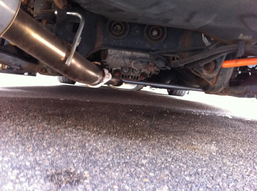

Cracked on getting it all together and fitted a different decat, and made up a sturdier mount for the downpipe. Gained a good 2-3" of ground clearance now the system is fairly droop free.
