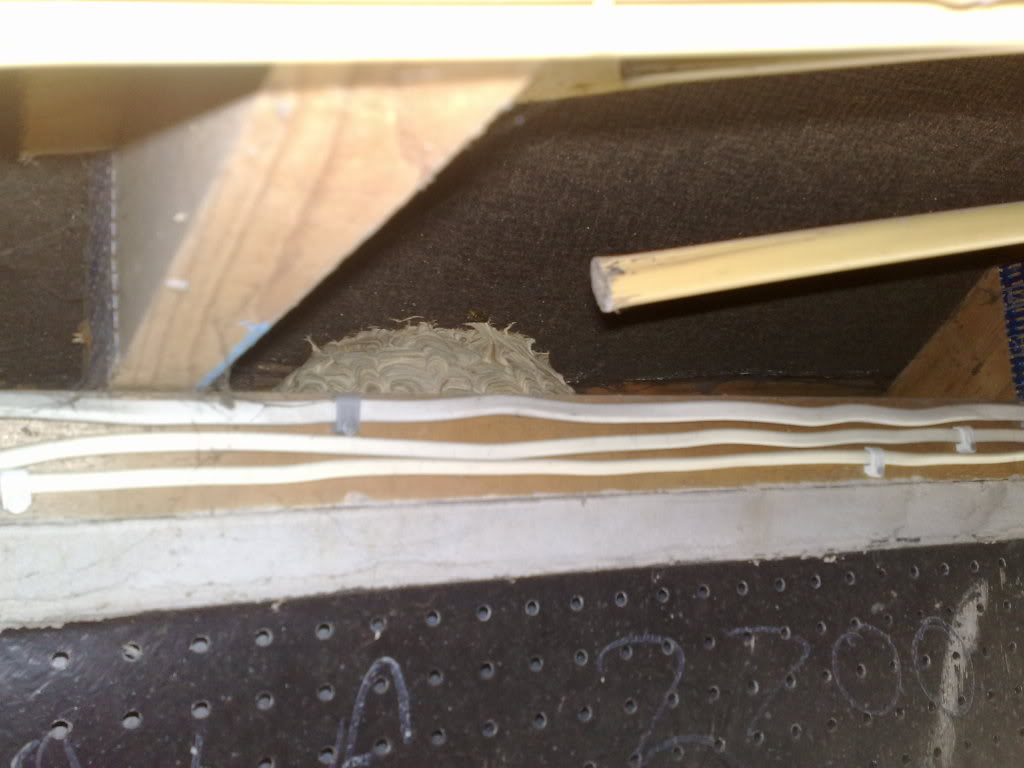

Literally can't do anything on the car for more than 5 minutes without being harassed by wasps. It's being looked into (I'm not paying to kill them, it's not my name on the bloody mortgage.) Doing my head in now though, I just want to be able to drive the thing!

We've just banged a couple of tins of that wasp killing foam at the nest, see if that gets rid. I'm dreading doing the arches for that very reason, it all looks solid ATM but it can be deceiving.

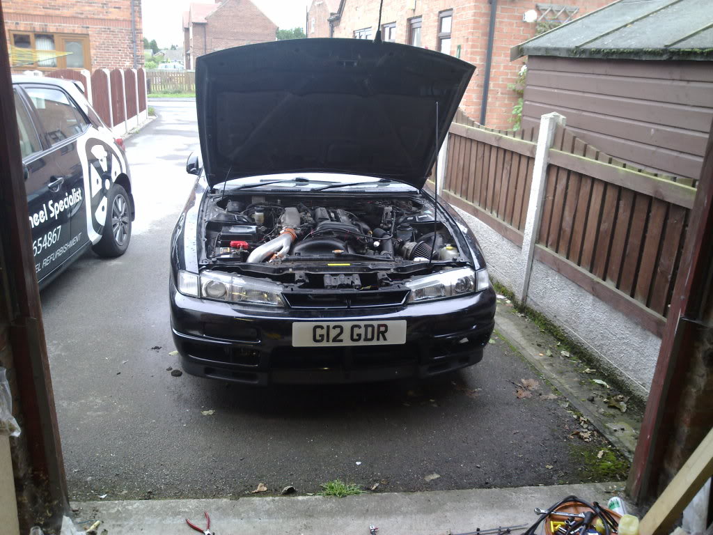

Sweet ass update, I've been able to start it up today :D

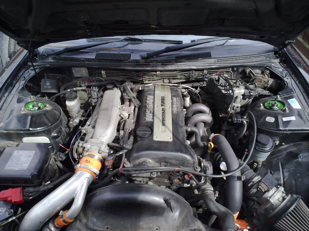

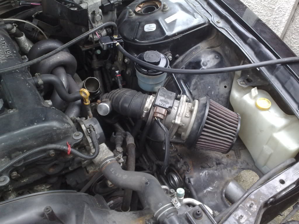

HKS off, Apexi fitted and Recirc Hole bunged up (thanks to Malice for donating the bung)...
Everything put in, all the pipework and the Profec B Solenoid stuff...
And the Profec's location for now...

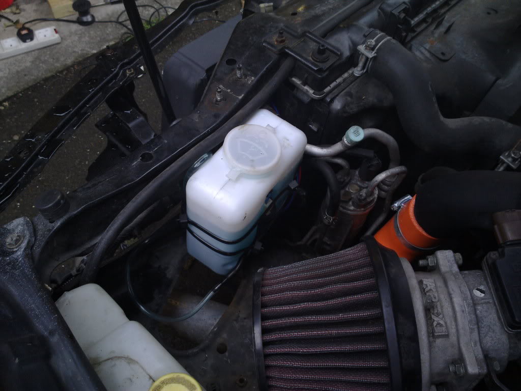

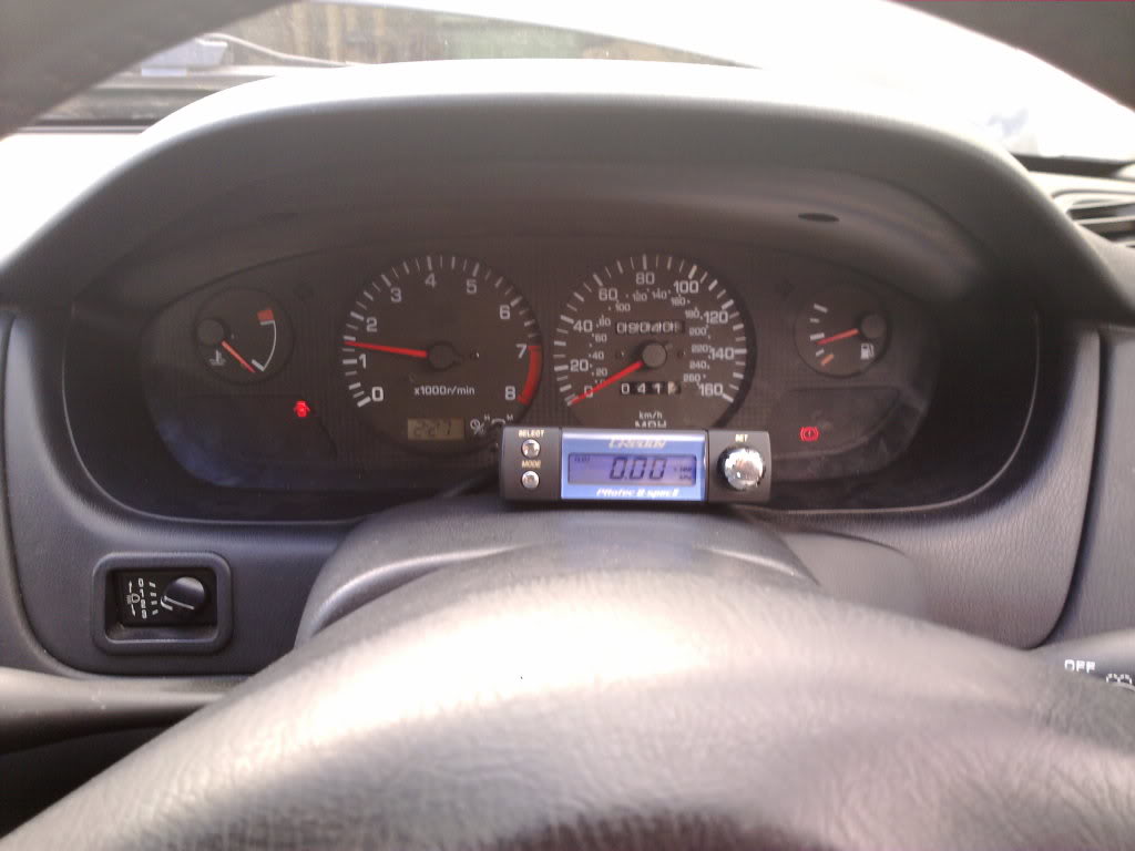

So now I need to sort out fitting my universal washer bottle, get bumper & lights back on, program the Profec and enjoy it.
Wow, nearly 4 weeks off the road!

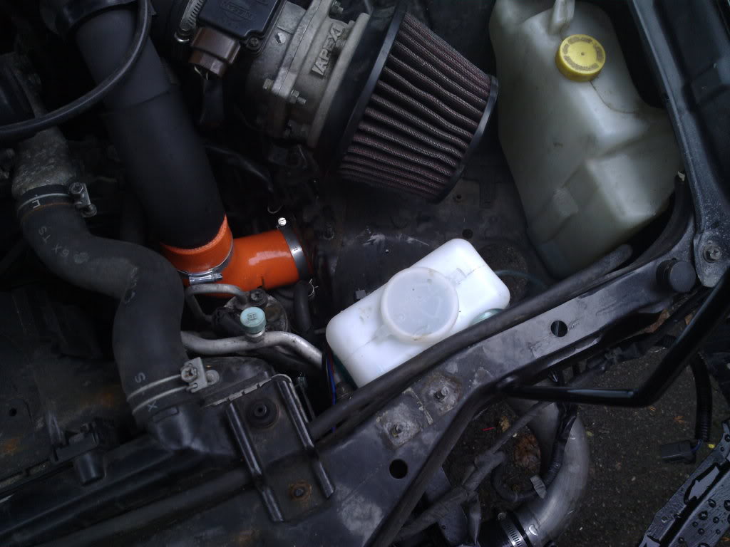

Well, I sorted out my very rig up washer bottle, it does the job but will be moved to the boot in winter...

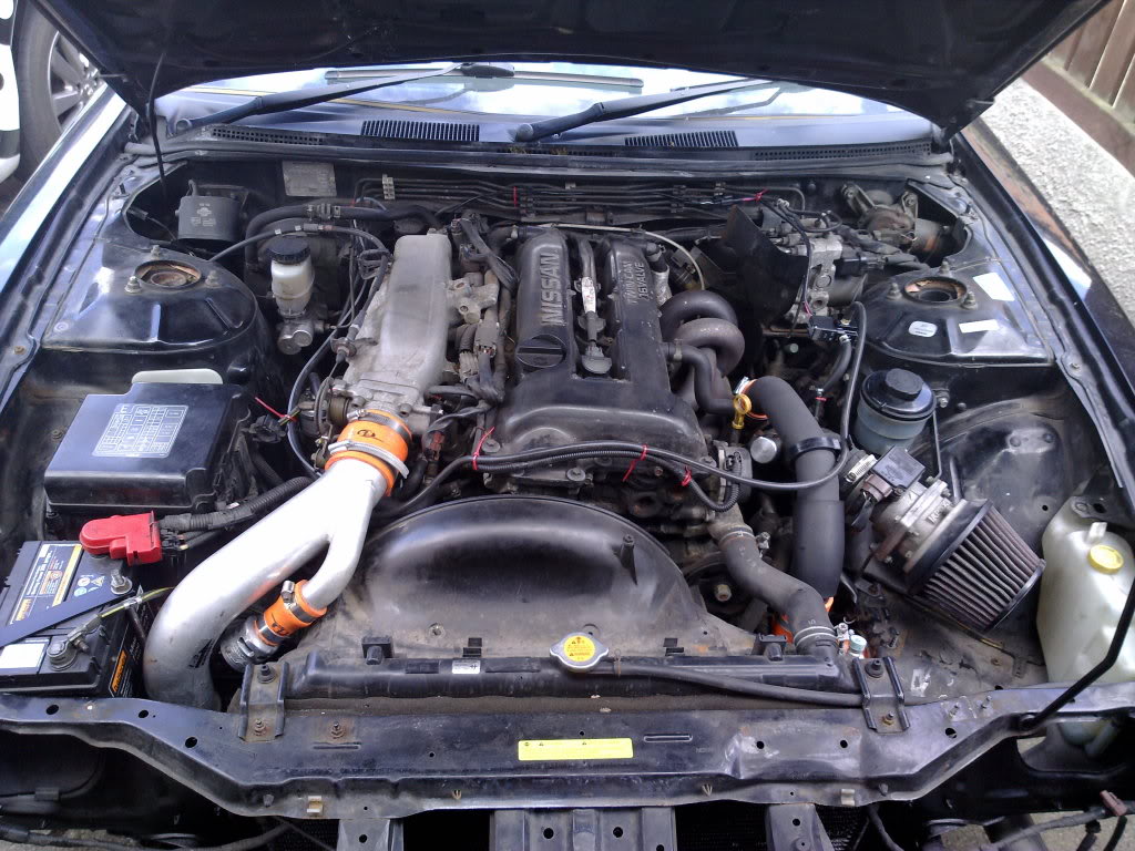

Got a rough setup on the Greddy, but it only held full boost a couple of times before it started leaking again :(. Might have to bite the bullet and get as many Mikalors on as possible.
looks lovely with those wheels mate, just a shame your havin boost problems :dapprove: hope it all gets sorted
Thanks mate. I've decided to man up and forked out for some Murray Constant Tension Hose Clips, rather than continuing this pikey affair of cheap s**t jubilee clips. If that doesn't solve it, it'll be time to start pressure testing components.

hnmmmm i would check your inlet pipe isnt collapsing... also... check your turbo isnt shafted... its not the ecu hitting boost cut is it?? tried resetting the ecu??
Does it at any boost pressure between 8 and 15psi dude, so I doubt it's boost cut.

inlet pipe is the big rubber one that the air filter is on... they have a habbit of when you come on boost collapsing and stopping any air getting through...
see to me its odd, because if it was a leak it wouldnt be just at 5k no matter what boost it is... i mean if you run 8psi and it happens at 5k... or run 15psi and it still happens at 5k... then to me that isnt a boost leak... a boost leak on a 200 is REALLY noticeable even a small leak will make it run like s**t and you wont get over 3k it will sound like a tractor and buck and jump all over the place... sounds like something else to me ....
I knew which one it is. Been out to have a look, and it was misshapen. So pulled it further forwards to get it back into shape. Then bolted the support so that the filter is practically next to the coolant reservoir, and guess what, it now revs to the redline.

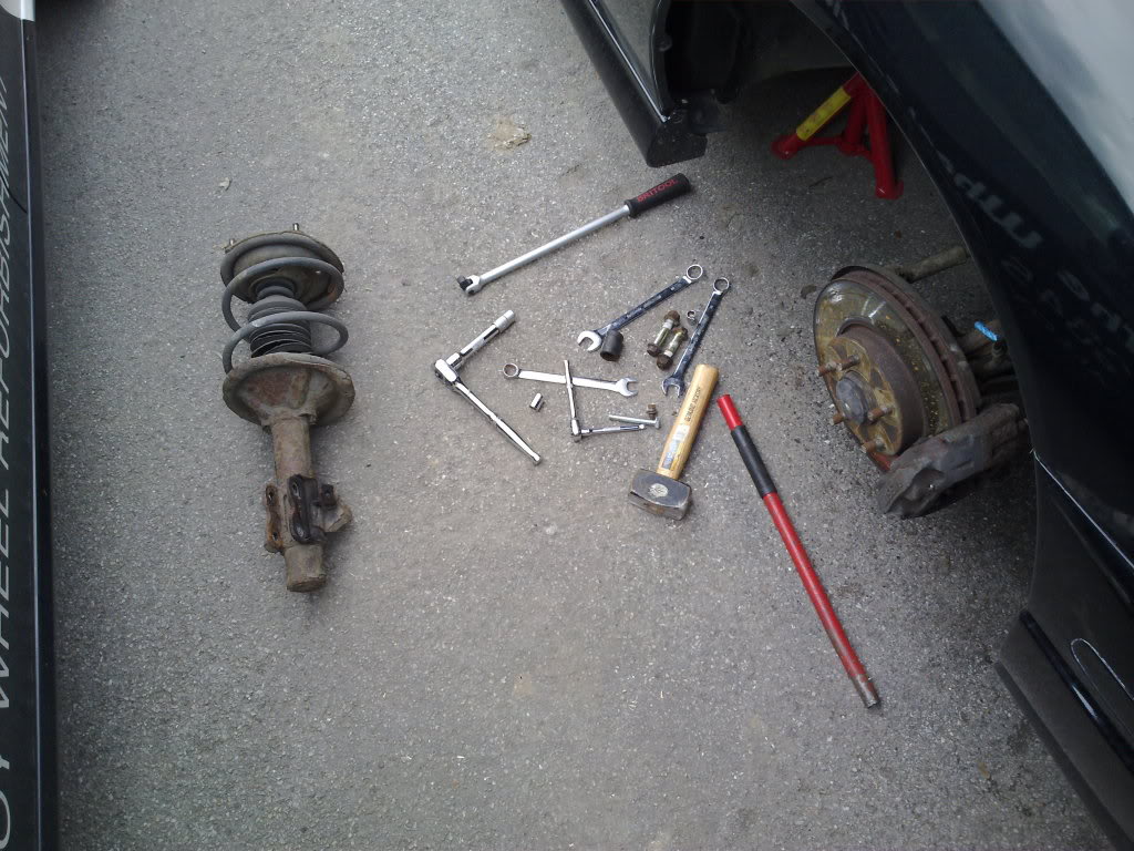

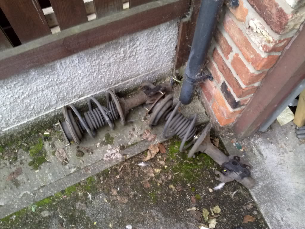

Front struts came off and the arches got waxoyl'd.

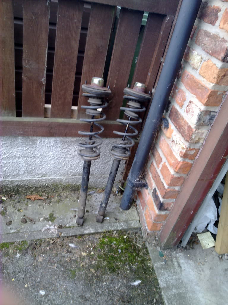

Rear struts breezed off.

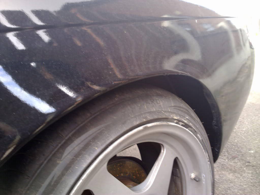

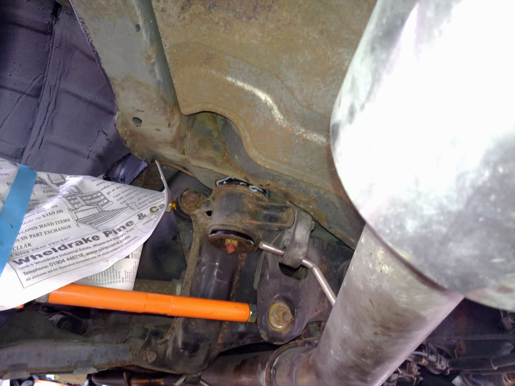

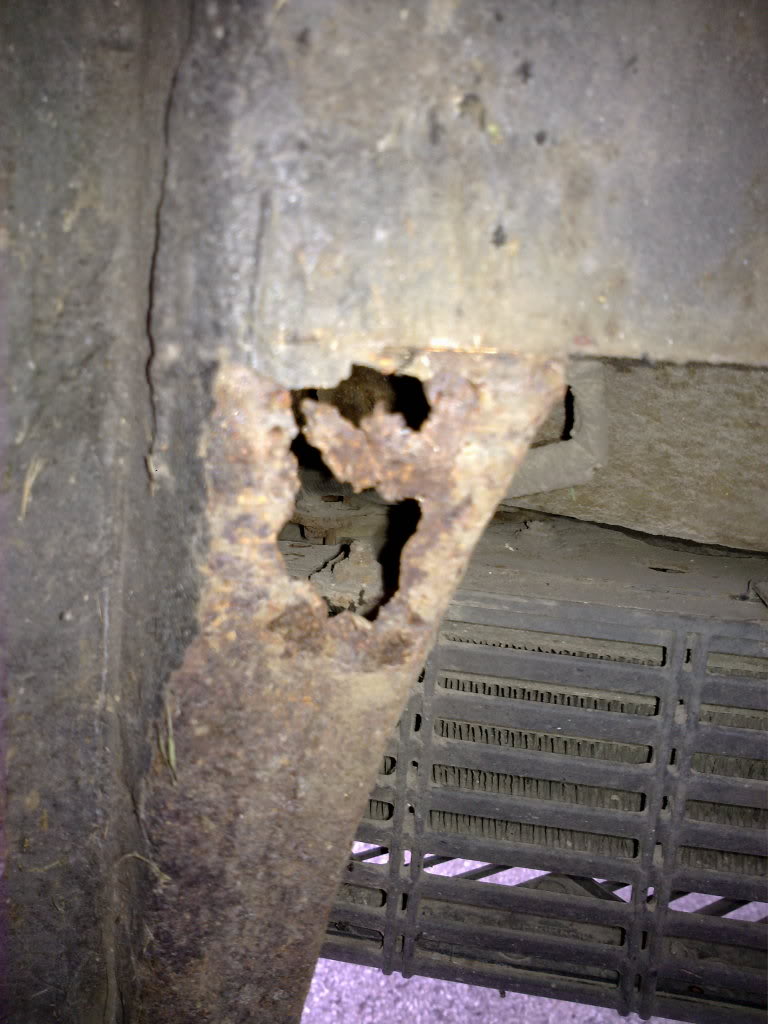

Had a poke around the rear arches to check they were solid and...
FML. Not what I needed when I have no welder or the skills to weld such thin steel. That's really set progress back now.

Mine started going there aswell, luckily i caught it early and sorted it. You taking the arches back to metal?
Well, the problem I have is space. This fucker's so long that when in the garage, it touches the door and my bench at the back, so I can't really work on it in the garage. After the winter to come I was thinking of tearing it apart and going to town on it like Petrol has on SXOC, but need to find somewhere to do it, and obviously need a dirt cheap run around too. I think tomorrow I'll kill the rust with some gel I have, then waxoyl them to s**t and hope that's enough to see it through the winter. Obviously once I get it back on the floor I can get somewhere to weld that patch up for me.

make a template, cut the piece out and just rivvet a new bit in... its not structural...

there isnt much that is lol! i ripped the rear arch off of one of mine... well a bus shelter did lol... back end there is very little holding it together.

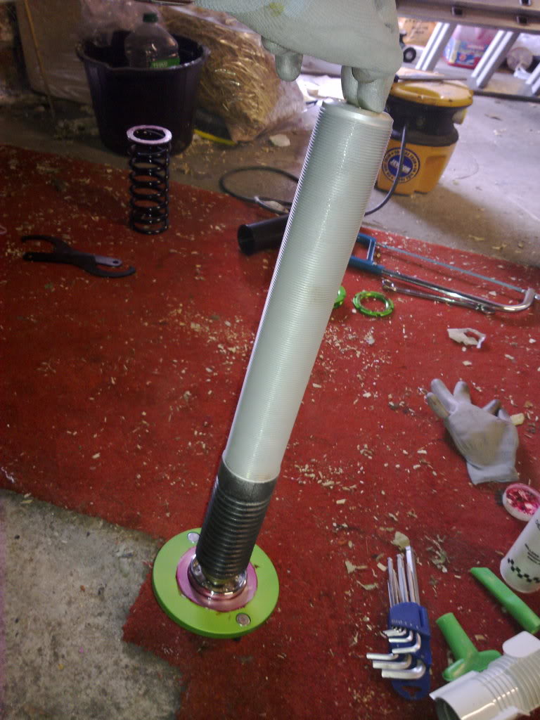

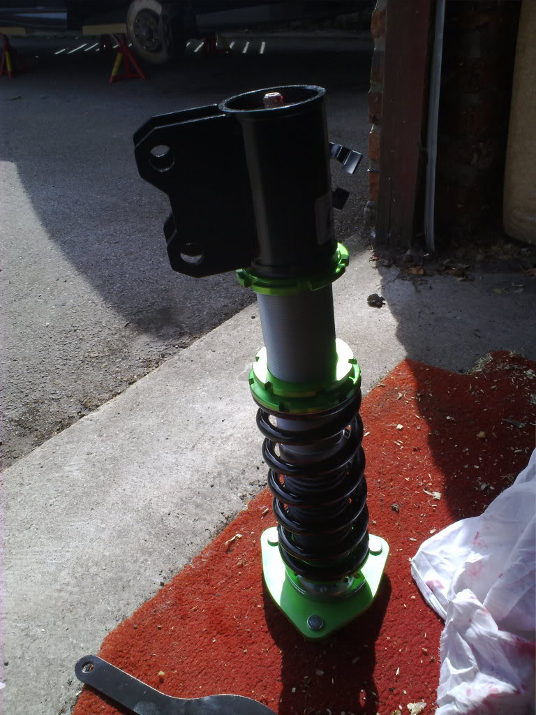

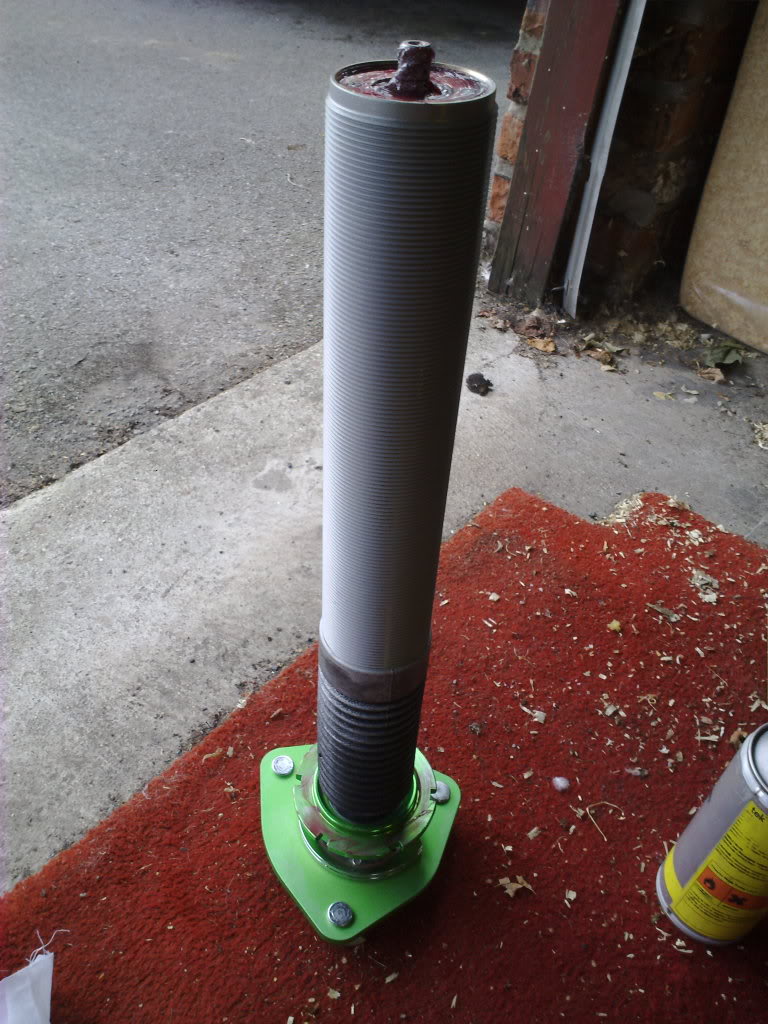

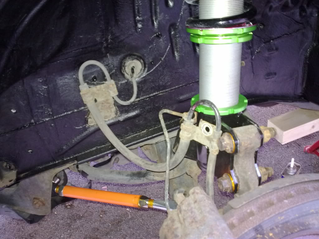

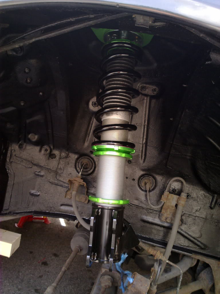

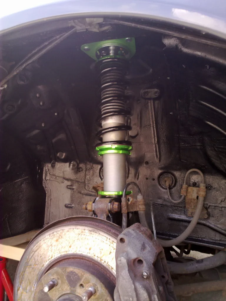

So, I started on the front coilovers. They are supposed to have a very resiliant coating, but a bit of grease can't go amiss. I stripped them down, sprayed an aerosol anti-seize on the body, protected the damping adjusters with a coat of grease, sprayed the pillowball mounts up top with the supplied WURTH aerosol lubricant, and copper slipped the top mount capscrews and the top mount studs.

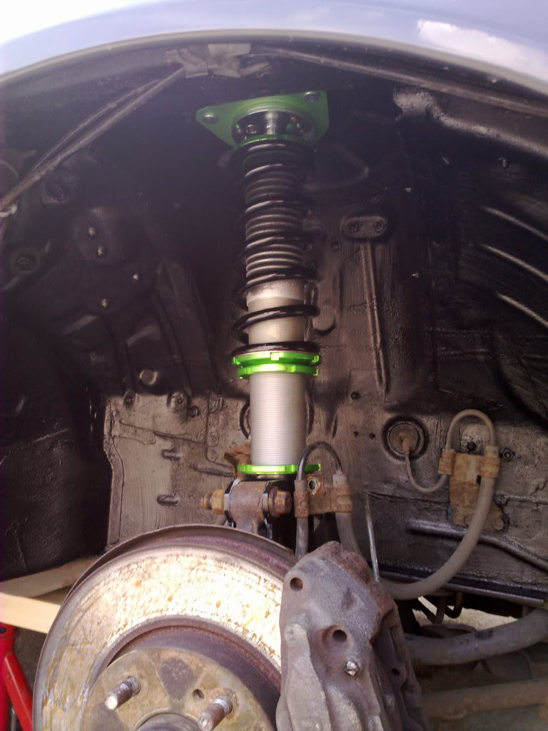

Banged the top in...
Bolted up to the hubs (eagle eyed readers might notice the hub bolts in with the thread pointed towards the cabin, did it to try and keep the threads out of some spray with the arch liners not being there)...
Then did the tension rods...
Moved onto the other side...

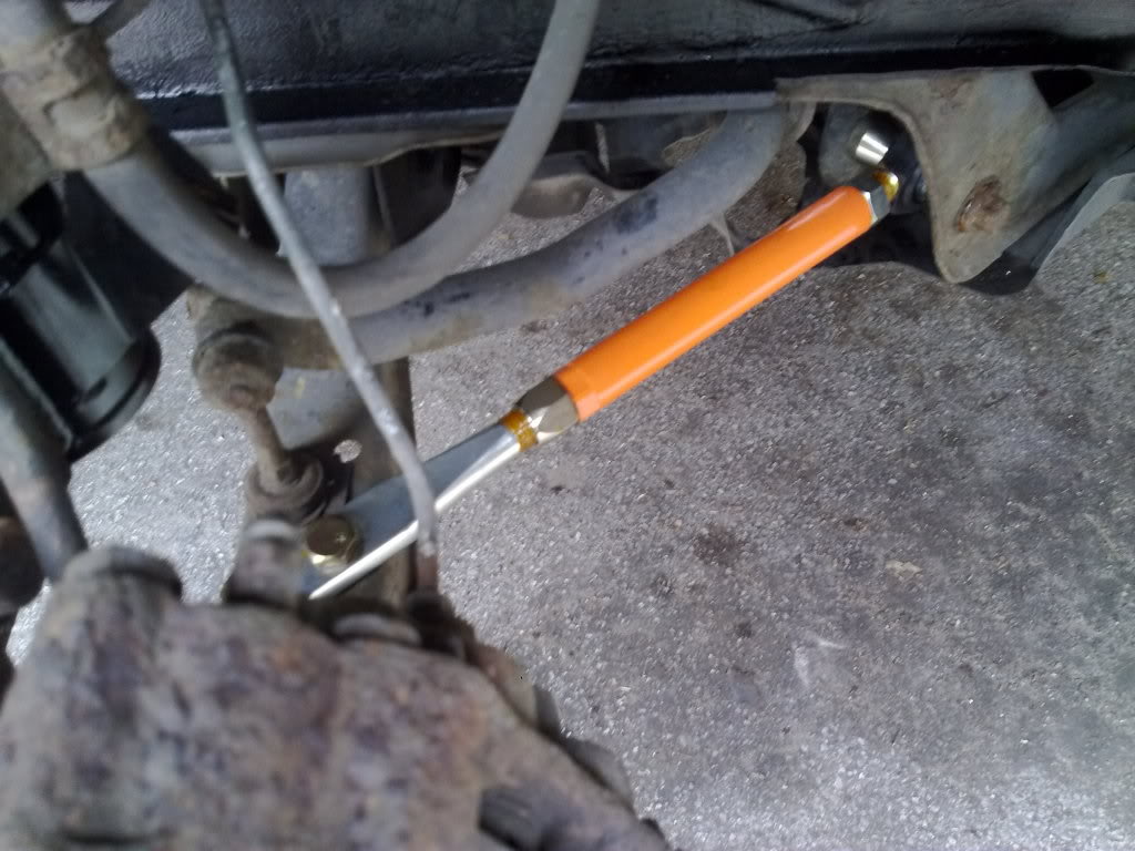

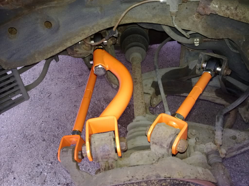

Then did all the Alignment arms on the O/S/R before coming in right before a rain storm...
The weekend brings derusting, zinc primering, waxoyling, arch spraying, the N/S/R alignment arms, subframe collars, and rear coilover struts.

mate 100% respect to you for not going with nasty cheap shitty coilovers! the hsd's are amazing you will love them! and the alignment arms are sexual trust me!
Been an arduous battle with the weather today.
Started off blathering rust with some green rust killing gel. In between doing multiple coats as per the instructions, I got the N/S/R alignment arms done.

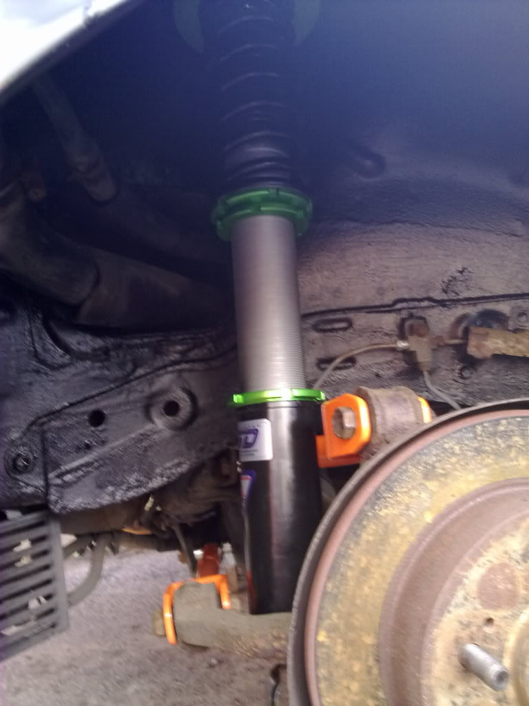

Then I washed the gel out of the arches, let them dry out and cracked on with giving the rear coilovers the treatment I gave the fronts...

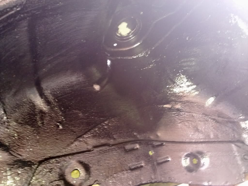

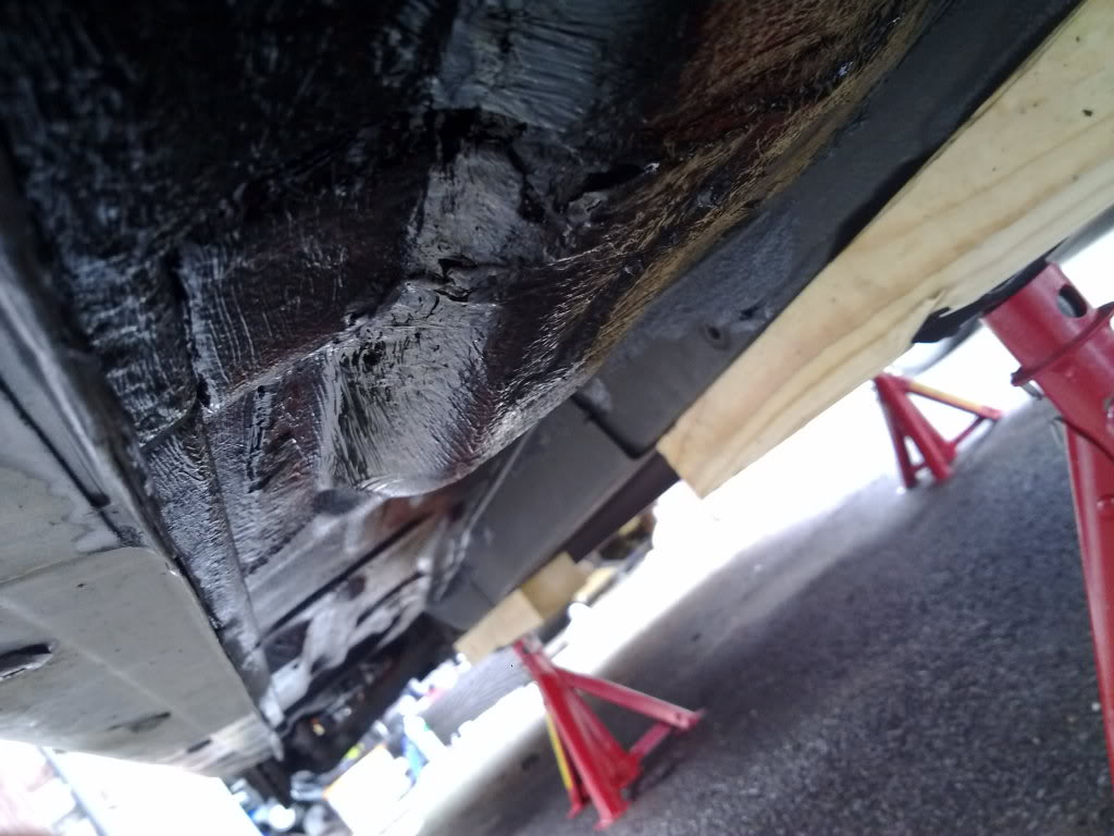

I then zinc primered the arches, and not long after the bloody heavens opened up. Waited for that to stop, and carried on. Whilst waiting for that to dry, I got round to putting a spark plug cover on now I'd found some M5 capscrews...
Then it rained again. It stopped, so I waxoyl'd the arches and chassis between the sill and rails...

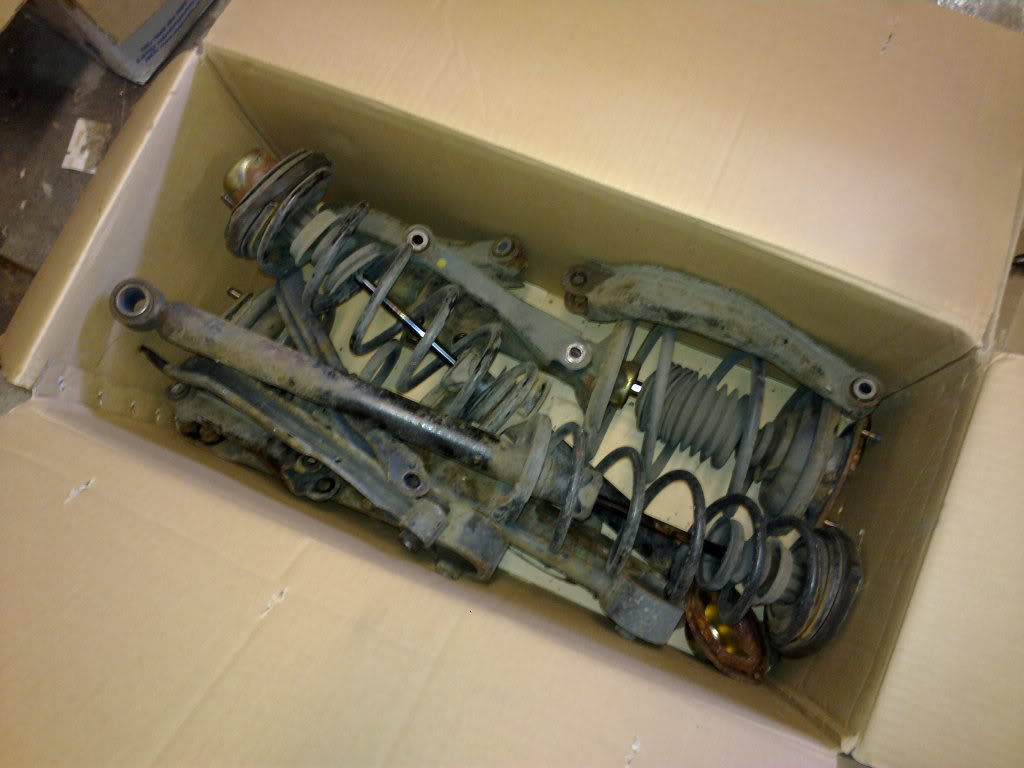

Then the final job for today, sling all the OEM stuff into a box :D
So I've got the subframe collars to do, rear struts to fit, then got to play around with the ride height & torque everything up.

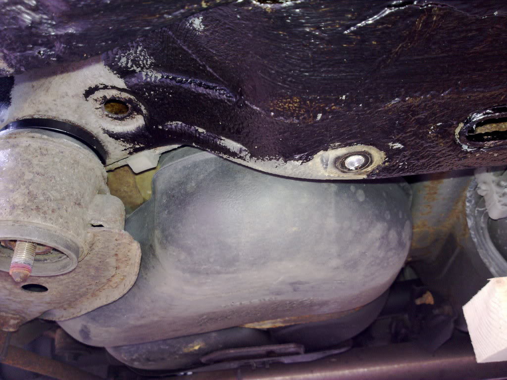

Started the day with the subframe collars. Got them all loose bar the little arms, when...
Each side furthest in sheared, so they had to be drilled & retapped.

Then got the struts in.

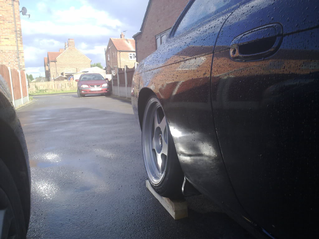

^^^ That's the rear clearance in the air lol.
Sat it down...

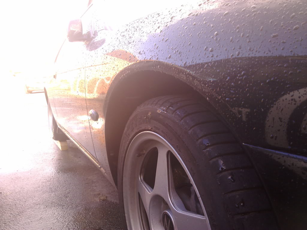

Rear - You may notice the subtle stretch on the rears 225/40/17 on a 9J.
Front. Needs new tyres to be fitted, which I have waiting.

holy s**t you could put 40mm spacers on the rear lol!
when i saw your first pic... i thought i had jinxed you lol!
you prob wont notice it because you did it all at once, but when i did collars i i got pissed because made my seat feel like it was at an angle lol! got used to it though :) good work mate!
do me a massssive favour take a pic straight on to your rear wheel so i can see the full tyre and profile... im still undecided... from that angle it looks nice but im still considering 215's or poss 205's lol
