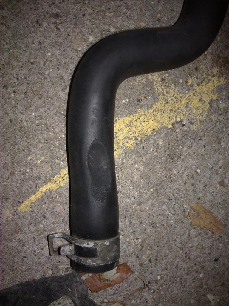

Found my breather hose to the turbo to be in bad shape due to being so close to the exhaust manifold, so had to get myself another one...

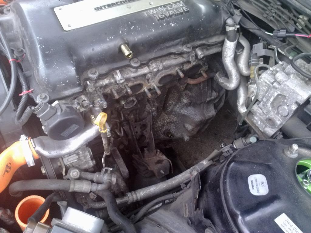

Got on with getting the exhaust from the downpipe back off...

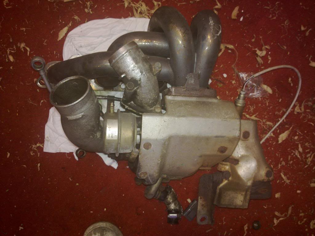

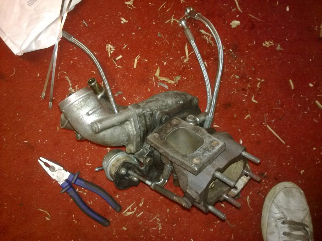

Then I was able to pull the turbo/manifold & elbow out in one lump...

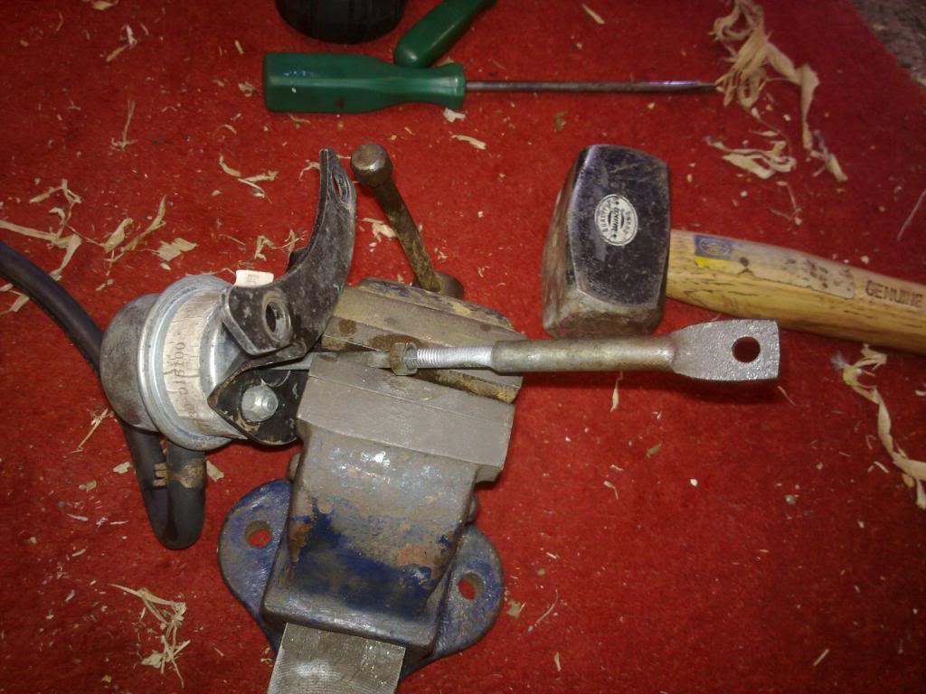

Got that apart, so cracked on with the wastegate actuator (made sure it was nice and free & anti-seized up)...
Then turbo lines...

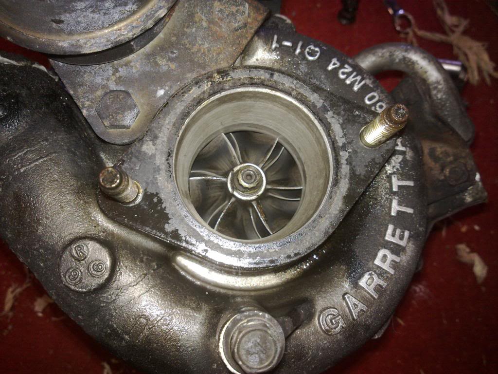

Compressor Wheel doesn't look in bad shape, play wasn't too bad either...

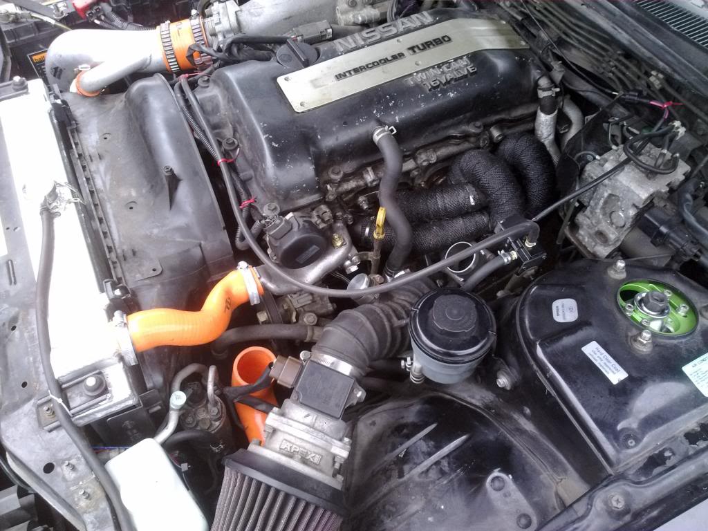

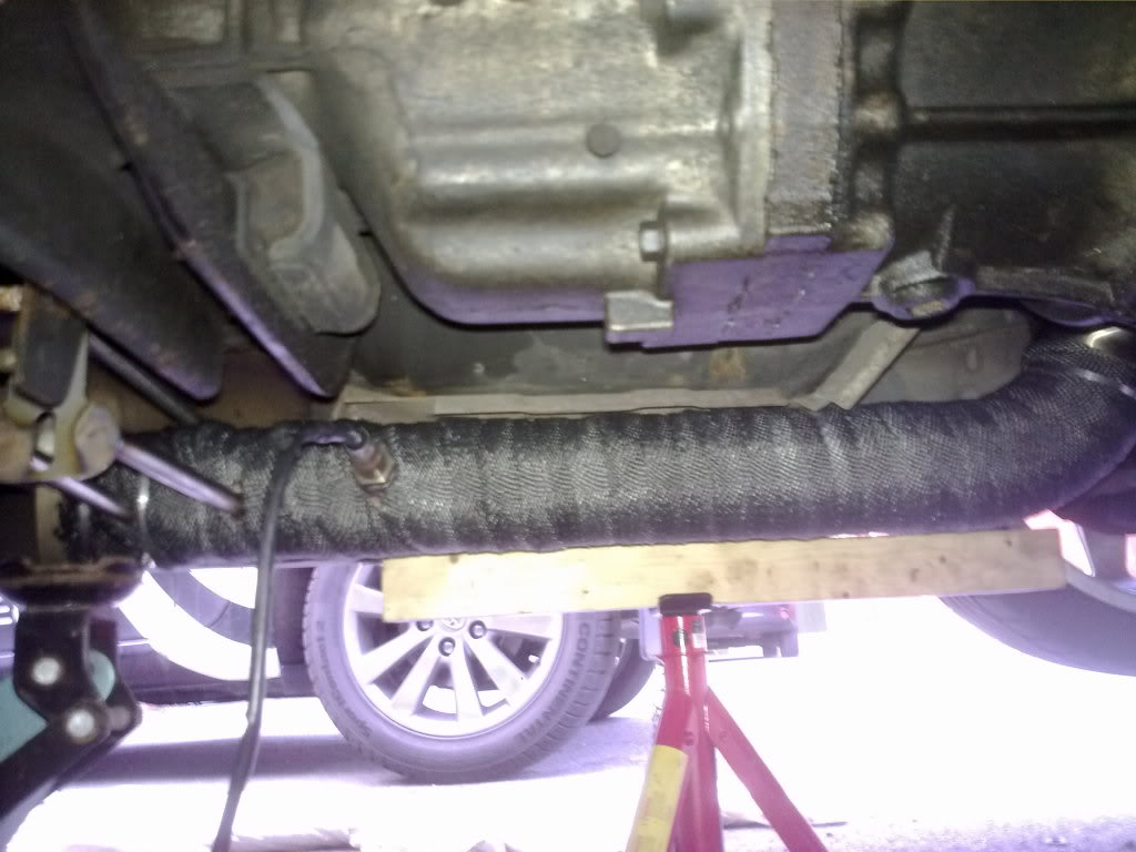

Wrapped the manifold up (absolute horrendous task, never doing that again), and attached it to the turbo with the new gasket. Then put it back on...

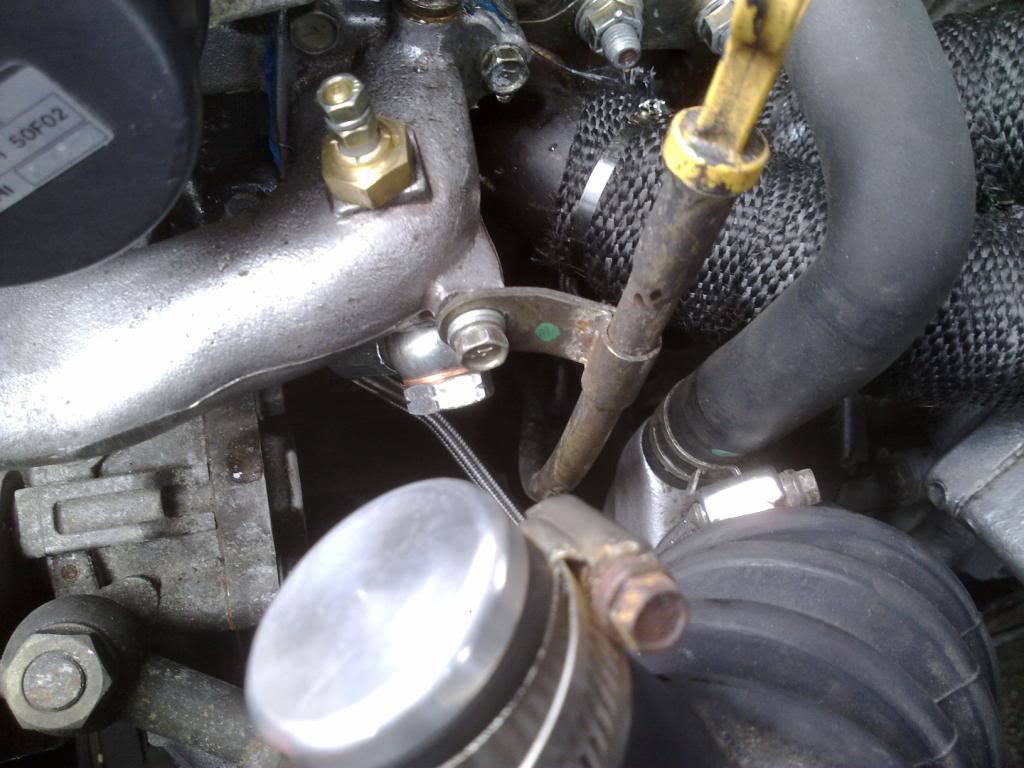

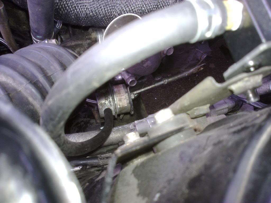

Wastegate actuator left with the shield off, so it can be adjusted...
And a sneaky braided line...

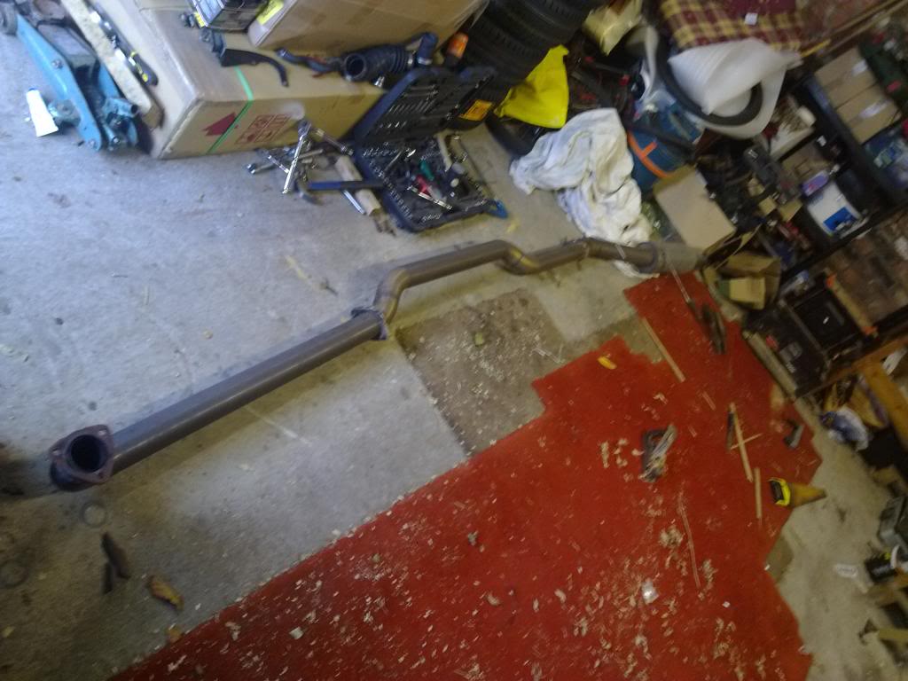

Got the rest of the exhaust to fit, downipe will be the hardest part of that, then bleed her up and get it running for a run up to Knockhill next weekend for the BDC.

i would of put the downpipe on to the turbo then fitted it all in one go to save an arse ache.... i threaded my oil feed on the block... i had to get it to a garage and have the block tapped and helicoiled with the engine in place... cost me 400 quid :/ the stock turbo is pretty strong on them... get a gtir rear housing its a bigger a/r and is more fun :D if you do upgrade the turbo... i would seriously consider the holset hx30 or 35 if your wanting a bucket load of power in the sr... but the 30 is a good upgrade! and cheap too! just block up the water ways with bolts on the block i actually ran my stock turbo with no water pipes for a while i saw no massive issue with it...
oh if you do the downpipe the way it is... trust me on this wear goggles lol... i ended up in hospital when i did that, little bit of metal dropped in my eye and hurt soooo much :( also get yourself a catch can... the stock breather scares me... oil vapour in a hose that close to a mani is just asking for a fire :( seen soooo many with melted and holed hoses on tubi mani's but you will notice a massive heat difference now you have wrapped... though first time you run it... expect alot of smoke and dont panic lol!
I wasn't sure the downpipe would fit through from above so didn't want to risk it. I will eventually get a catch can, but for now a new hose is better than the one I took off. I'm used to the heatwrap smoke, seen it before lol.

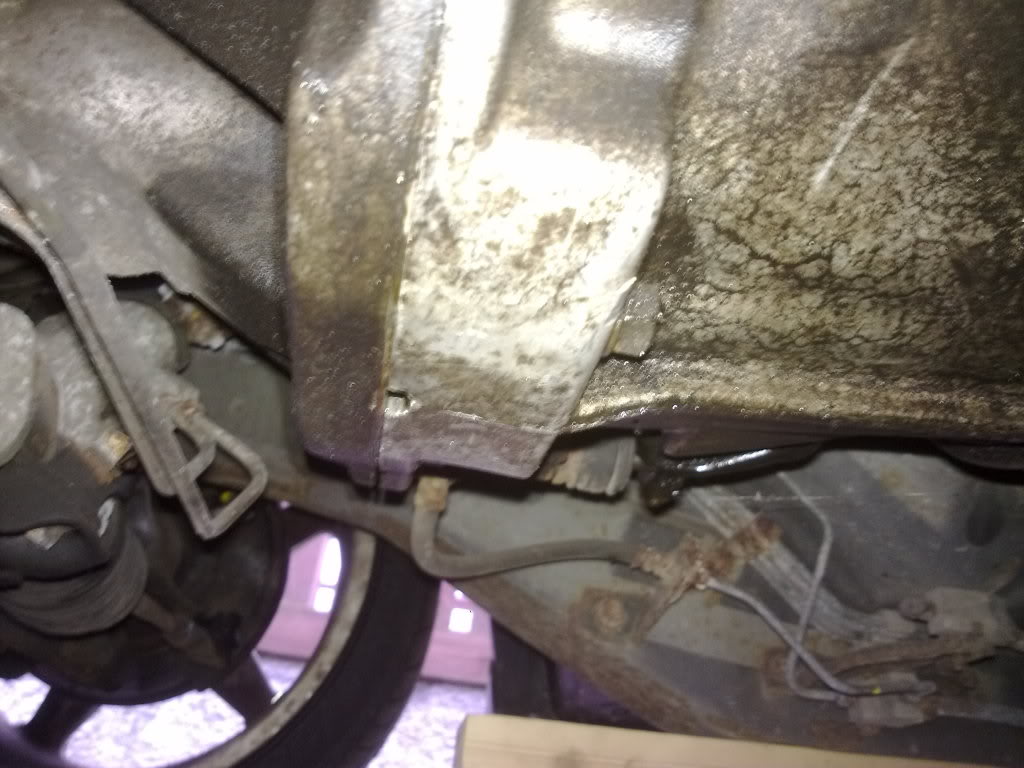

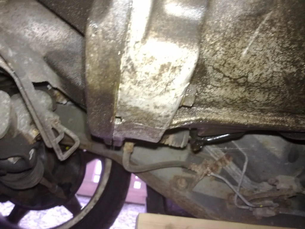

Knew my gearbox had an oil drip, but didn't know it has this hole in it. Guess somebody knocked that hole in to keep oil off the clutch, must be a leaky input seal :(

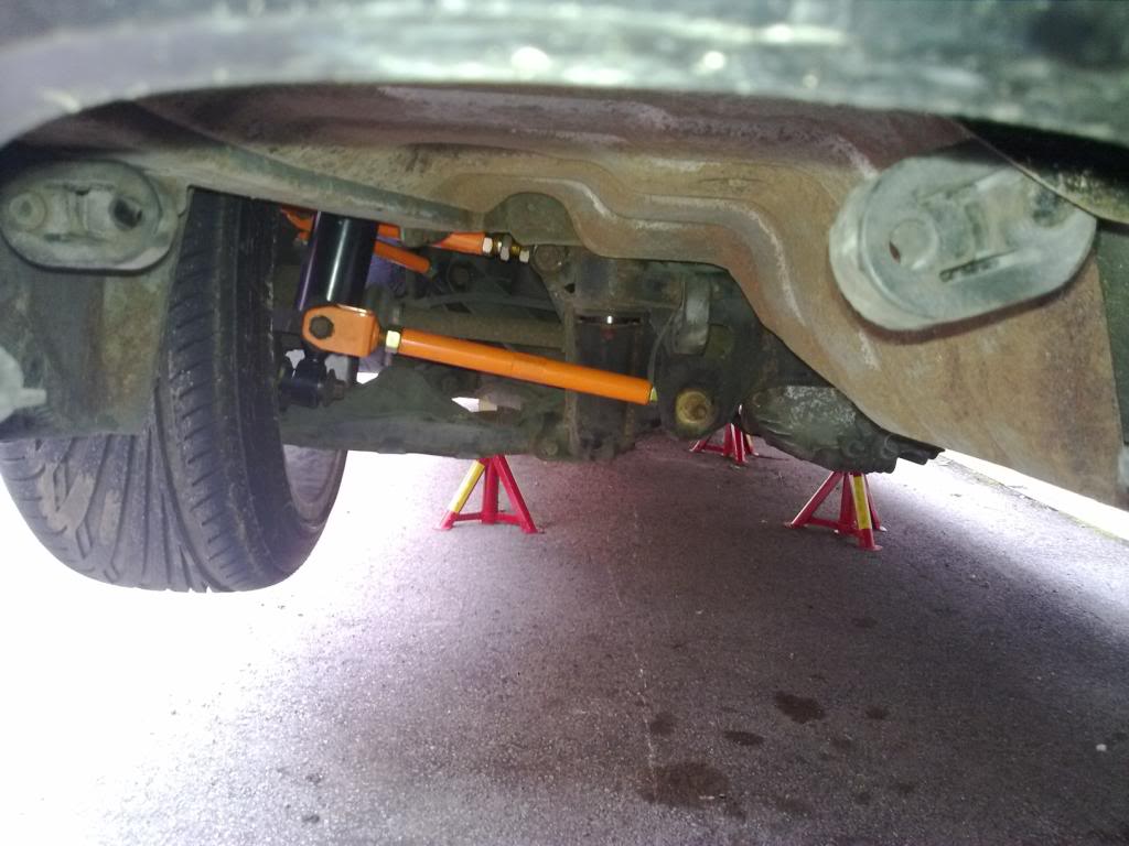

Rest of the exhaust is dangling on, and I've got myself a nice shoe shaped dent in the rear quarter, lost my rag big time :(. Good job the bodywork is so s**t really, just got to gain access to push it back out.
Bolting the exhaust up on the floor worked, seemed because the downpipe is literally touching the heatshield it was causing difficulties.

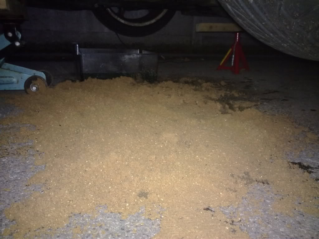

So, Horsham Developments got me a new Lambda sensor here within 24hours, so banged that on, fitted the remainder of the boost pipes. Fired it up, sounded a lot quieter and no leaking exhaust. Then heard a loud trickle. Then saw a large pool of oil. s**t!!!!! Turned the car off, chucked some sand underneath then investigated.
Now, when Hose Solutions sent me the braided hoses, one of the oil feed copper washers didn't fit. So I re-used an old one. And that was the culprit, so I'll have to get some new copper washers.

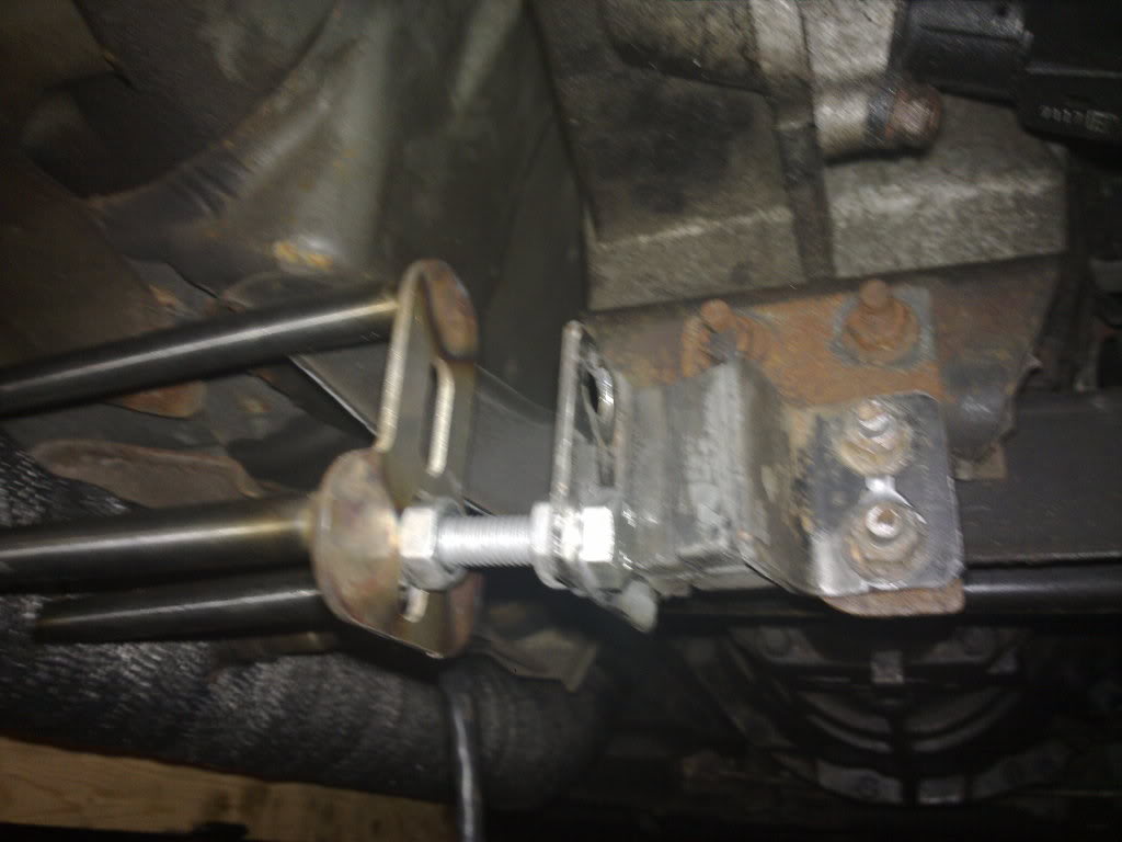

Also made a start on an exhaust to gearbox mount...
Will consist of 2 M10 bolts and 6 nuts tomorrow lol.

Not very impressed with the centre silencer ground clearance, so I need to look at that.
  Mustang, S13, AX GT
I think a big problem with the S bodies is the exhausts hanging down tbh, A lot of the cars I've seen the exhausts are hanging down quite a bit below the floor of the car and mines the same. Maybe you could try and knock up another mount?
