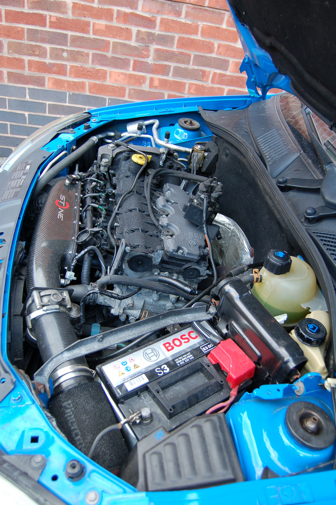

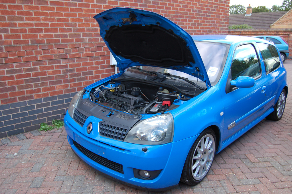

Well, the swap over has started a bit more than just the wheels now.
Swapped the complete front uprights complete with brakes/shocks/springs all in place as the 172 had everything new including wheel bearings.
Swapped rear shocks and springs.

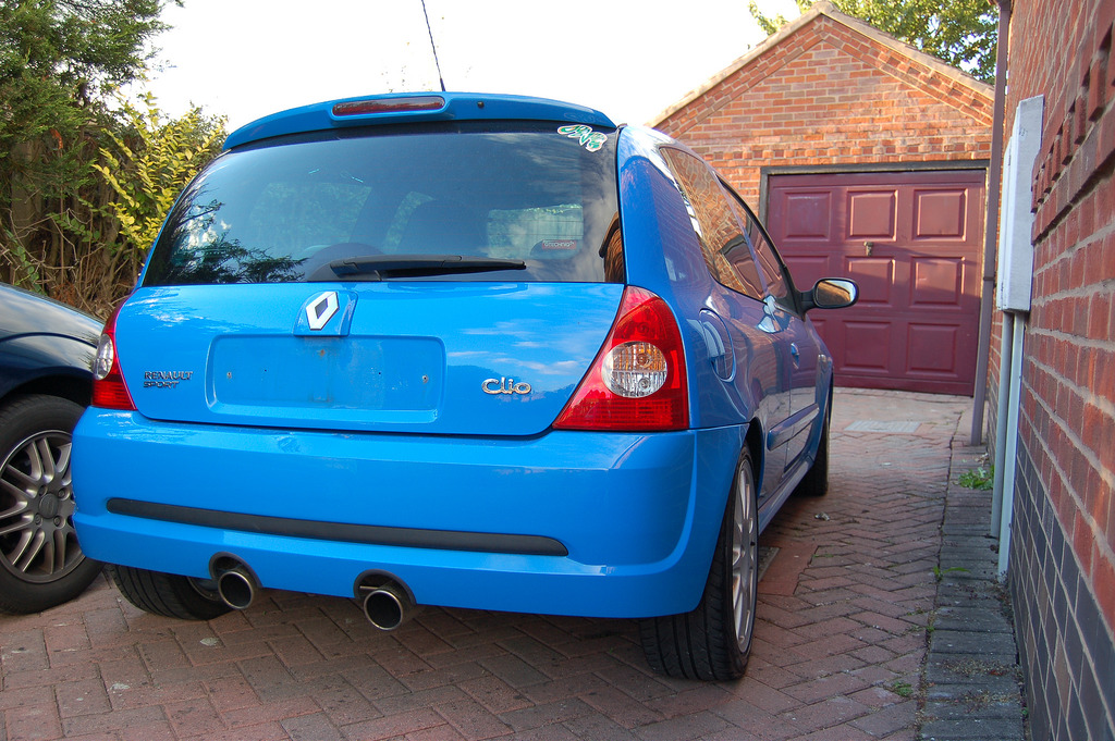

Fitted an rs192 exhaust, really nice and easy to fit and looks quite nice in the cutouts.
The list of things to do before Llandow is now pleasantly short which is good as got almost no free time before then.

Then after Llandow will swap the rs2 on then get it down to Mwm for his latest cam timing tweaks and then I will remap it.
Not going to bother swapping in the ARP and supertechs engine just yet as may as well get some use out of the one that's in it first.
Will swap that when either it needs a clutch or box or engine.

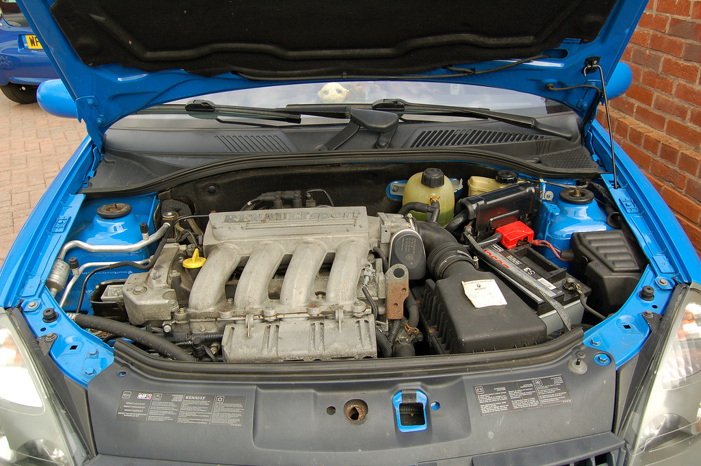

What does RS2 mean? Different engine?
Different inlet manifold mate.
Bit like throttle bodies but designed to work with a shared plenum and standard body so you can retain cruise control etc.
Keep an eye out for cat-centre section joint blows. The female side doesn't quite curve round enough!
I assembled with a fair amount of sealant and an uprated clamp and seems ok so far but will keep an eye out. Can always chop it off and weld on a new flange if its a problem. Made the exhaust on the last car anyway so used to doing stuff like that.
Ah, I see!
Where can I read up on these? I thought it was an Audi Engine :P
Edit: JMS RS2 Inlet Manifold??
Whatever you think of the term "fast road" it really is the perfect fast road engine mod.
More low down torque, more power everywhere, zero drawbacks. So much nicer to live with on a daily basis.
I'll say! I ended up getting called 'the cat' because of the amount of time I spent under the bean resealing the fcuker!
​Lost patience and had it welded!
Otherwise, I got on rather well with the RS192 :)

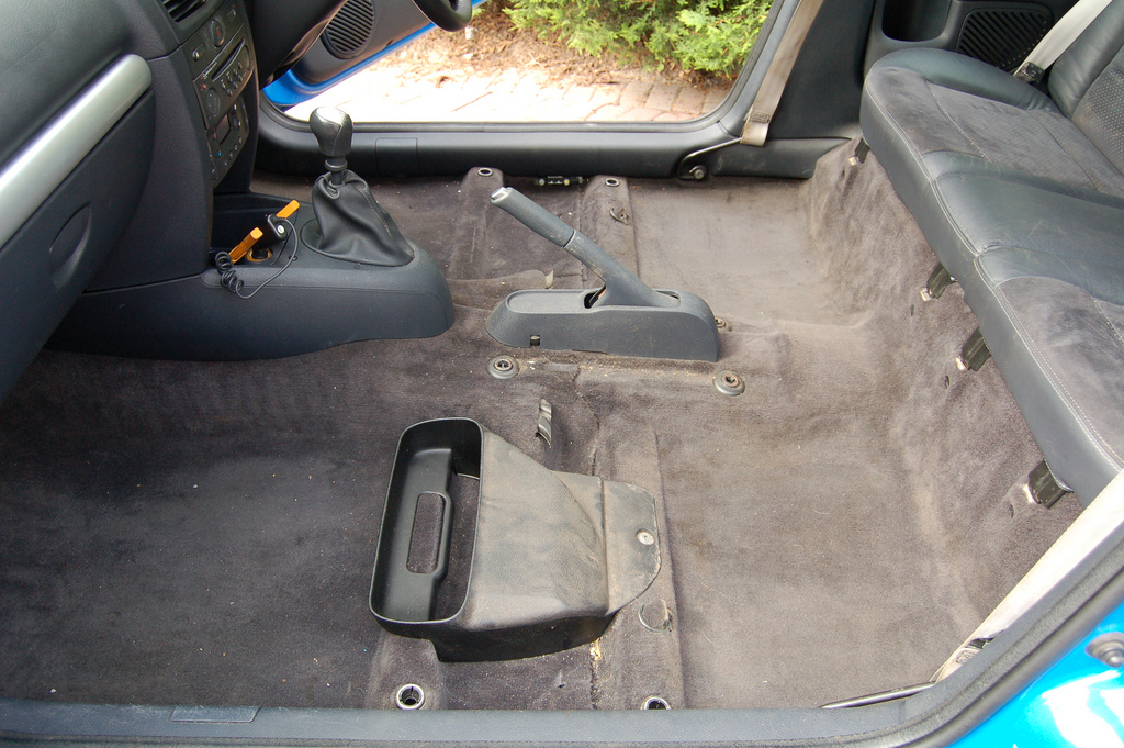

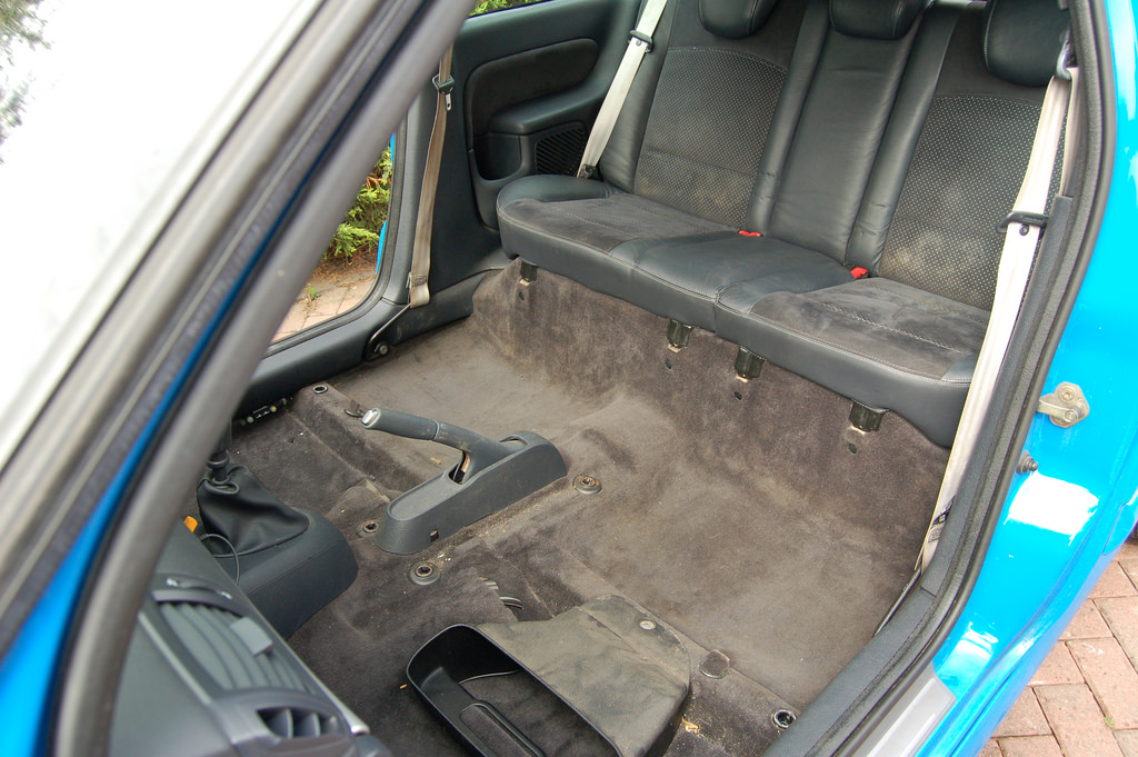

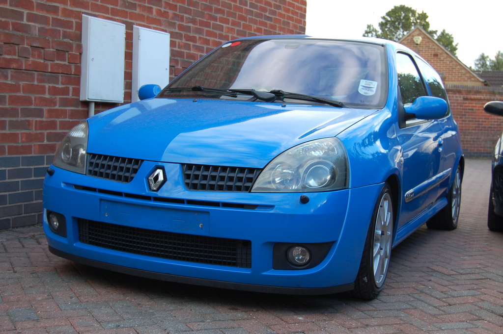

Did a few more bits to the new car today.

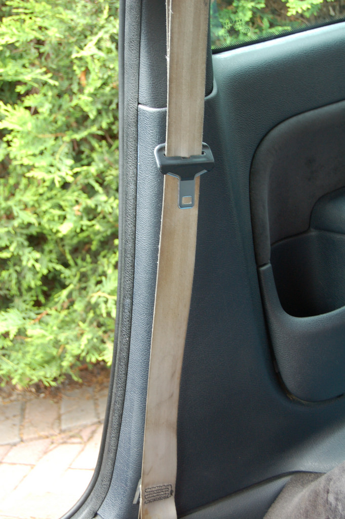

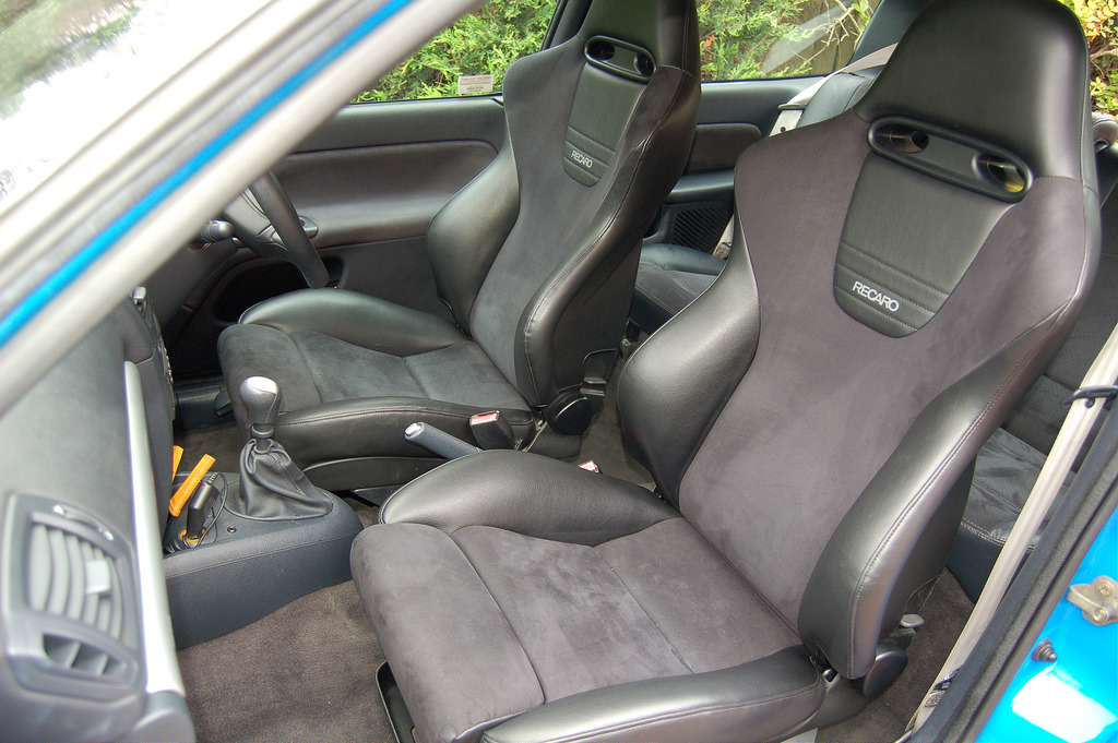

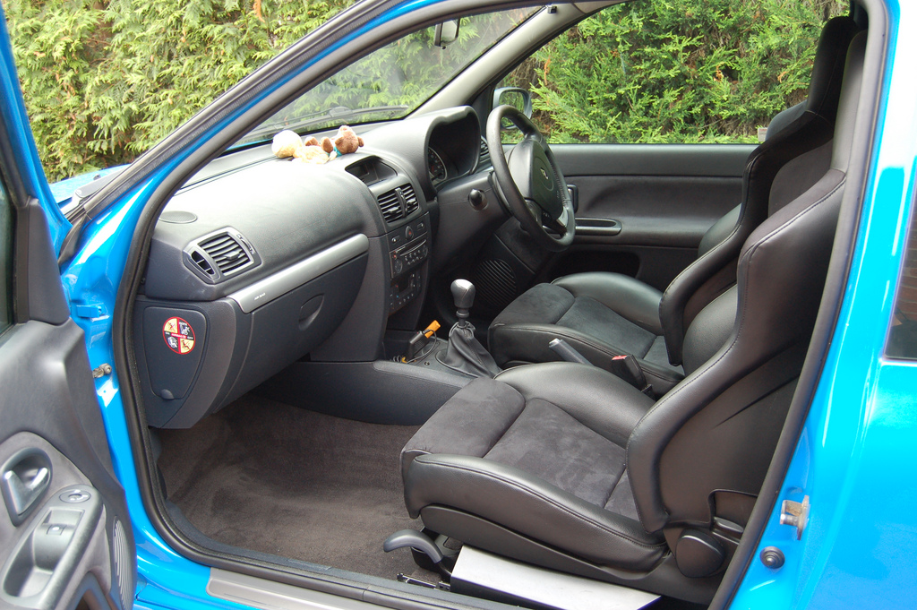

Swapped the Recaro trendlines from the black one to the blue one, and gave the carpet a good clean ( was proper filthy, dog hairs and maccy d's chips lol! )
Gave the seats a quick going over with alcantara & leather cleaner too.
The seatbelts are really dirty :( had a quick go with some apc and interior cleaner, got a bit better. guess its just gonna need alot of scrubbing and time!
Chip swapped the polyflex'd dogbone over from the black one whilst it was in the air.
just need to find somewhere to get it tracked tomorrow
some interior before & afters

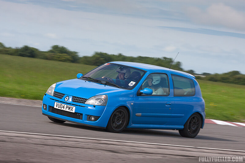

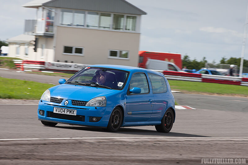

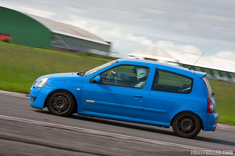

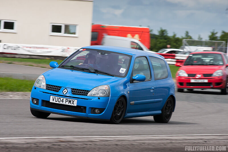

We did Llandow for the burpspeed day yesterday, hopefully some other people got pics too, this one courtesy of sharky.
Had a good day and the car is handling great now that I've swapped the suspension off the black one onto it.
Noticed the difference in pace though compared to the black one when racing the Williams trophy yesterday, as in the black one I could keep with them on the straights (theirs is standard engine but stripped and no aircon etc so a lot lighter) but in this car they were visibly quicker, so hopefully once the rs2 is on we will be back to a good match despite ours being full road weight still like the black one was.
Still had a good little battle though even if this time its me being followed on the video while they shout abuse at me into the camera for holding them up not the other way around like I did to them at Combe as is out traditional banter when out with each other. FLOL. So hopefully they will upload that at some point.
Got stopped short by about an hour by a noise that I thought at first was a front wheel bearing but on the way home last night it became apparent it was the rear one. They were changed with gen Renault ones just before we got the car so might be some stub axle damage so will strip that all off the black one to swap over as well.

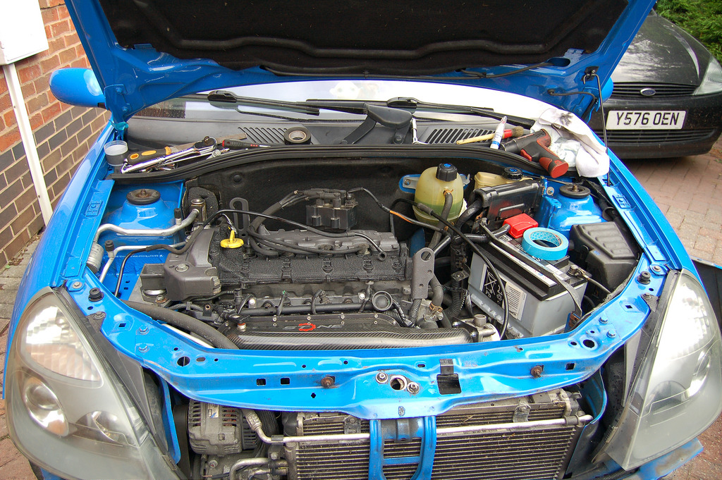

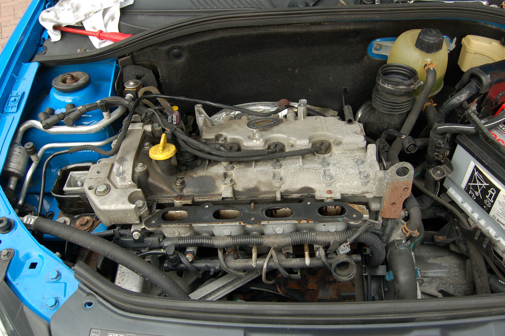

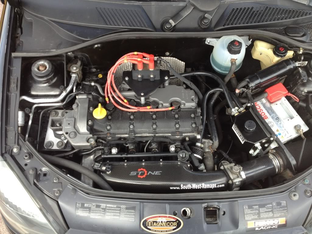

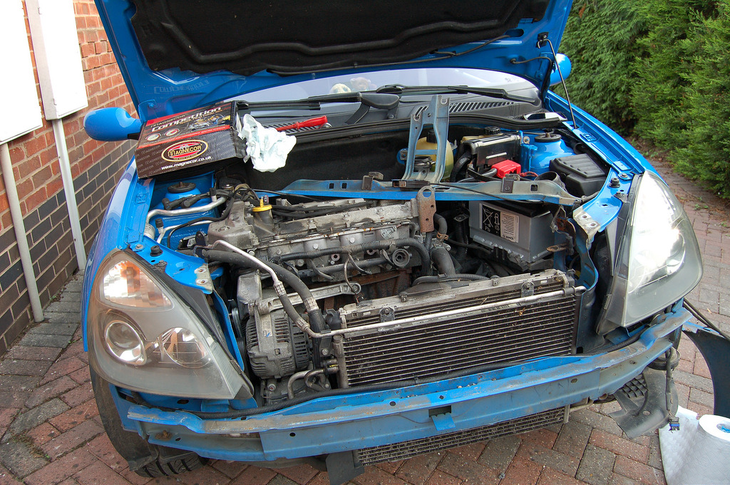

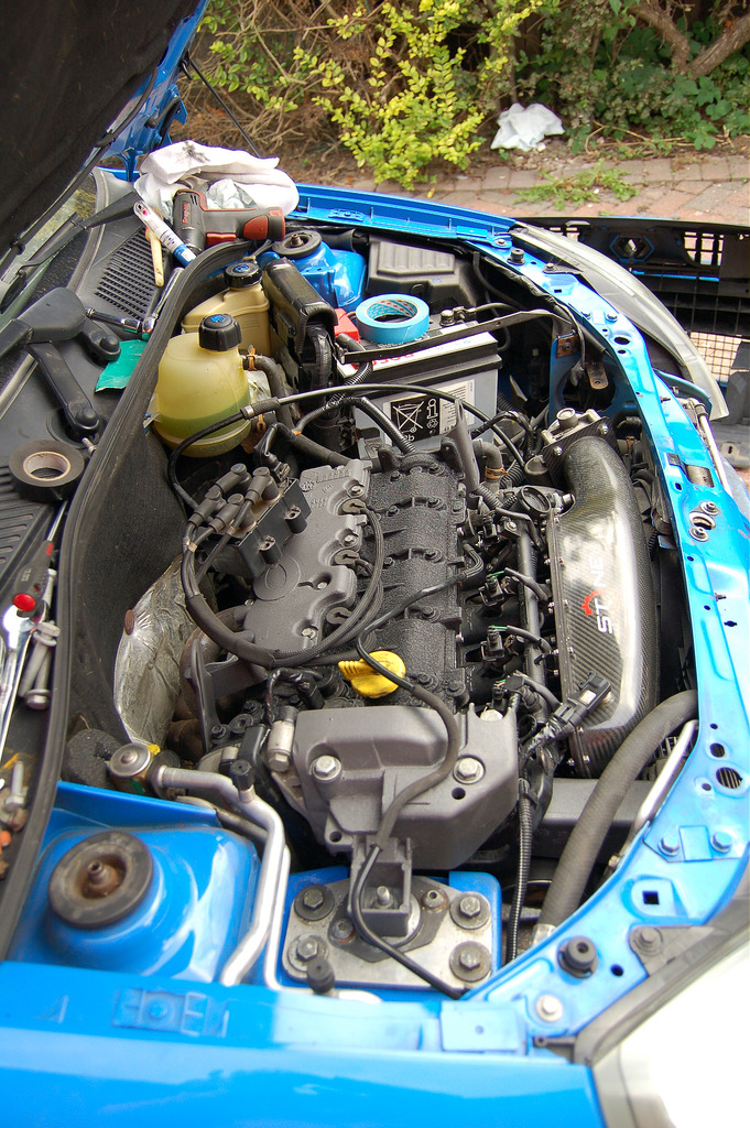

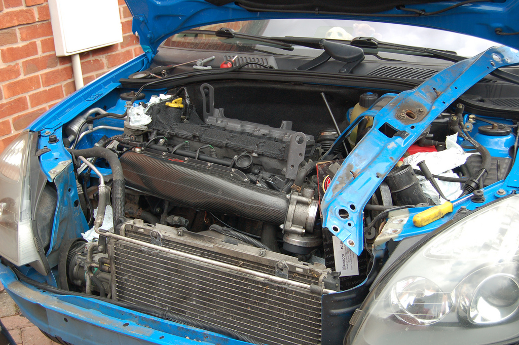

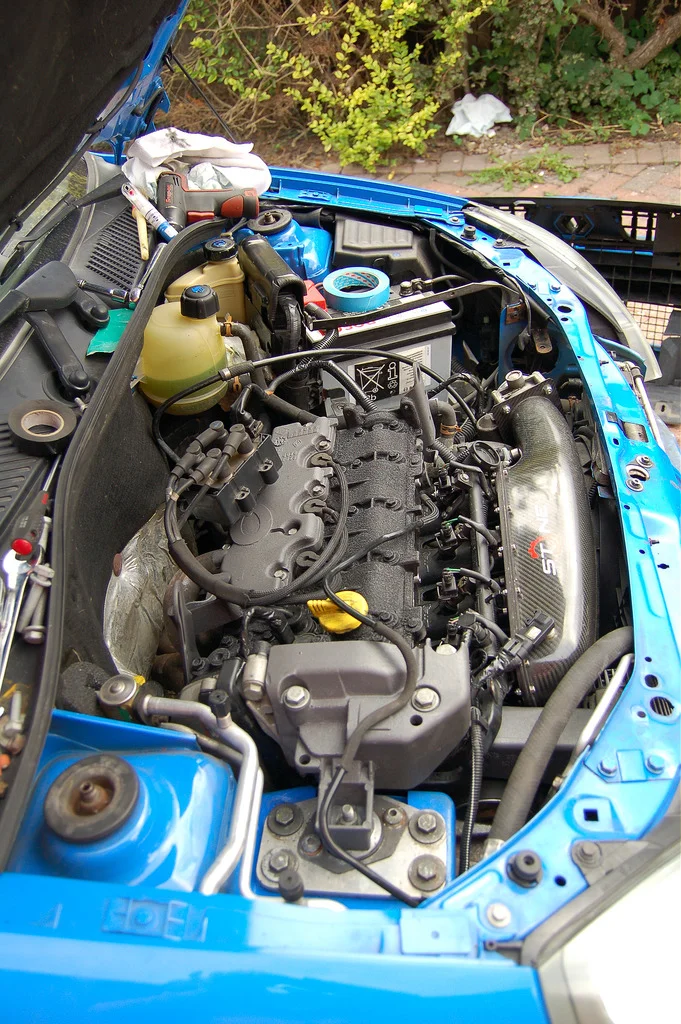

it was time to take the RS2 off the black 172 and put it on the 182 :D
whilst it was off i painted the cam cover & a few other bits to tidy it all up a bit. Just need to get a 182 RS2 coilpack mount as its only held on with 1 bolt at the moment.
took the standard plates off to put my old reg from the black one on when i've got some sticky pads to put it on with.
