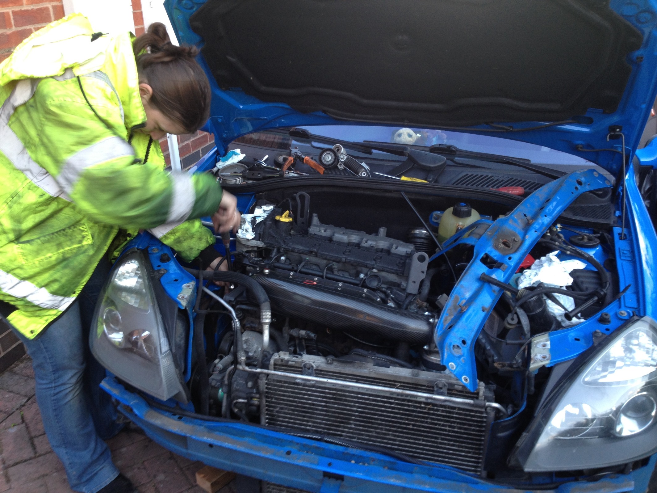

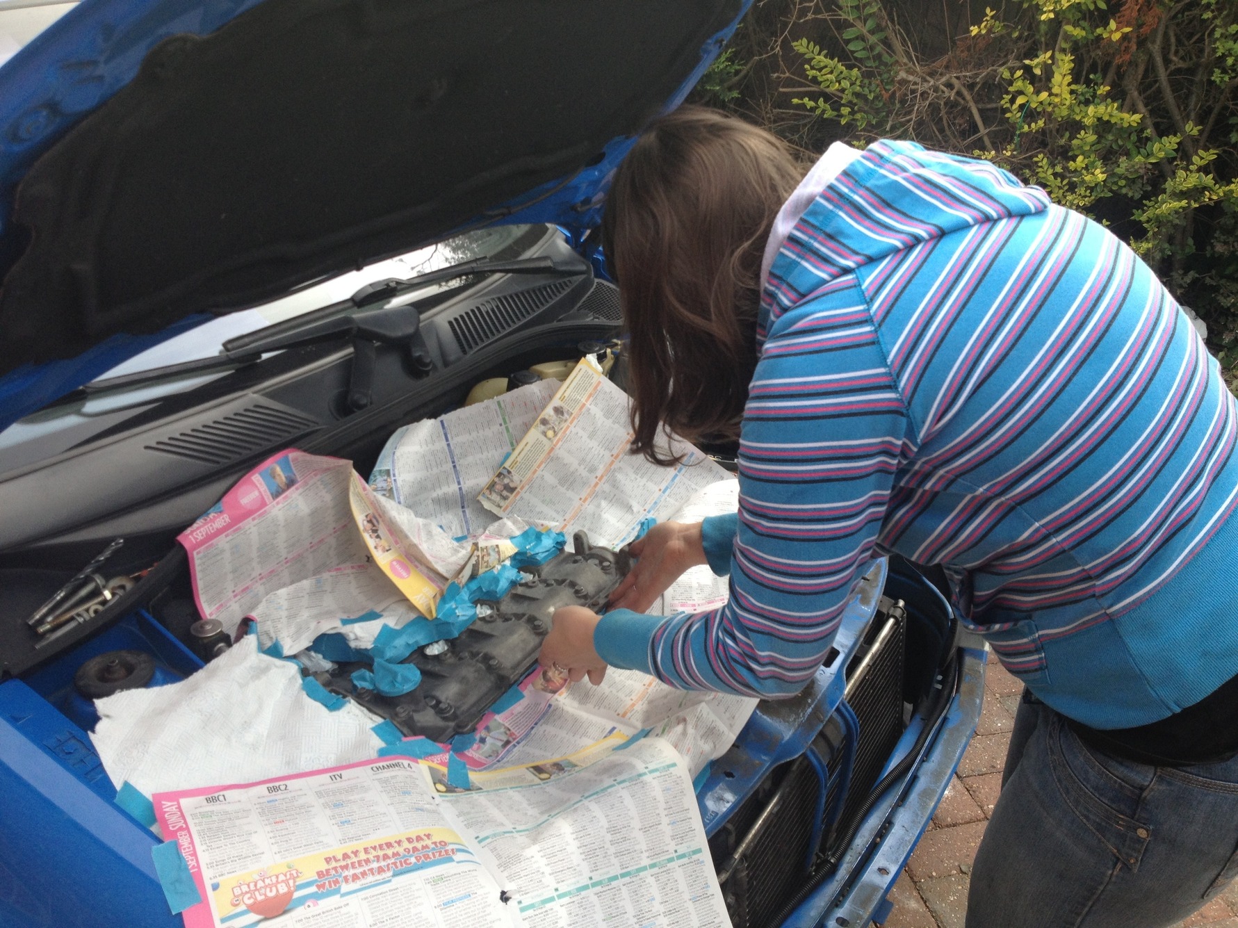

Few pics I took when I wandered out to see out she was getting on.
Masking off the cam cover to paint
Getting RS2 on it
Finishing off by putting bumper back on with a replacement arch liner on the drivers side as it was knackered
Mostly went quite smoothly other than the fact that some numpty had tack welded the old engine top mount on as the captive nuts had spun, so les had to grind it off and then I had to weld in a new section I made up with new captive nuts on it.

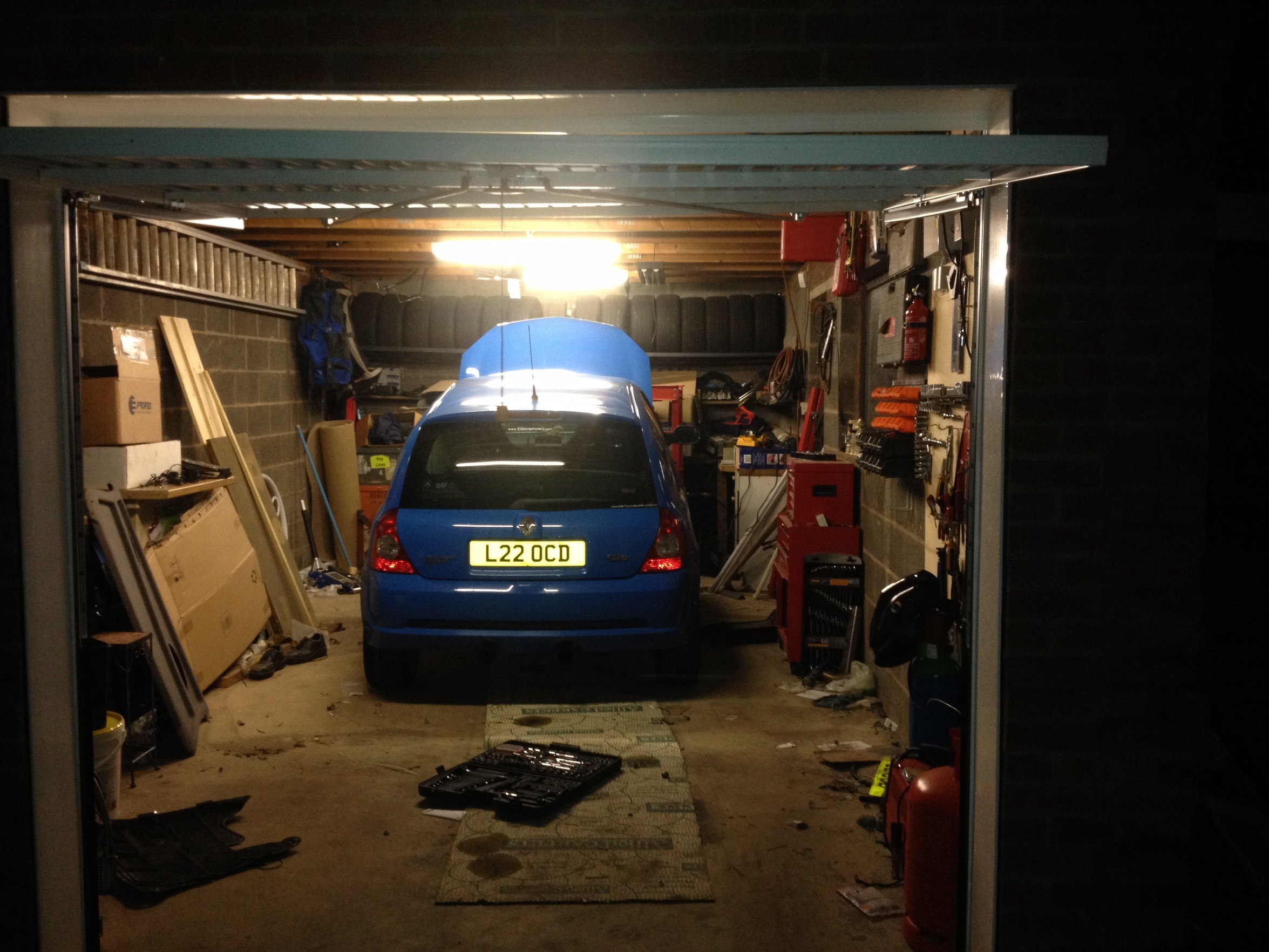

Didnt really get any WIP pictures, other than just this one I grabbed as I was about to let it back down off the jack after I did the rack bushes.
Please excuse the state of the garage, we're just finishing off the small workshop next door to it and got junk piled up everywhere till thats finished!
  182/RS2/ Turbo/Mk1
Nice sized garage.
Thanks mate :)
For a single its a really generous size, its about way longer and about 2/3rds as wide as our other which is a double one (sadly thats not all mine though, the double one I have to share with my dad who lives next door, the double is actually meant to be his but luckily he lets me keep one car in it!)
My single one is *JUST* 2 clios wide, if it was literally touching wing mirrors, and its *JUST* 2 clios long if they were touching bumpers, so basically no chance of ever getting two cars actually in there at once, but it means plenty of room to get right round a car no problem, or rather it will have when I get rid of a lot of the junk thats in there!

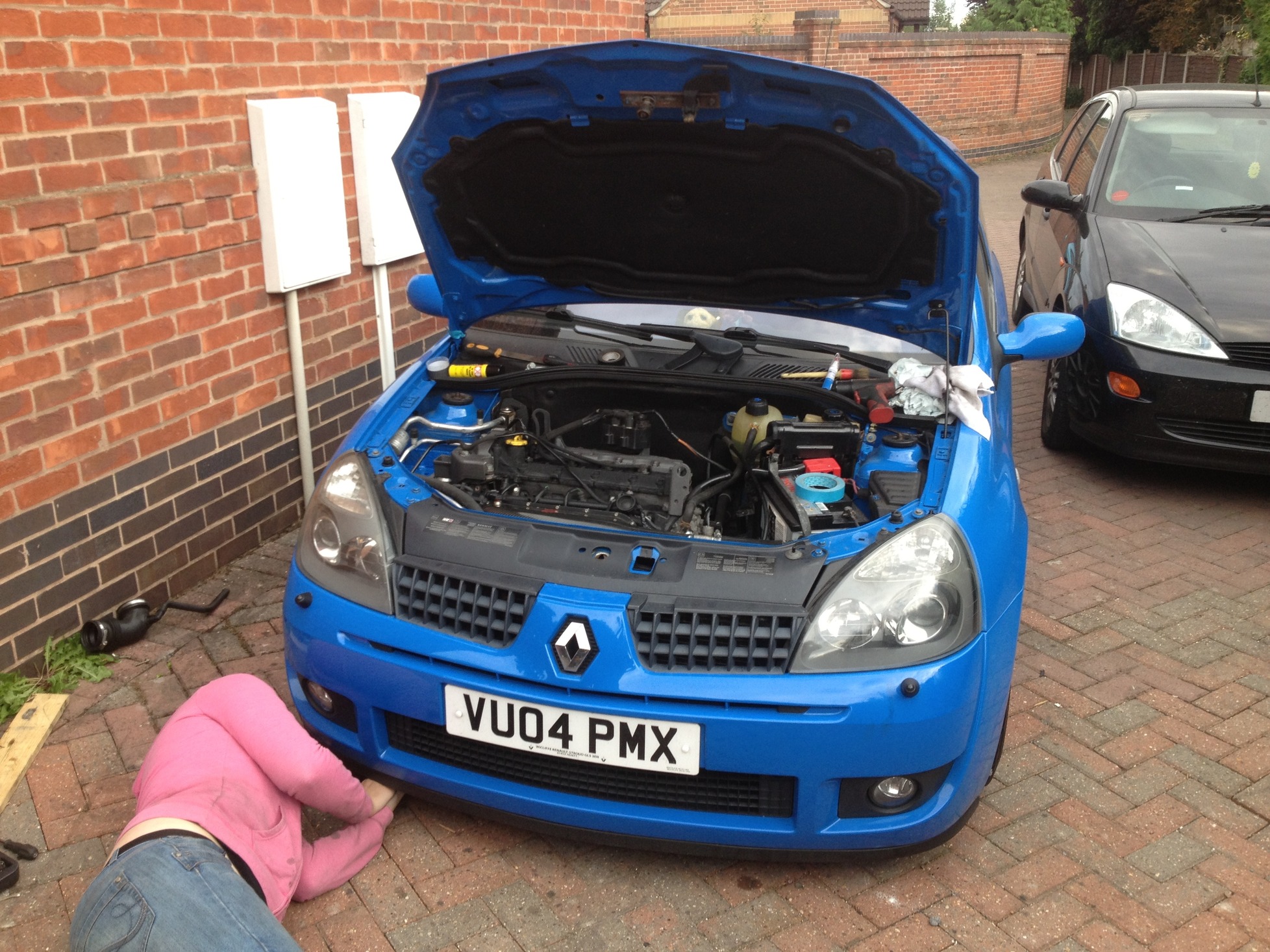

I'll give anything a go, its my power station "engineering" background don't you know ;) Only thing that worries me is timing, had an issue with a Mk4 escort many years ago and never done timing since. So when get the Ph1 back here and I'm doing the dephaser & cam belt I might need a bit of guidance/moral support!!
  182/RS2/ Turbo/Mk1
Let me know if you want to borrow the timing tools, ive got a genuine set sat here you can grab if you need them.

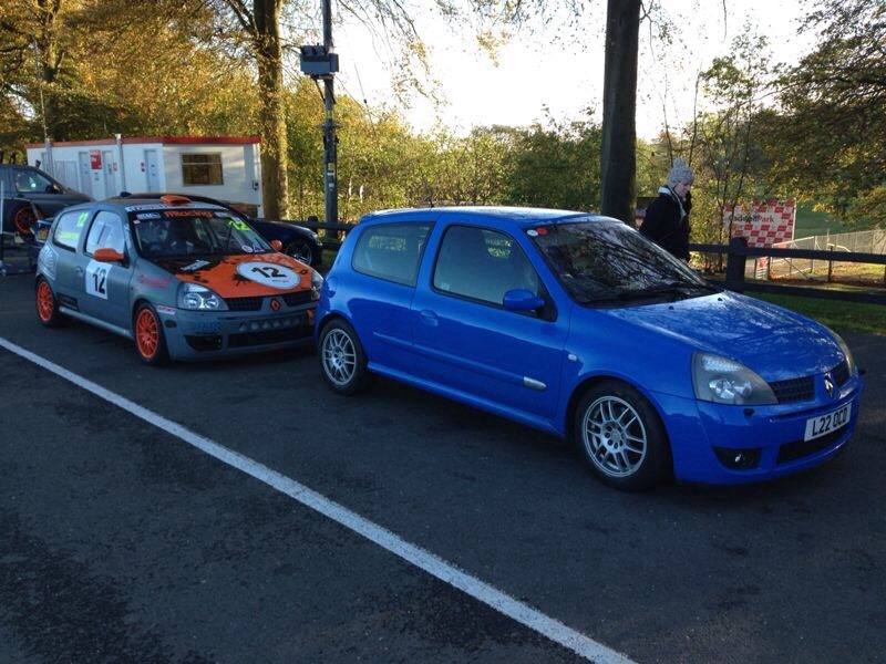

  182/RS2/ Turbo/Mk1
Picture James got of his racer with the RB.
Two very different cars from the same starting point.
Huge difference in spec and pace, but still both great fun at a track.

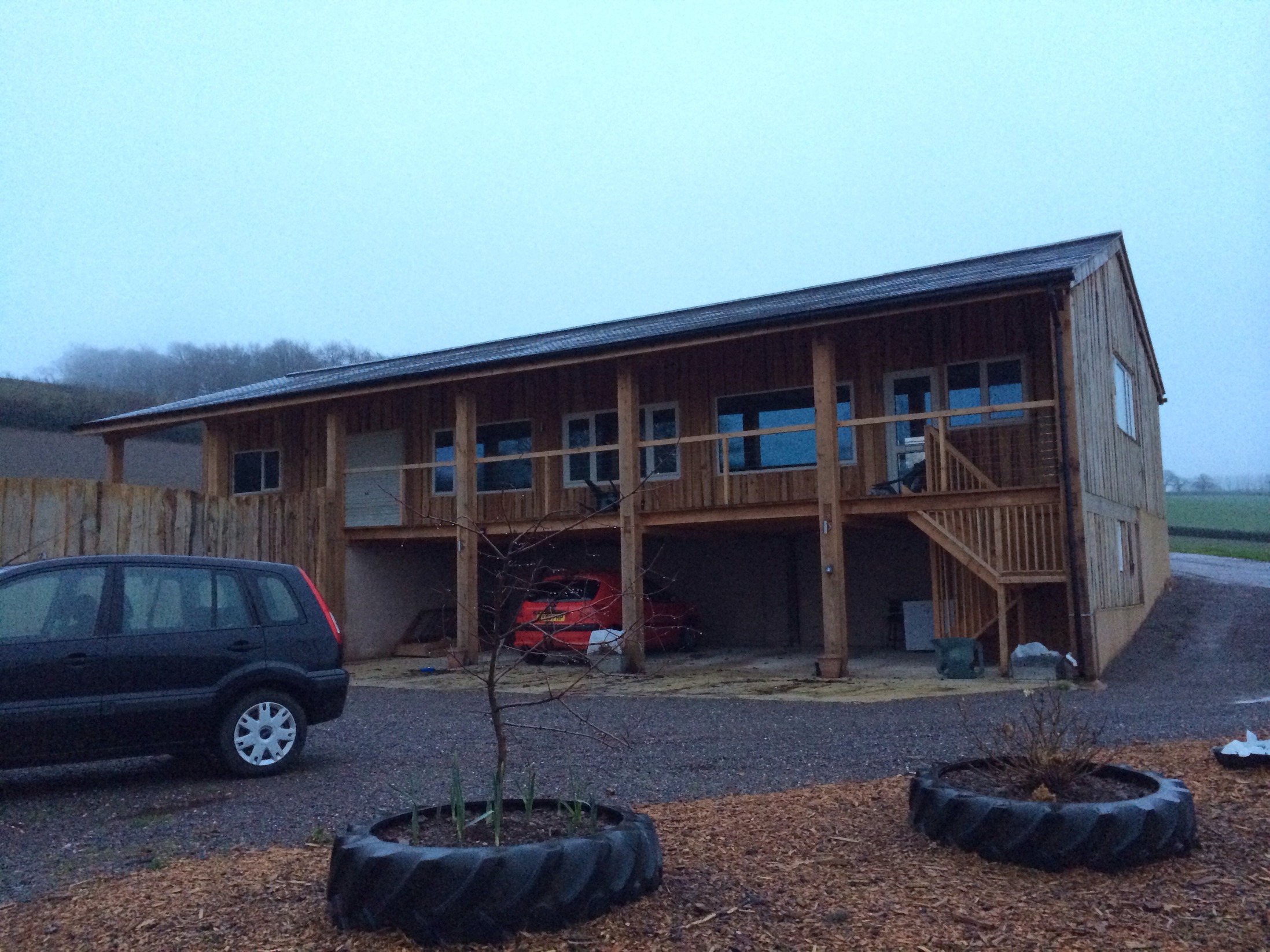

my mate Colin's awesome new man cave, huge upstairs area for the serious stuff and then some car ports underneath for dailys.
SO jealous of it!!!
his wife was going to hire a huge marquee for their wedding and as it was about 8k to hire just for a weekend he said instead he would build a space for it. Then after the wedding he added garage doors front and back on the 1st floor as that way it could still be useful. what a legend managing to get her to fall for that.
Only took him 2 months start to Finnish including time to cut the wood out of trees he had chopped down, makes all those "grand designs" types on the telly look like poofs when it comes to work rate. Epic skills and proper hard working. Fully plumbed in and wired etc too. Only thing he had help with was lifting the bigger beams and a weeks help from a roofer to do the roof with him.
