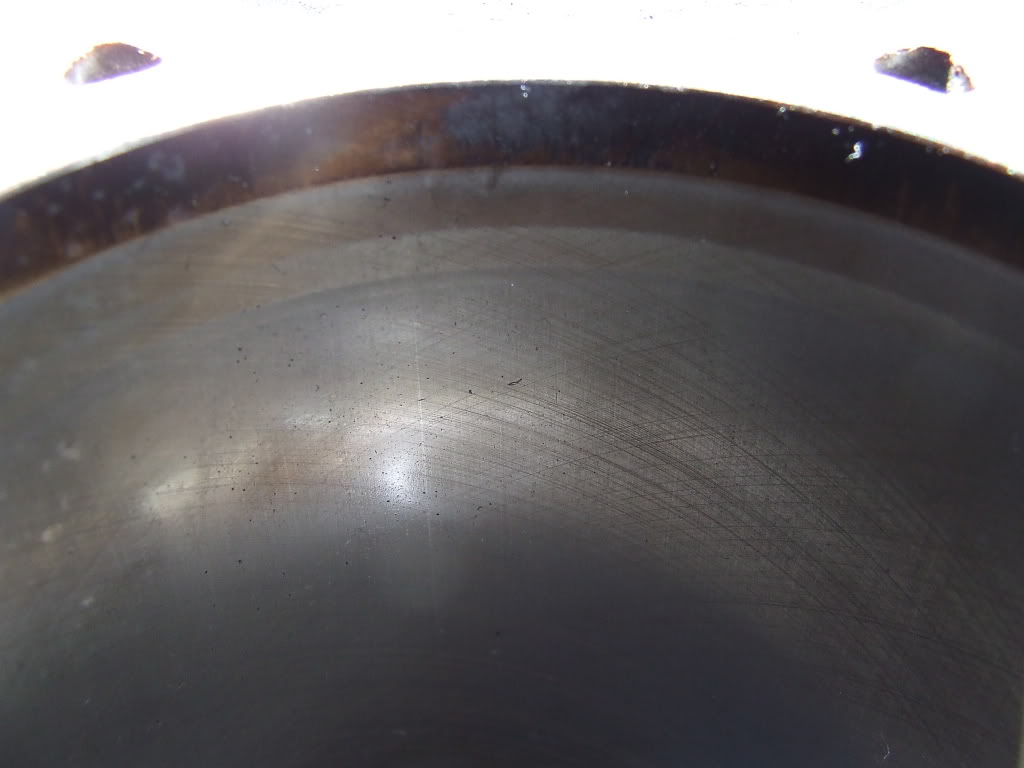

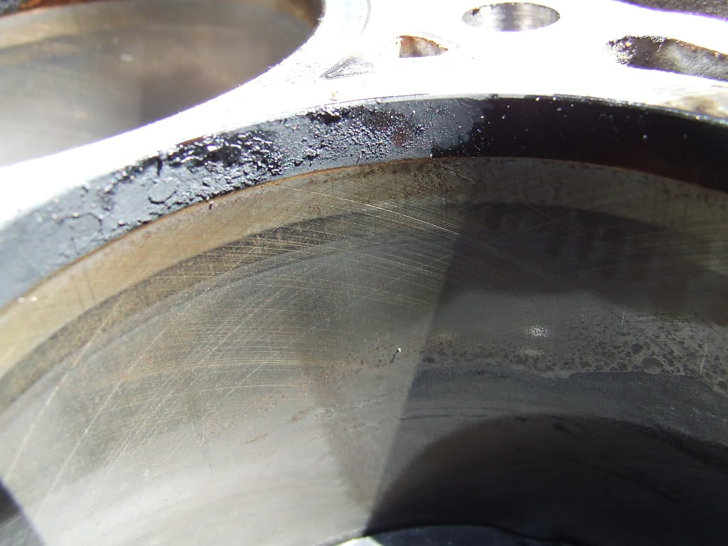

  '92 172, Lotus Elise

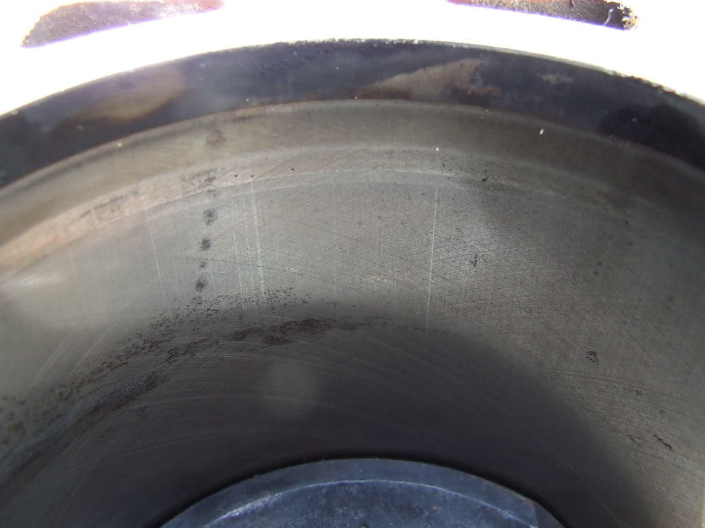

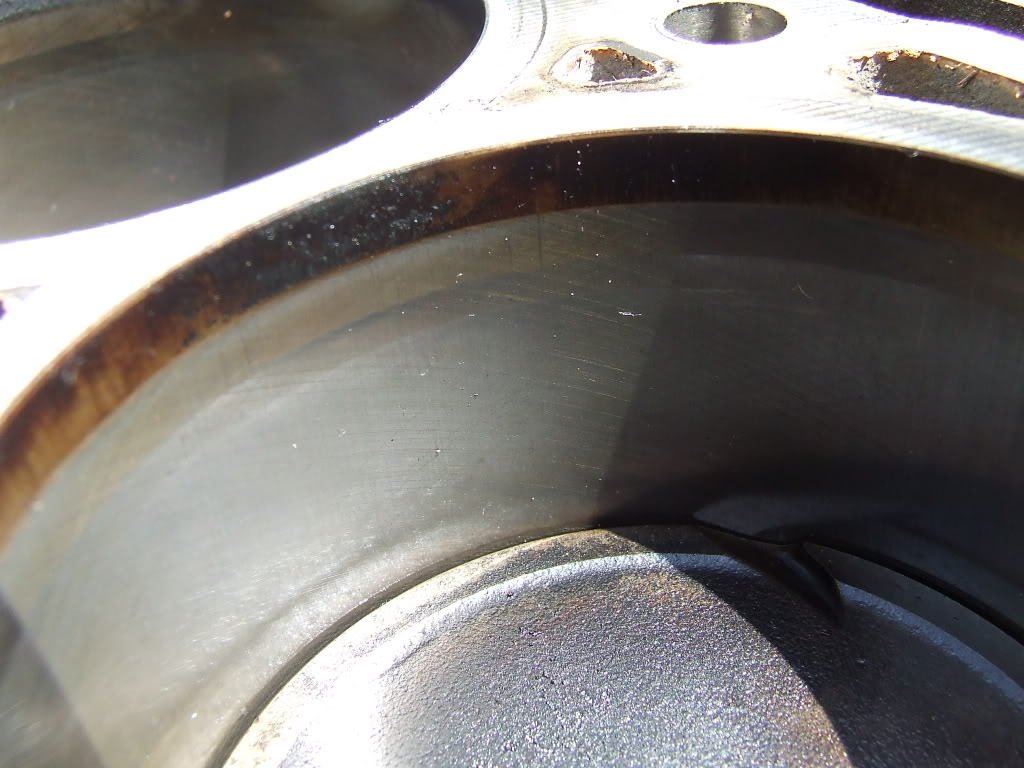

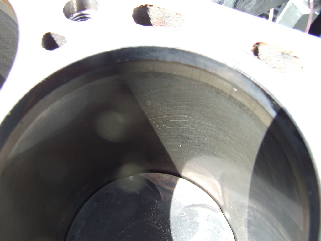

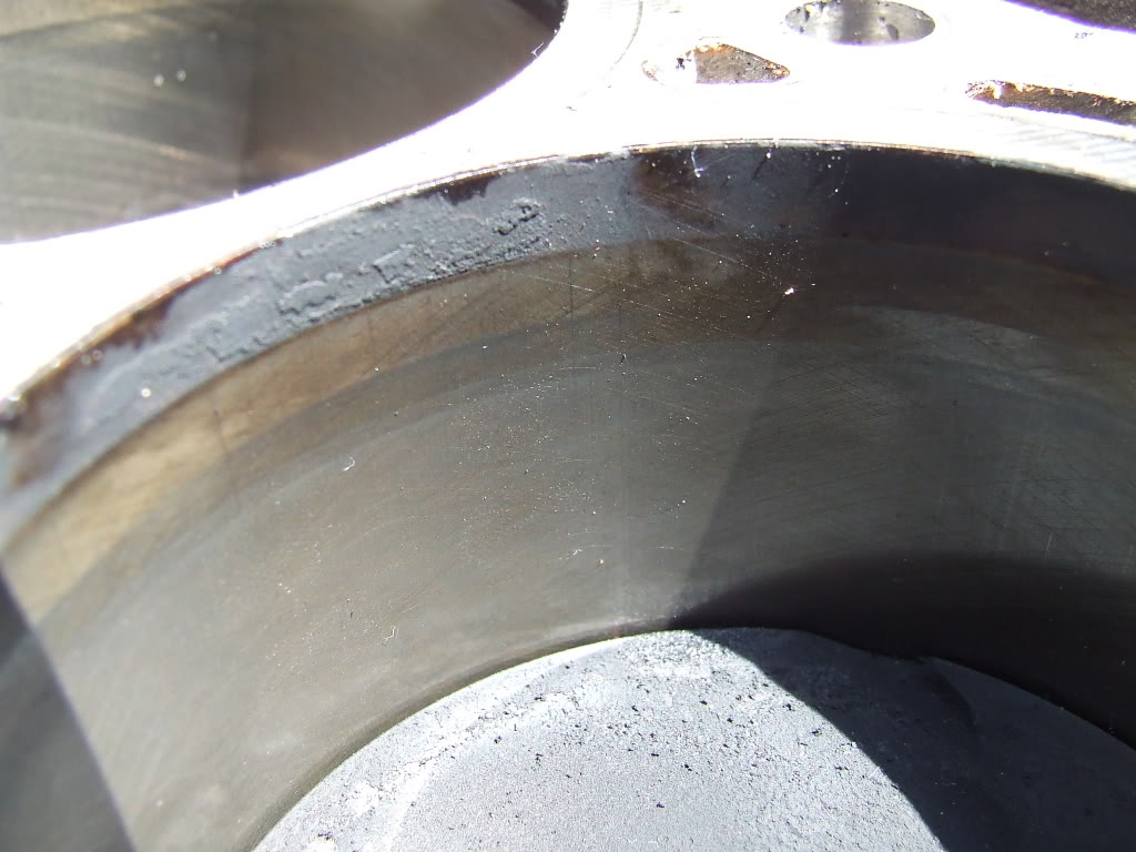

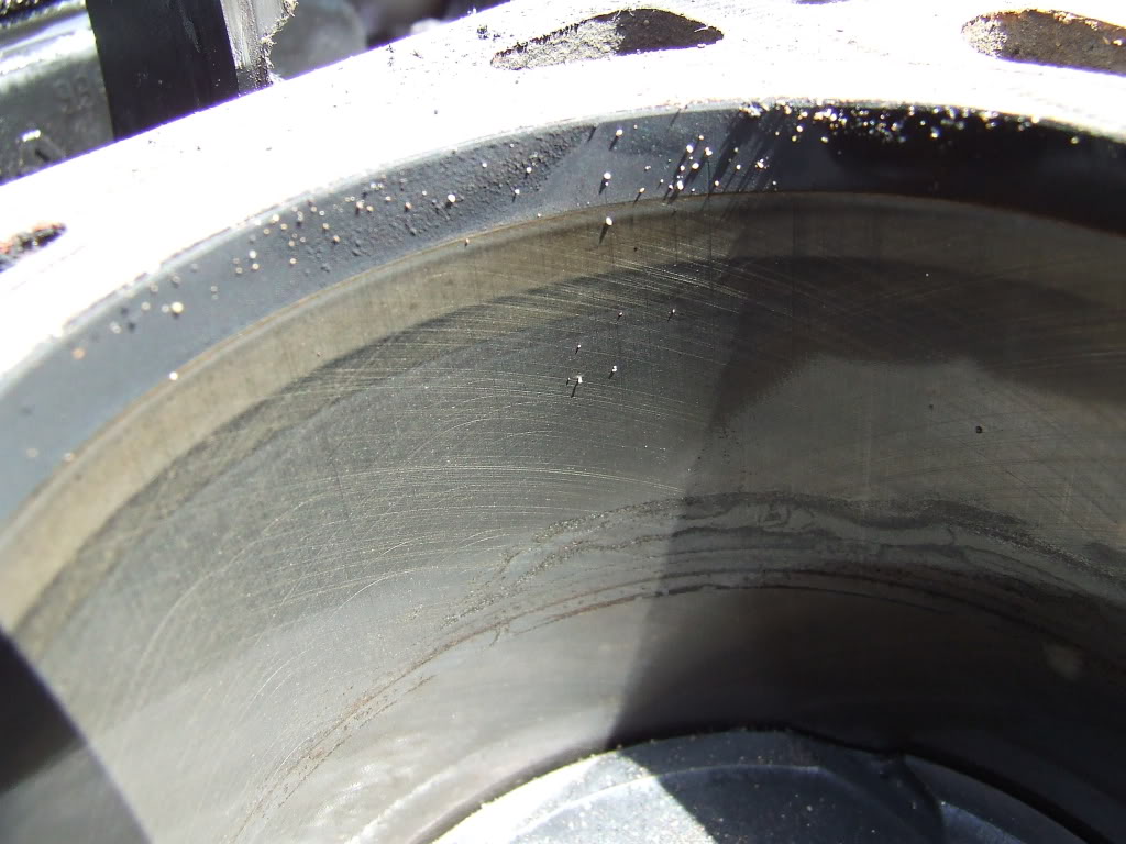

I think I see the problem
pics from various cylinders (click for proper size):
I must admit, i didn't notice these marks until i actually viewed the pics
looks like the engine had been left standing and not locked at TDC, meaning it started to rust? or is that completely wrong?
anyways... what do i do now! :D
  BMW M135i
Can't be doing it wonders but I don't know whether that'd constitute the drop in compression, its been honed recently too obviously it have new rings in recently?
i've not touched it, and as far as i'm aware its not had anything done
it's said to be low milage though. the hone marks arent that apparent when you look at them (same as those piston marks) - the camera seems to pick them up very well though (in macro mode though)
  BMW M135i
Is there a notable ridge or texture change where the rusted bit it? I imagine the piston doesn't come that far up or it would've rubbed that away by now so I doubt its contrbuting tbh.
I was under the impression that you should've be able to see the hone crosshatch pattern at all after a while as its rubbed away?
  LY 182
looks quite pitted to me could have been water damage.. nothing you can do about it though as even if you lock it at tdc obviously only 1 and will be a tdc.
how deep is that part?
may get away with honing it but depends how pitted it is.
bmh - i've taken 100k + engines apart on the likes of audis etc and you can still see the cross hatch pattern.. when theyve been properly looked after regular oil changes etc

have you got the engine out?
take it to a machine shop to get assessed.
ideally you dont want to be mixing and matching parts if you can help it, and you'd have to take your other block to a machine shop anyway to get honed for the new rings to bed in so just get it checked id say
