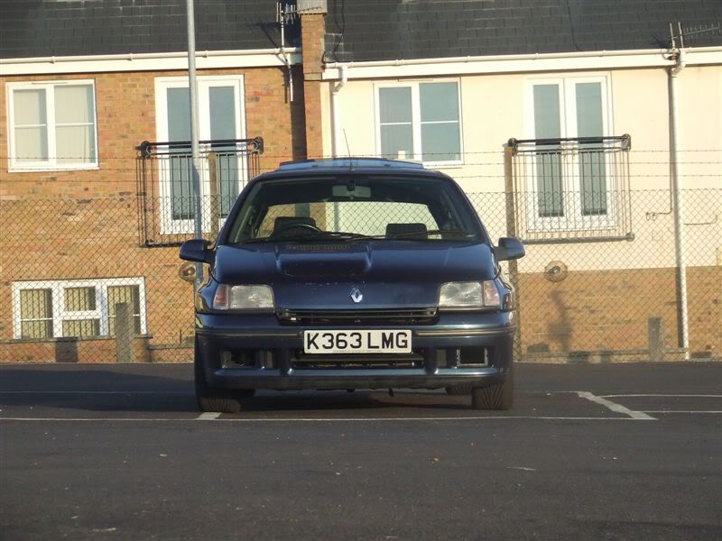

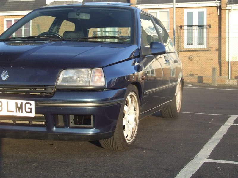

done!
as a birthday present to me, LMG decided to work :D
neighbourhood annoyance 101 ;)
so happy!! :D :D

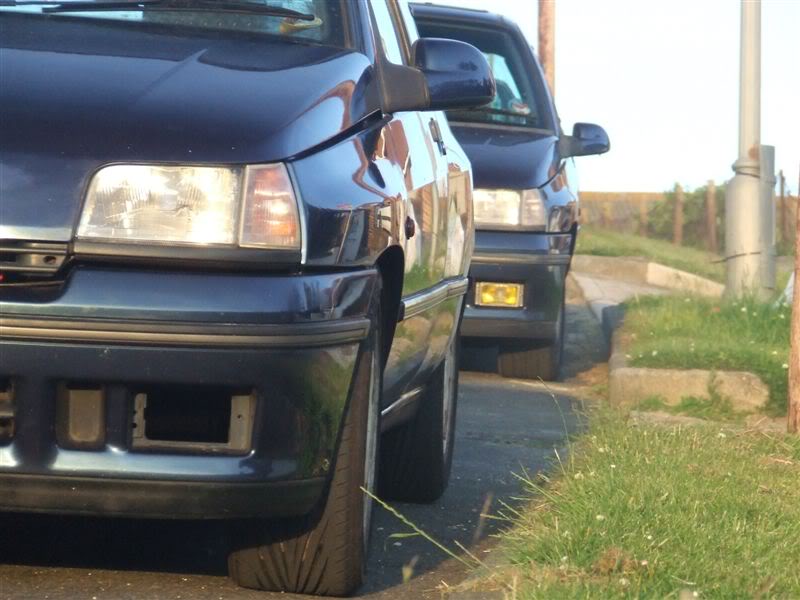

need to bolt the lights and bumper on properly tomorrow to sort out those awful panel gaps

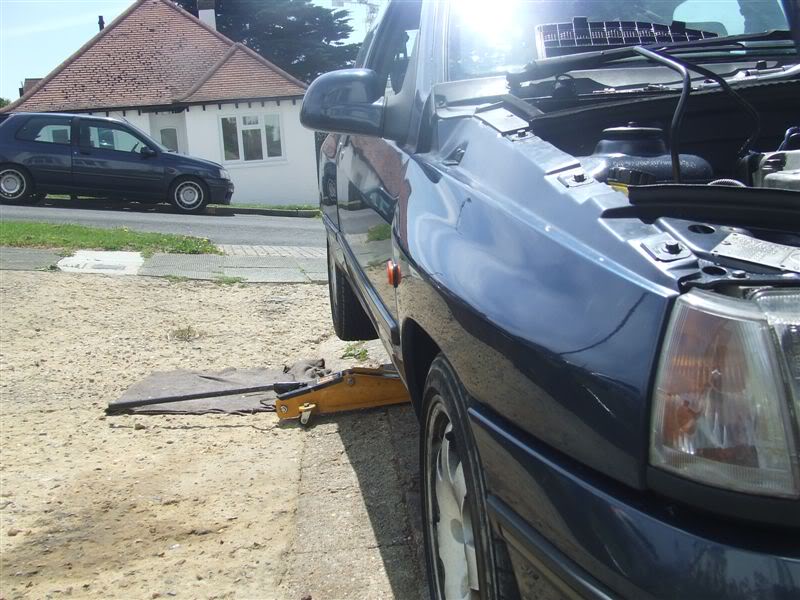

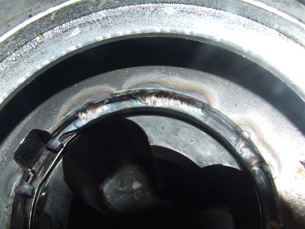

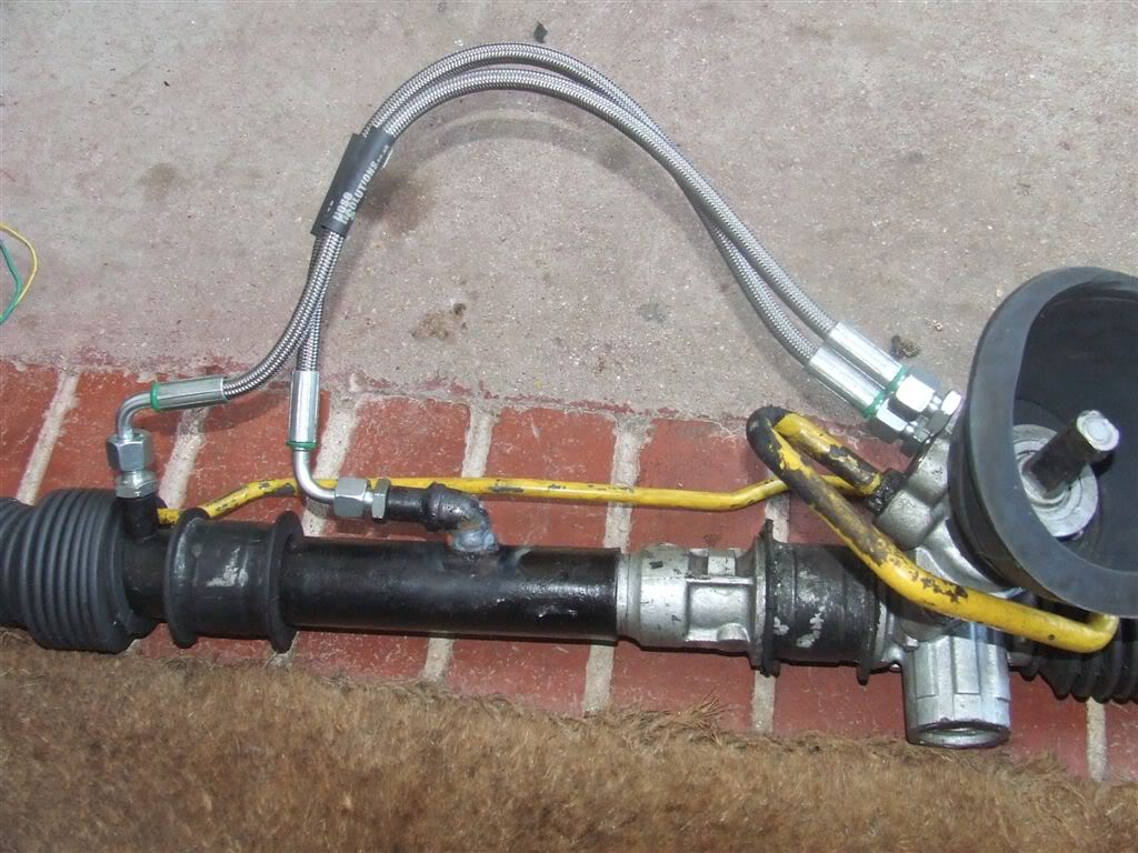

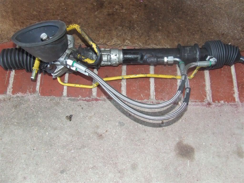

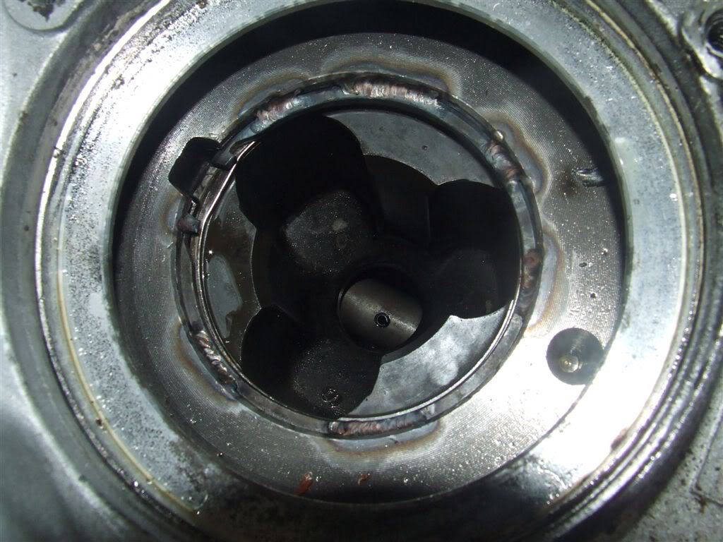

it's not hard to get the power steering to fit in the conversion i'll post up some pics - just needed one of the connectors chopping off and welded on again with a 90deg bend (not actually required i think, but it gives me more room!) and a couple of pipes made up!
and my welded circlip:

I've connected up my PAS pipes and now have nice light working PAS!! :D :D

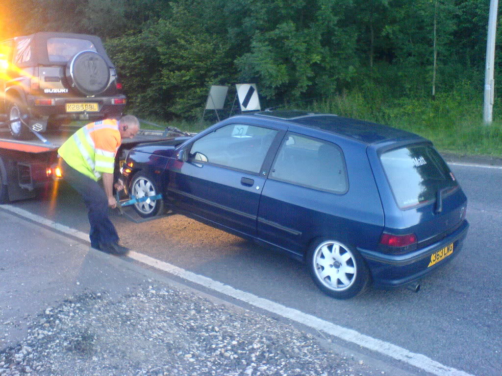

she made it to FCS!!
did a bit of brapppp on the track
and then
on the M1 at about 20mph when it started to surge. few minutes later the fuel pump packed up :(
might also explain the poor performance? - it was as quick as a williams only down the straights :(

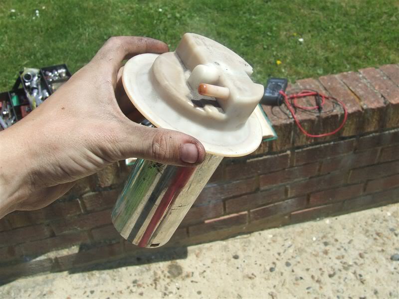

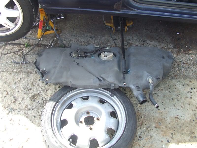

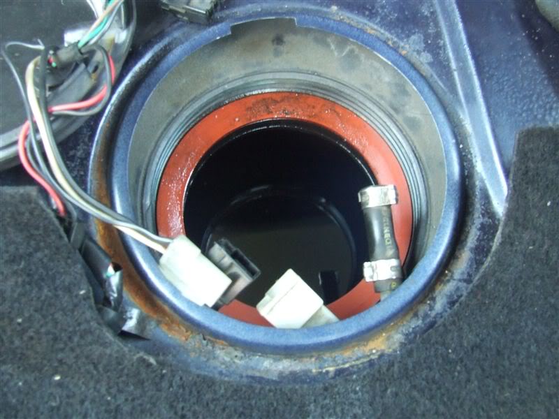

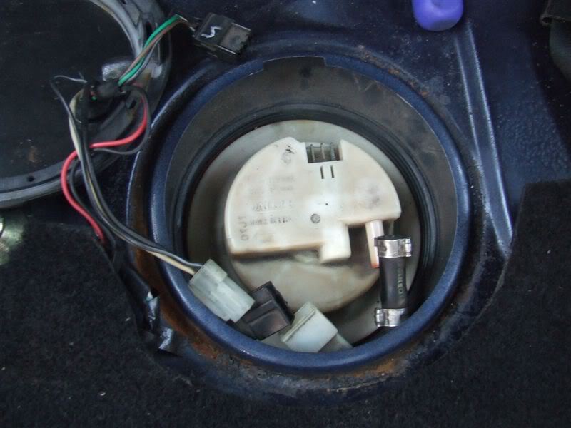

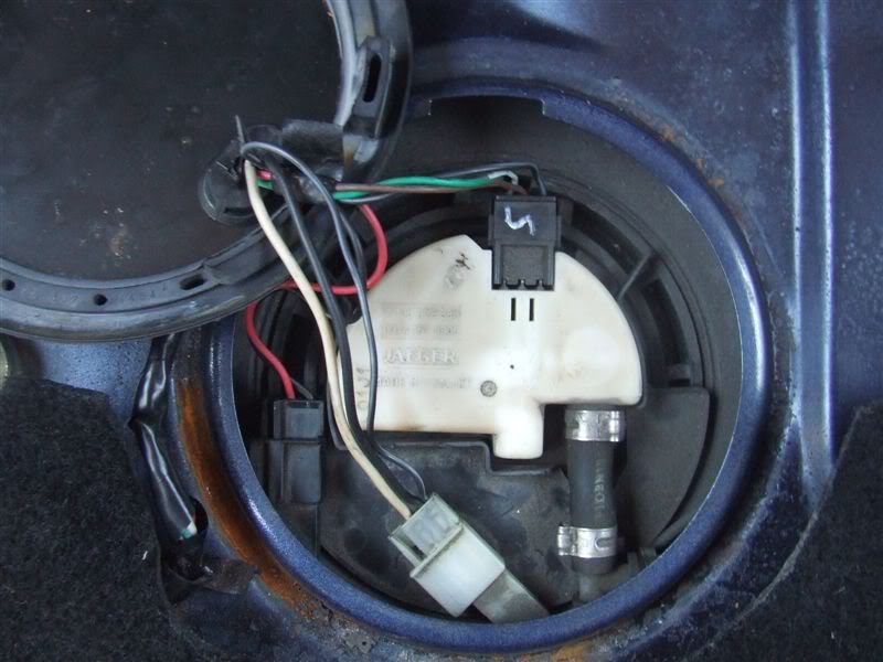

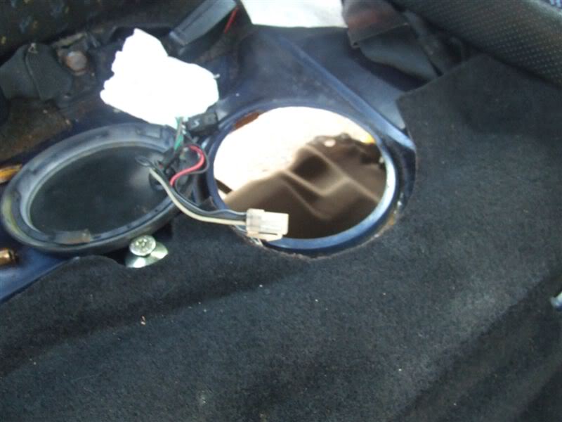

sorted my fuel issues out - was just a bad connection on the pump! was fuming!! :(
