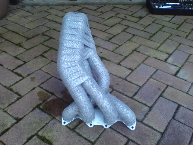

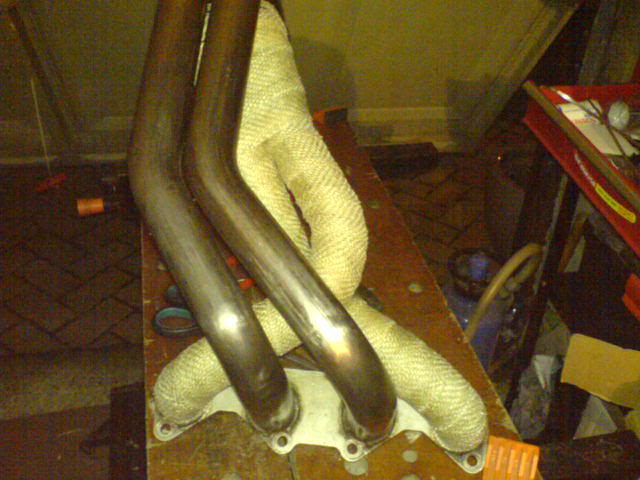

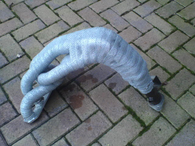

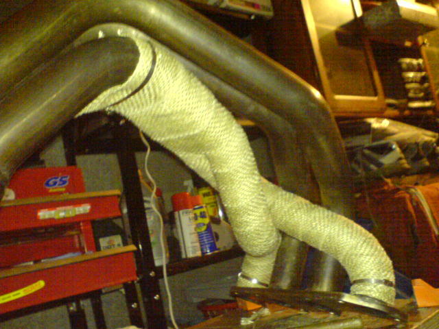

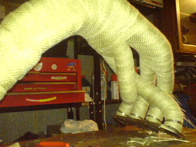

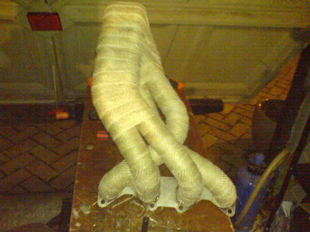

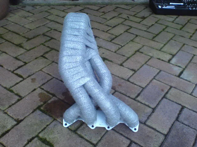

started to wrap my manifold to protect the steering rack/pipes and brake lines
didn't realise how much it would take, gonna use about 30' i reckon, just waiting on some metal cable ties now
  Sunflower & Golf Mk6 BMT
Why dont you just wrap the pipes and cables in heat protection or install a heat sheild that would be easy?
From experience mani fold wraps always fall off no matter how neat you do it and unless it done properly doesn't really help.
Good luck to you thou!
  F4R'd ITB'd '92 cup racer
did you wet the wrap matt?
i did my 106 manifold, if you spray it with water (dont soak it) before applying it makes it much easier to work with, also dries tighter. mine has never come loose, only problem is that ive caught it on the ground a few times and it has torn in places. not a problem with the clio's though.
  '92 172, Lotus Elise
i've not properly put it on yet, was waiting for the ties (which have arrived now)
cheers for the water suggestion!
fuel_slut, I'm gonna take my chances with it, i've seen a few done recently and they all still look ok and seem to hold the heat in

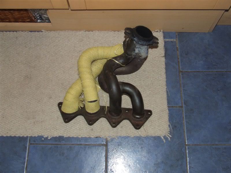

my GMC 4-1 manifold, wrapped by yours truly
and then sprayed with high temp paint, acts as a sealant aswell to stop water getting in and rusting the pipework
i'll stop pic whoring your thread now :rasp: ;)

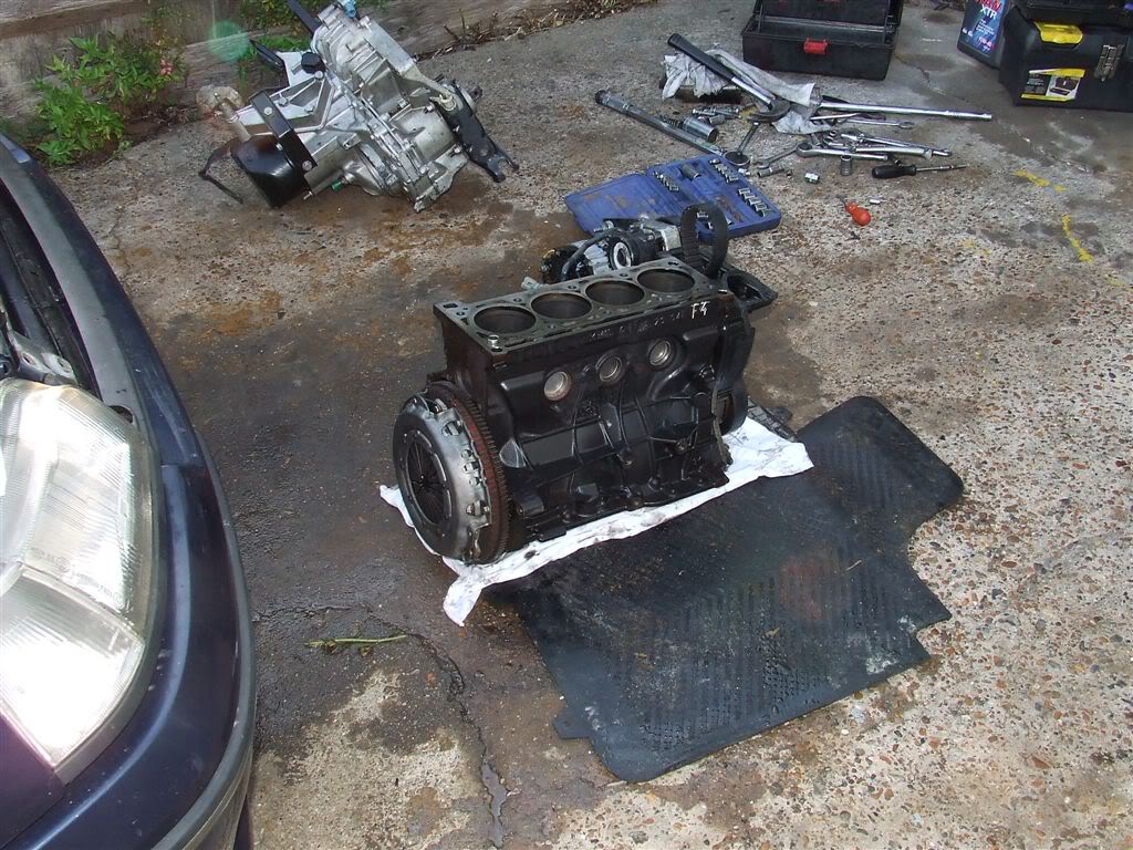

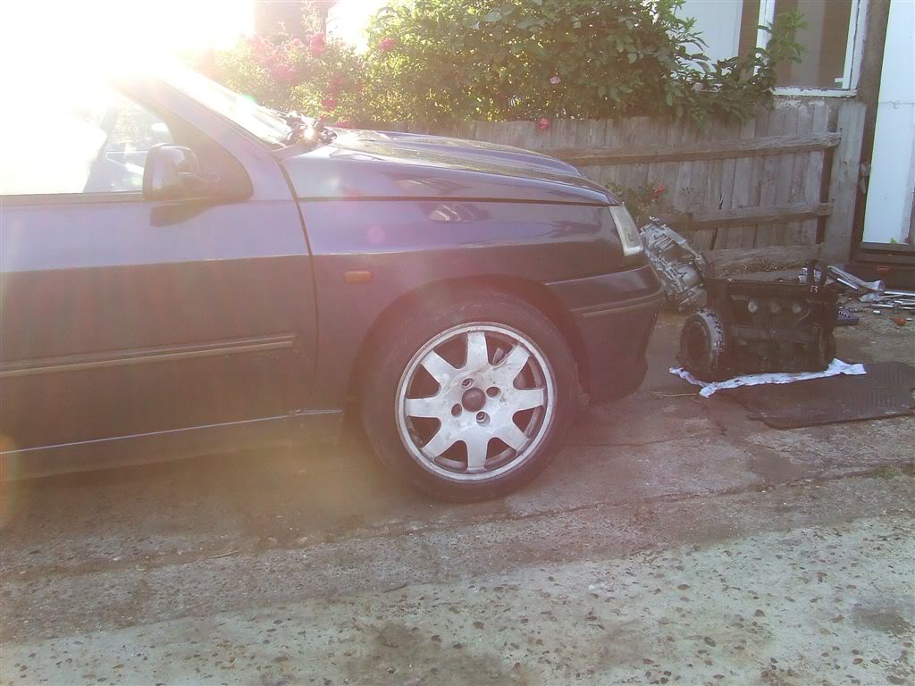

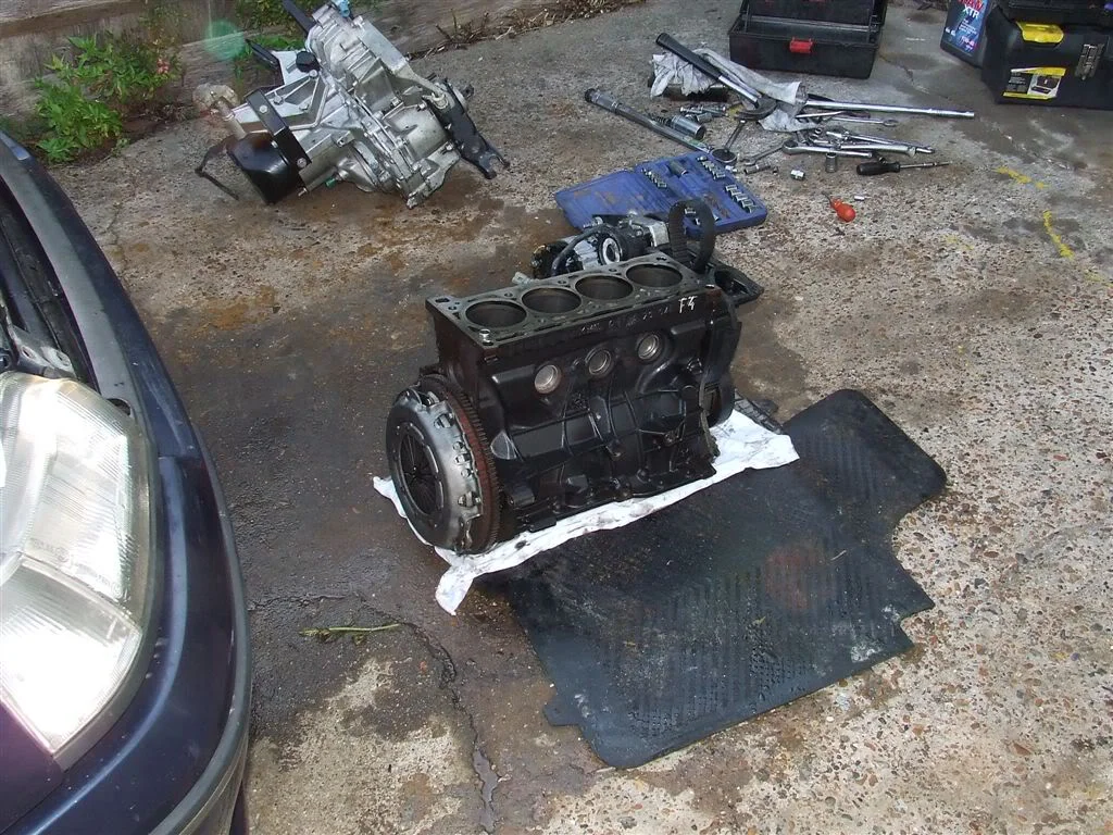

engine out.. again :mad: - neighbours must think i do it for fun

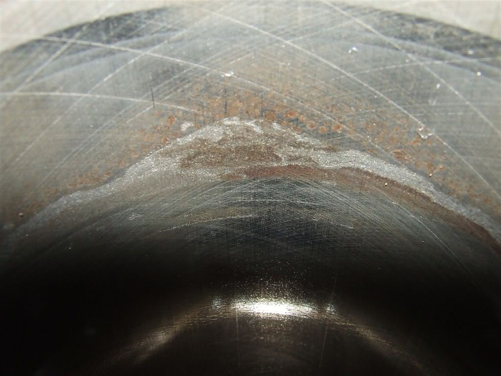

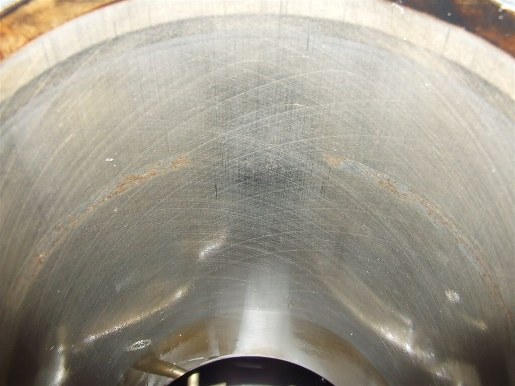

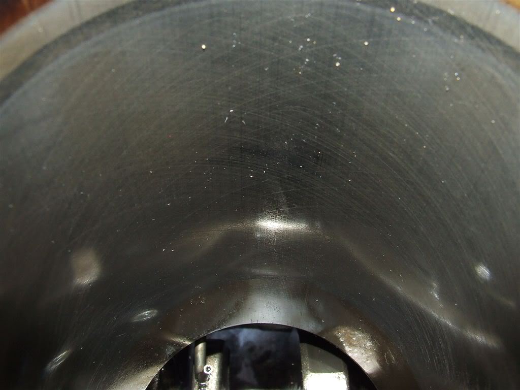

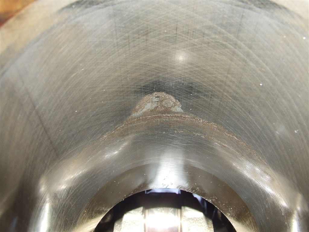

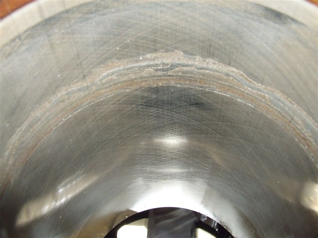

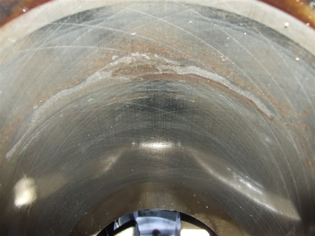

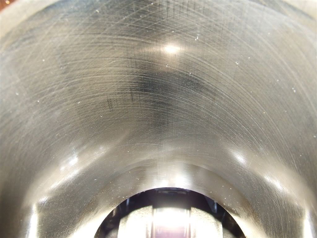

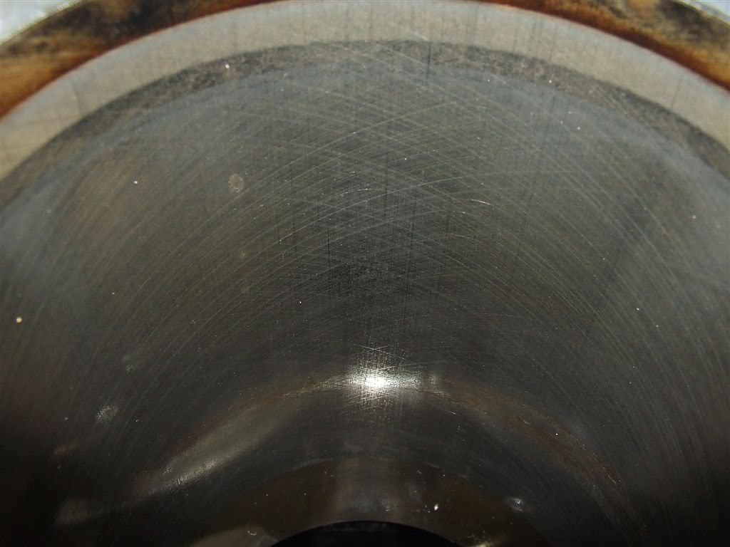

heres some pics of the bores - the flash accentuates everything (e.g. the hone marks) but you can clearly see where a piston/ring has 'rusted' to the bore - or am i miles off?
building up a collection of crank cases :dapprove:

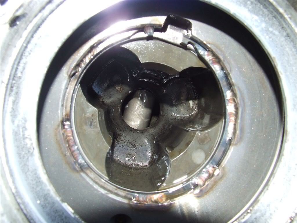

atleast the welding on the diff circlip is holding up! (even after track abuse)

I could go with that being the problem seeing as its not a complete loss of compression, wouldn't like to say whether thats salvageable though without a slight bore and oversize pistons which I don't think exist.
Im no expert, but that looks like your problem.
When you run your finger over the suspect cyclinder is it rough/pitted or un even?

if piston rings are really expensive (£500) - then that takes them out of the equation
Can i not just use piston rings from engine #1 with crankcase #1 and the crank/rods/pistons from #2?
would it *need* to be honed, as it was working perfectly (compression wise) when i took it apart!!
if not, i'll have to get a new block.... again!!

Rings are about £20 a cylinder fella! You have the engine out, dont just bodge bits of different engines ow or you'll be back to square one. Might aswell do it properly and whack some high comp pistons in and get the block honed. It wont be THAT expensive...
Thats FUBAR'd, rings are not the issue.
A hone will not fix that and depending on the depth of the corrosion, even a set of oversize pistons might not fix it.

maybe not at all - it seems piston rings are renault only, and very expensive :(
I'm taking them to an engineering place tomorrow as my final option, then its on to a new block!

In that case, old pistons new rings and a rehone....but were only talking like 1-3 tenths of a thou max.

rings are available from plenty of places, Perfect circle, Federal Mogul, Gotze. A decent engine reconditioner/machinist should be able to sort you out

no where can source piston rings and i do not have the money to upgrade to forged etc..
so I'm using my original crank case and mains caps with the crank/bearings/rods/pistons from engine #2
I'm going to reuse the rings from #1 and put them back in the cylinder they came from nd hope it works basically.

You can get the rings from renault for circa £30 a set each. Part #77 01 472 823.
I'd not be overly confident codging it together like that tbh but might be worth trying, you sure the block hasn't been damaged when the crank bent?

i was told its massively more! - and my dialogys confirmed it - £120 isn't for 4, it's per cylinder
and i'm hoping the crankcase is ok!

phoned renault, they said £36.01 inc the vat per piston, which bmh.01 said. they gave the same part number too
gosnays said they didnt have anything for the F4R
so looks like i might as well get them ordered from renault. about £144.
then i'll need to get my block honed and check the mains to make sure the old crank didnt fook them, but i suspect its ok!

found a machine shop who can hone it for me. i'm going to get them to check the crank first though, to make sure its ok... as i really want to be sure
then hone it, new piston rings... and away i go!
