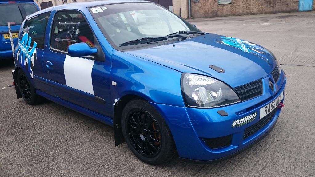

Well fcs has been and gone, I had a blast on track! Was very impressed with the way the car felt and handled in the wet and dry with r888's on! Very predictable and controllable, only got overtaken by the 200 cup car and some other race 172 cup which had wets on so was very pleased!
Only things I need to amend is trimming a piece of the front mudflaps so they don't rub the tyre and fasten the front bumper on abit better, I'm thinking a couple of aerocatches will do the trick.
Next up will be pugfest at Prescott "in a clio -_-" to get some runs up the hill which Ive done the last few years, then hopefully a track day at oulton park in august!
Here's a few snaps..

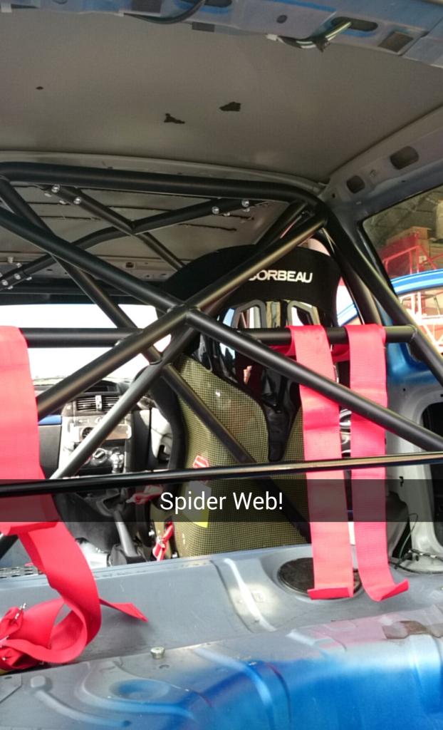

Time for a little update, the cage has been ordered which will be the full safety devices r016 from Mark fish motorsport. Should be here in around 4weeks.
Trackday booked at oulten park on August 19th which is the same week as the cage is due so with abit of luck I will have that fitted ready for that.
Also last Sunday had a great day at pugfest at Prescott hillclimb. 7runs up the hill and was apparently 3rd quickest up there according to my mates timing skills haha. And sounded the best which will do me!
  172 Cup Jenvey'd
Cage shall be here Wednesday by all accounts, so work has began on drilling out the spot welds on the original seat rails aswell as any other unwanted brackets. Weld in seat rails shall be here early next week also. Hopefully be all ready for the track day at oulten park on the 19th!
Also the fabricator whipped up a proper rubber mounted ecu tray.
  172 Cup Jenvey'd
Cage is finally in! Aswell as proper seat rails. Only took 3 full days to fit *sigh*
Very happy it's all in and ready for oulton park on Tuesday!

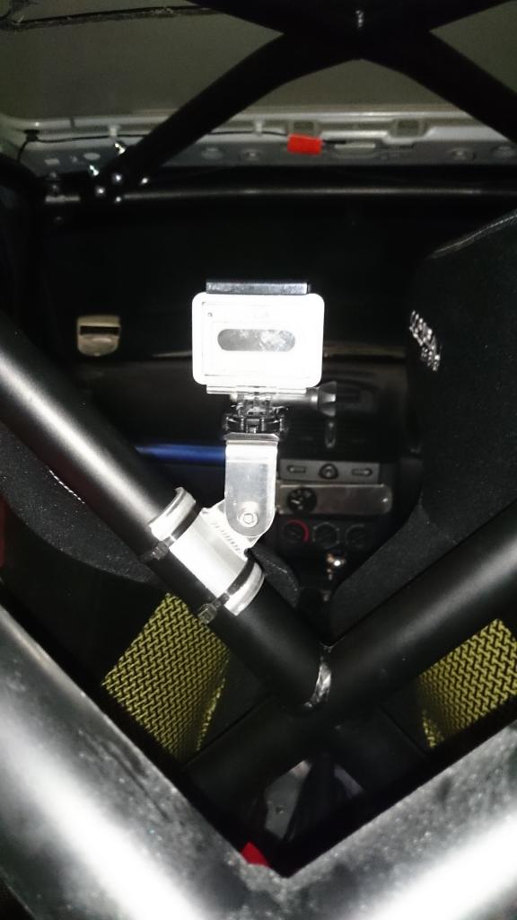

Also got a go pro mount made up too which is sweet!

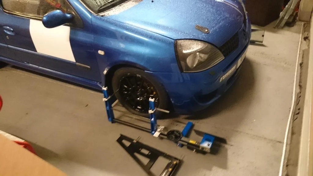

Also checked out the geometry last night and the tracking was way off what I wanted so hopefully be a little quicker again this time around.
Front track was toeing In 18minutes.. Rear is toeing in 1.5degrees!
Running parallel up front now and going to order shims to run parallel on the rear aswell.
