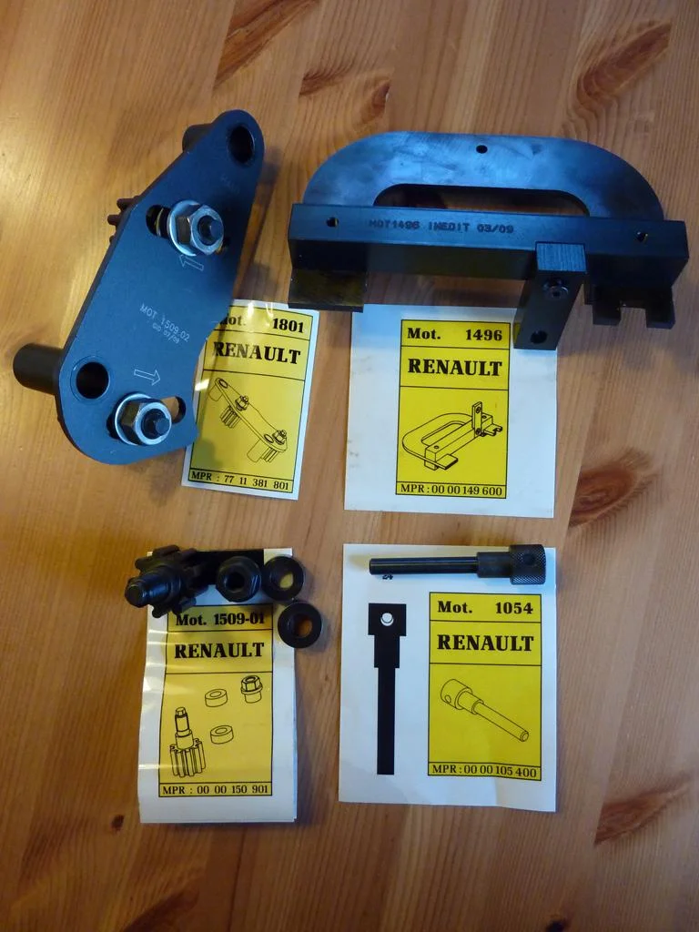

Are the locking tools to hold the cams whilst belts of? I had to make something similar when I did my omega?
p@blo
  Clio/A3
LOL.
3 tools required.
Part refs on the image.
As of last month when I asked:
0000150901 @ £22.95
0000149600 @ £56.14
7711381801 @ £54.48
0000105400 @ £12.45
