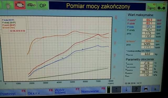

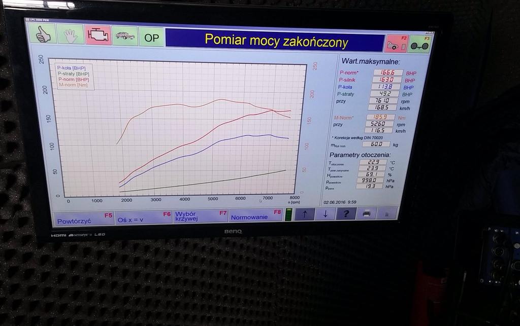

My mods are 4-2-1 exhaust manifold, 2,5" Milltec exhaust, stock cams, SM intake, SM 65mm throttle body, ITG style air filter, stock ECU
At the begining:
And this is final what we were able to achieve on this setup here in Warsaw:
What to do to reach more HP after 7000 RPM ? Cams ?
  BG Clio 182
It is pretty good. Would much rather see a car that's been correctly mapped and then fitted for a proper result. I got 11bhp from a map so that'd put the inlet at 9bhp increase from my results and his above
