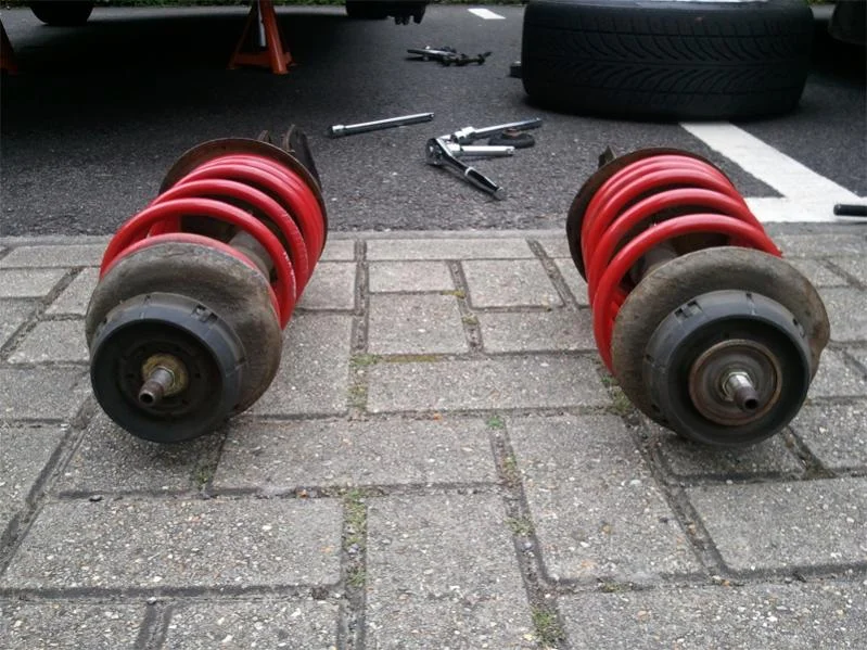

So, I've had the struts out and the problem is pretty obvious.
Question is, which one is right?
Shouldn't the bearing on the right hand strut be under the mount?

Sorted.
That was simple enough, I should have just done it myself from the start.
I disassembled the other other one as well, just to make sure the bearing was actually under the mount, and was on the right way up.
Once I was sure both struts were assembled properly, I fitted everything back together and took it for a spin... perfect. No noise at all, and both rubber hats sit flush with the chassis when wheels are straight.

You did flip that bearing over when you fitted it yes? The side that you can see in the pic should sit on top of the spring cup that face down.

Define flat side?
The side that you can see in that picture should be face down on the top spring cup.

I'm pretty sure that's the flat side. When I took them off, there was a definate flat side. The other side isn't flat, like the surface of a doughnut.
As in:
It's got a recess for the collar that goes throught the rubber mount to sit in.

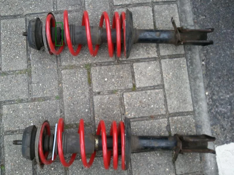

Any thoughts on the rubber that surrounds the shocks? Is it a problem that its all perished?

The sleeve and bumpstop, i.e. the bit inside the spring covering the piston. The sleeve has come completely away from the bumpstop on one of them.
  Monaco 172
You can see the perishing where i've drawn a green box, and one is split where the white line is drawn.
Didn't know you could just replace the rubber... that's good as the shocks look fine underneath.

7700434126 is the part number for them.
As long as the dampers offer good uniform resistance throughout their travel theres no need to change them.
