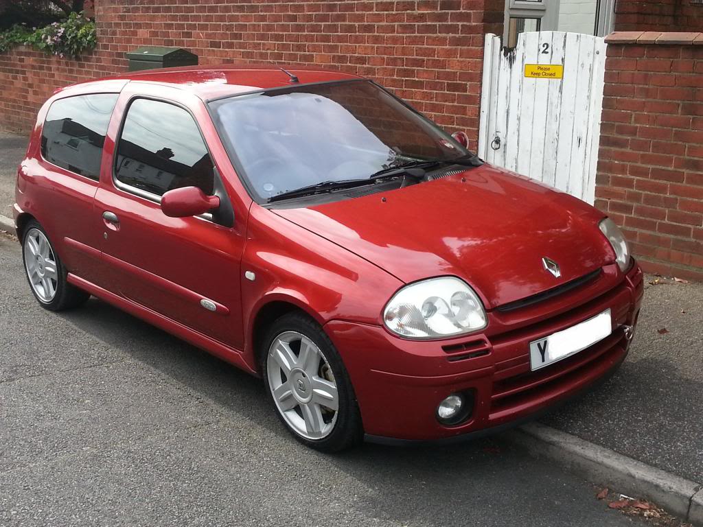

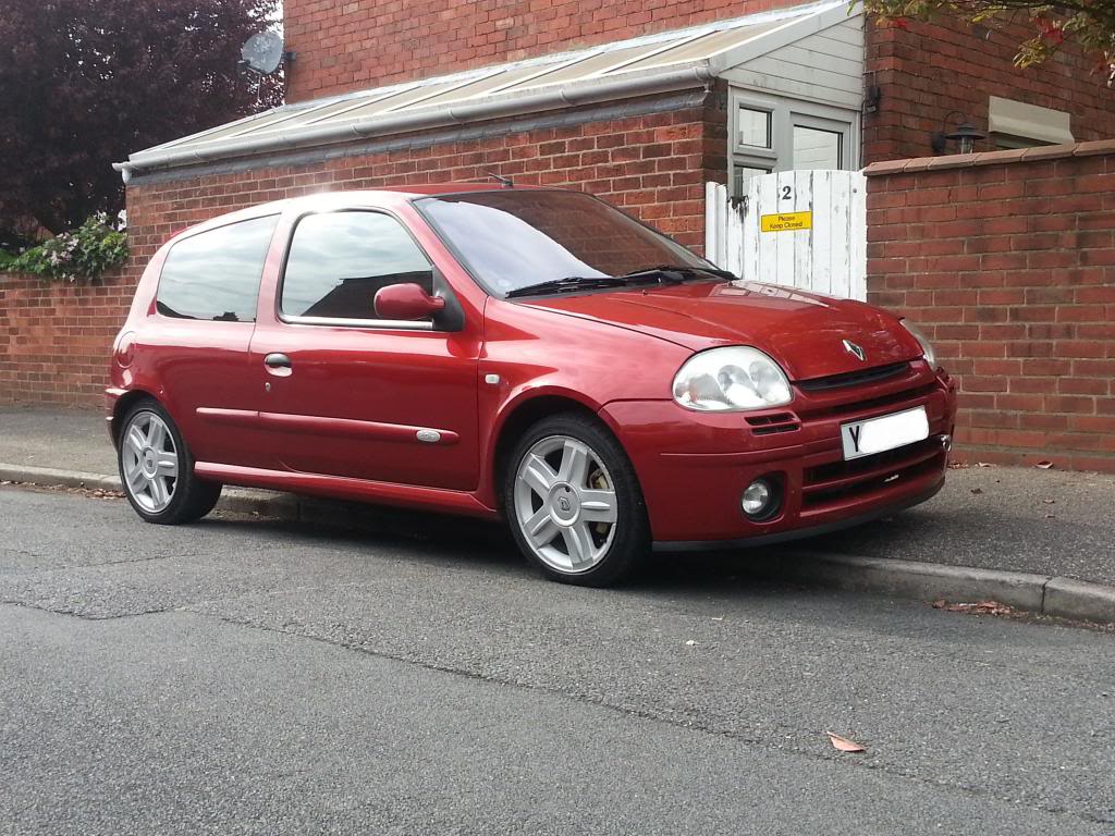

As with title, I was on the market for something cheapish that had a bit of poke that's not ten a penny and came across a standard, untouched flame red ph1. I've never owned a renault before and as a driver by trade (new cars) after a quick test drive out in the ph1.. I loved it. A very underrated car indeed.
So hooked I was/are.
This is the original pic from ad. Excuse my MSpaint skills - life's too short.

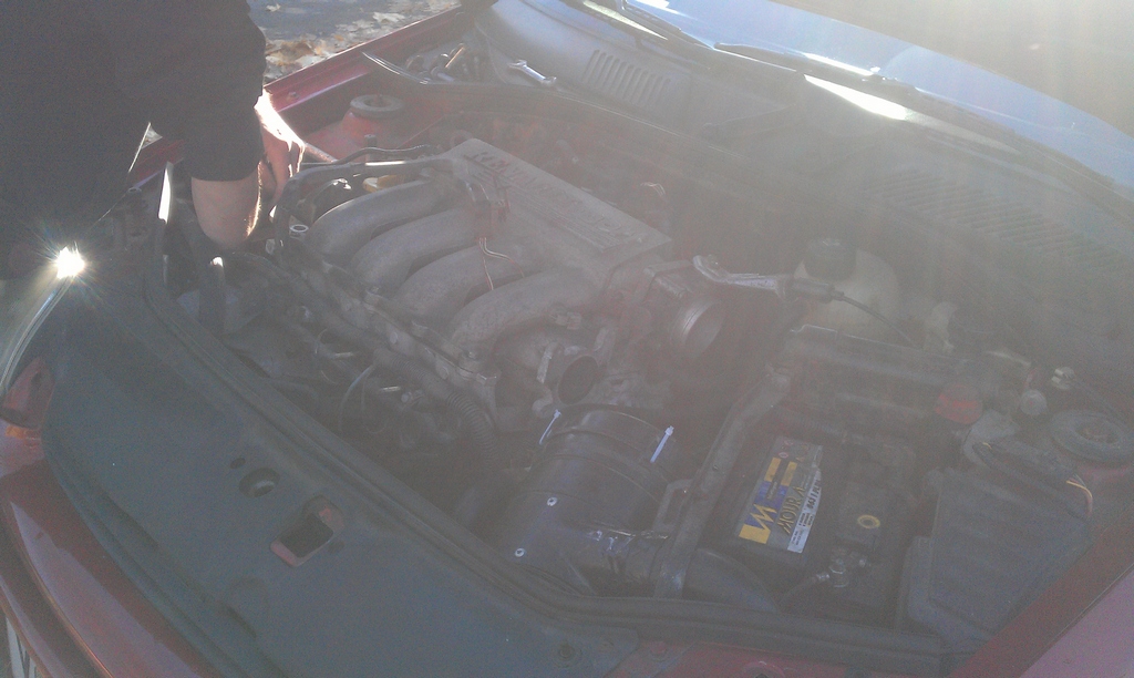

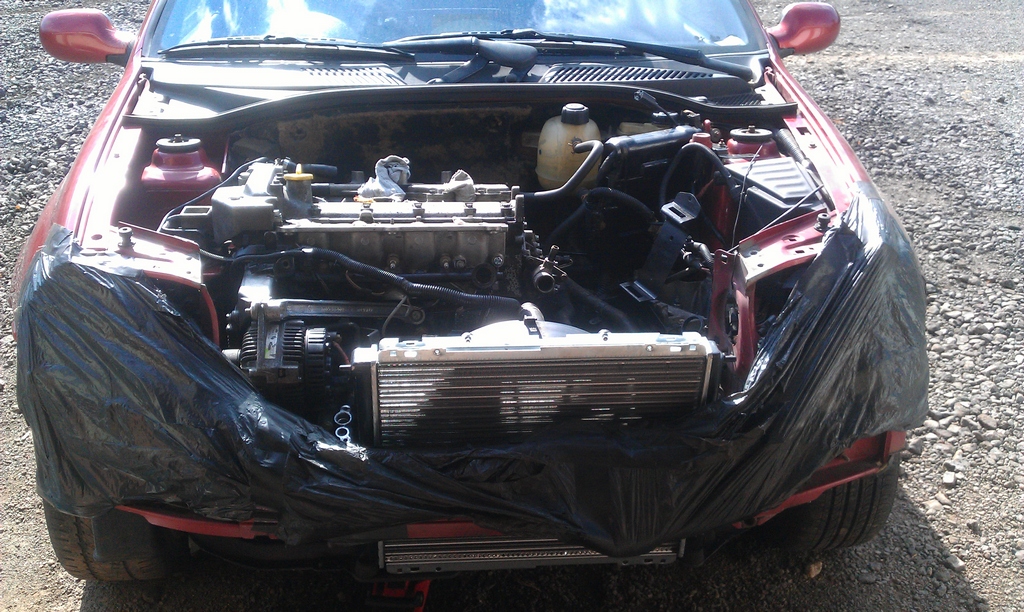

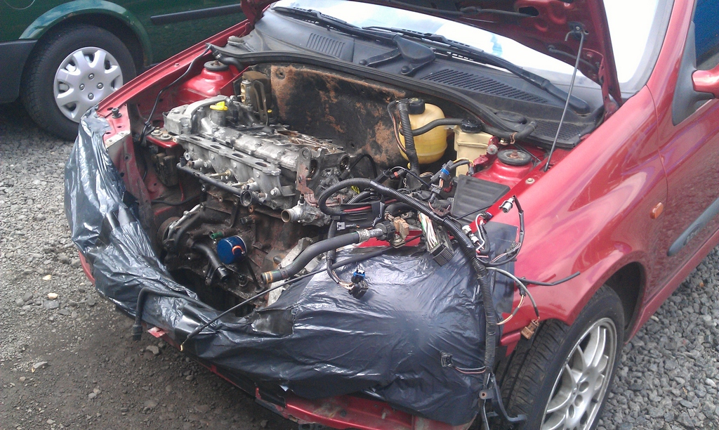

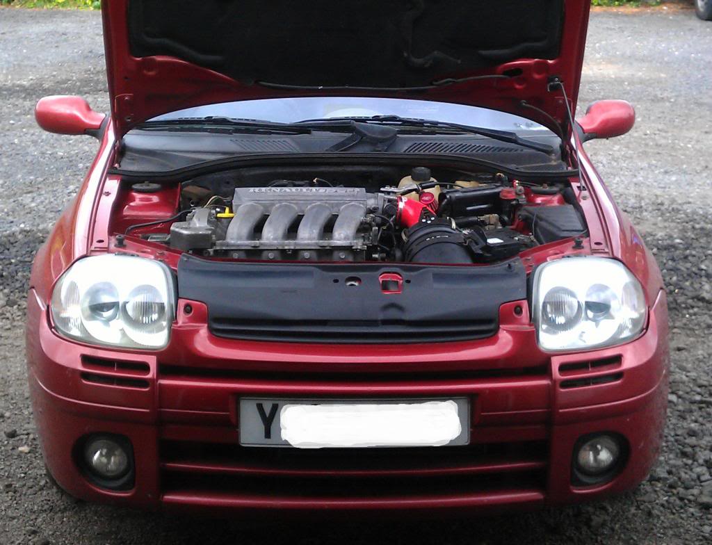

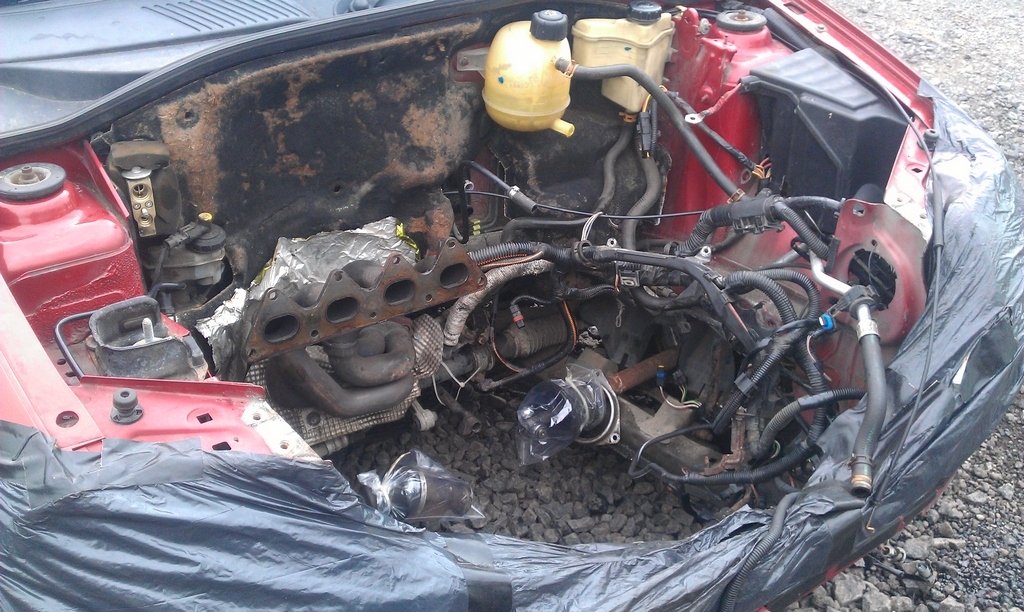

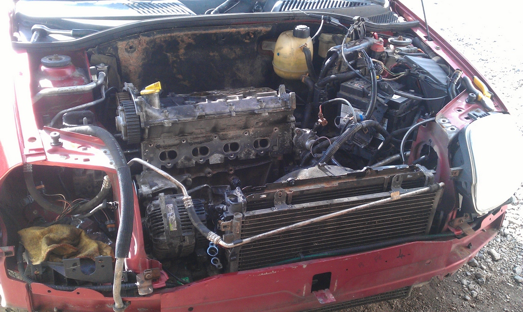

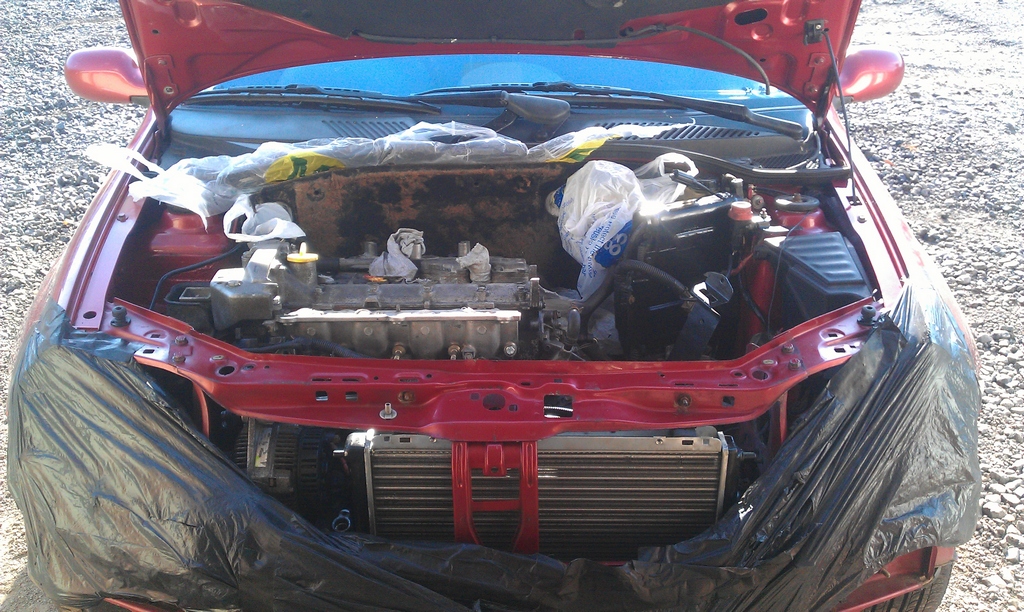

The engine was looking neglegted but it had never been touched, so onwards and upwards.

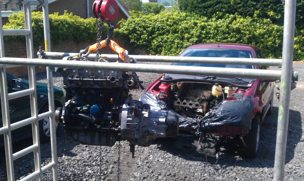

Prepping ready for removal.

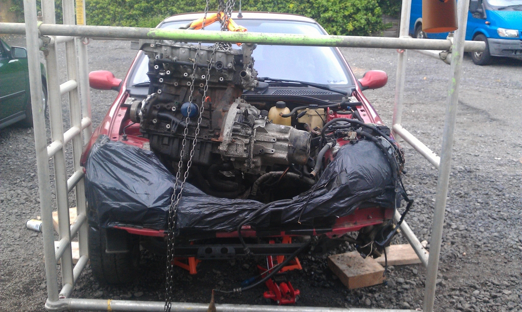

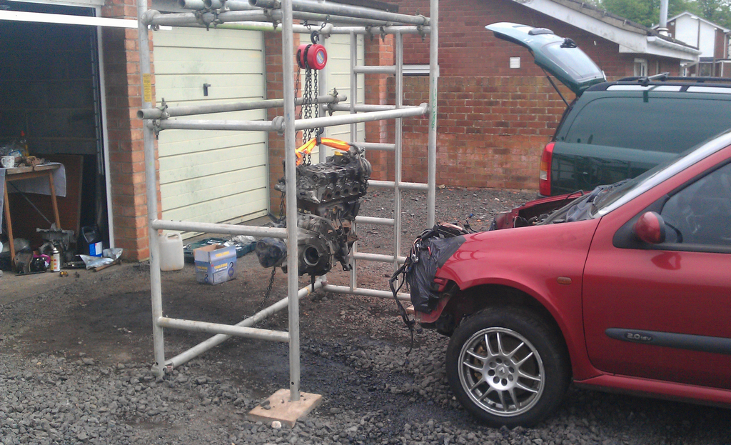

And out it goes.

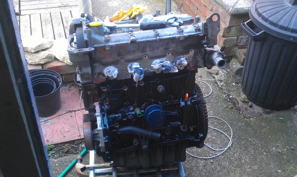

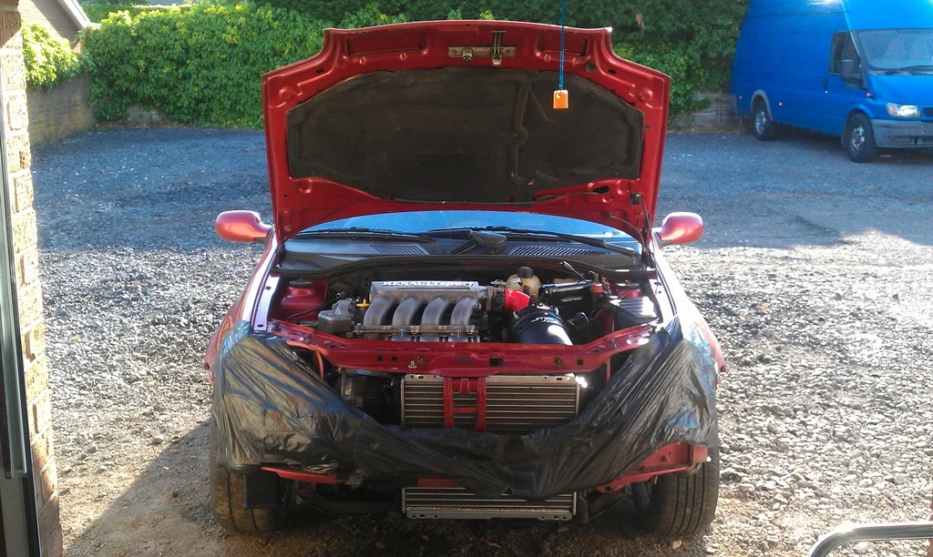

I managed to source an 80k 172 cup engine with everything done, dephaser, belt, pulleys, pump, plugs (platinums), oil, all new delivered cheap as chips.

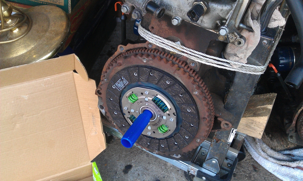

New clutch.

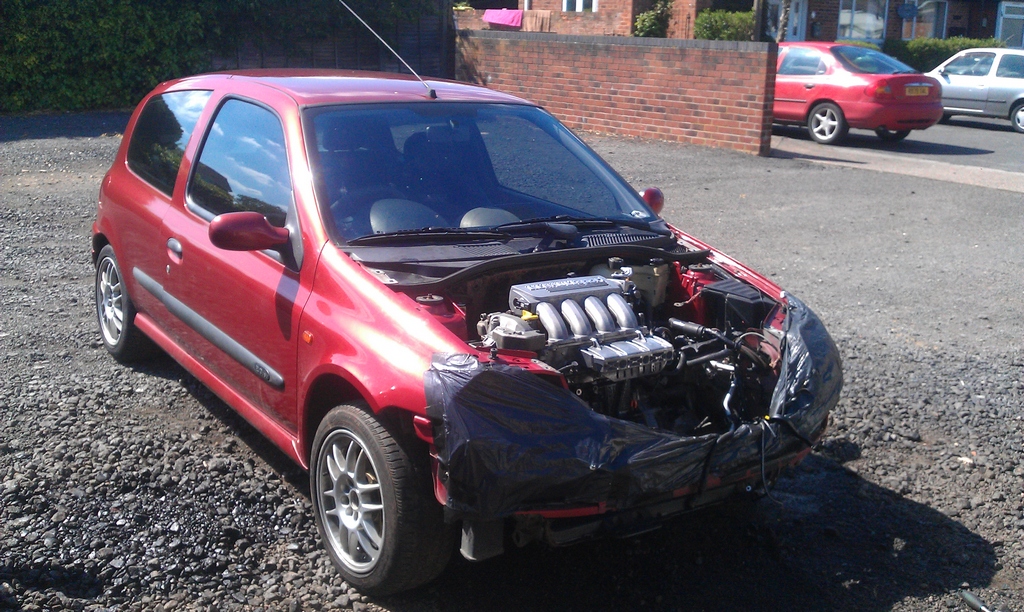

And in it goes.

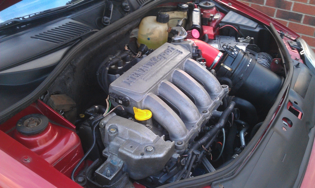

Shazam. I've now removed the fuel rail cover.

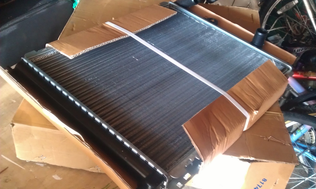

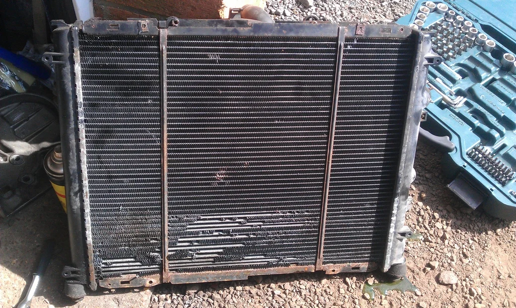

Radiator had seen better days.

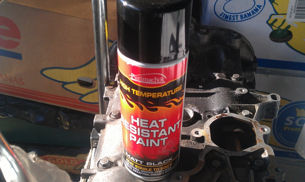

The fire wall looks awful.
A cheap fix.
Makes a fair bit of difference.

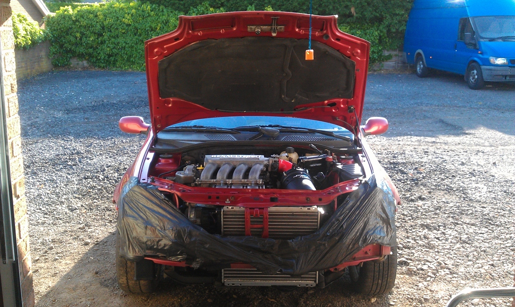

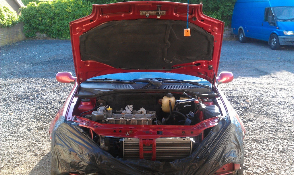

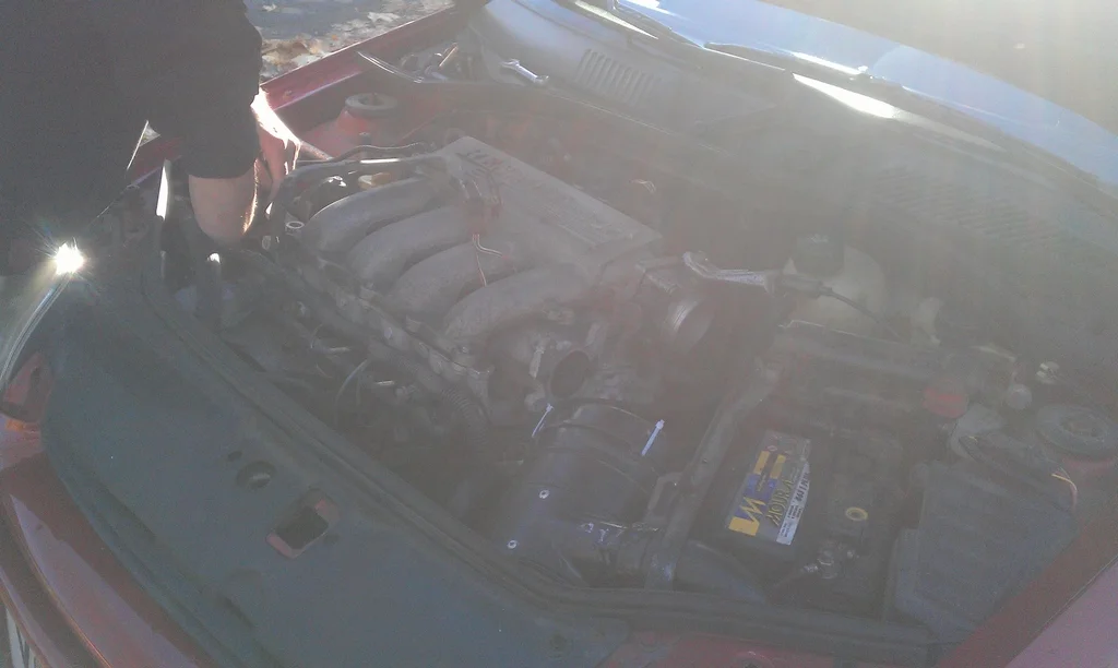

A quick mock up with v6 box, itg filter and 90 degree bend.

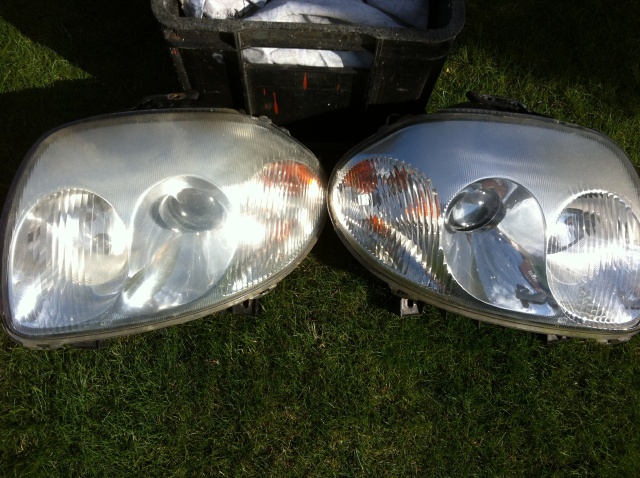

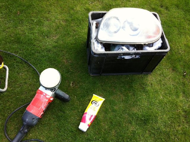

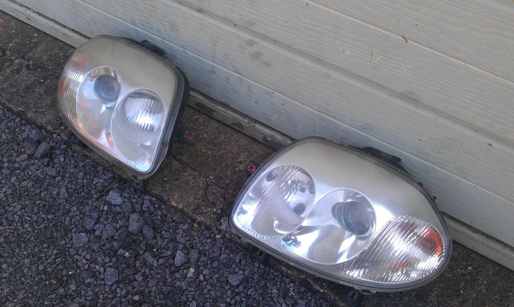

I wasn't happy with the brown tint to the headlights.
So they had to be sorted and my old man did an amazing job with them...cheers popsicle :cool:

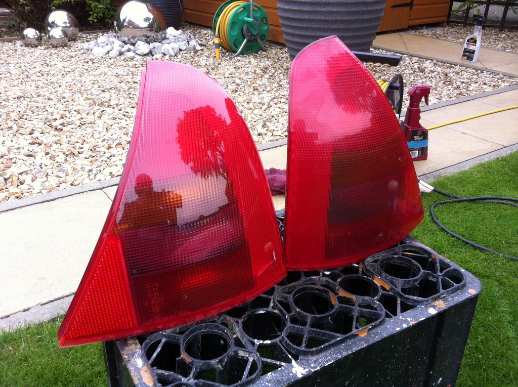

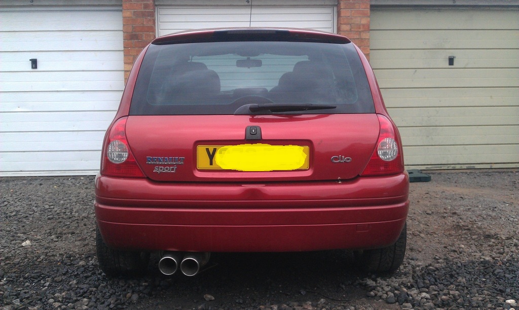

PH2 rear lights. I have yet to rewire.

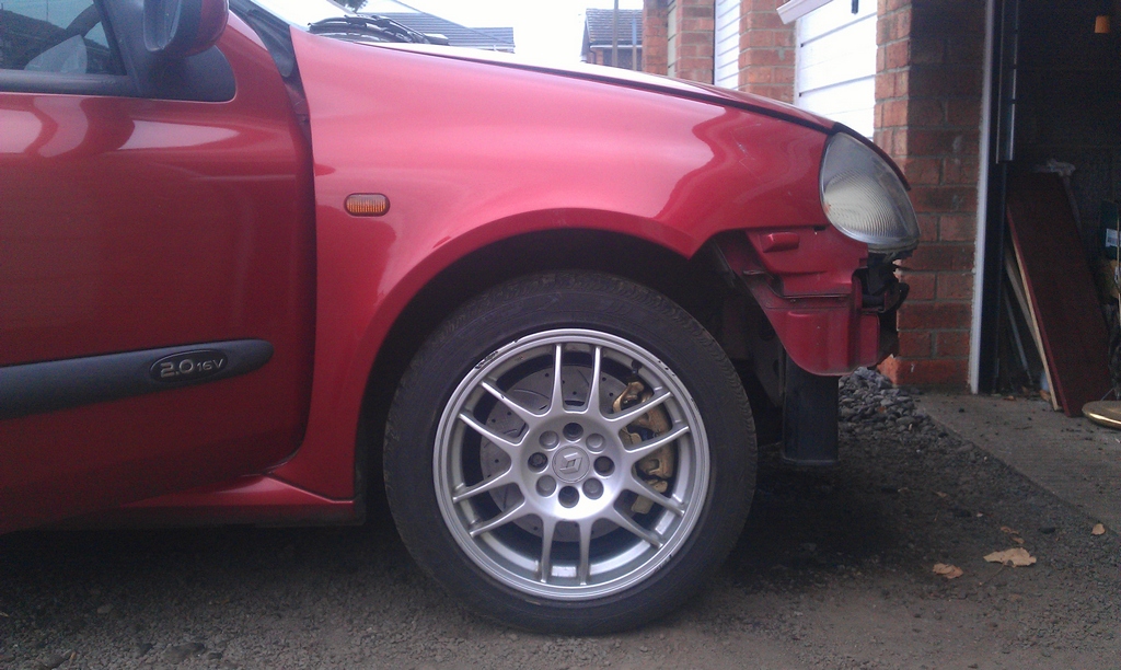

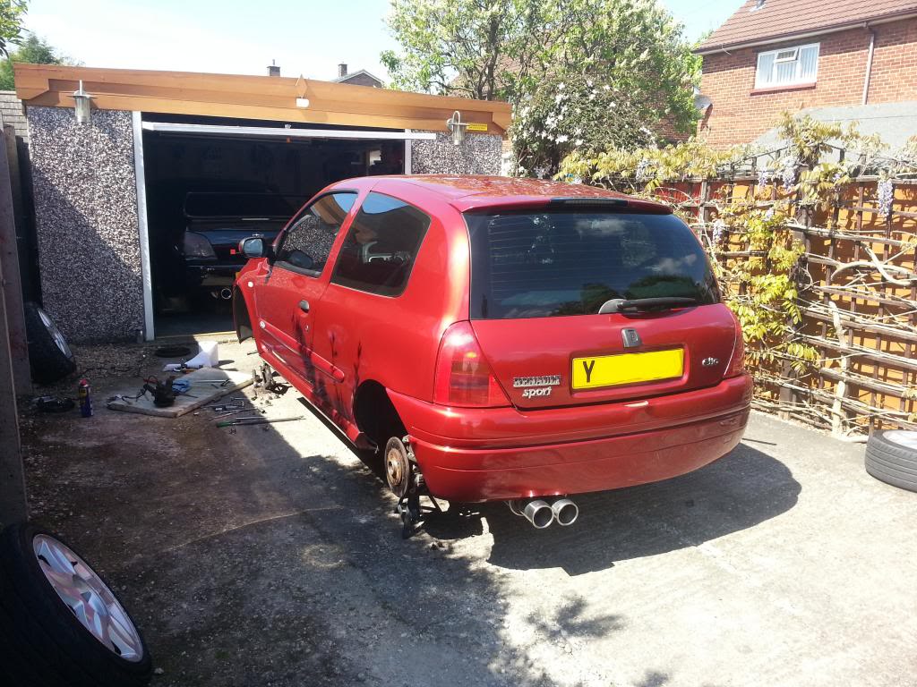

I only get a day here and there to work on the car but managed to fit drilled & grooved discs, brembo pads & new track rod ends today. I was unable to fit the rear as waiting on wheel bearings. I will take some more pic's when I've next got time. I will be changing the back box as well (too chavvy) when I get the decat. Ive still got a long list of things to do but it's getting there slowly.

Why did you remove the engine?
Having no service history and nothing changed on the engine it was cheaper to replace with something newer. As I said before, the car was cheap, as was the engine... It doesn't stand me at a lot so far. It's only the bits and bobs that are totting up.

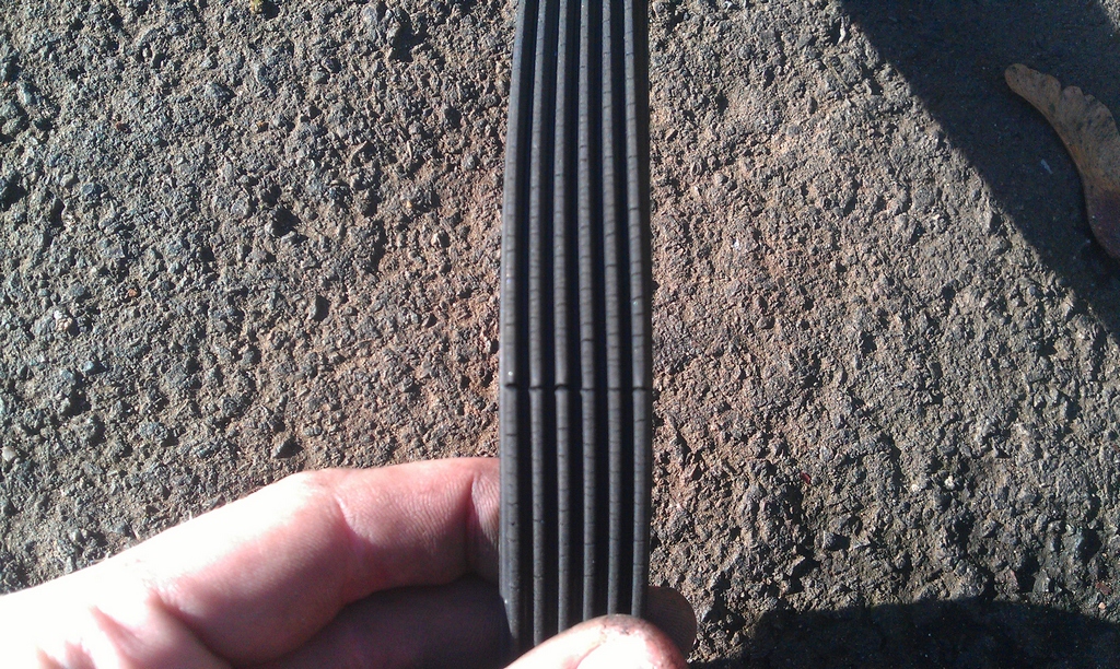

Sorry to DP folks, but nipped to upload some pics. When I first got the car I did a small service myself, plugs, oil filter, oil etc.. but there was a whine coming from the water pump so while changing the water pump this was state of the old belt:
And you thought gillette was a close shave.
Fearing the worse (cambelt) and weighing up options, the car was taken off road for a while to be sorted.

After showing a few comparison pics to mates at work of the rear lights, the jury is still out.. some say keep, some say go back to ph1. Though, one good thing did come out of it. I was intending to strip the interior out and just have two recaro seats & strut braces, but I've decided to keep it as standard as possible so will be placing the ph1 lights back on and just replacing anything that is in poor condition, i.e interior/steering wheel and anything else that needs sorting.
Wrong route narrowly avoided.:S

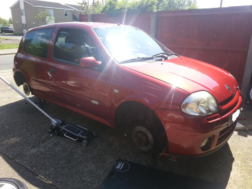

Been fairly busy preparing for mot, had a few problems with abs light with new discs & new abs rings sorted that out.
Decided to keep the ph1 rear lights and had my old man do his stuff on them. O/s turned out to be cracked so will be replaced.
They look great though.

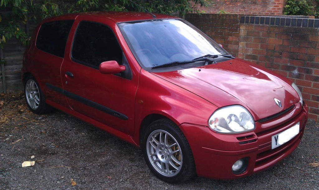

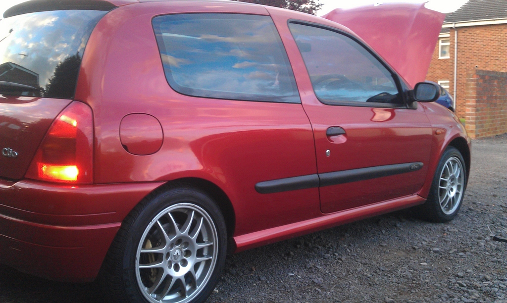

Been busy preparing for mot, s**ting bricks on the day.. never smoked so much. But went through fine with only one advisory - a knackered o/s in door handle (waiting on new ones). so all is well and now back on ze road. Had a chance to colour code the strips, a royal pain in the a**e to do as can't stand spraying anything. Fitted a 8.5 inch single din touch screen along with a vibe sq evo sub (big dnb fan) & have the joy of threading the power cable through bonnet grommet sunday and not looking forward to it.
Should be getting some gold 16" cades eros next month pennies permitting, but this is how it's looking at the mo. still a long way off yet, but getting there slowly.

Thought I'd update an old post to let you guy's know a ph1 flamer is still alive . :p
There's no sub anymore & after sitting for another four months nothing new bar a fabia splitter & 172 alloys.
First time I drove it again I remembered why I loved it so much ;)

I have the original f1's, but three tyres need replacing on them & mot is looming, which gives me time to anthracite the f1's.
Though I really do like these on it.

Still quite a way to go yet, but had time for a few bits over the last few days.
Full brake overhaul & new n/s/f bearing before being cleaned up, previous fluid was literally black. I have no idea when it was last changed :S

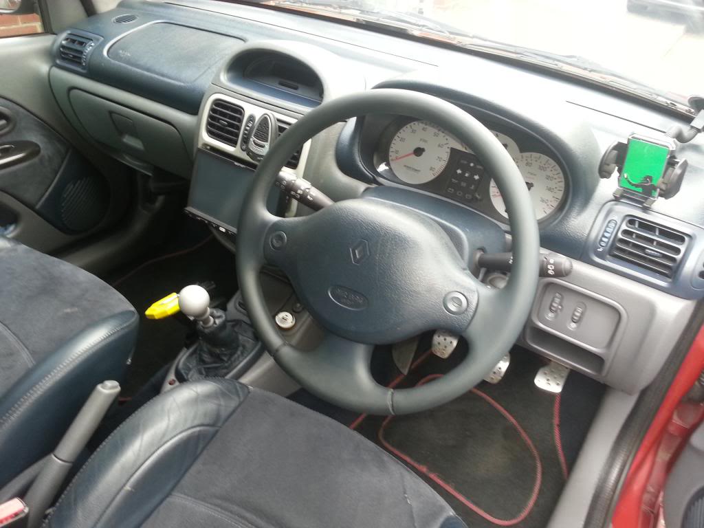

The leather on the steering wheel was way beyond salvaging so it had to go, it feels a lot better with a smaller wheel though.

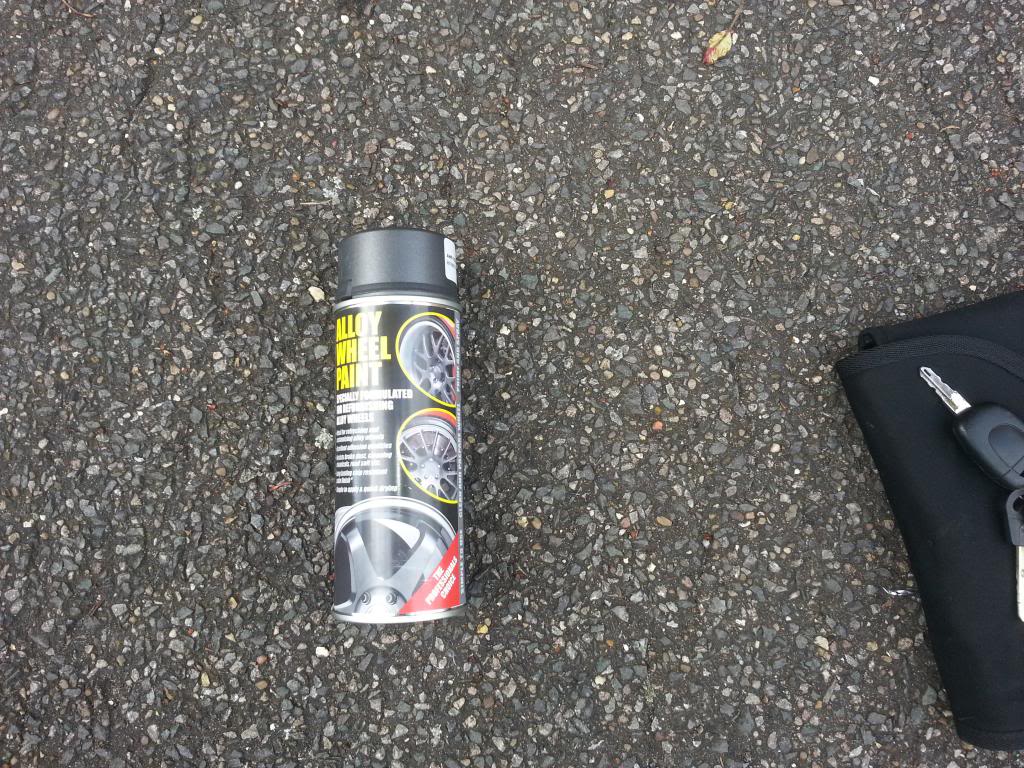

I just want to point out that 'I DO' want the f1's back on the car and then lowered but they need a lot of work, I have three tins of this stuff & will post a before & after.

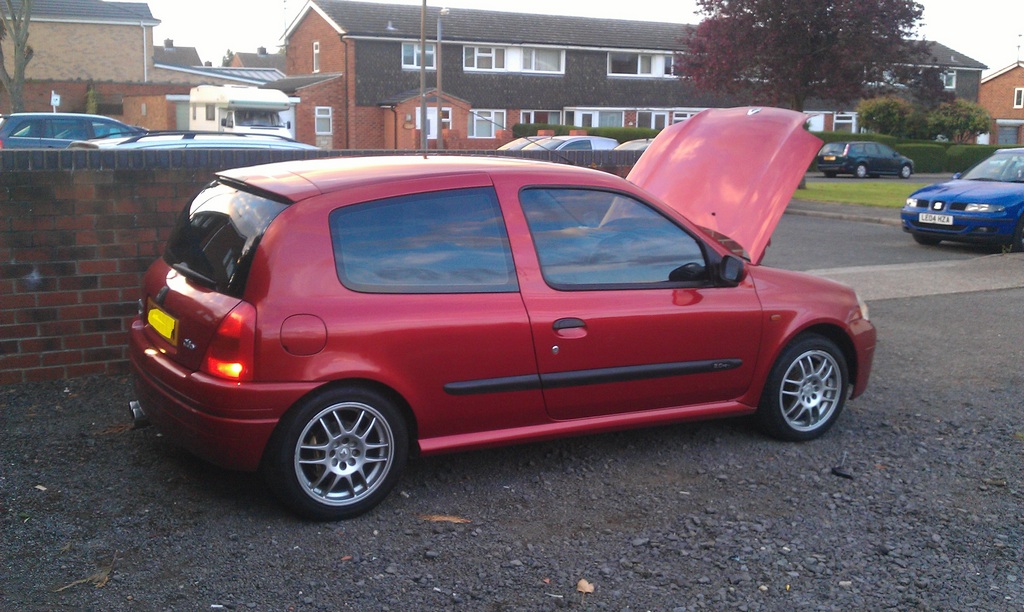

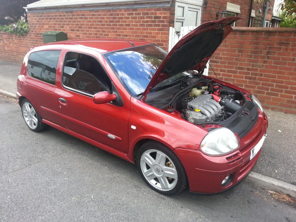

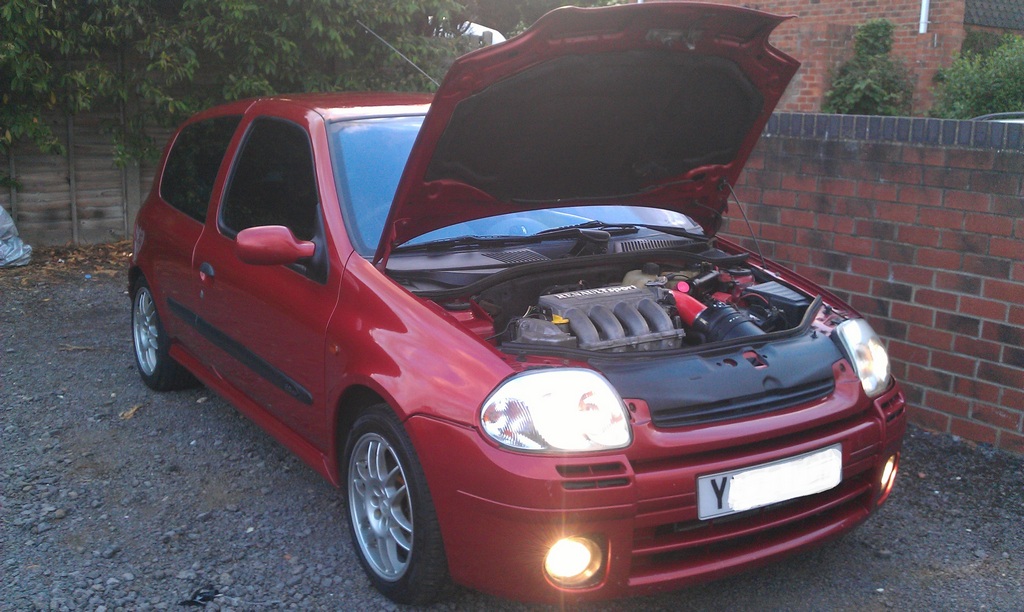

I have a long list of things to do, but here's how it looks at the moment.
