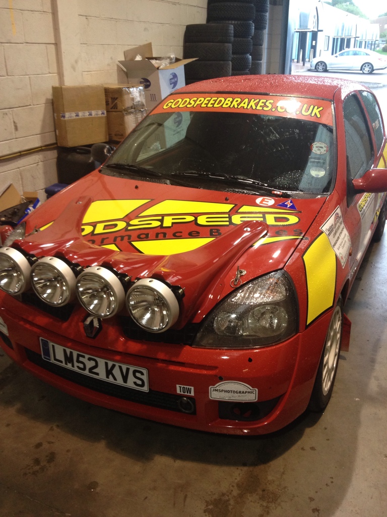

Got my lamp pod down from the attic this week and dusted it off , been there a year , bought it ready for Jersey last year but didn't get the car finished , its a crap fitting pod on the bonnet , so have put it in the best position with the least amount of gaps , started cutting out the fronts and drilling it to fit the lights , will get it all finished today then strip it down to have it sprayed red to match the car , will order a couple of HID kits for it and get it wired up next week , the car is already wired for it and has the plug on the underside of the bonnet

I had one of those for my old TR7 V8, plenty of light, but couldn't see over it lol.

Sorted out the lamp pod , and painted , lamps fitted and HID kits wired in

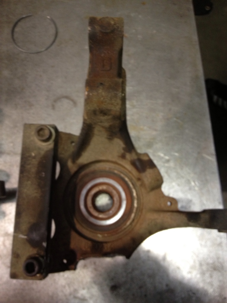

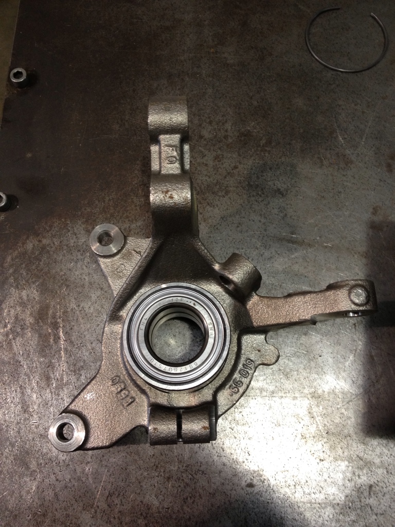

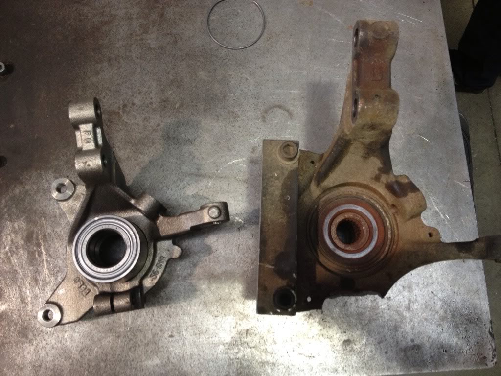

Had the parts delivered by R sport , and they are wrong ! might have buggered up my plans for rallying this weekend now , just taken the old hub off my car and its a lot bigger than the one they sent me , I think they have sent me a standard clio road car hub , even after giving them the numbers from the race car CD , ffs !
The one fitted to my car
The new one they sent me
and the two side by side
Even the bearing they sent me is miles smaller.
I have just had a search on ebay and looked at the laguna ones , and seen a scrap yard has a Mk 1 front hub that looks the same as mine , so have just ordered it , they said they can send it out tonight so hopefully them will and it will fit just to get me back out on the weekend
mikekean
  996 C4S, 135i, E30x2
Yeh thats deffo just a standard clio hub, ive had many a heated discussion about the hubs with R-sport when i tried to order some suspension. Trying to tell me they are just 182 hubs and all sorts, i was just like well i have 172, 182 and Cup racer hubs here and they are all different..
It should just be a laguna hub but you will need to fit the track rod end insert from the old hub as i think they fit from the top on the laguna as far as i know.
