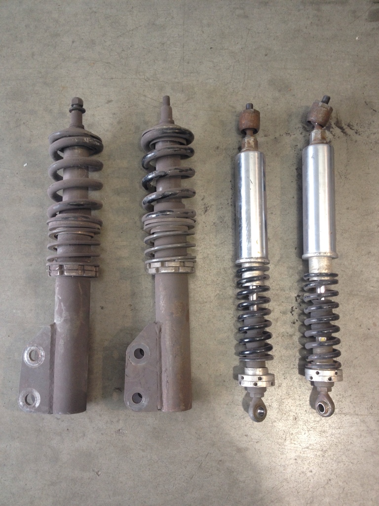

I have just dug out the race car suspension from the attic in the workshop , I'm looking to sell it , I have someone on here inquiring about it so will give them first shout , if they don't want it i'm selling it all for £500
They are just dusty from being stored
Cheers Ian
  Cup In bits

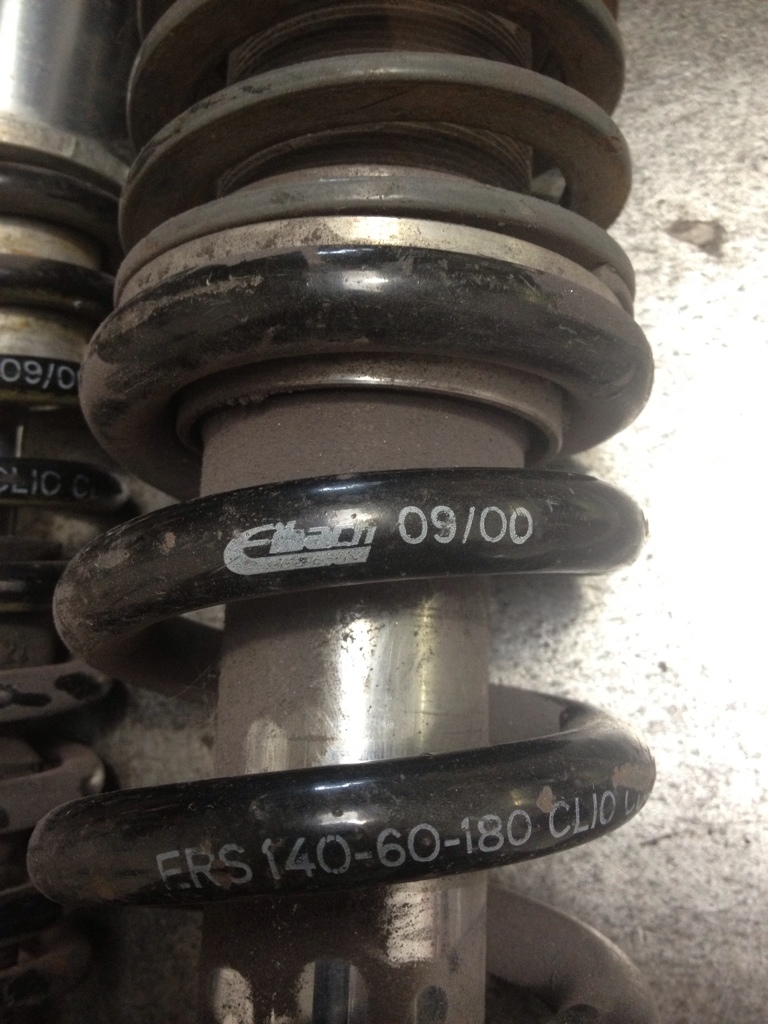

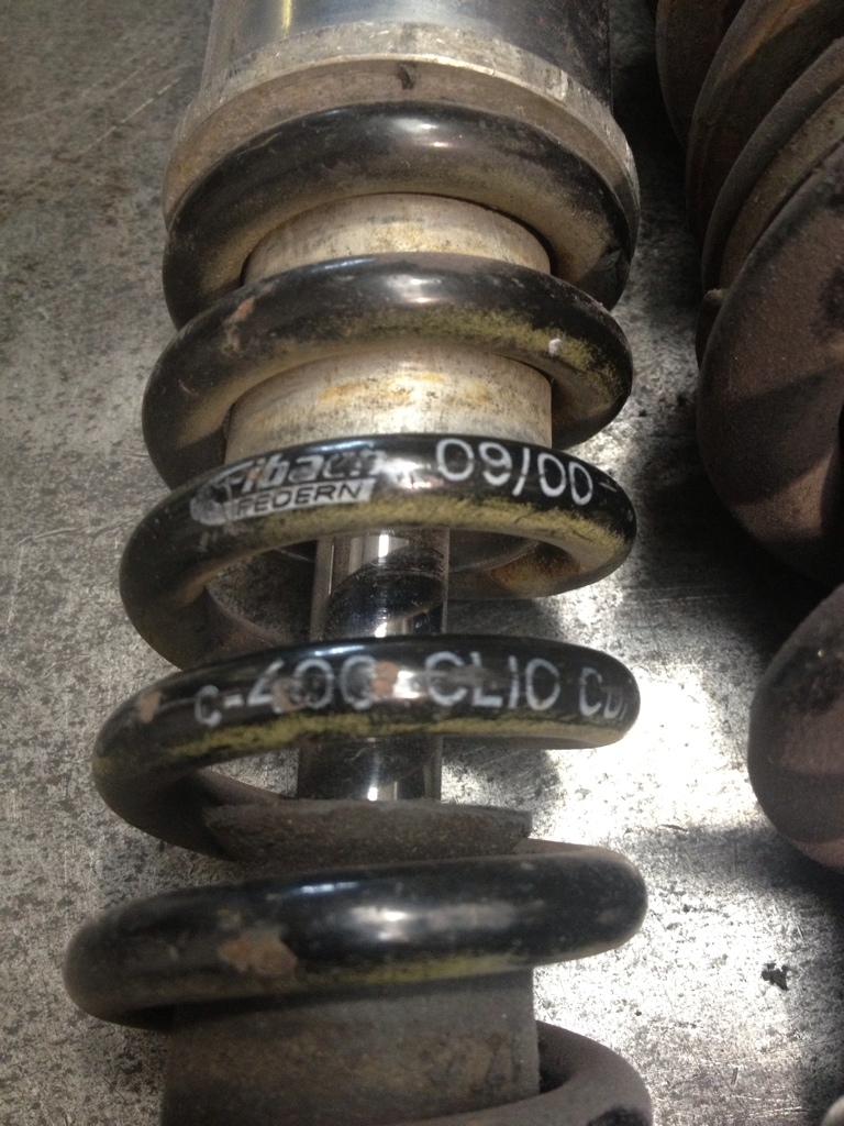

I'd like to know the poundage on the springs to, they appear to be standard clio cup rate the the softer nurburgring dampers were yellow.
These are absolutely solid mark, when you jack the car down and it hits the ground, you would think there is steel rods in place of the struts.
  Cup In bits
Should be close too 80nm front / 130nm rear (Mk2 Clio Cup)
There are numbers on the springs in that image ^
Blond moment, mine still have writing on them but never paid attention, it must say "super fu**ing hard" on them somewhere.
WANT!! What is the front bolt spacing?? Will they fit a Ph1 172?
No is the easy answer, you would need cup racer/laguna hubs, pure motorsport top mounts,RCA pins, uniball holders, longer shafts and cup tie rods and track rods lol or chop the mounting lugs of and have them re welded. The bolt spacing is 64mm and 34mm wide, the bolts are a thicker than 1*2 as well.

Front spring
Rear spring
The bolt spacings don't fit the road car clio as the race cars has Laguna hubs , but it would be easy enough to have the lugs either redrilled and weld a washer in place so it did line up , or cut them off and fit new ones drilled to fit
The spacings on these are 65mm

Front are 1000lbs rear are 500lbs from what i remember in the manual, if its not that then they will be very close. Stupidly hard anyway! £500 is a bargain though and all you need to make them fit a normal 172 is the Strut casing from Bilstein, they do make them as thats what B14's use. Ive fitted B14 inserts into my cup racer casings so i know it works.
