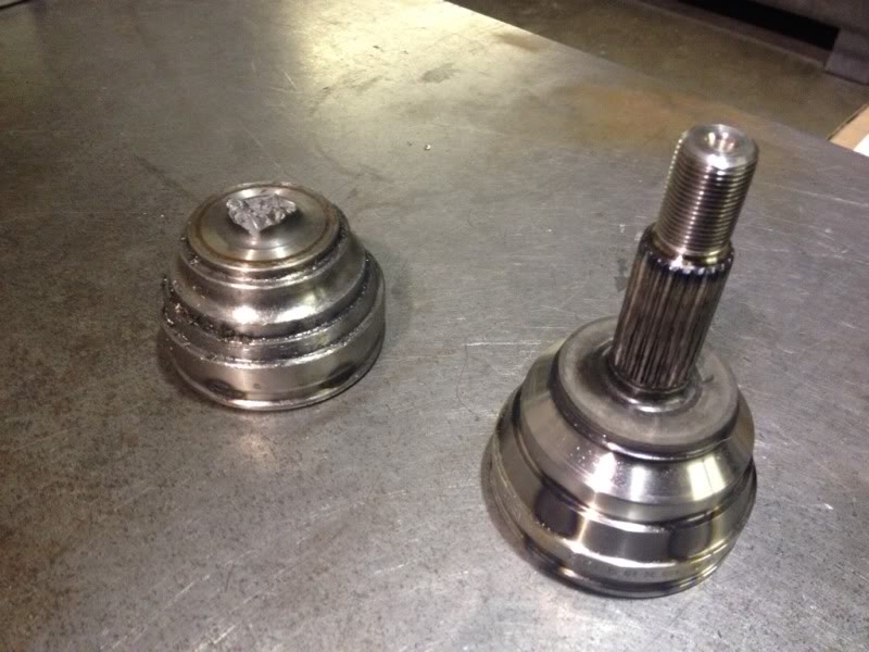

Well finally got the car on the ramp today to strip it down to send the shaft back , was told by one of my mechanics on the rally that the shaft had snapped flush with the CV joint so naturally assumed it had snapped in the same place as last time on the circlip groove , well it turns out its not ! it snapped the CV joint itself , on the outer splines , so I guess I had better ring the guys who made the shafts and apologise for chewing his ear off lol. and then chew his ear off some more as the CV he sent me is not up to the job.
So i'm trying to locate some genuine Renault ones unless GKN can supply me some uprated ones , there are plenty of cheap ones flying around on ebay , even the local motor factors do them for around £20 each , but I think thats what has been sold to me and broke so quickly.
Firstly I need to find out what CV joints are fitted to the cup race cars , I bought a non running 53 plate 172 yesterday for the panels , I had the outer CV's off it and they don't fit on my shafts , my shafts are too thick , anyone know if they used the Laguna ones as well as the hubs ?

The shaft I had made the other week , the same company also supplied me an outer CV joint , this was only £35 and they had them in stock so it must be off another car not a special one off , i'll ask them tomorrow what they supplied me , but was hoping asking on here that someone already knew.
  clio cup race car
Just had a look at my shafts and CV's , there are 25 splines on the end of the shaft and 23 on the CV joint

Ever since i uprated my shafts i have always snapped outer CVs (end of the spline where it mates up to the Hub bearing) guess as the material used doesnt have any give (twist) the the load spikes it gererates as a result causes the problem. Not sure if there are and larger CV that could be used of a diesel etc.

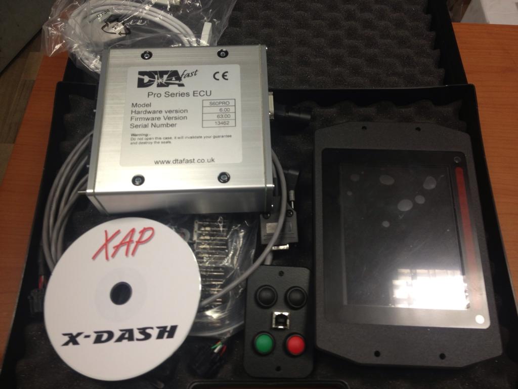

I'm fitting a DTA ECU , was going to go for the S40 but then was told it wouldn't run all the features on the XAP X-DASH , so went for the S60 , so they arrived this week as well

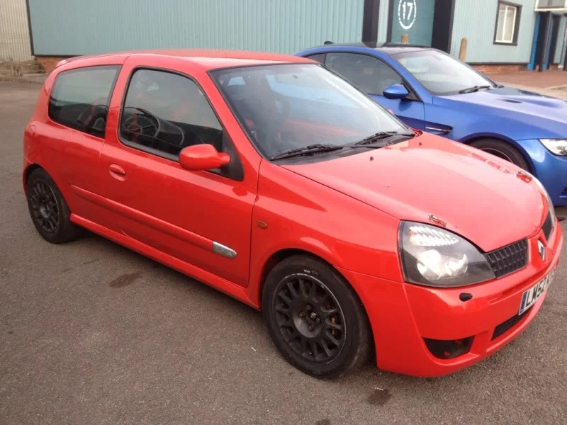

Went down to the workshop to drop it off at the electricians so took a couple of photo's of it looking fresh , pictures make it look a bit orangey , but its a nice bright red
If I could figure out a way to fit the engine and box out of my M3 it would certainly shift then lol :D
  BMW 330ci sp/ 172Cup
That's quite a combination of cars you have there! The M3 looks very purposeful with those wheels on it:)
Clio looks to have come out well too. Bet you cannot wait to get the new motor in it.

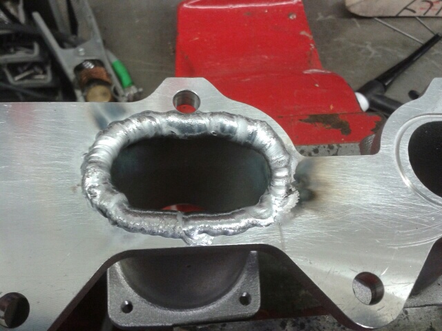

Found a problem with the Jenvey inlet manifold which I'm sorting out as the engine is off to the dyno on wednesday , they have started machining a groove on the face that mates up to the head which you fit an 'O' ring into , the problem I have is my ports are too big and the manifold needs opening out to the groove , so I'm having to weld up the grooves , I'll machine the ports to match the head , and skim the face of the manifold to give me a flat surface again.
I asked Jenvey for a flat manifold but was told i'd have to pay extra for it , and would have to wait a couple of months until they made another batch !
What a pain in the ass !
I read up about the Cnc head the other day and sounds very impressive. I look forward to seeing what yours makes! I would really struggle with my AT ITB's I guess. Hope you get sorted Ian :)
  clio cup race car
Could you not have just put a gasket on it?
Yes that is what I am doing now , but the port in the manifold is smaller than the posrt in the head , i'm welding the groove up , machining it flat and porting the manifold to suit my ported head , and fitting a gasket on
