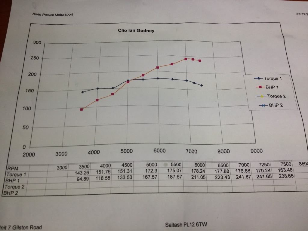

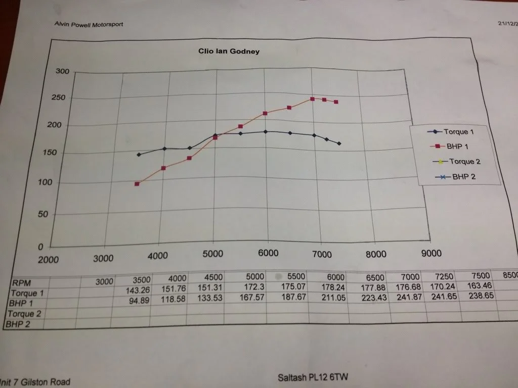

Any graphs would be good to compare to my 2 engines ?

Great torque curve from 5-7k, very similar to mine 172 engine but flatter and holds on at the top end like my F7R one in the pink car.. I bet the head will have something to do with that. Will go very well :)

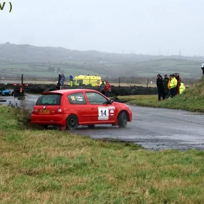

And slightly over cooking it coming off beach road by the pumphouse but just got away with it as I thought we were going into the field
Great photo, pity it wasn't the last stage, that'll need detailing again.^^^^^^^^^^^^^^^^^^^

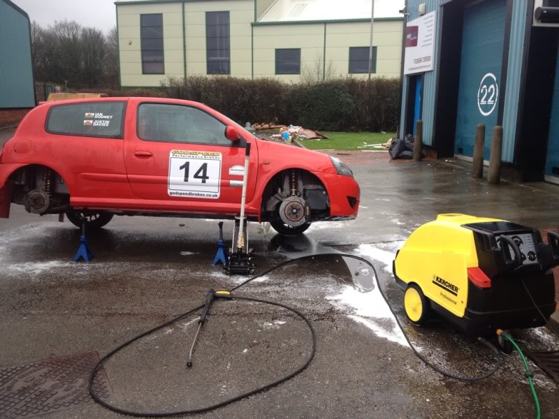

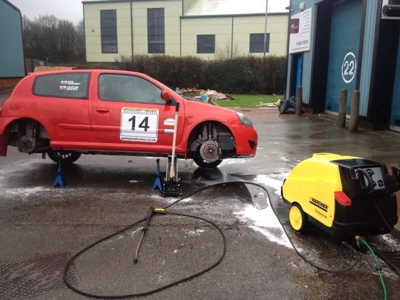

I gave the car a good clean yesterday , got it up as high as the jack would go so I could get underneath and found a big clodge of mud around the bottom pulley , it would seem it picked it up going through the big puddle above , spoke to a mate of mine who said I made a big cut on that bend , as there was so much water there you couldn't see where the road was , I can see that I can blank the gap off between the sump guard and chassis with some mud flap material so it should stop that happening again.
Its all looking pretty again , so will start stripping it down and fitting the new engine in over the next week and get it over to the electricians so he can finish the new engine loom and wiring up the X dash.
Will get the BTB exhaust modified to fit the 182 manifold before I send it off for wiring

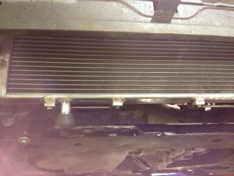

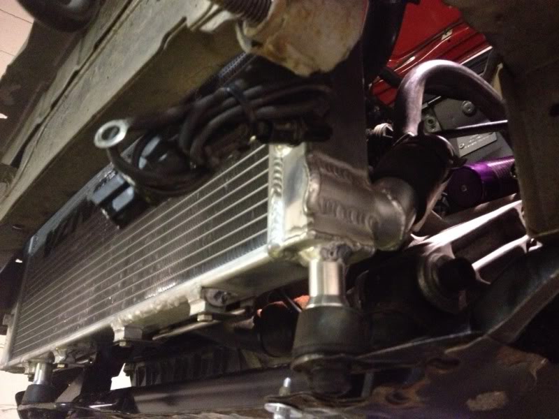

I bought one of those ebay alloy Golf rads to fit but its not a perfect fit , so bumped into a friend of mine in Pembrey who makes alloy rads and tanks , he did all the alloy tanks ect in the M3 rally car I built in this thread , so i'll get him to make me a rad which is a perfect fit , will make it larger than the golf one so it will keep the car cool on even the hottest rallies
At least my jet wash is hot so kept me warm in the rain while I was cleaning it off lol

http://www.cliosport.net/forum/showthread.php?668668-brand-new-50mm-core-alloy-radiator
Have you looked at this radiator? it has been on sale for a while, it's the same as mine and im premusing the same as your's where the radiator almost touches both chassis leg's. This one has less length so would give some more room.
  clio cup race car
I bought my rad from these
http://www.ebay.co.uk/itm/230726159046?ssPageName=STRK:MEWNX:IT&_trksid=p3984.m1497.l2649
It just seems a compromise , it would do the job I guess , but needs faffing about welding lugs on to fix it in place , and brackets for the fans , and then it could be a better fit , so i'll get one made for the job which uses as much space as possible and fits perfectly , i'll use the one I bought for my Golf rally car so it won't go to waste.
The rad I have doesn't touch the chassis rails and could be longer and taller
  Cup In bits
Yeah I think you have bought the narrower version to mine (same as in the sale thread)
It does need a couple of lugs welded etc to use standard mounting points so your best getting something custom if you can, I couldn't swallow the price tag on a custom jobbie, at least your 80% there with a golf rad.

I've spent silly money to date so £300 on a rad won't hurt lol

Yeah 300 ain't to bad, from quotes I had I was looking at 550 which I thought was extortionate.

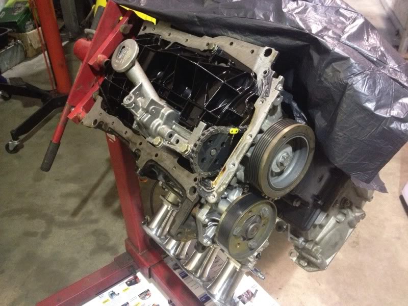

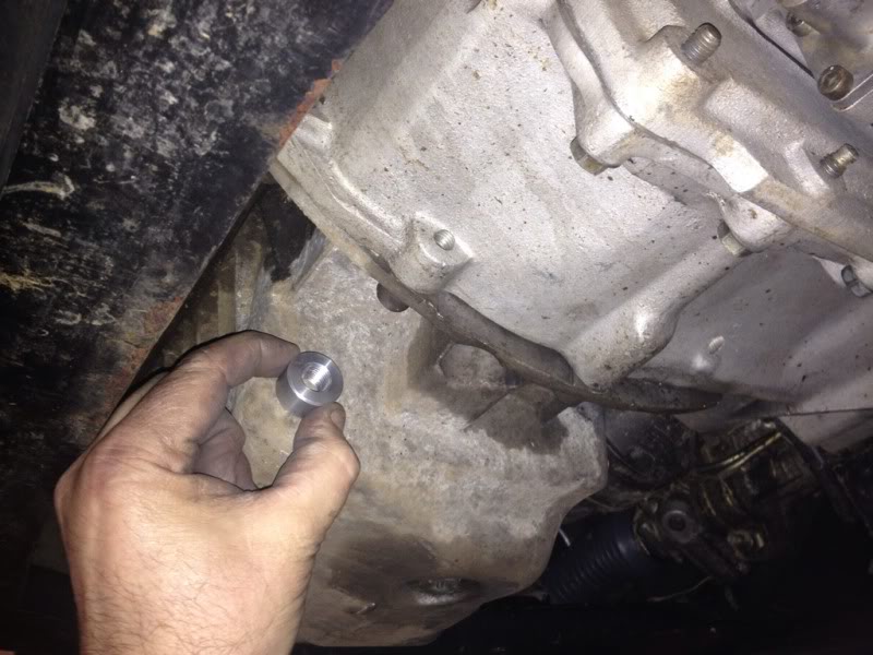

Made a start on getting the engine stripped out , have removed the sump on the new engine ( sorry Fred lol ) to weld on a boss for oil temp
Had a look to see where the best place to fit it and chose here
Made up an alloy boss and drilled a hole in the sump ready to weld it on.

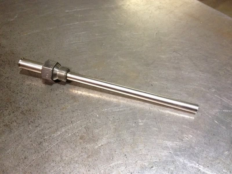

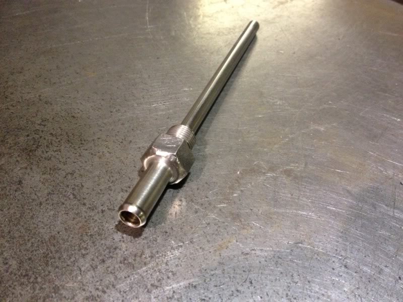

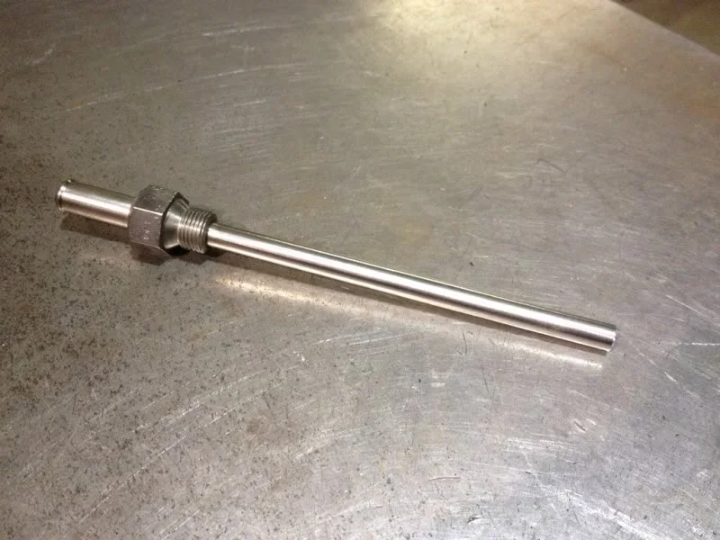

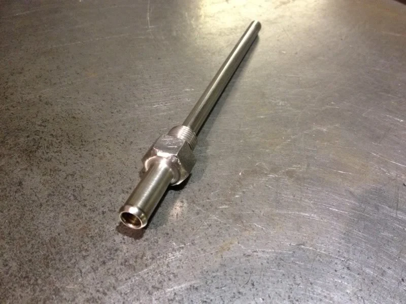

Was also thinking about welding on a tube to fit a drain from the oil catch tank I'm going to have made , but then thought its something that could cause trouble if it broke off getting hit by something , which would result in losing all the oil , so am going to make something out of the oil level sensor
Going to either modify it or make something similar , so it will have a hollow tube running through the part that threads into the block , and will drain any oil from the catch tank into the sump , but with the tube lower than the oil level so it will work as a drain and not a breather

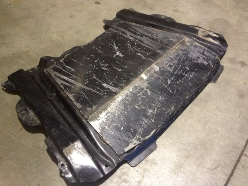

For those asking how I modified the standard Renault metal sump guard , I have welded 2 plates on to beef it up , and its done a very good job bar the rally I did the big jump and bent it , which you can see by the battle scars lol
Thats about it for the moment , should have the engine in by mid week , just deciding wether to change to an AP racing clutch at the moment , oh and have ordered a heated screen which is being fitted on friday as the rally I did last week it will misting up on the big puddle we had to go through

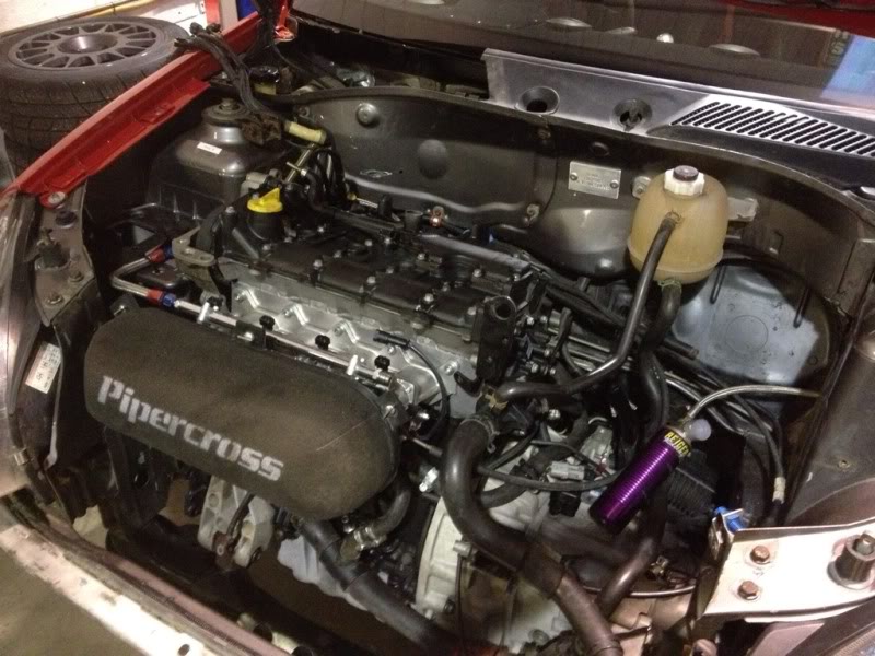

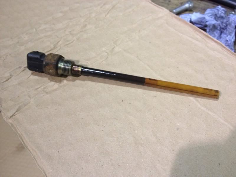

Getting there with the car , engine and box is in , just getting all the other bits done , finished off turning the oil level sensor into a drain from the catch tank , will get a tank fitted onto the N/S inner wing
Decided to use the alloy rad I bought on ebay for the golf , I did think it wouldn't fill the gap but after trying it in place it seems to fit quite well , have made some tubes and welded them onto the bottom of the rad to sit in the original rubber bushes , I have changed the bottom outlet pipe so its the same as the original rad , and fitted brackets to fit the two 10" fans

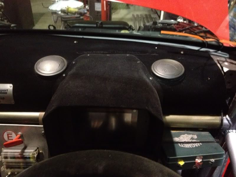

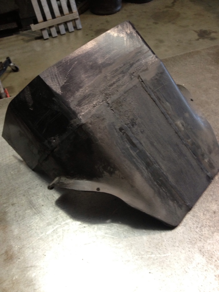

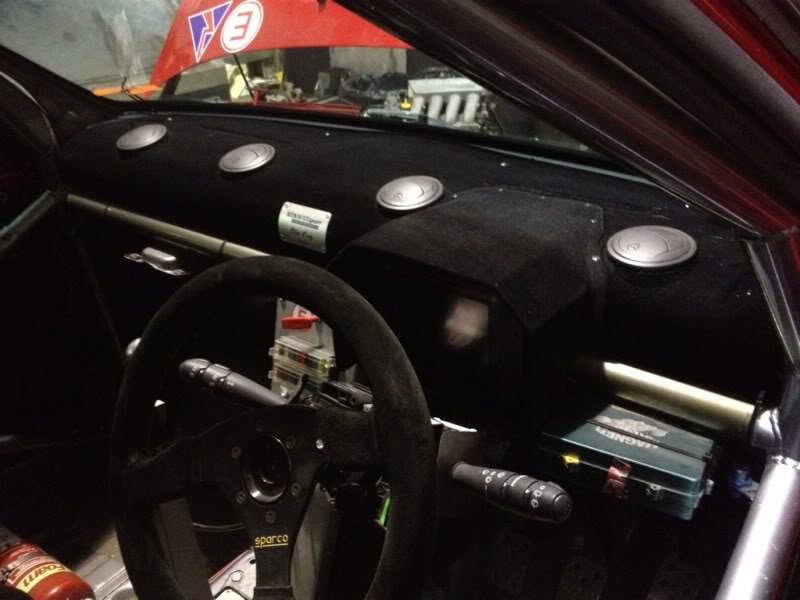

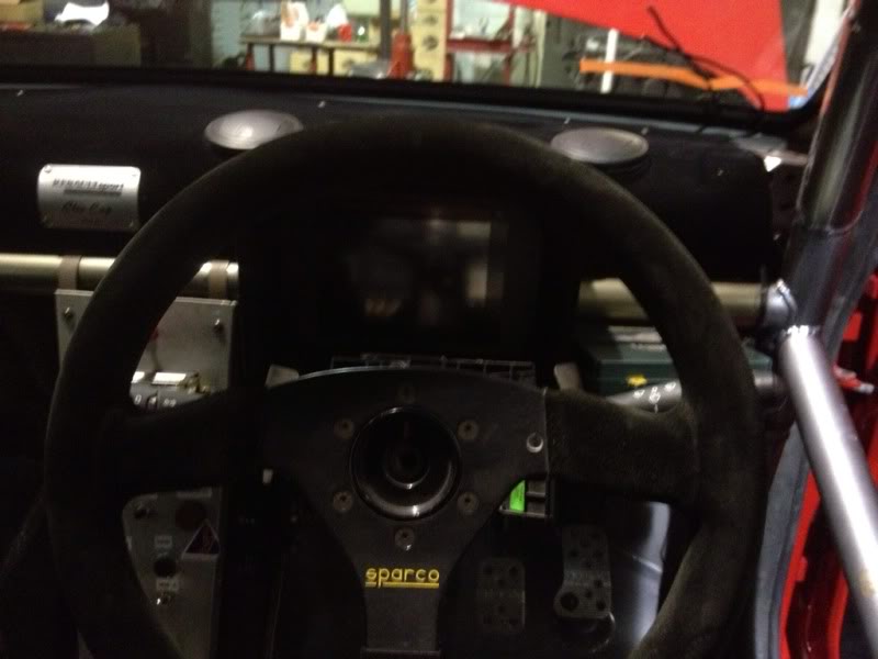

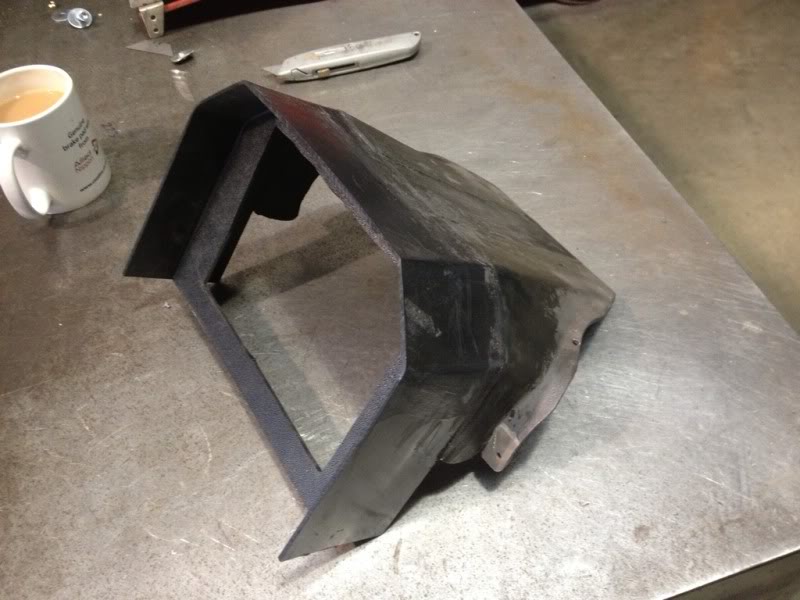

Finshed off the dash top and had it flocked , riveted it back onto the dash , it turned out really well , had the cowelling widened and legthened so the new digital display fits and it looks really good , I had a company round the corner to me plastic weld it up for me , and a mate of mine does flocking so sorted that out for me
And here's the finished job all back in the car
Close up of the dash , will take some pics when its wired up and working , they look good lit up

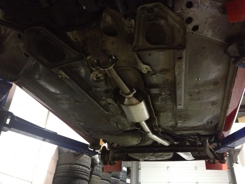

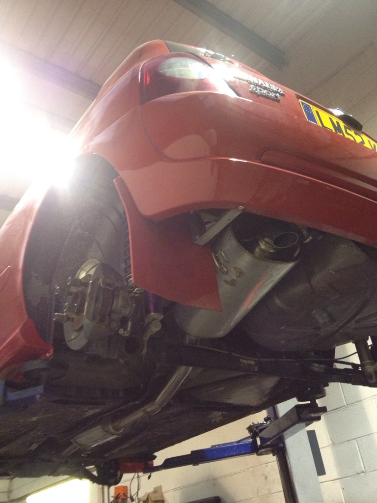

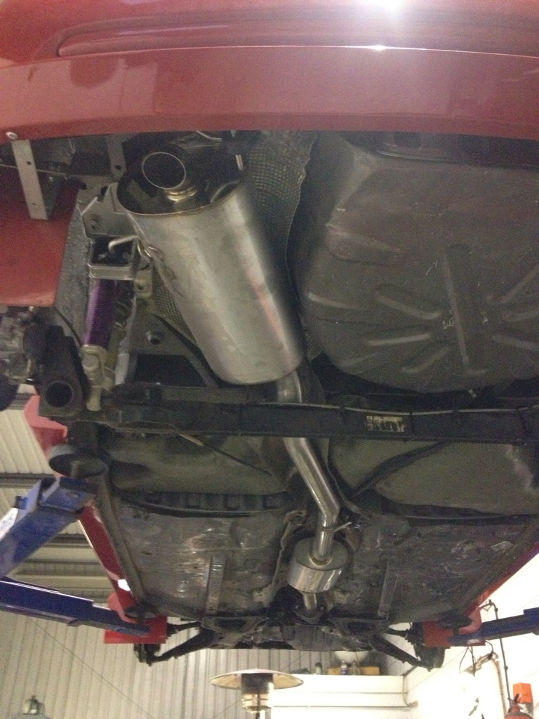

Got the exhaust fitted on , I bought a decat pipe off a member on here and used it to fit the BTB system onto the 182 manifold , the system is well made and a very good fit
