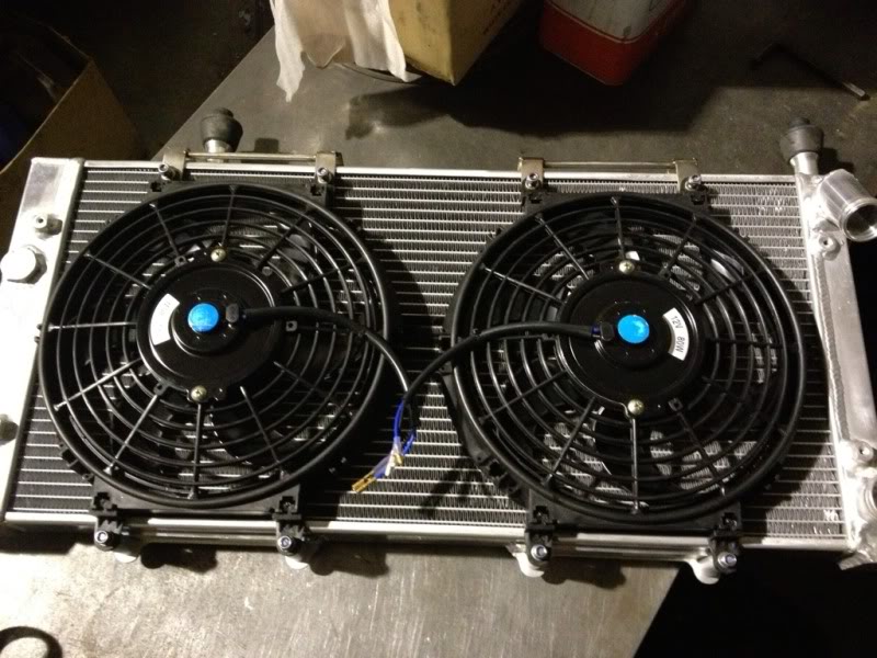

Took some better pics of the rad after being modified , I took it off tonight to fit the alternator
Fitted some brackets on to fit the 2 x 10" fans I got off the same people I bought the rad off , its just about ready now to drop off to the electrician tomorrow
Rad looks good Ian, where did you get the brackets at the top of the pic? Im going to get my inlet angled up as well. Did you need to buy another piece of pipe or was there enough length by cutting and shaping?
I made the brackets and turned down a new piece of pipe for the outlet as the piece we cut off was too short , it turned out ok

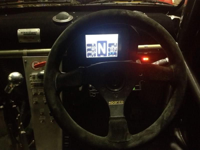

Got the car back from the electrician last night so did some more work on it today to finish off all the bitty jobs , its the little jobs that seem to take the time , made a plate to fit onto the rocker cover to hold the coil and the can for the front O/S suspension , filled the engine with water and got it running , it definitely needs work on the cold start map , so hopefully get it back down to plymouth the end of the week for the fine tune on the rollers and out on the road.
Took the dash top off and tidied the wires underneath , and moved the heater pipes about as the dash wasn't sitting properly , will have to speak to DTA as am having some trouble setting up the dash , but so far so good , it didn't want to start first thing and put it down to the battery on its way out , its turning over ok but not firing up the spark plugs and injectors , as soon as you jump it from another car it starts , so will get a new race car battery ordered on monday

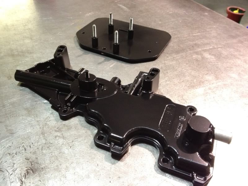

Getting somewhere with the car now , just finding time is tricky at the moment as I'm so busy in work , I have modified the breather plate on top of the engine , have drilled it and fitted a second breather , the original one is still there , so will pipe the 2 breathers to a catch tank we are making , which will vent to atmosphere but also drain back into the sump , I have welded a blank into the pipe on top and fitted some threaded bar into it and made up a plate to hold my coil pack and suspension canister.
Made up brackets for the top of the rad yesterday afternoon so thats all finished , need to make a bracket to hold the ecu inside the car , got someone calling up the workshop this morning to download the settings for the gear display into the ECU so the dash can read it , had delivery of a stack oil pressure sender yesterday so will get that fitted monday , got a few small jobs to do , if I can get them all done in the next couple f days , I'm hoping to get the car down to plymouth on wednesday for the final mapping session then I can do pembrey on sunday.

With this type of catch tank and return to sump do you fit baffles and some kind of filter to alow the crap in the oil to stay in the bottom of the catch tank, also do you top the catch tank up to the return oil feed level to keep the oil level correct in the engine, or is none of this required.
Regards Russ........
exactly ! what crap ?
Its only engine oil that can come out under extreme conditions , which will be caught by the catch tank and make its way back to the sump , there will be no crap in it , as Fred said it will be fully sealed bar the small type K&N type filter which will vent any pressure but stopping any crap getting into the catch tank.
Yes the catch tank will be baffled
Cheers Ian
Only thing I can think of is the condensation created during warm up is going to stay in the oil rather than being burnt like on road cars or staying in the catch tank like on traditional catch tank systems. I get more water in mine than I do oil.
true you can get a wee spalsh of water but you can keep an eye on that easily enough, Ian the mocal tanks are vented anyway so no need for a breather filter

we are making a tank so it fits nicely in between the back of the N/S headlight and the strut tower

Finally got it 99% finished , had some electrical issues and it lost its spark , think it was a wiring fault on the back of the ecu , the electrician came up to test it and said it was ok , so was onto DTA who said it couldn't be an issue with the ECU so was piggy in the middle for a while , electrician had to come back to connect my stack oil pressure sensor and redo the gear display sensor as he'd wired that up wrong , and had another look inside the car and it worked.
Had the car down Plymouth yesterday for the final mapping session , my car is slightly under 3.5 bar fuel pressure which it had been mapped to so he had to make quite a few adjustments , took it out on the road for the final tweek and couldn't feel anywhere that didn't feel right , so no more changes were made.
Am I happy ?? you bet your fooking life I am lol , it absolutely flies now , it gets up to the limiter in 6th in no time , cough , on the private roads outside Plymouth :D
