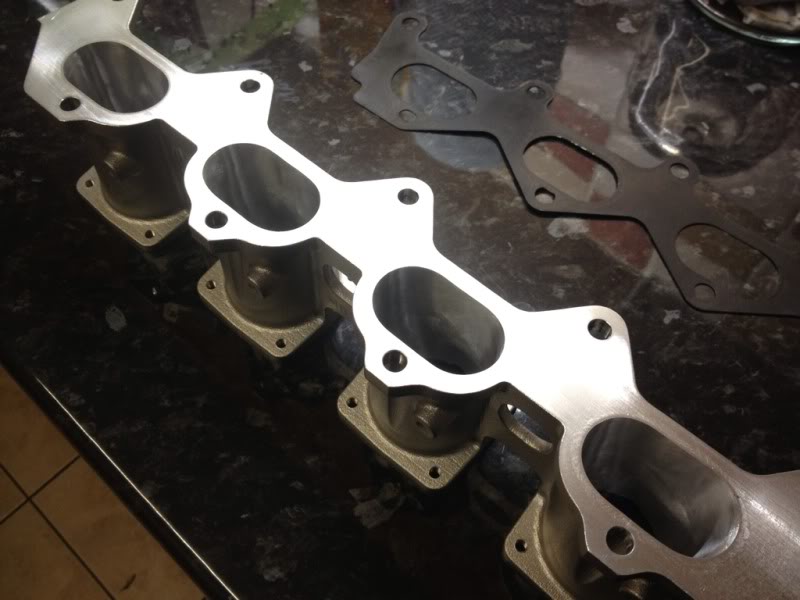

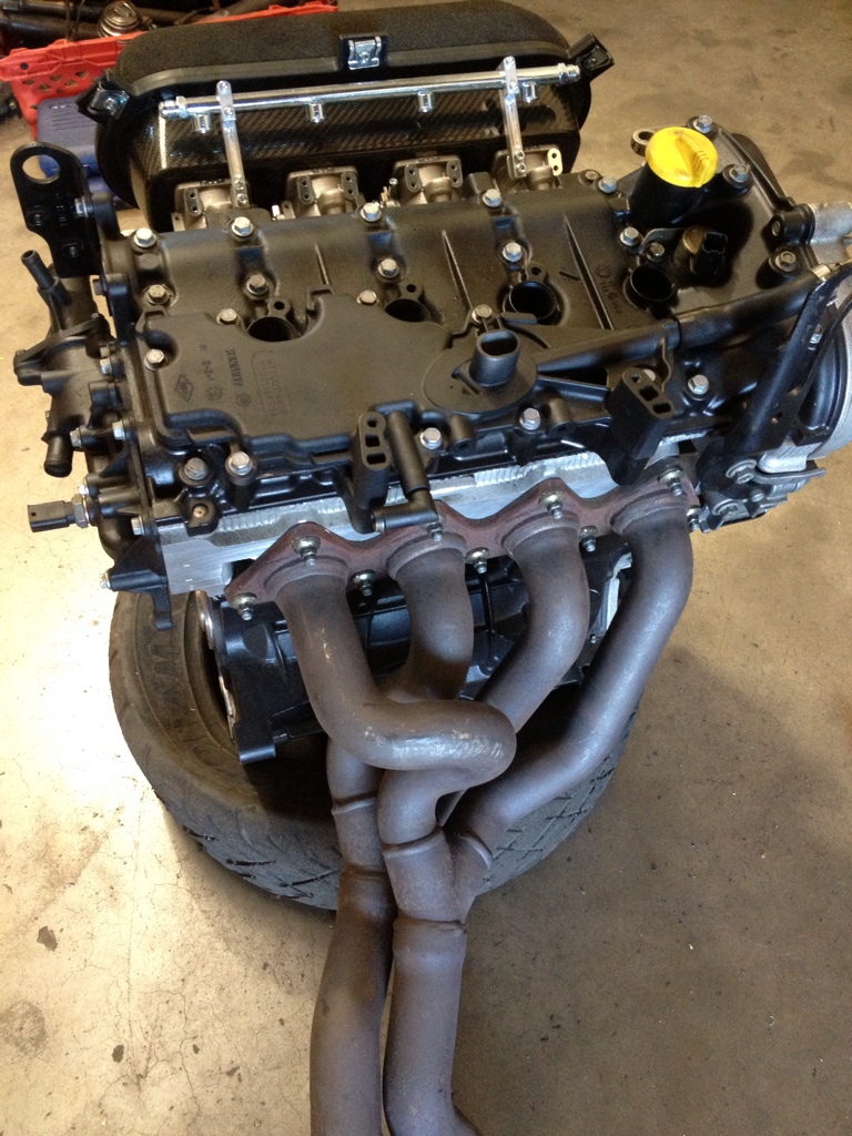

Just thought if you were opening the ports out you would end up removing the groove? But I assume its going to be right in between and leave you with part of it?
If you've got TIG facilities then I suppose its not too big a deal, but appreciate its still a pita! I take it there wasn't enough meat on the flange just to skim it down and take out the groove?
  BMW 330ci sp/ 172Cup
We had exactly the same issue on our inlet manifold/plenum as we used a jenvey mr23 to the head. Our head ports are pretty big too. We initially just used a std gasket but it had a very small leak. We still have the o-ring groves so we got some rings from Jevey and they seal fine.
However, if the manifold was properly matched to our head the groves would be history! Shame they don't machine them 1-2mm bigger all round.

sorted the manifold out on the weekend and its a perfect match to the head now

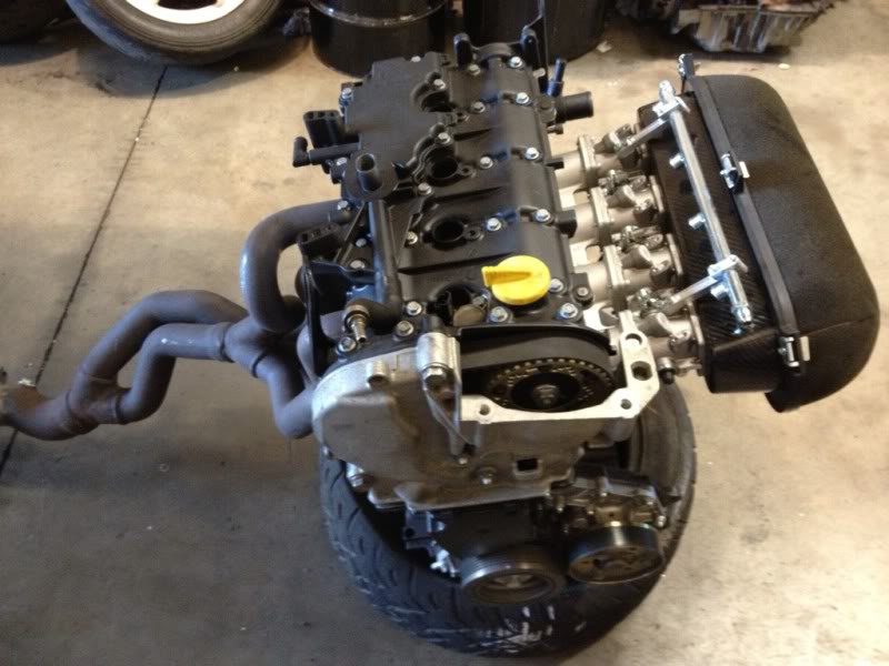

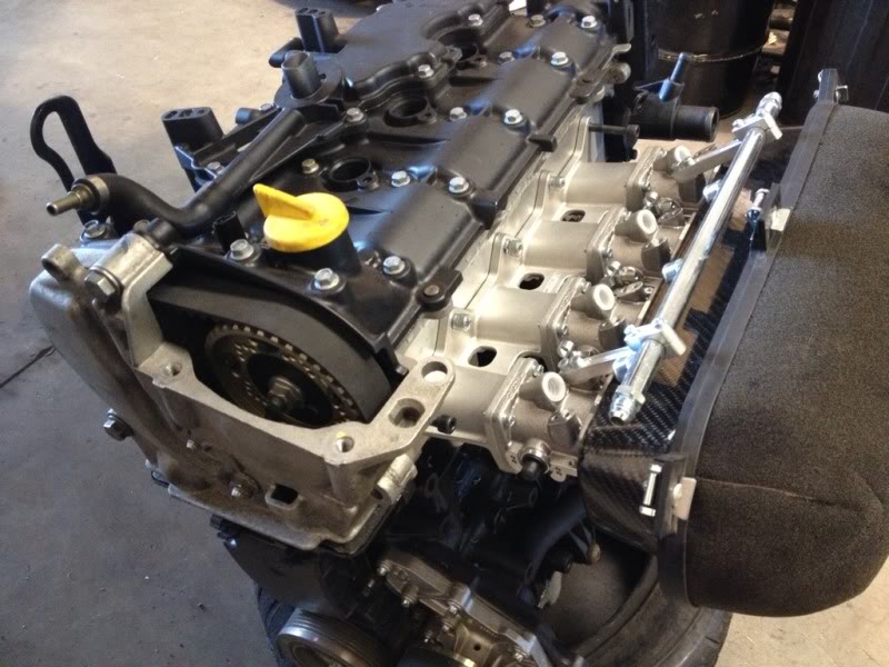

Finally managed to get the engine to the dyno yesterday in plymouth , it will take around a week to do so with the hold ups this week I'm going to struggle to get it back in the car and rolling roaded before christmas now , just seems to be dragging on now and getting fed up of it lol , I cut a section of gearbox out from the knackered box I bought off Jay Kay so managed to mount the crank sensor , that wasn't as straight forward as it should have been , the holes in the bellhousing are 12mm , but the bolts are only 10mm , when fitting the section onto the engine it was able to move all over the place as the bolts were loose in the holes , so I had to machine the end of some 12mm bolts down and re-tap them with a 10mm thread so they locate the bellhousing section in exactly the right place.
I ordered some Megane 225 injectors and got them overnight , but the spacer bar on the Jenveys are too long and the fuel rail didn't fit onto the injectors , so they are sending me a shorter set which I will just send onto the dyno guys , just need to put a pressure gauge on my fuel line now so I can tell the dyno guys the exact fuel pressure my car has so they can dyno it at the same pressure.

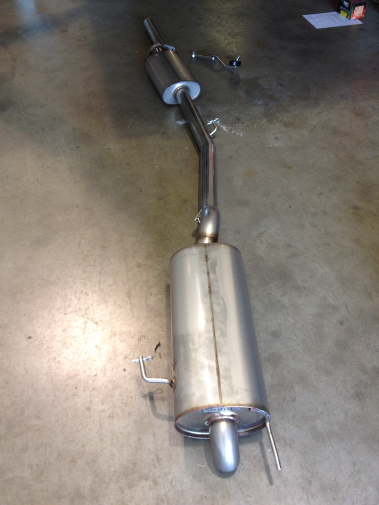

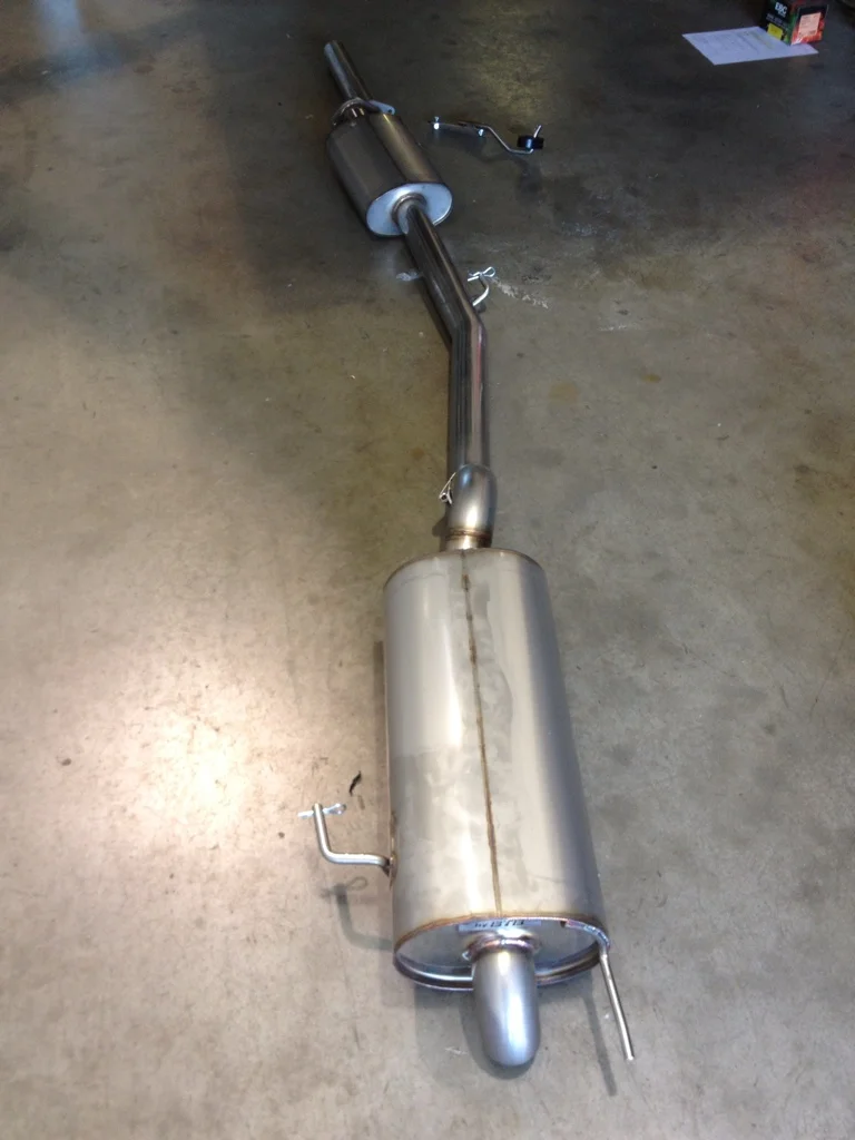

I have ordered a BTB twin box stealth exhaust which will be with me tomorrow , so I'll have to modify it to fit onto my 182 manifold , they are also sending me spare 182 flange as they think they are different to the 172 one , so I can fit on which one fits the manifold.

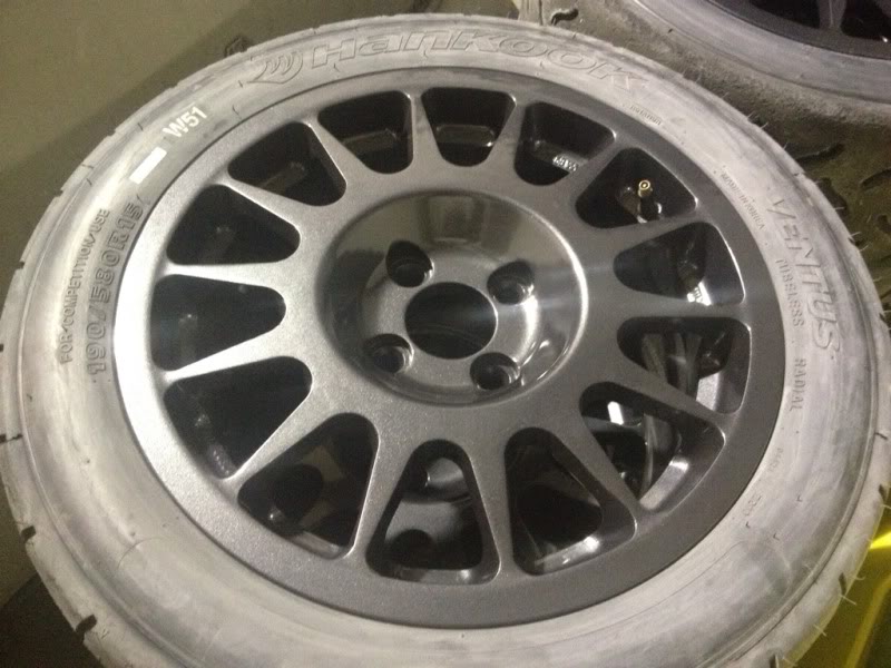

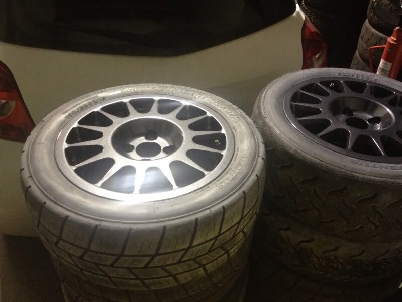

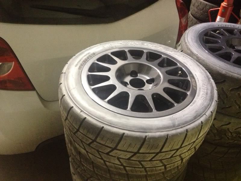

Had my wheels back from being sprayed , well I have had 12 of them done , i'll fit 4 on the car tomorrow and they can have the 4 that are currently on the car and do them as well , they have come out well
Will be looking so nice with the respray on the car and wheels it will look too nice to use lol , and with the extra grunt , I can't wait to get it out on the stages now

Got the exhaust first thing this morning , got an extra flange and a short piece of pipe as well so it can be modified to fit the 182 manifold if needed

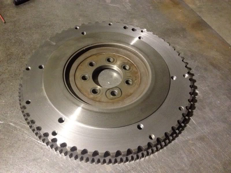

Spoke to the dyno guy yesterday and I had to modify a flywheel to suit there dyno , the adaptors he has fit onto flywheels for AP competition clutches , so I have machined the standard flywheel and will send it up to them tomorrow , he's hoping to have it started before the weekend
I had to machine it down on the outer edge so there is a step where the clutch plate touches , then drill it to bolt the AP cover on , there dyno picks up on these points
I have just had my clutch plate redone with new pads , but I am going to see if I can get a proper AP racing clutch that will fit my setup as I now have a flywheel to suit , I have had some issues with even the Helix cover slipping when the weather is warm and the slicks are nice a sticky , it has slipped a few times at the stage start , so i'm thinking it would do it more with an extra 60-70hp.

Heard back from the dyno guy today , its nearly finished and should be tomorrow , so far its got 223hp at 6500rpm so is looking on target to make the 240hp I was hoping for , so fingers crossed for him to finish it tomorrow , just a real shame I don't have the time to fit it into the car and have all the other stuff done to make it work ready for Pembrey next week , but will look forward to using it on the next rally
ian-speedy
  clio cup race car
Its all done ready to collect tomorrow , had a problem of it chucking oil out of the breather at high revs so Fred spoke to them and they dropped the oil down slightly from max on the dip stick which stopped it doing it , before that they had mapped it to 7k and it was making 242hp , they thought it had more to come but it didn't , was the same at 7250 and dropped a couple of HP at 7500 , so the limit has been set at 7600.
So 242 hp and 178 lb ft of torque without having to rev the t1t's off it , well happy with that :D
