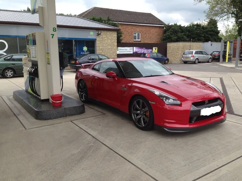

I know its not a Clio but I sold my M3 a few weeks ago and have been deciding what car to get next , and went for a GTR in the end , had a small list of cars to tick off my bucket list , and ticked this one off first :D
Got to be honest i'm well impressed by it , probably the quickest car I have driven , I can see why its called a licence loser !
