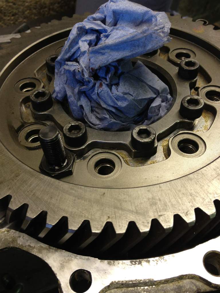

The ratio in mine is 15/61 , took some pics of the damaged parts , they say 4th gear broke a tooth off and dropped into the CW&P which is anoying as 4th gear was renewed last year when I had the box done , i'm thinking it was faulty
And the damage to the crown wheel
So its fingers crossed it will last now !
Ouch! Don't want too many more repairs like that.
Interesting that its got semi-helical gears, i assumed they would be straight cut.
That gear definitely looks faulty to me, bit weird that literally the whole tooth has come off. I was going to get my box rebuilt as a matter of caution but I'm starting to think if it ain't broke don't fix it. It all works fine at the moment, so why touch it..

The Crown wheel is identical to a Bacci and Gripper one, you just need to have the slots machined between the bolt holes so it does not interfere with the drive flange. The difference seems to be with the pinion where there is a connical / taper at one end which may be different where it locates etc. But this looks like it maybe a sleave that does over the end ?
