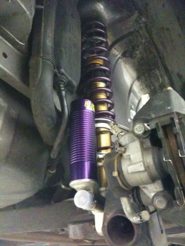

Don't lower models have a different filler without the tank?
Why does the 172 have it what is it? The workshop have removed mine (for the Reigers as they foul) and it wont fill up with fuel at teh fuel pump, not sure if they have messed with the other breathers. Has anyone got a pic or diagram showing the breathers on the tank so i can check they are all there ?
Interested in how Ian has done it on his.

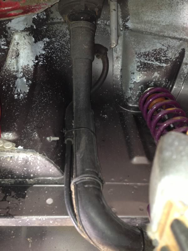

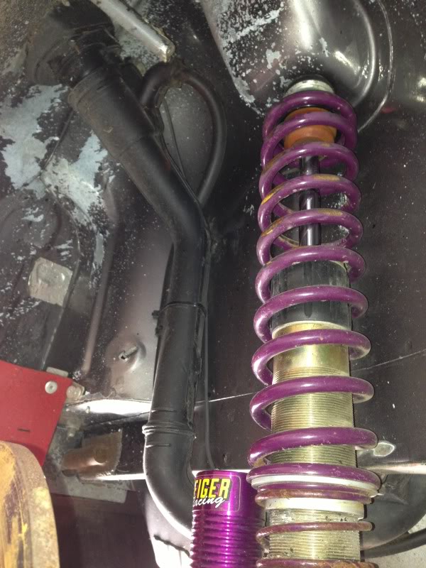

its a breather and expansion tank in case fuel does work its way up the breather to the filler , i'll sort you a photo how I did mine , I still have the breather pipe and have no issues filling it up , I just cut out the expansion tank and run a pipe up

Ian / Anyone got pics of where the other breathers are routed, think they have re routed mine and may be adding to the problem.

Mine seems to have that small pipe you have vented to atmosphere plus anther thats plugged?
On the road cars it heads off to the carbon canister underneath the car. For the fuelling problem I would also pop off your filler neck at the tank and check the non return ball is moving.
Is the non return ball in the tank pipe or filler neck?
  Audi A6 & 172 Cup
It's inside the tank, you can reach the back of it through the fuel pump hole.
Do you have the 15mm (ish) pipe vented to atmosphere?

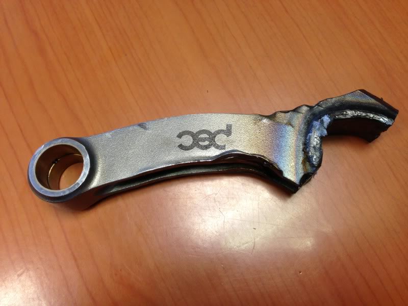

just found this melted to the bumper so not holding out much hope for the head !
j
ust need to find the pin and piston now lol
  182/RS2/ Turbo/Mk1
Well that is exactly as expected TBH, seen WAY too much heat and failed, I still think its going to be a case of the centre main spun first, dropped the oil pressure, at which point if you noticed the gauge at the time and had any mechanical sympathy you would back off (but as well all know anyone in competition use never does!) and get away with a basic rebuild but instead by keeping your foot in its just got worse and worse until it finally rodded the block (as im sure would porkies have done if he had just kept going at bedford when he miss shifted and spun the centre main but as it was just a trackday he pulled straight in so hard less carnage)
Even if you get lucky and the piston hasnt hit the head, I'd be surprised if the oil starvation and/or swarf from the bottom end failure has completely totalled the head and cams.
