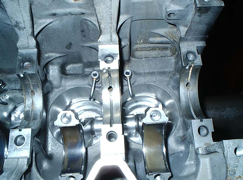

Porkies new engine (which a friend of ours is building this time as I am too busy) has got the tagged bearings, but the couple of grand for a girdle seemed like overkill and so we havent gone for that.

did you buy tagged bearings or modify the block and standard bearings , when reading this morning about bearings spinning that was my first thought is if I can modify the block and bearings to tag them so they don't spin , or less likely to , I have read that some of the rally guys with the Ford Duratec engines have issue's with mains spinning

bought tagged bearings and modified block. I have pics if you wanna see?

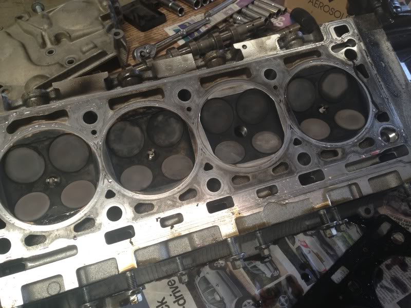

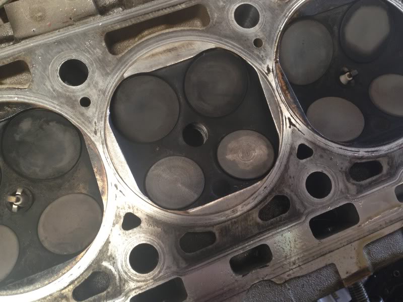

Good news is the head is ok , the piston has made some contact with the valves as the soot on them has been cleaned off , but a quick check the head seems ok , haven't checked the valves yet but if the 4 need changing its not the end of the world , I was expecting to see a right mess in there , so the rallying gods have been kind to me :D

Ian, what are the journals like in the head?
​Got a picture of it from the top?
They are good , as are the cams , there was oil everywhere , and the oil is clean , it is not contaminated at all , I was expecting to find copper from the bearings , but there is nothing
Wow, that was a lucky escape considering the amount of swarf that must have been generated by the bearing spinning enough to cause the rod to discolour that much.

Given the potential for carnage it certainly looks like you've been lucky!
