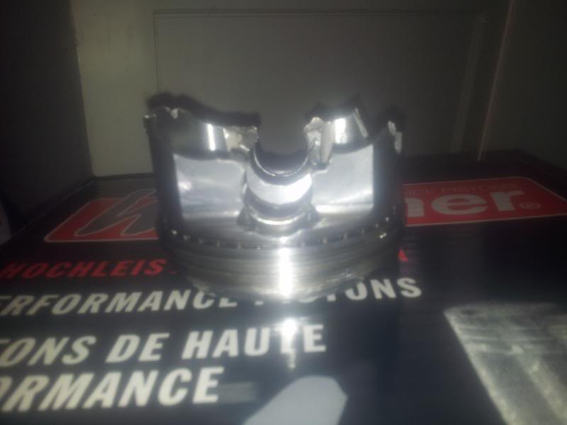

looks like it has the basis to build a serious engine , some real trick bits , a different animal to a standard engine , the chamber is in a mess from a valve head falling off , but should be able to be fixed , it has a steel billet sodemo crank and Pankle rods , they are a work of art , short stroke and long rods , I'll put some pics up tomorrow

the crank needs machining as well as is not turned down on the nose to fit the oil pump drive as they were dry sumped , but that should be straight forward , a bit of work to do but will be worth it , the cams are thinner than standard and run in bearings similar to big ends in the head , the springs and retainers are all smaller as well , real trick what's been done

Took a few pics today before I left work , will add more soon showing more detail

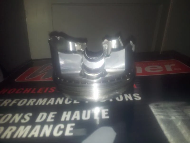

pistons and rods are a lot different from standard , the rods are longer , the pistons are single ring slipper pistons , and both the big and little ends are smaller than standard
the head is also miles apart from a standard head , cams are smaller diameter , and the valves ect ,you can see the shells that the cams run in , I have lifted the followers up so you can see them better , the heads have been drilled through and the followers are all fitted on the bar running through the head , there is no way I can see these failing like the standard ones do
