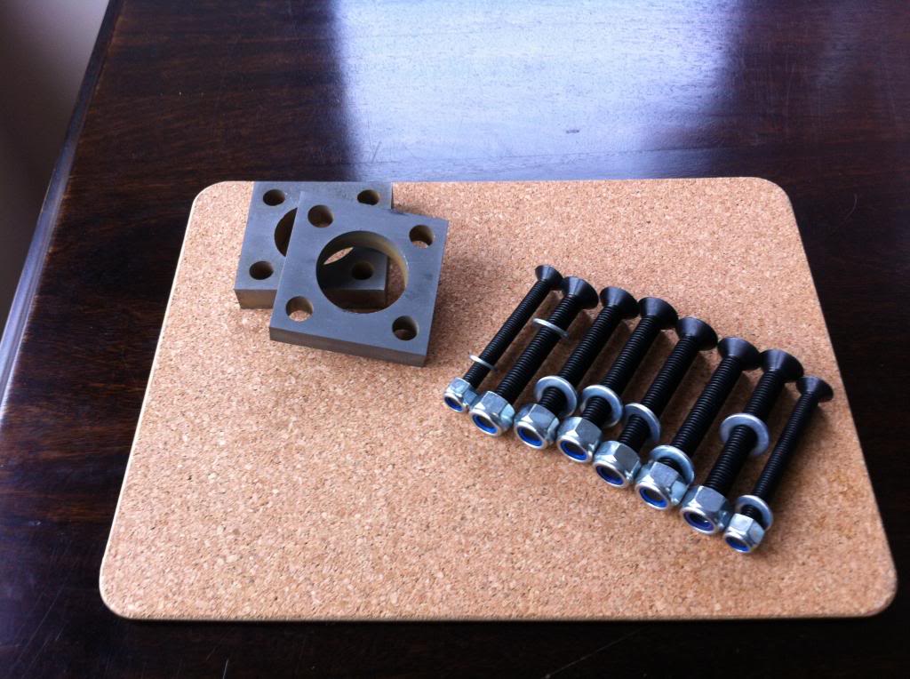

Another piece of the puzzle has arrived today, cheers Ed. 15mm rear hub spacers, just need to get some camber shims ordered once i've got the geometry checked.
Nick
Ooooh these look nice...where from etc.....my rear 15mm spacers are a right royal PITA
  TrackCar & F30 330d
Those spacers look nice!
What ET are the wheels your going to be using?
As i have 10mm rear hub spacers, and my Ultraleggers rub the arches a little with 3 deg of negative camber.

Running et43 OZ F1's Chris, cheap and disposable when they get bent. If it rubs after i've fitted similar camber to yourself then i'll look into 'massaging' the arches. ;)

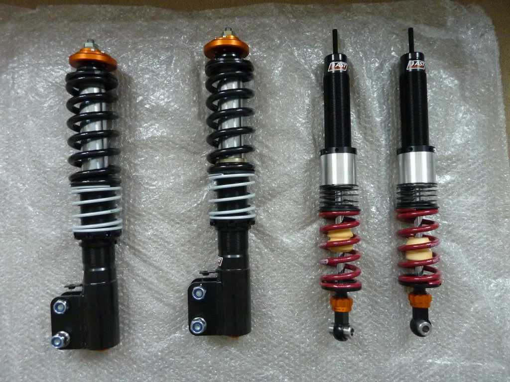

All I need now is a couple of different sets of rear camber shims and the stripdown of the clio can commence! Need to book the car in with the 'mad scientist' (Mike aka budgie) to fit all the parts and once all the bits are done I can actually start using the car properly!
Properly like a kid at Christmas atm, been ages saving up for all these AST's especially! :)
  TrackCar & F30 330d
So are those rear AST's brand new? The Lower part where the bolt goes through is just rubber on mine and Fred has said that these rubber parts can fail. Yours looks like a new design!
What springs rates did you go for.
Not brand new Chris but definitely the new design. Rhys on here had them for a little while, used them on 2 trackdays and had the fronts refurbished as the seals started leaking but hasn't used them since.
Spring rates are... Fronts - AST 180-100-61 / Rear - Eibach 13/99 0500.200.0500. James (BIGASH) said they are roughly 10% softer than his setup and he's not 100% happy with his, so these should be alright! Just need to get out on them and work from there.
I think that was the first ones made. Mine have rubber ones and been in for years with no trouble at all.

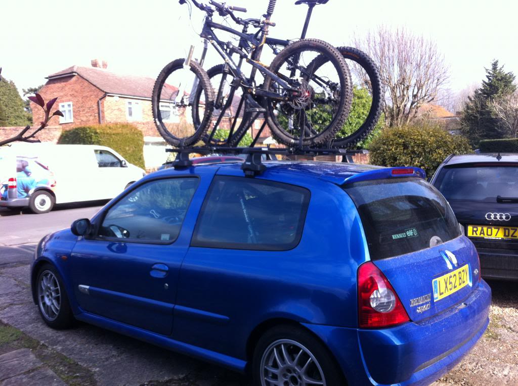

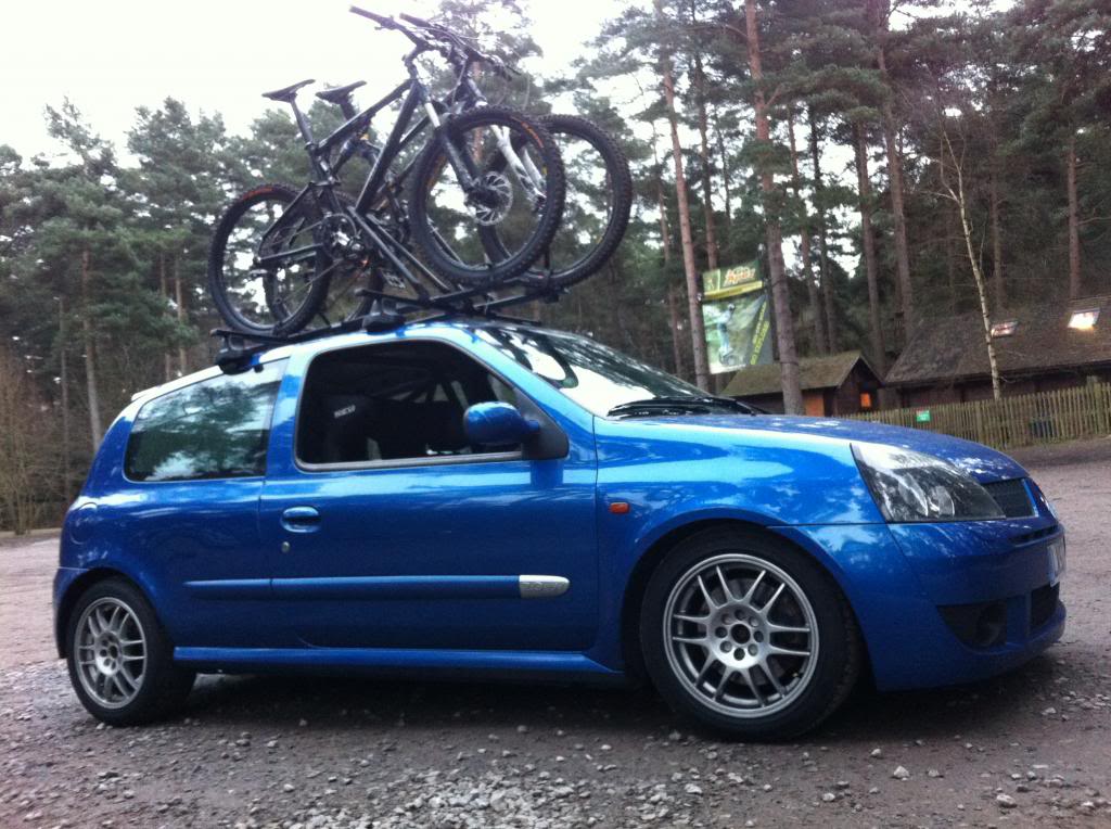

With the DCI still being in its current broken disgusting state and not having any time to even look at it because i've been working away in Cornwall this past month, the Cups been the 'daily' so to speak and doing it finely(ish). Its been pretty versatile, i'll let the pictures prove this... :)
A trackcar/daily/bike transporter, does look epic with the bikes on top as well! Love the looks people give seeing a low/caged/wraparound bucket seated clio with two poser bikes on it! lol

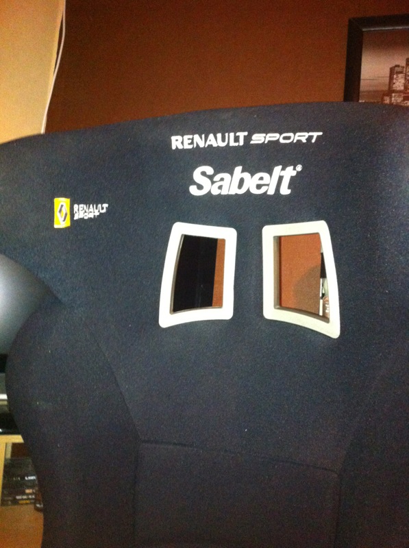

And a new drivers seat. ;)
