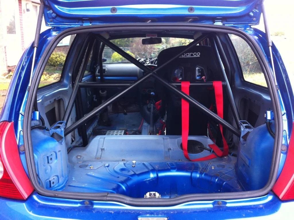

Safety Devices 6 point bolt in cage
Odyssey PC680 lightweight Dry Cell battery with cut off switch on passenger side floor
OMP steering wheel with OMP adjustable boss kit!
Sparco ‘Circuit’ wraparound seat.
OMP 6 point harness
Spare OMP 4 point harness and passenger seat subframe

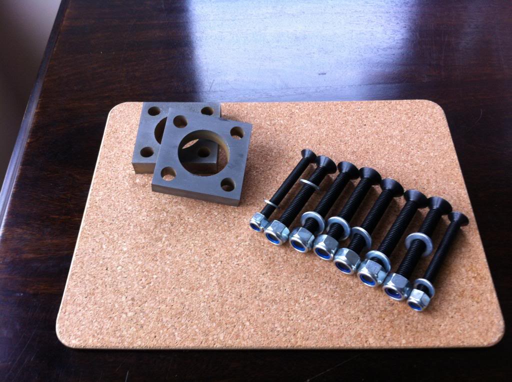

25mm front spacers (Done)

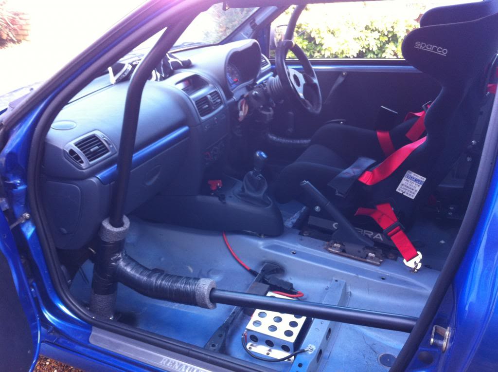

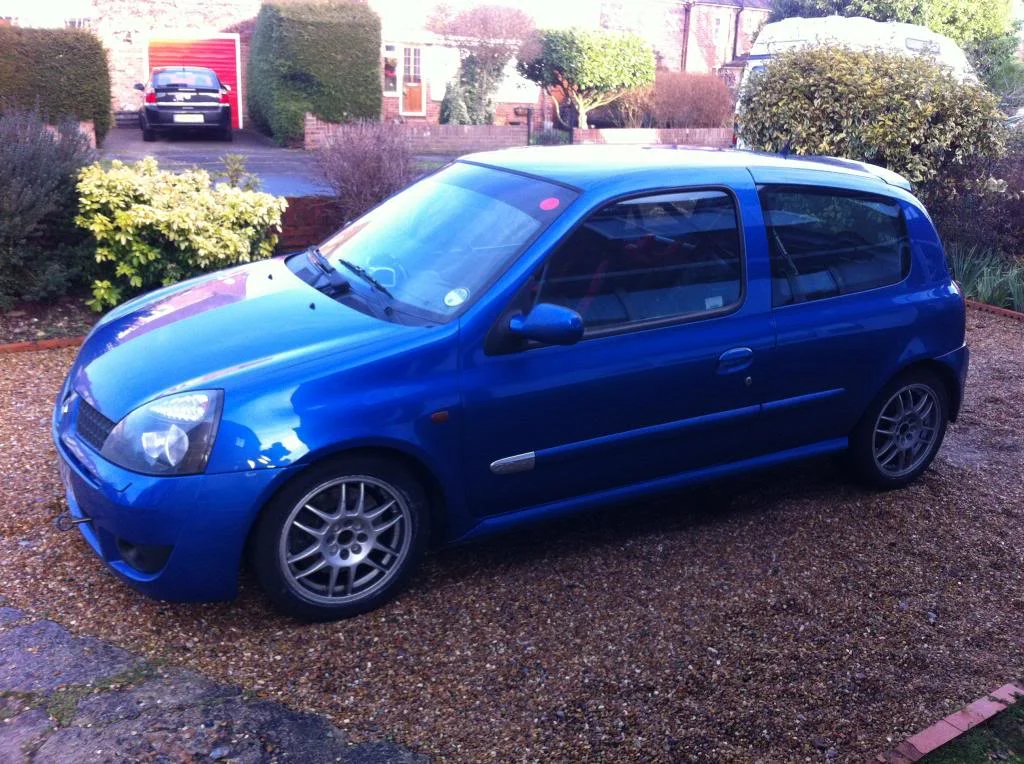

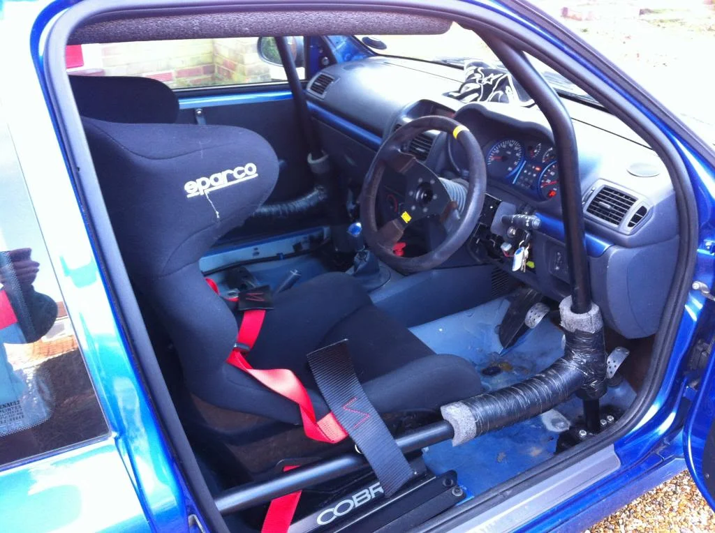

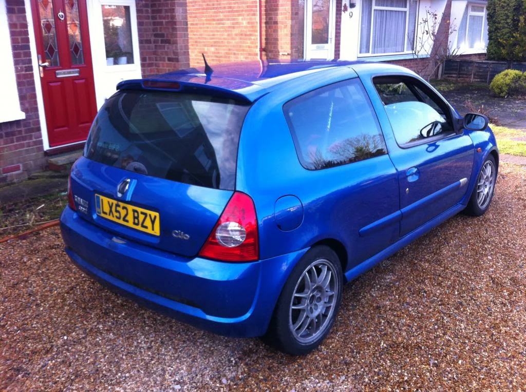

Anyways, here’s a few pictures of it...
Cheers
Nick

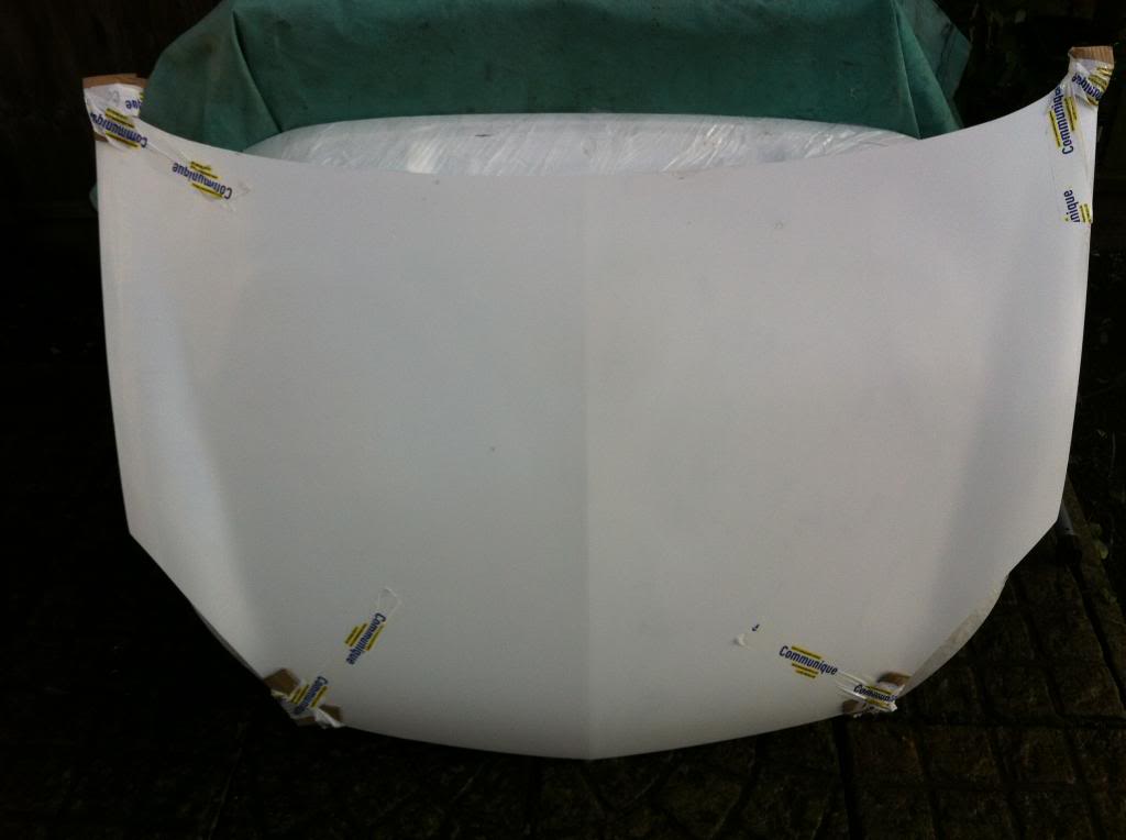

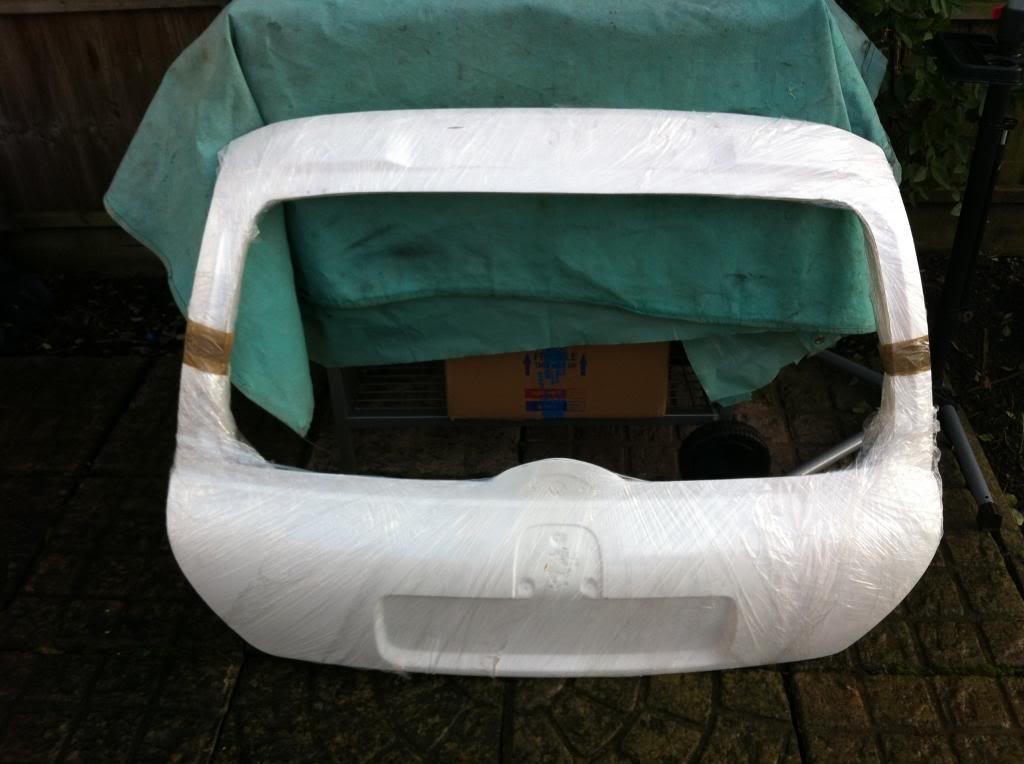

Oh and picked these up the other evening from Hal (HrRacing)...
Massively lighter than the standard parts, wont be fitted to the car just yet but when they do i'll be getting them wrapped in Mondial Blue or closish colour to that (hopefully).

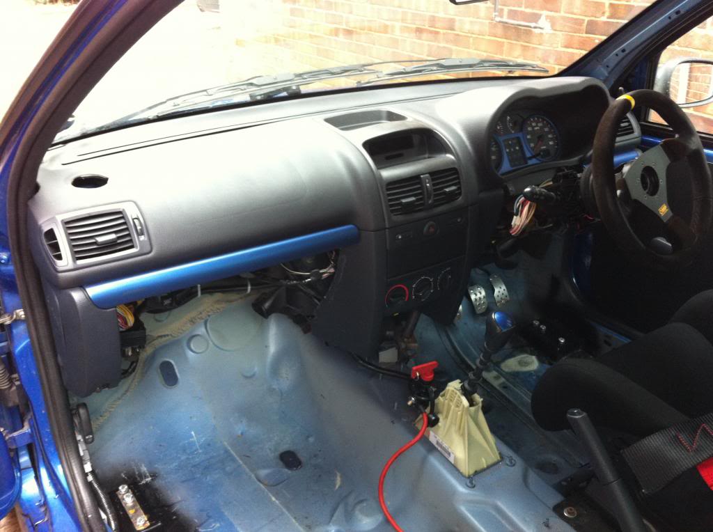

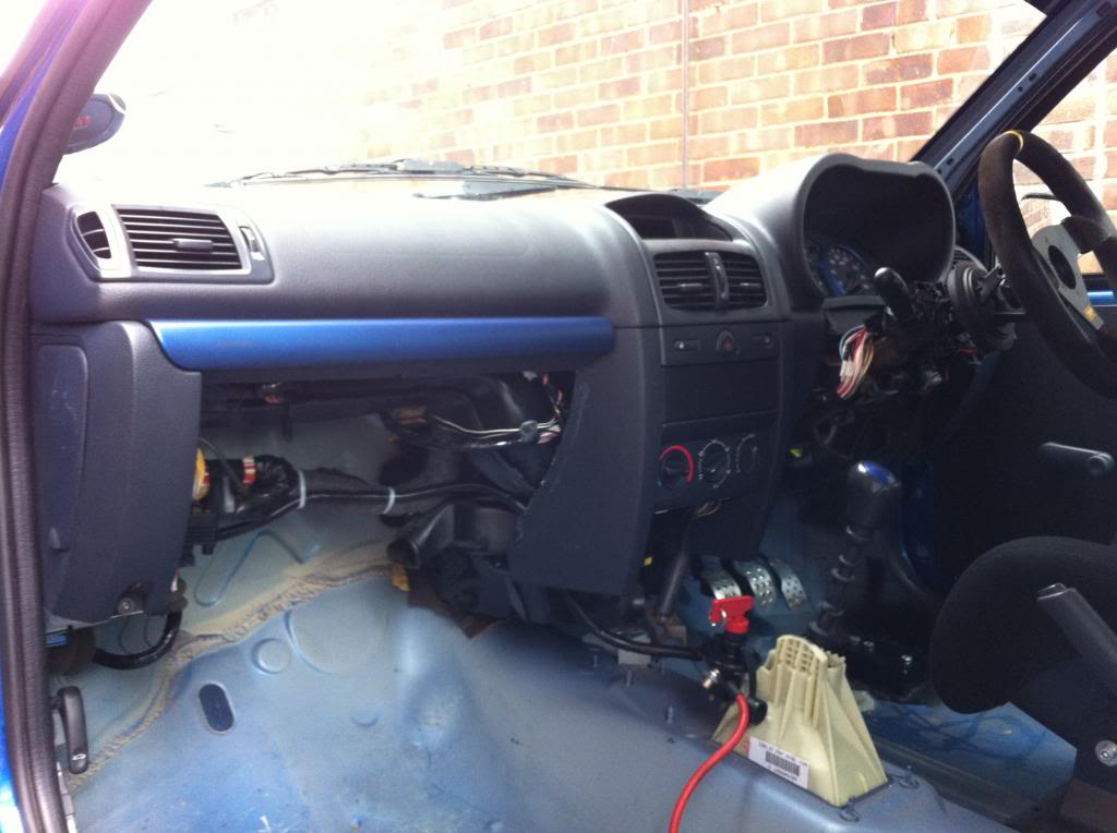

So a little update...

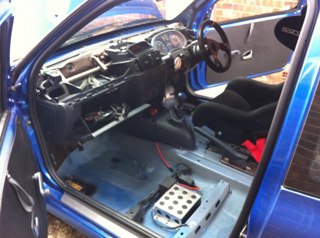

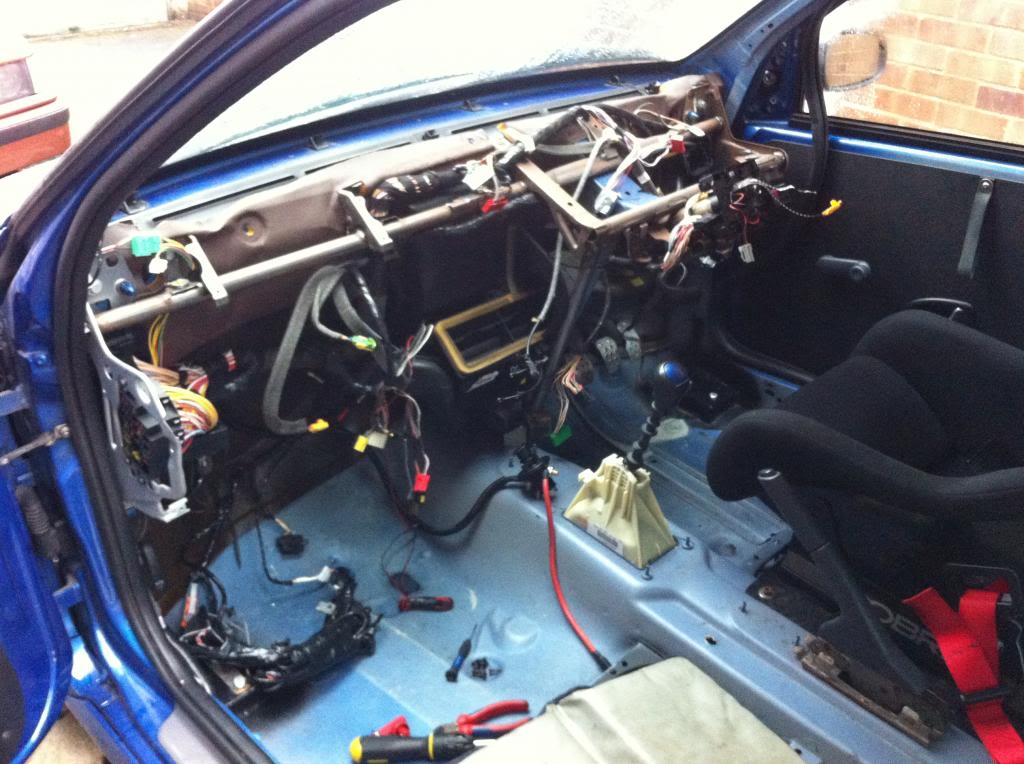

Been meaning to find out why I keep getting a big puddle of water in my passenger footwell, so I went on with removing the dash and all the thick sound deadening from behind there. While the dash was apart, I looked into slimlining the dash a little and cutting bits away there werent required. Also was tempted with a little loom triming but after the problems I had with trying it last time I decided not to bother and just hide them away.
As it was before...
So I removed the front half of the cage to make my life a lot easier as well as the dash itself...
Removed all of the glovebox, trimmed lots of bits from the lower part of the dash that are hidden and what used to hold parts that are now redundant. I think that the dash is roughly half the weight of what it was before and it still looks presentable enough. Possibly lost 5-8kg, maybe more between the redundant parts of the dash and the thick sound deadening behind it. Also fixed the water problem, a drainage pipe in the scuttle panel that was blocked up with gunk that vents into the engine bay. It overflows and then runs between the seals on the heater box and then onto the floor. So with that removed everything seems okay, plus i've managed to strip a bit more weight from the car, not a massive amount true but once i've finished with stripping other parts it'll hopefully make a nice difference to the total weight of the car.
Anyways some pictures of the finished artical, dash still sits remarkably rigid for only 6 torx bolts!

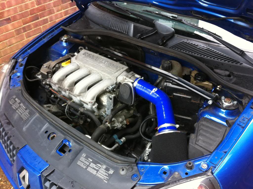

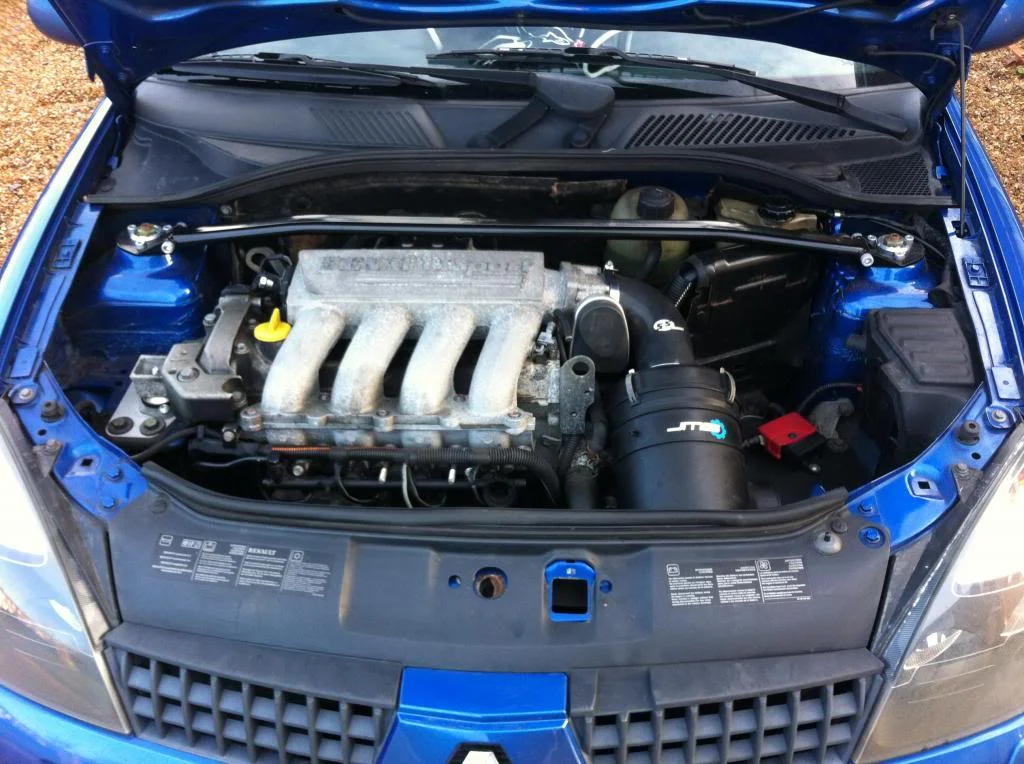

I also got my new induction setup through the post...
Previously had the JMS V6 airbox (which is for sale ;)) which is okay, but I enjoy knocking up a cheap IK that works alright. Was planning on sourcing my own parts separately, but when this popped up on here for less than I could get all the parts for and was brand new it made sense to get it bought.
