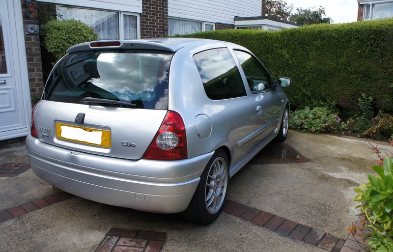

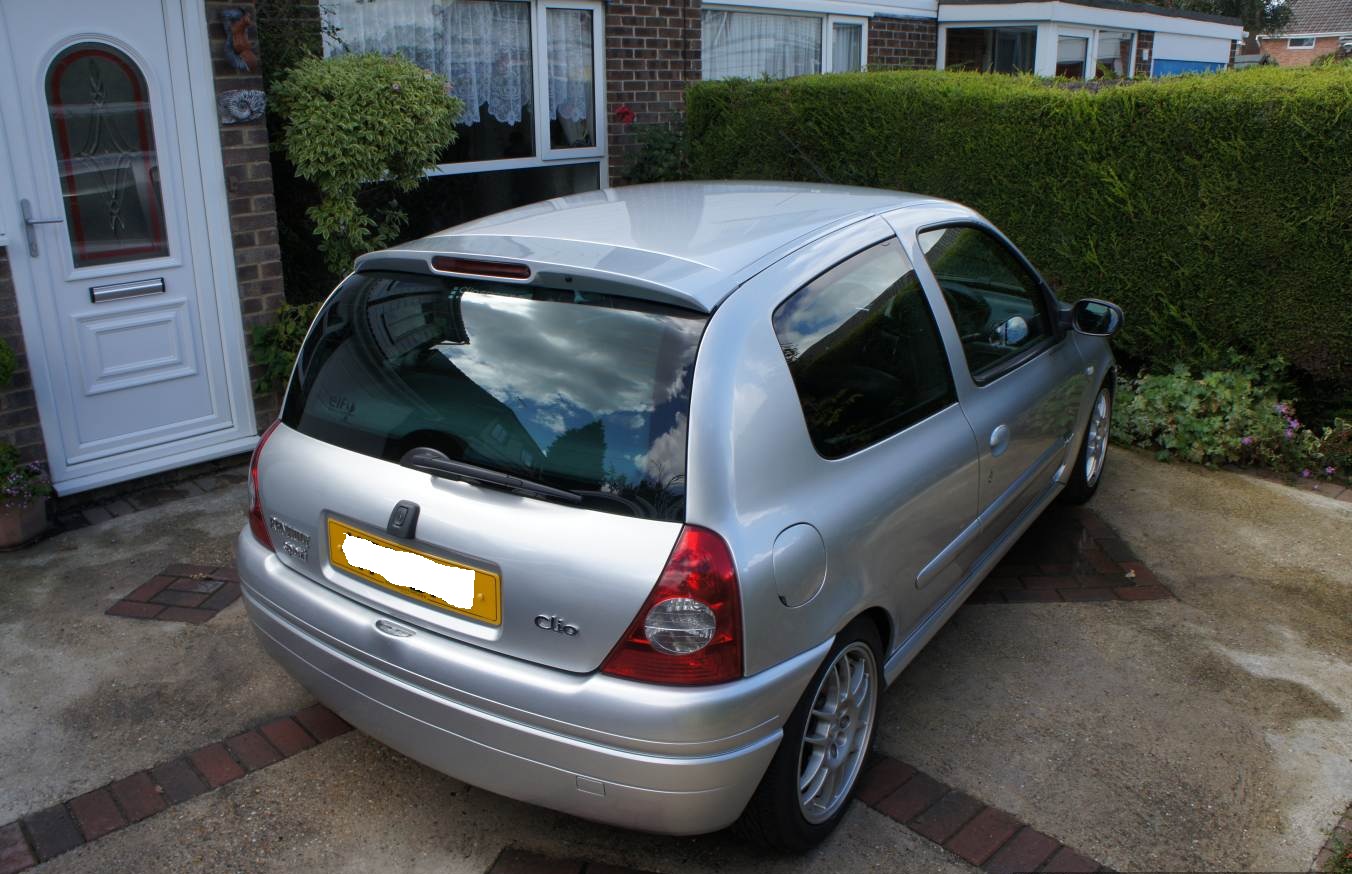

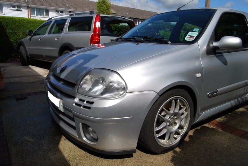

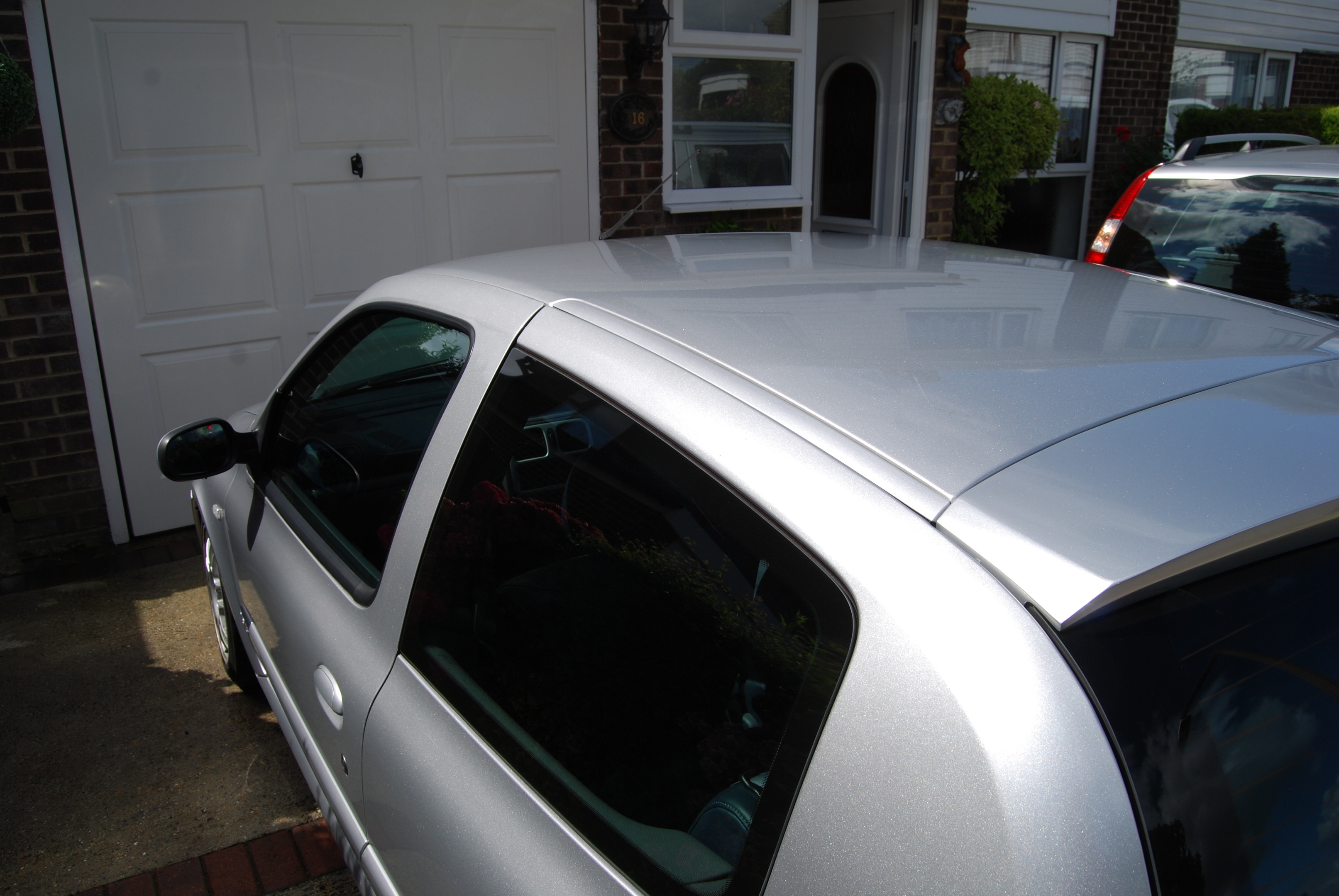

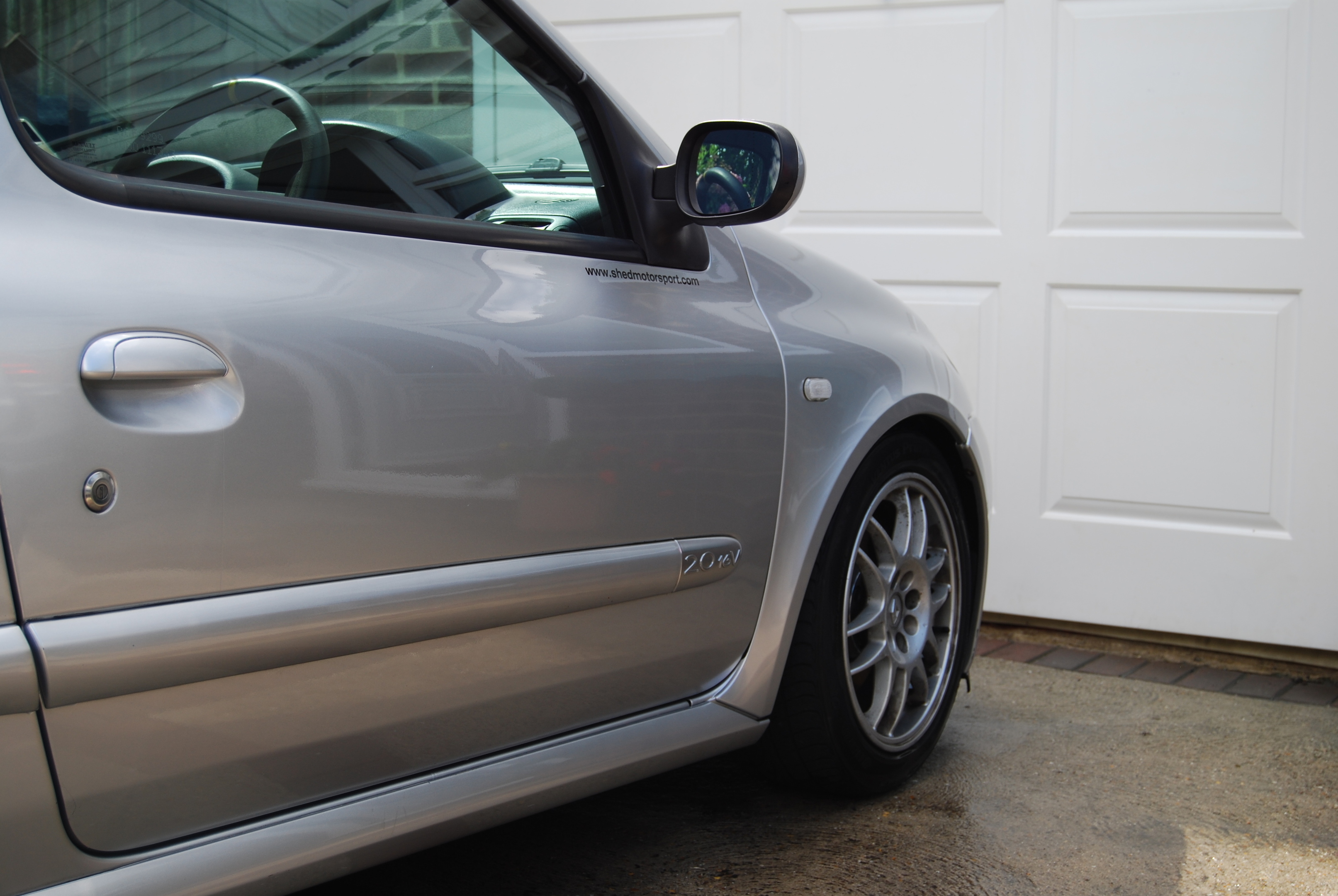

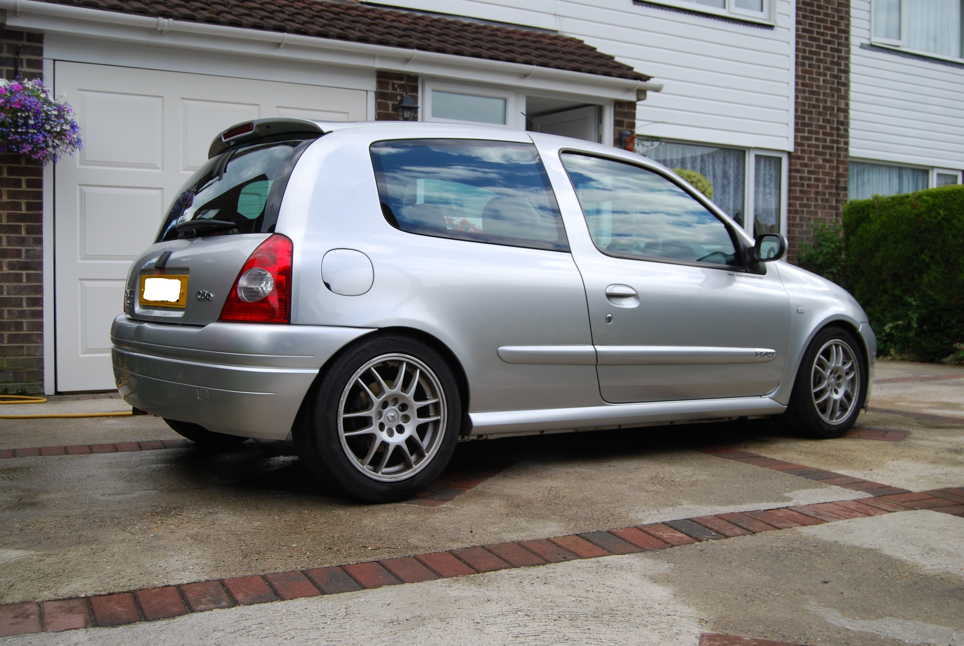

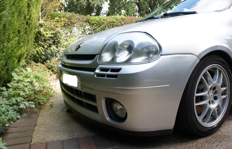

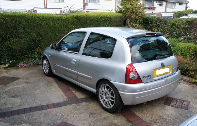

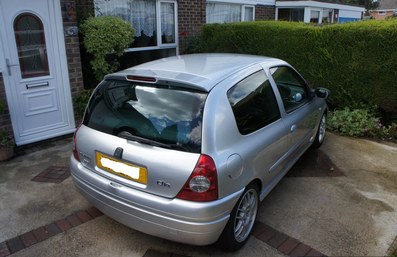

Few more pictures of the car from the weekend.
Gave her a very good wash and clean before I take a trip to the alps for 2 weeks to go mountain biking!
Poor car will probably sit idle for 2 weeks :(.
Will be getting the car into a garage on my return, to get a few little niggles sorted.
But for now, I am loving it!
Should be some nice little updates to come as well ;)

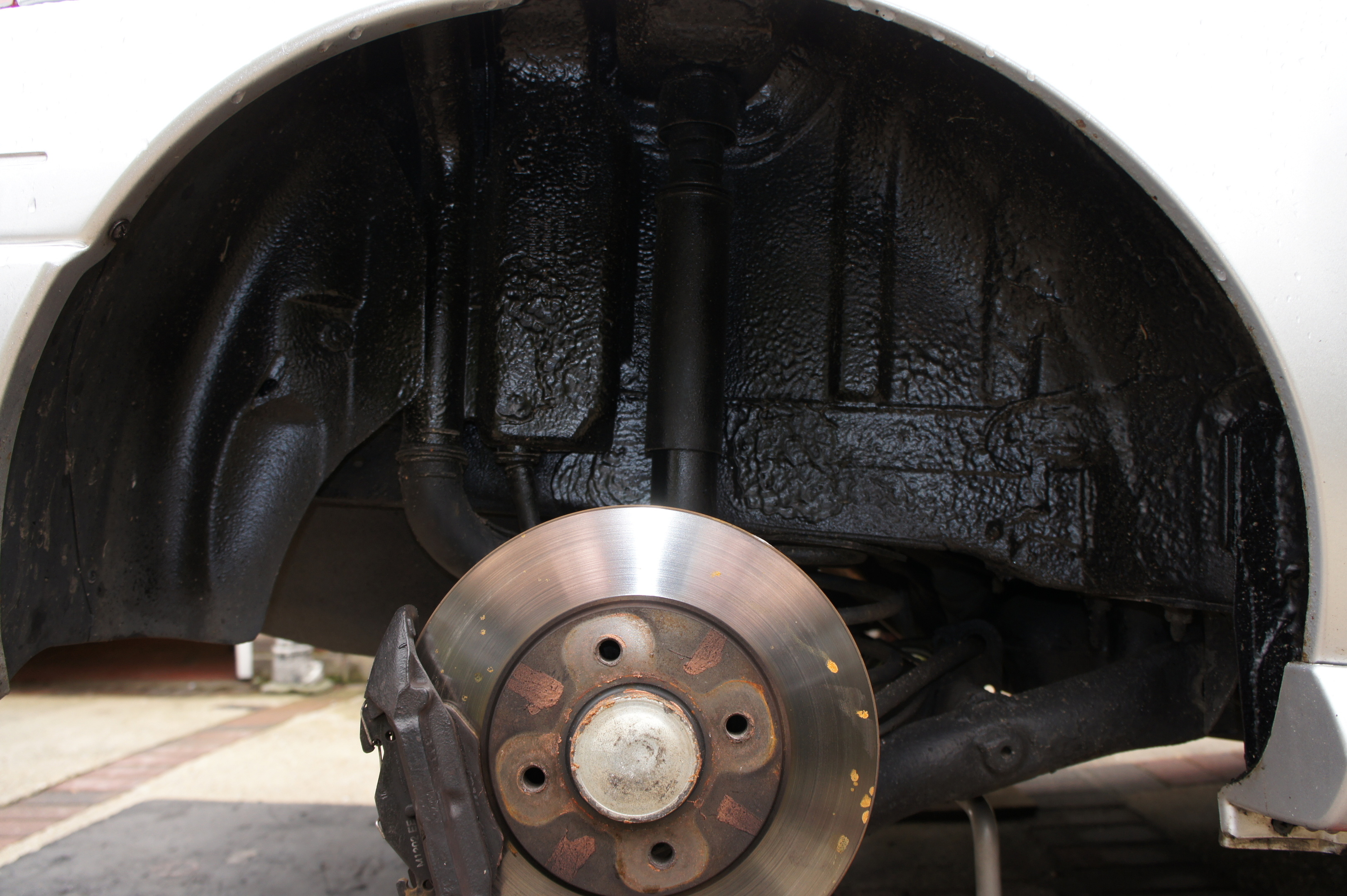

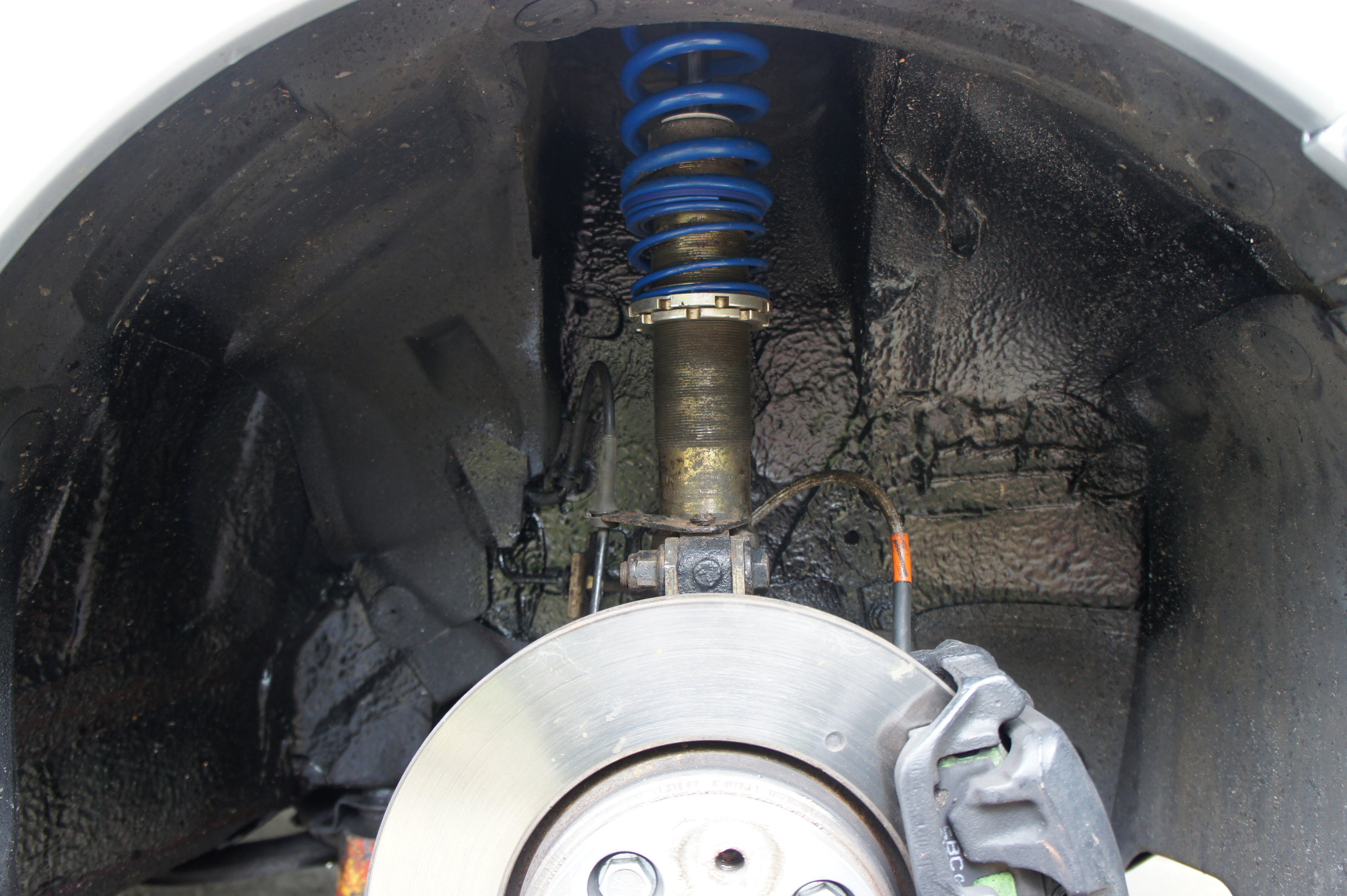

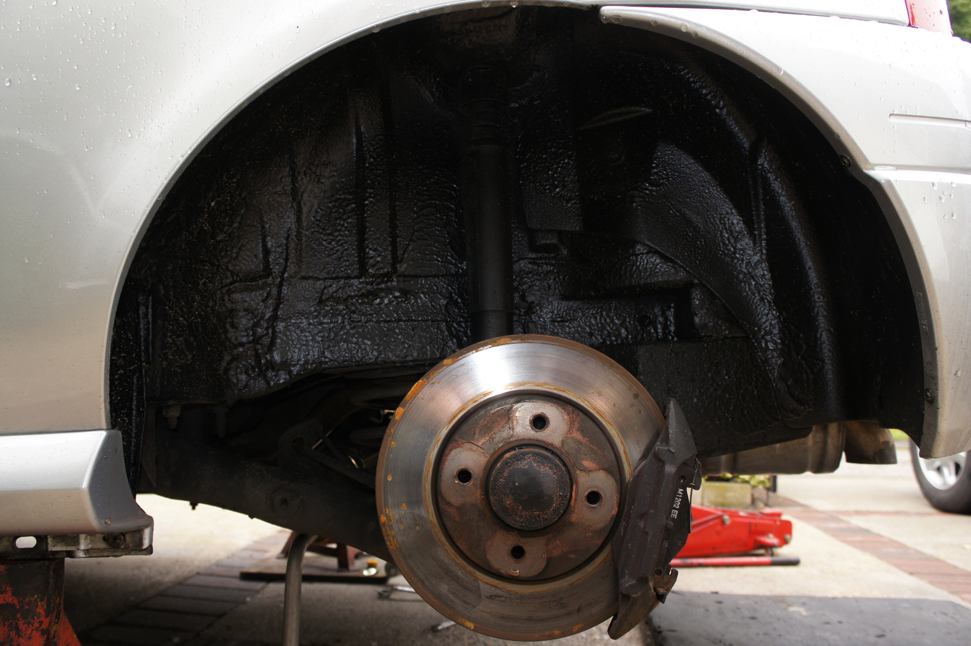

As can be seen earlier on in this thread, I have cleaned, treated and resealed the rear arches of the car.
It was now the turn of the fronts to get the same treatment. I apologize for the lack of pictures, the under seal stuff is horrible, and I didn't fancy getting everything covered in it :).
Firstly, this is how the car has been sat for the past few weeks. Hasn't moved an inch :(.

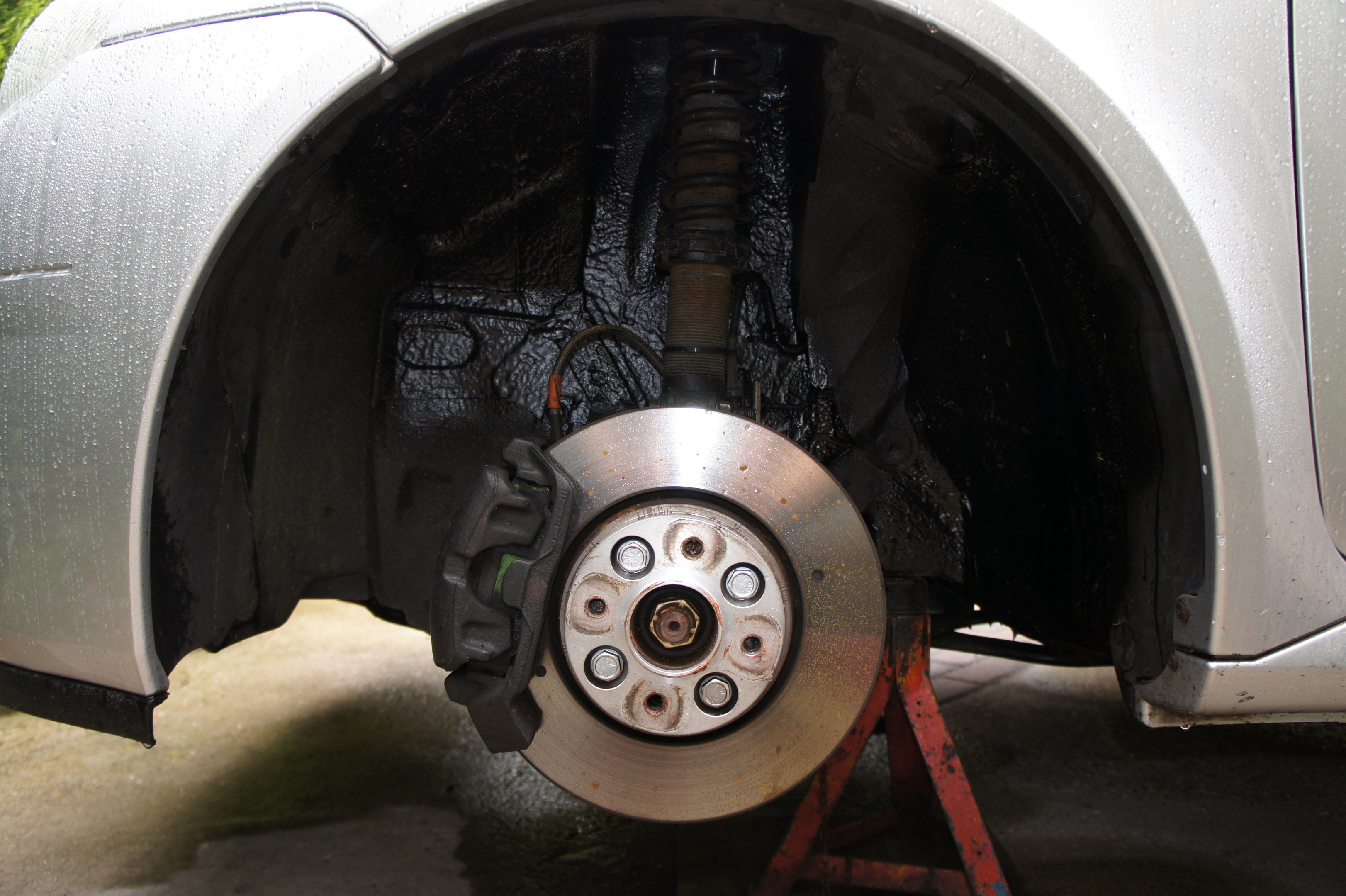

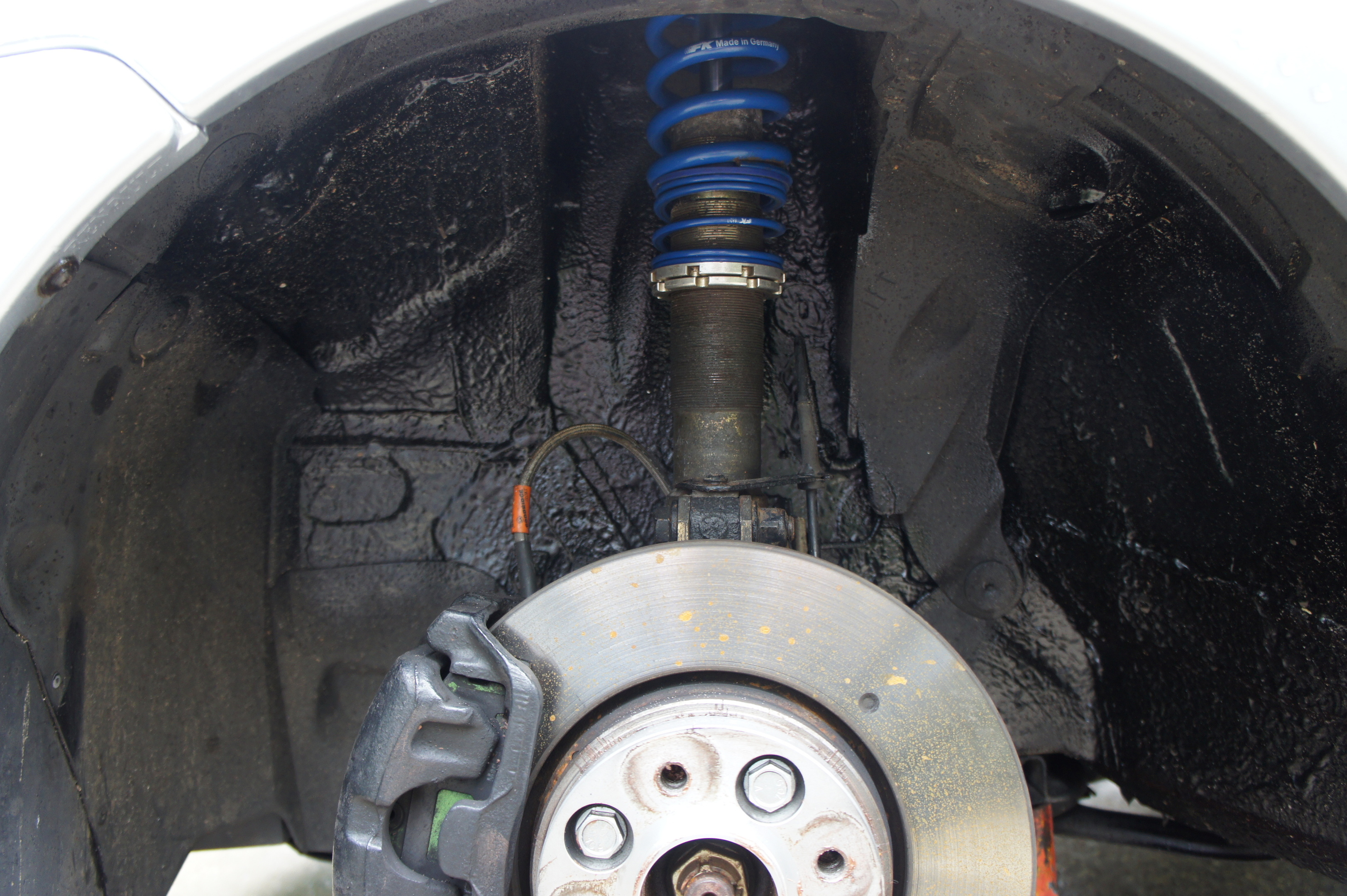

Without further ado, I got cracking. Jacking the car up and scrubbing at the inner arches with a wire brush and some Tardis.
Whilst down there I refitted my Eibach camber bolts, as I am taking the car down to Ktec to get the geometry dialed in (at long last).
Picture of the finished product.
Again, I do apologize for the lack of pictures and rubbish write up, but I didn't take many pictures due to it being a messy job!
I did both sides of the car, and to be honest, both look identical anyway haha.

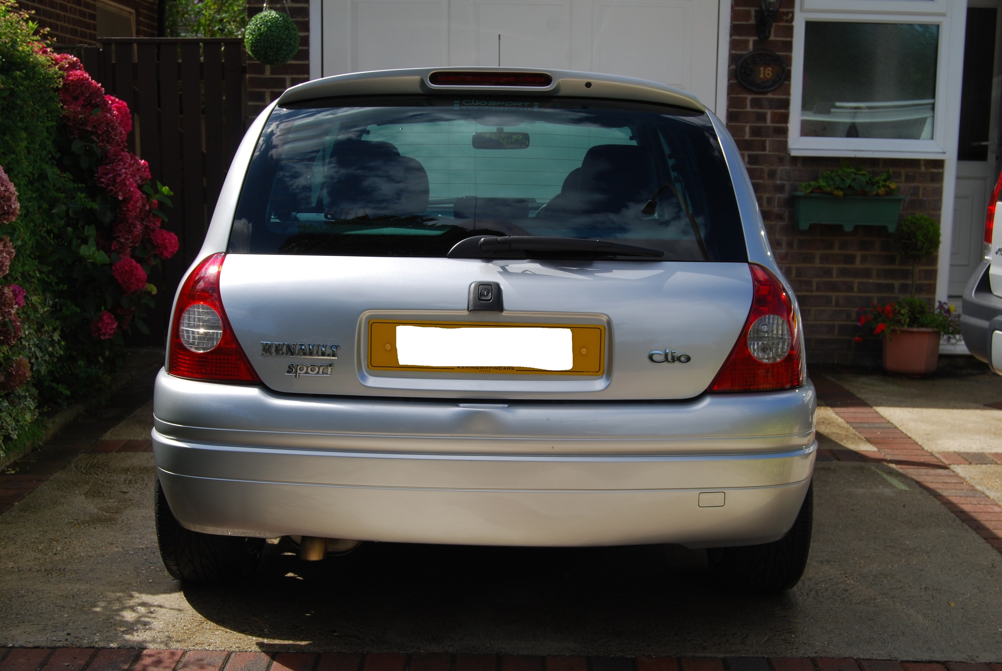

Delighted to see it still has the ph1 rear bumper! :) Great work as ever!
Where were you in the Alpes Nickson? I was there for the TdF, watched them go up the Col de Galibier! :) We stayed in Sainte Foy, on the way up to Tignes from Chambrey.. know it?
Thanks mate!
PH1 rear is staying ;)

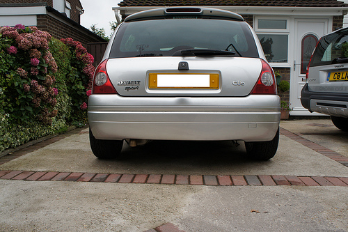

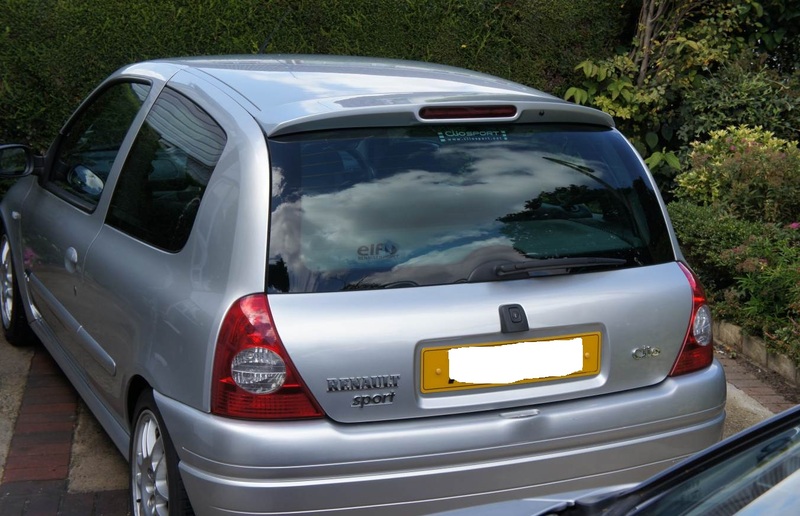

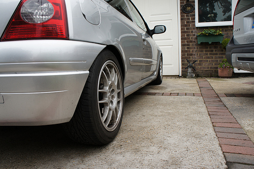

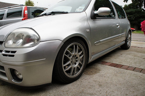

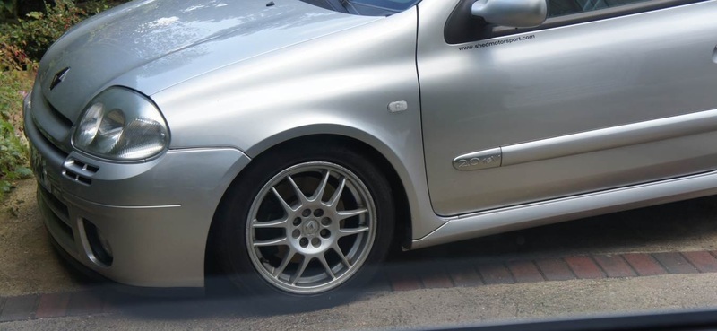

Lovely looking phase 1!!!! What size spacers have you got on the front and rear?
Thanks very much mate :)
20mm on the front, and about 7mm+camber shim on the rear :)

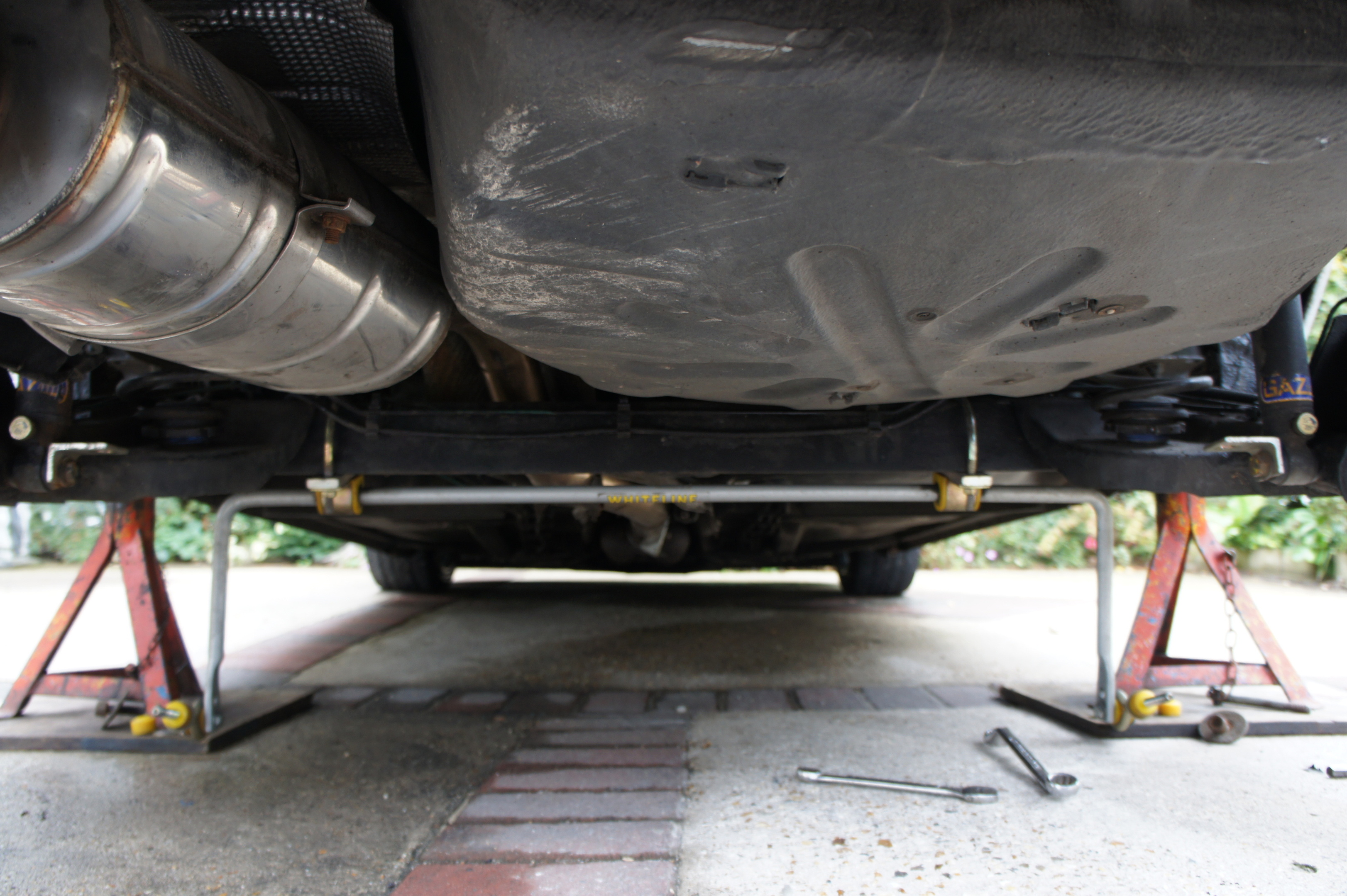

Cheeky picture of under the car:

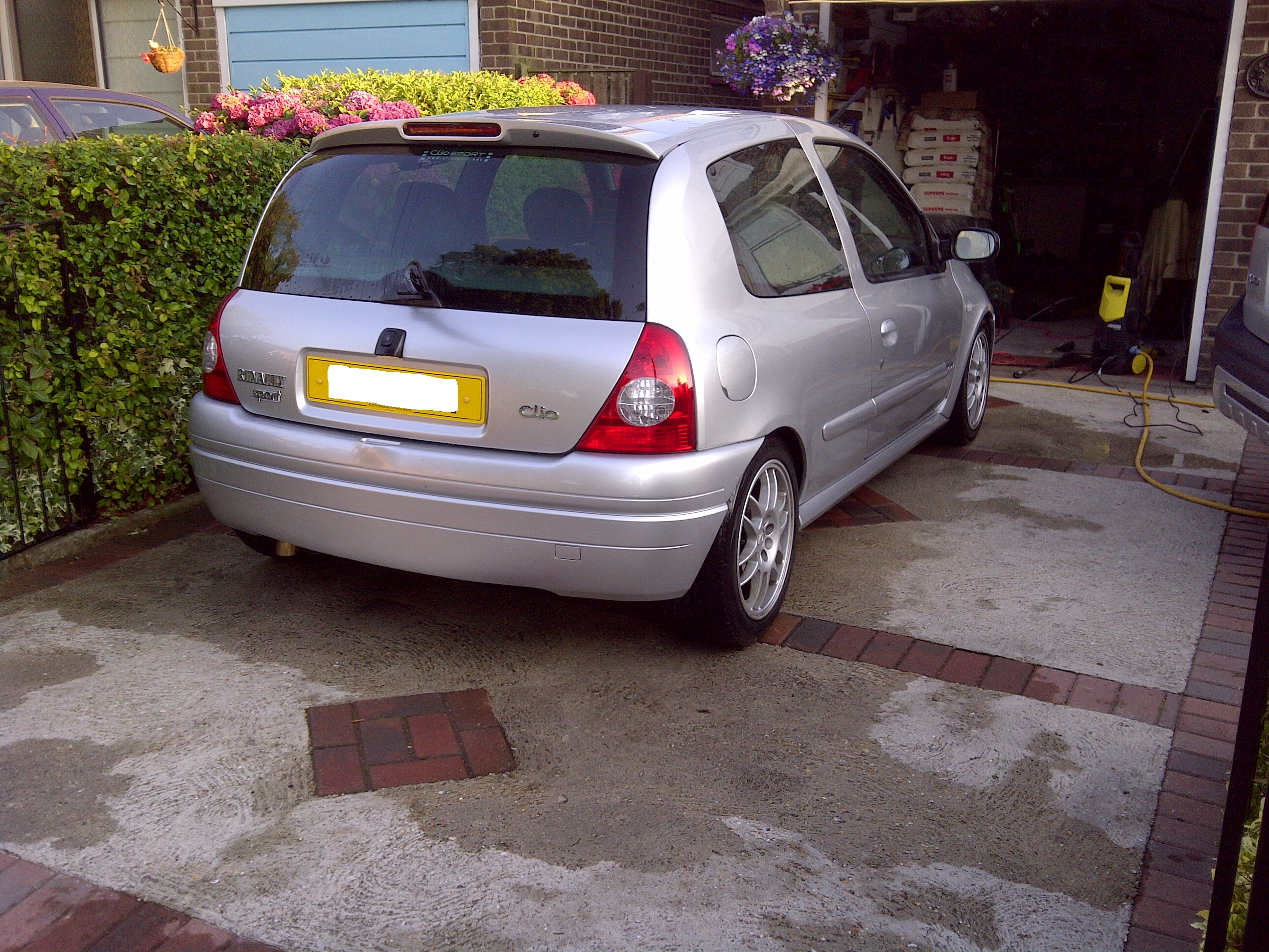

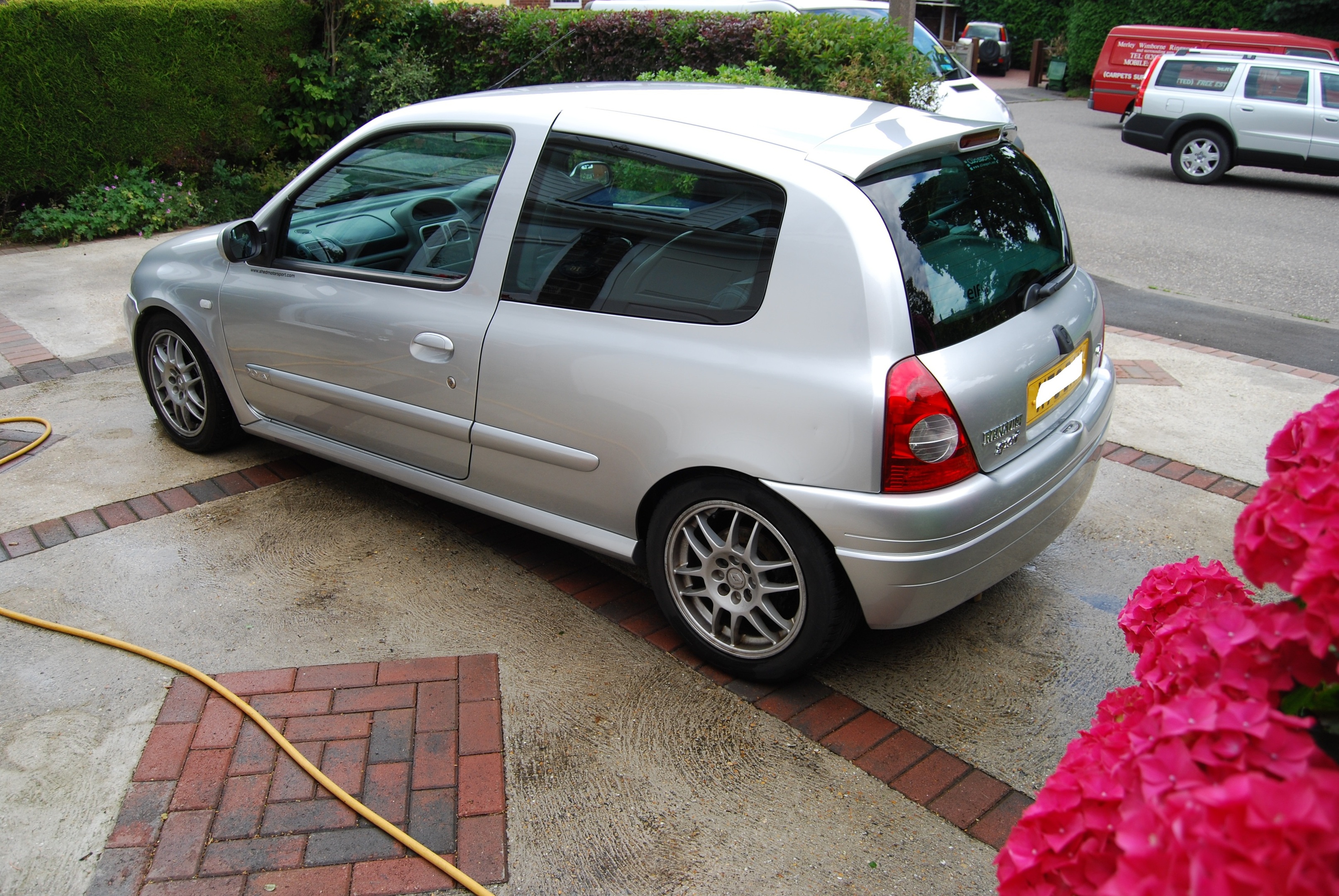

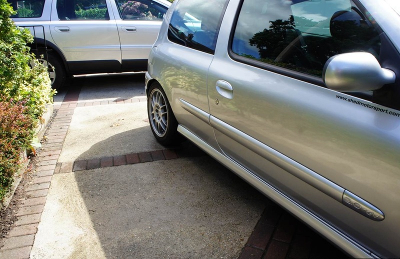

Little update from today:
Went out and gave the car a hell of a good wash inside and out, as I hadn't done it in 4 weeks due to holiday etc.
Pics of said wash:
Cheers :)

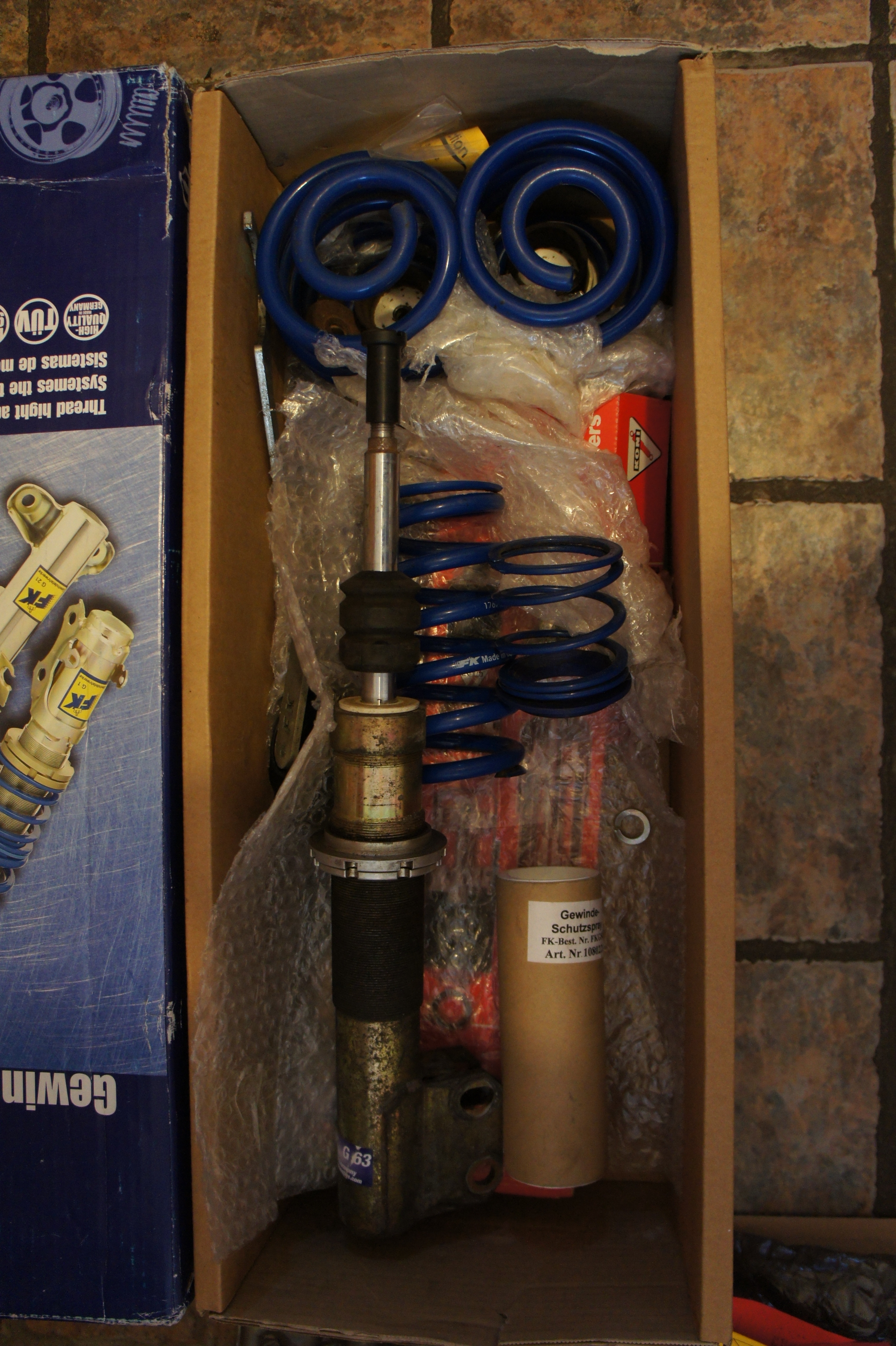

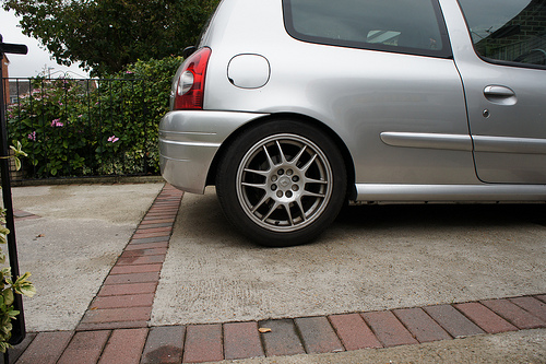

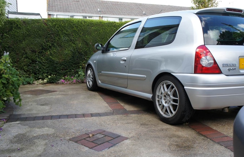

Have some updates from today!
As some of you may or may not know, I have been on the lookout for a new set of coilovers.
It just so happened that Bomber (Thanks Dave!) was selling his FK Konigsports from his PH1 172. Having waited for ages looking for another set of coilovers, I went for them, and promptly paid the money.
This morning, without any delay, a nice little package arrived...
With the car booked in to get it's geo setup at Ktec this Thursday, there was an urgency to get these fitted and ready to go in and get set up correctly.
Without further ado, I decided to crack on and get it done.
The weather decided not to play ball, and started to rain :(, unphased ;) I carried on.

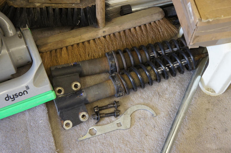

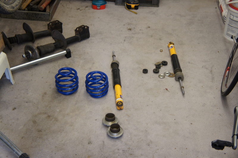

The old GAZ Coilovers that were scheduled to be removed.

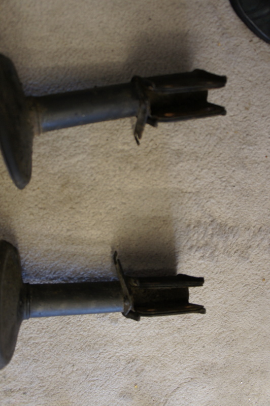

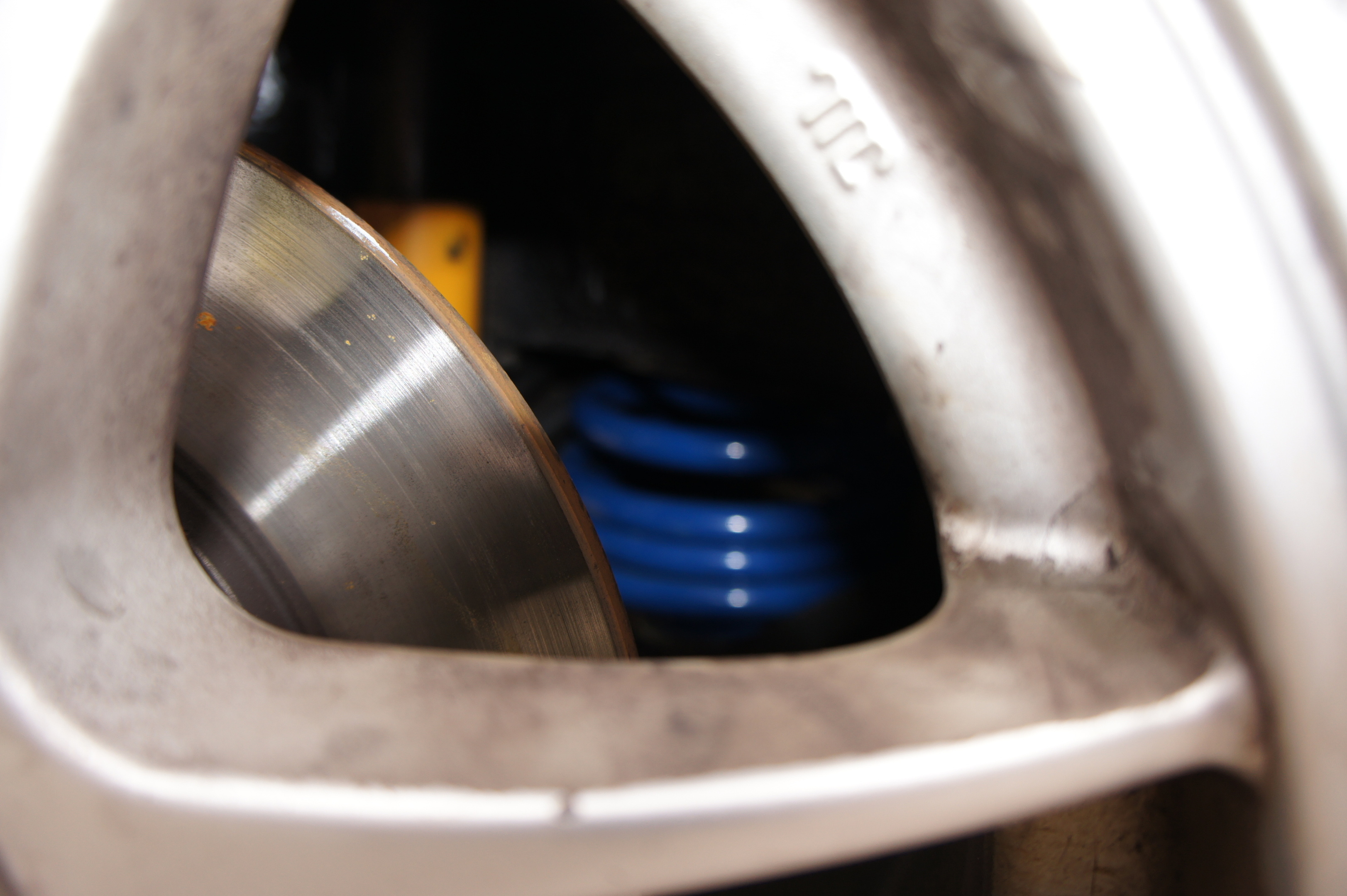

Once I had these removed, I cracked on with getting the FK's built up and ready to bolt up.
This involved removing the ABS wire bracket from the original shocks. All I am going to say is, the bolts didn't want to come off..
Once that was done, I fitted the AST top mounts, and slapped the new front coilovers onto the car :)

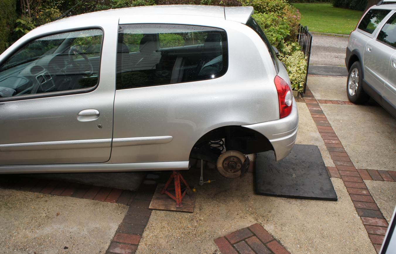

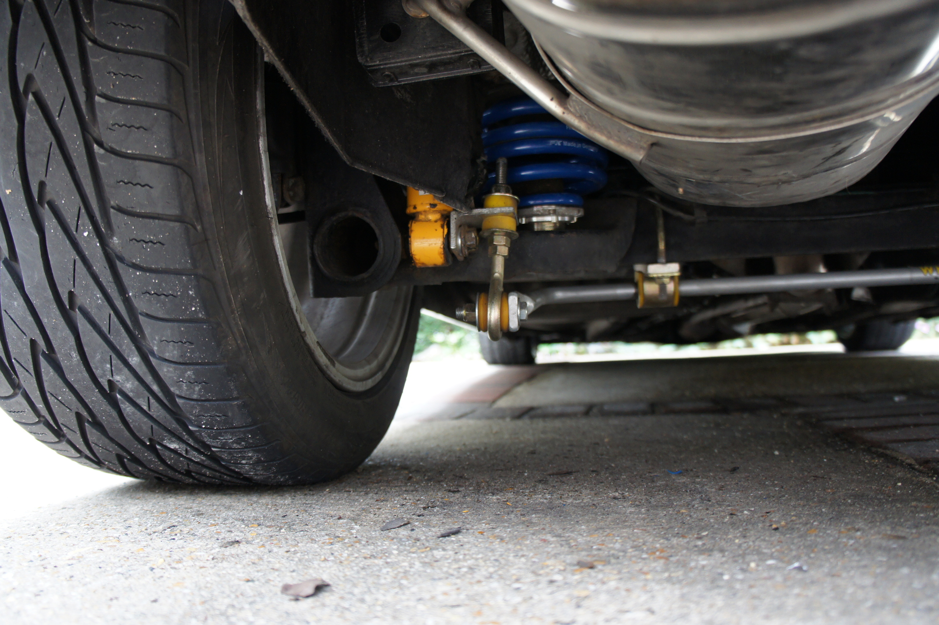

With the fronts fitted and bolted up, I started on the rear of the car.
Which proved to be much harder than I had first hoped. Mostly down to seized bolts :(
Got the rear jacked up.
The old GAZ shocks ready to be removed.

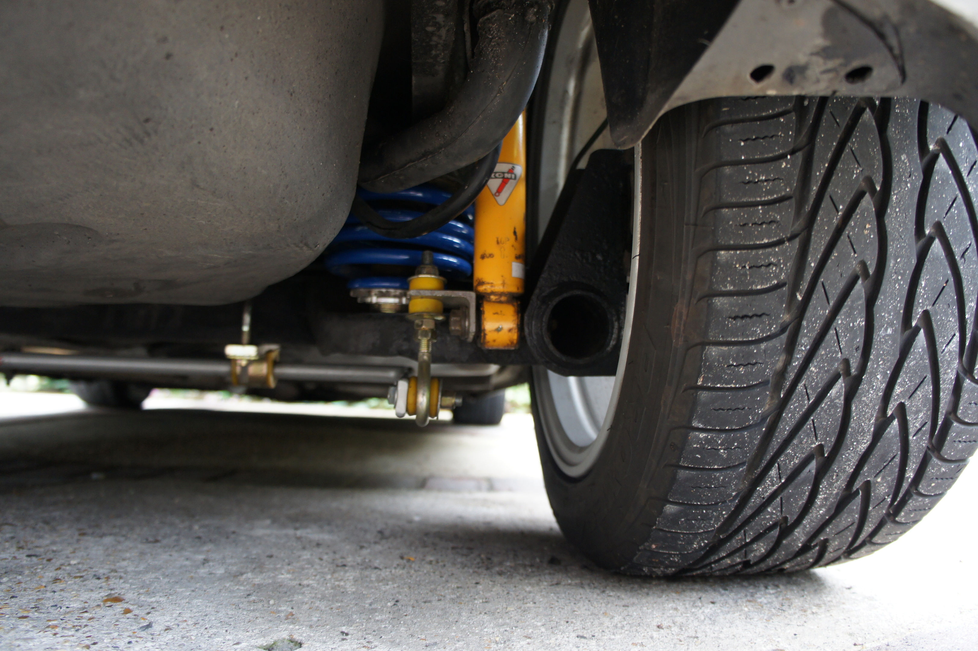

Sneaky little picture of the Whiteline.
FK's ready to be fitted!
Unfortunately I do not have any more pictures from the fitting, I only have afters!

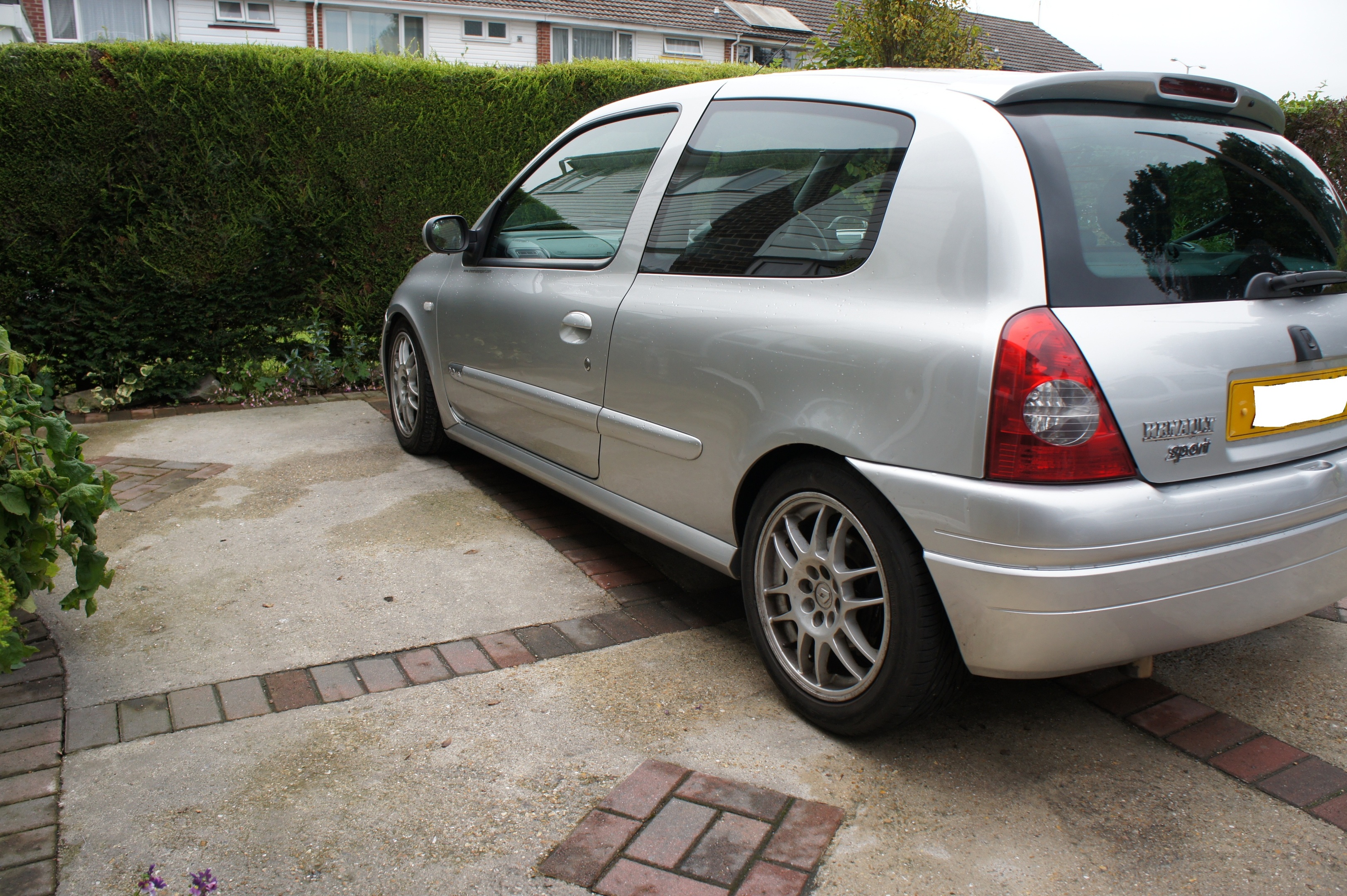

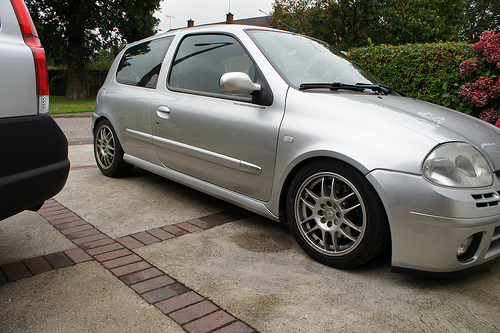

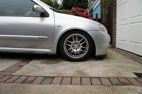

So, fitted and ready to go!
Very poor pictures I know :o
Few better ones ;)
Back on the floor.
Everything was completely wrong at this point. One side was higher than the other, and the front wheels looked rather.. Deformed..
So I took it for a drive, and wow!
So much smoother and quieter than the GAZ's were. I drove around for a good 10-20 minutes to let everything settle in, and then came home.

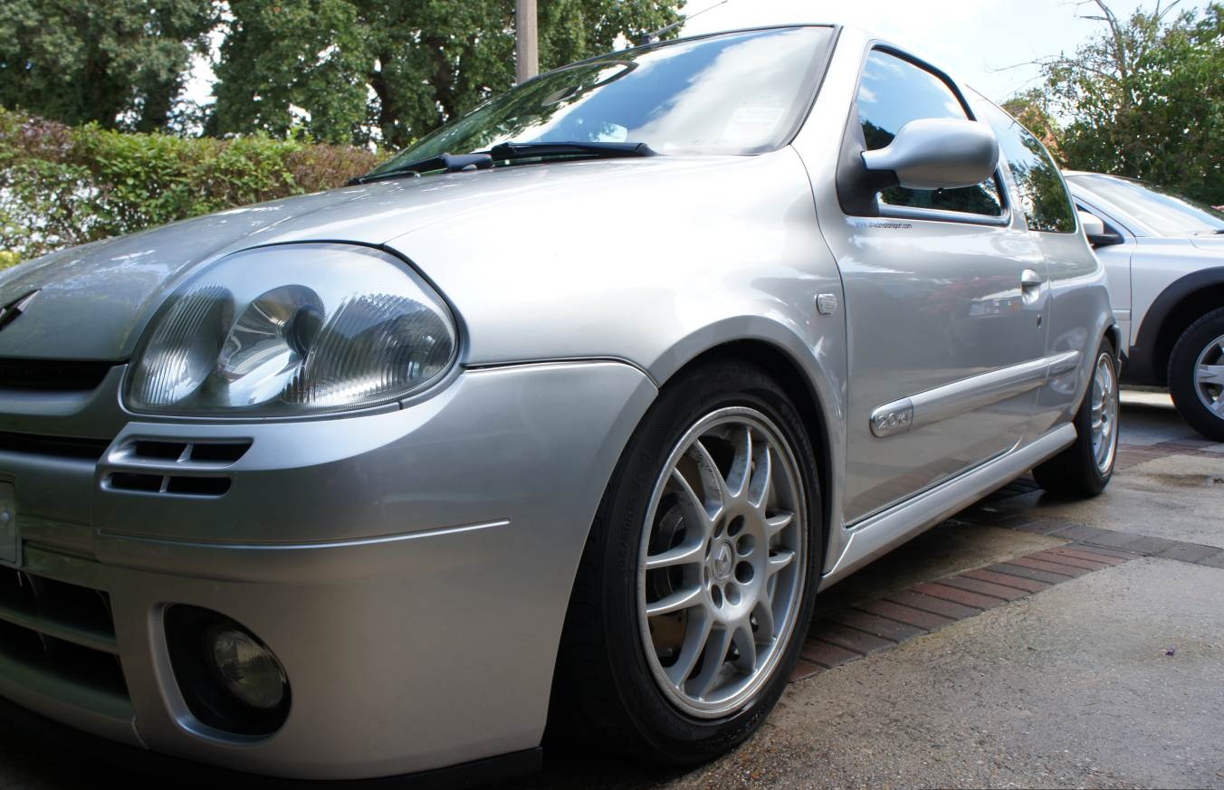

The finished stance is exactly what I was after, now that everything has settled it looks much better, Love it!
Few pictures of the finished article.
On second thoughts, looking through the pictures has made me want to raise the front a tad, unsure yet, we shall see!
Cheers :)
keep it that low ;) ha! And btw, do your top mounts come loose? mine seem to quite often but cant get them any tighter!
Haha you reckon?
Rubs a little bit :(, maybe Ktec will be able to sort that :p
They did, but I managed to get a tiny adjustable spanner on them to get them done up tight. That was on the GAZ's so we shall see on the FK's!
Looks brilliant mate awesome coilovers always seems to rain when you want to work on your car.
Cheers mate :)
I know tell me about it! Had 25° sunshine yesterday! Thought I would be lucky for fitting these today.
Nu'uh, weather had a better idea :(
Haha you reckon?
will see if i can get anything on the top nut as its basically flush with the mount lol Had a full geo set up on mine on thursday and the difference is unreal!! Drives amazing :):)
Give it a go!
I tried everything.. Swan neck and open ended spanners, mole grips, but the only thing that actually fitted was a small adjustable spanner. Did the job perfectly, they aren't budging now!
Ah really? Sick! Cannot wait to get mine done :o, its needed it for a while :p
wow love this good job with the coilovers mate looks spot on.
Cheers mate :D
What you doing with you old rear shocks! Car looks amazing as normal mate! good work
Old coilovers are for sale mate! All in the for sale section!

Had a play around with the height and damping today, got it pretty much set to where I want now, and the new coilovers feel great :o
Also gave her a wash as I have neglected it recently, with the recent bout of flooding etc it would have been a waste of time to wash it!
Got some pictures whilst I was there, obviously ;)

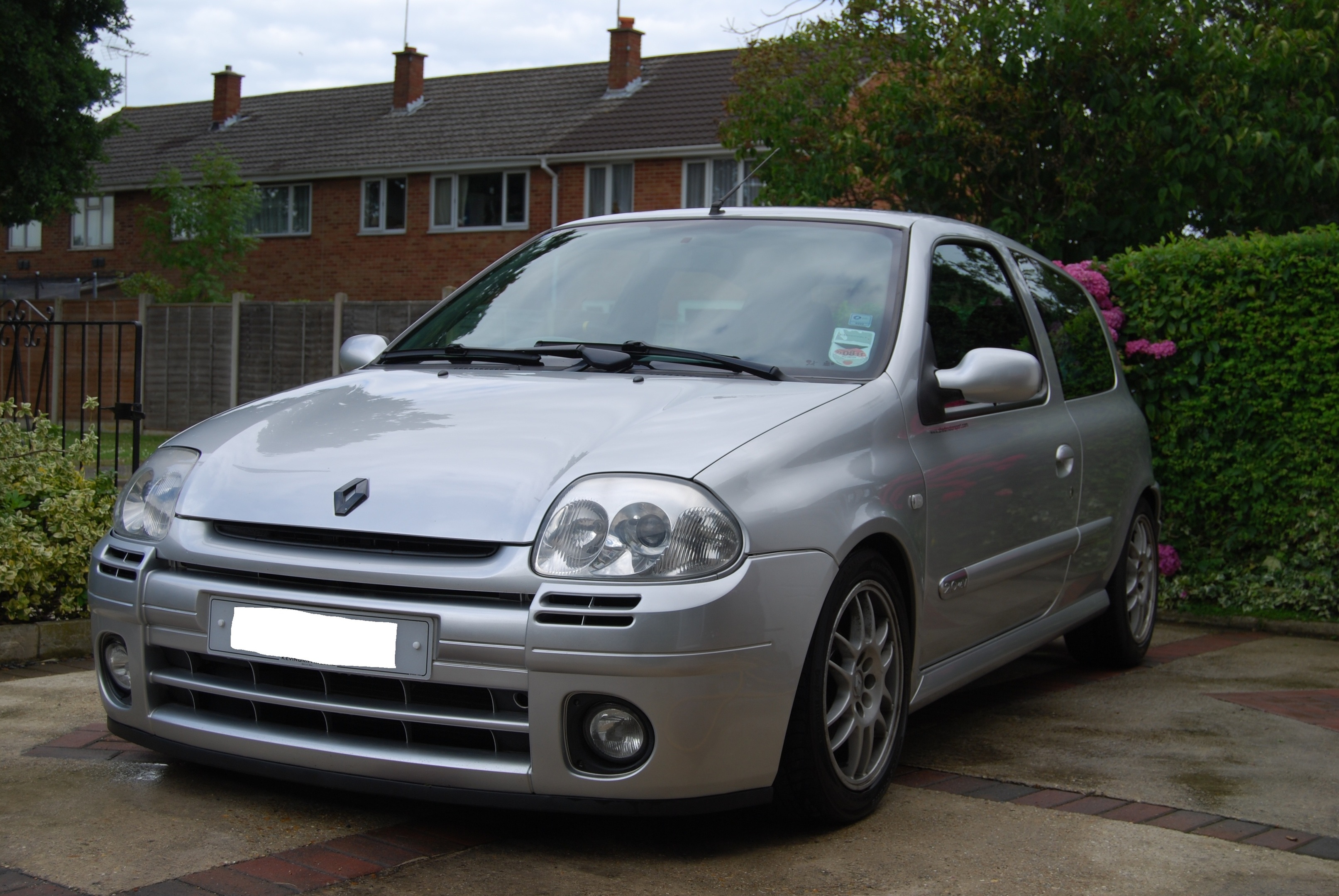

looks good mate :) what mm spacers did you say are on the front of the car? megane option sound good, im sure this would sell very quickly on here
20mm look good. im looking into the eibach 25mm one's, seem to be in stock at the moment
