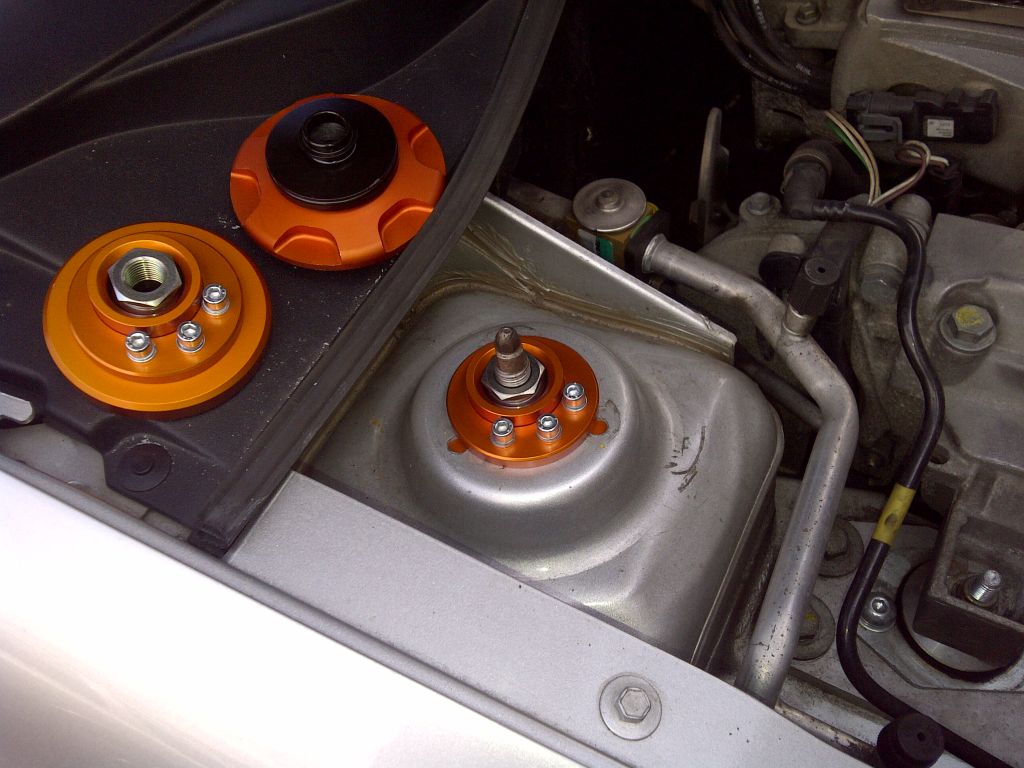

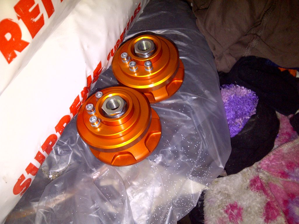

Fitting these:
To this:

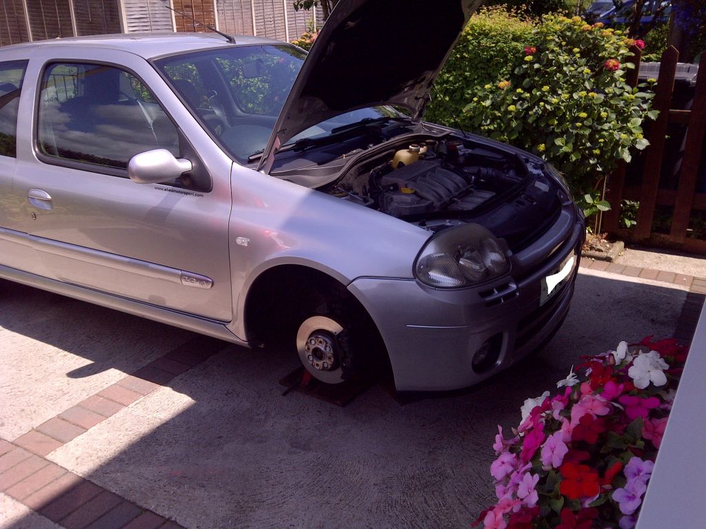

So before I got started, I took a picture of the Ktec mounts still in place:
That sight quickly turned into this:
And then to this!

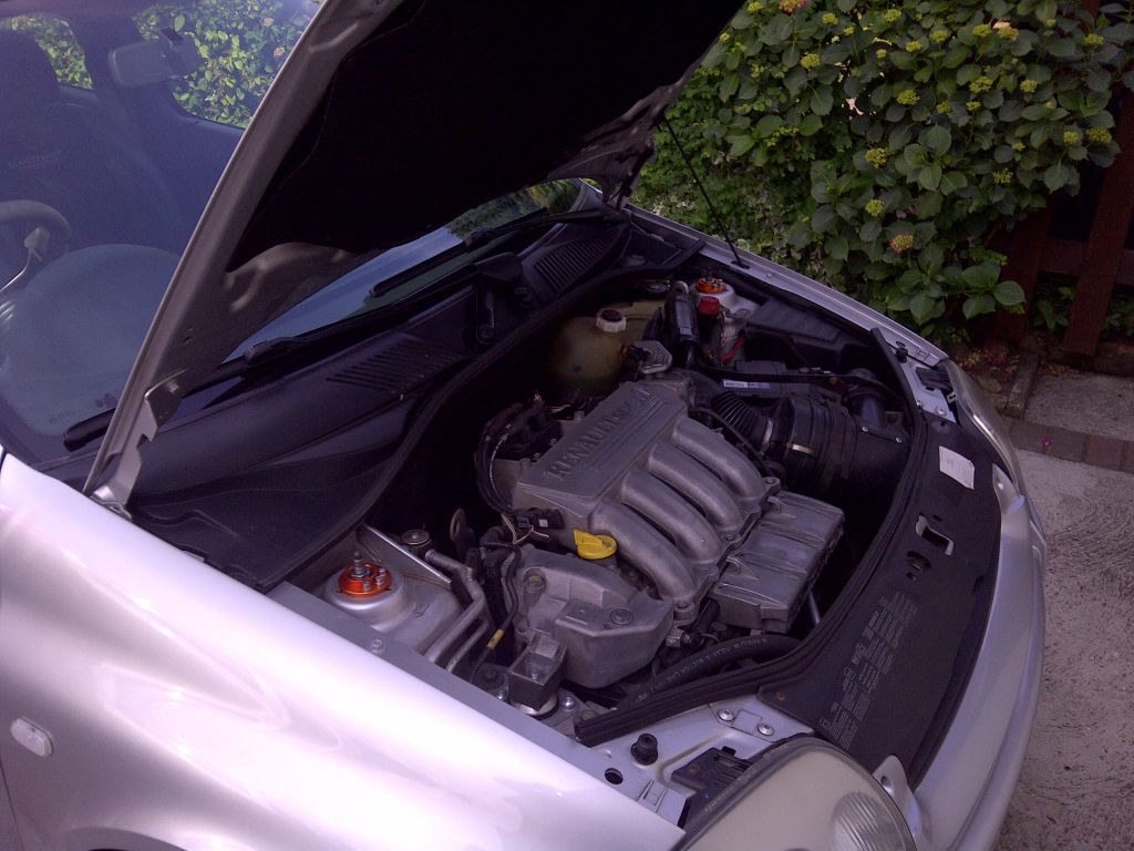

As you can no-doubt tell. I was very excited to get these mounts fitted. They look so good!

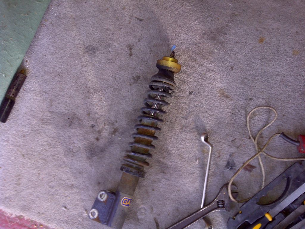

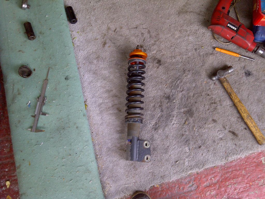

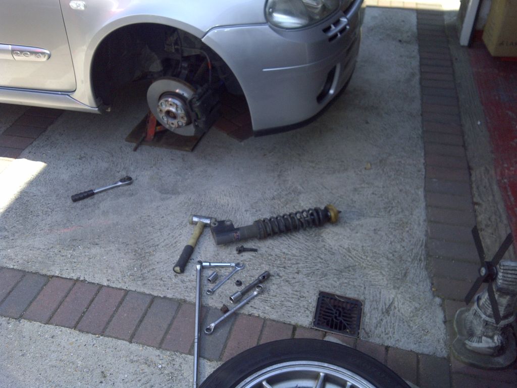

Strut no.1 ready to be disassembled!

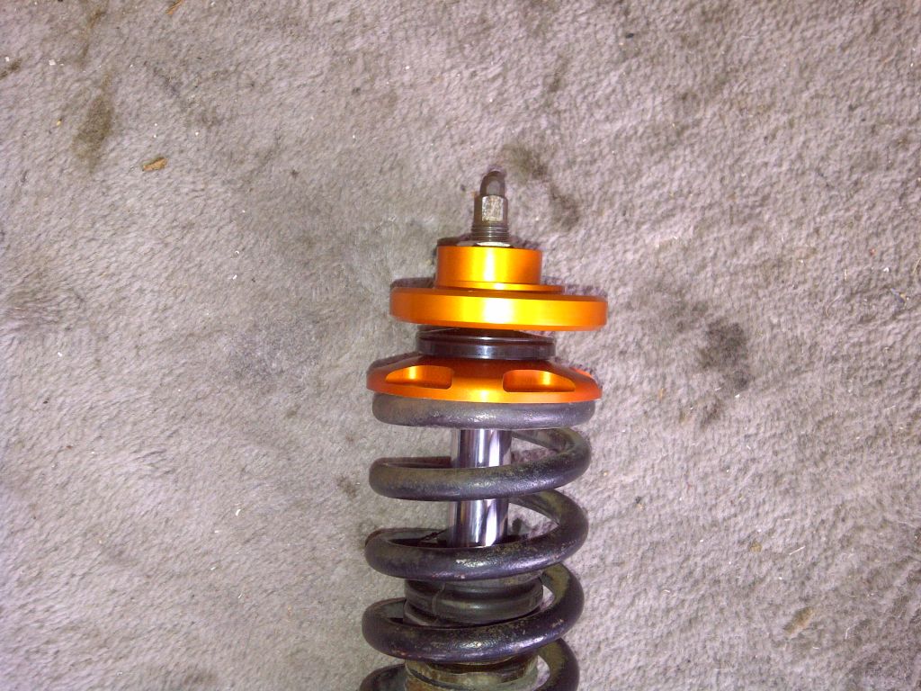

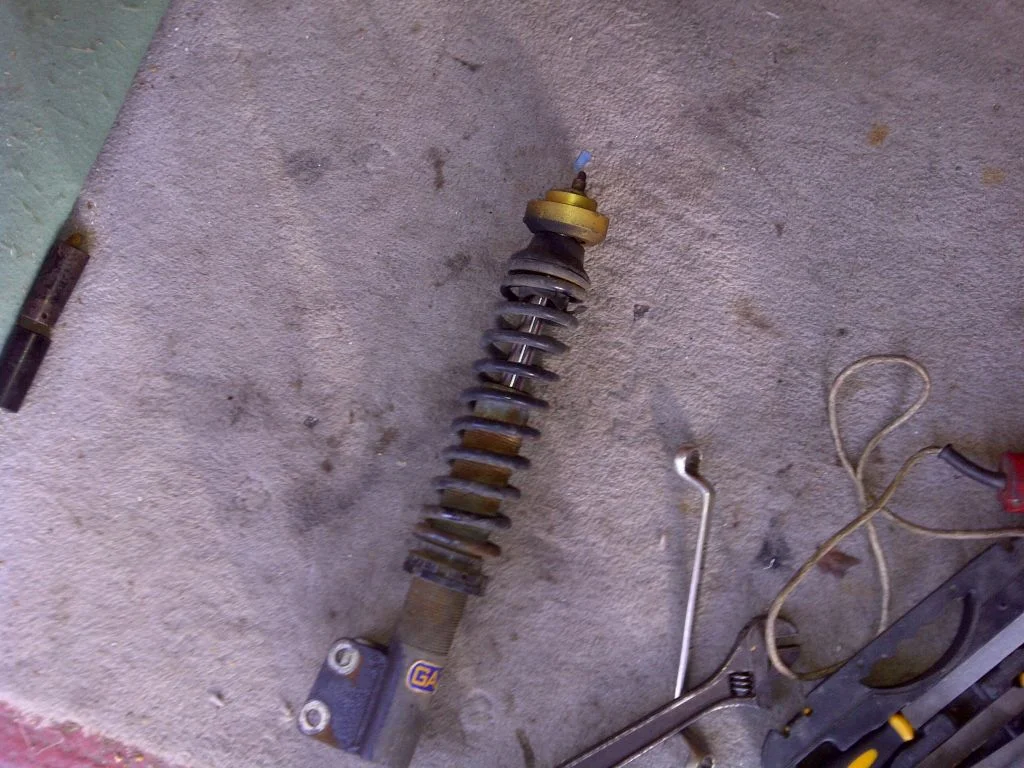

After I had managed to remove the Ktec mount from the strut. I went to fit the AST mount.
The spring mount that came with the AST mounts were slightly too big for the GAZ springs. This meant a bit of modification was needed to get them to fit! So a bit of filing later, I had them fitting like a charm, and bolted the mount all up.

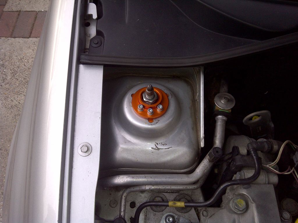

Ready to go back on!
And then got it bolted up to the car:
(You can see the holes from the Ktec mounts, I wish there was something I could do to cover them :()

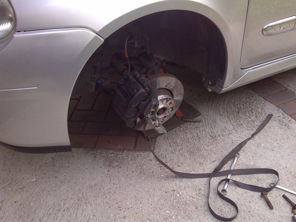

So, without further ado, I quickly removed the passenger side strut and got cracking with fitting the new mount!
(Had to ratchet strap the hub to the wishbone, as this side had the tendancy to lean a bit too far, which started to pull on the brake hose!)
Unfortunately no pictures for this side, but as you will expect, exactly the same as the drivers side ;). There was a fair amount of material that had to be removed from the inside of the spring for this side. Not sure why, but once that was out of the way and the collar fitting snug, I bolted up and away we went!

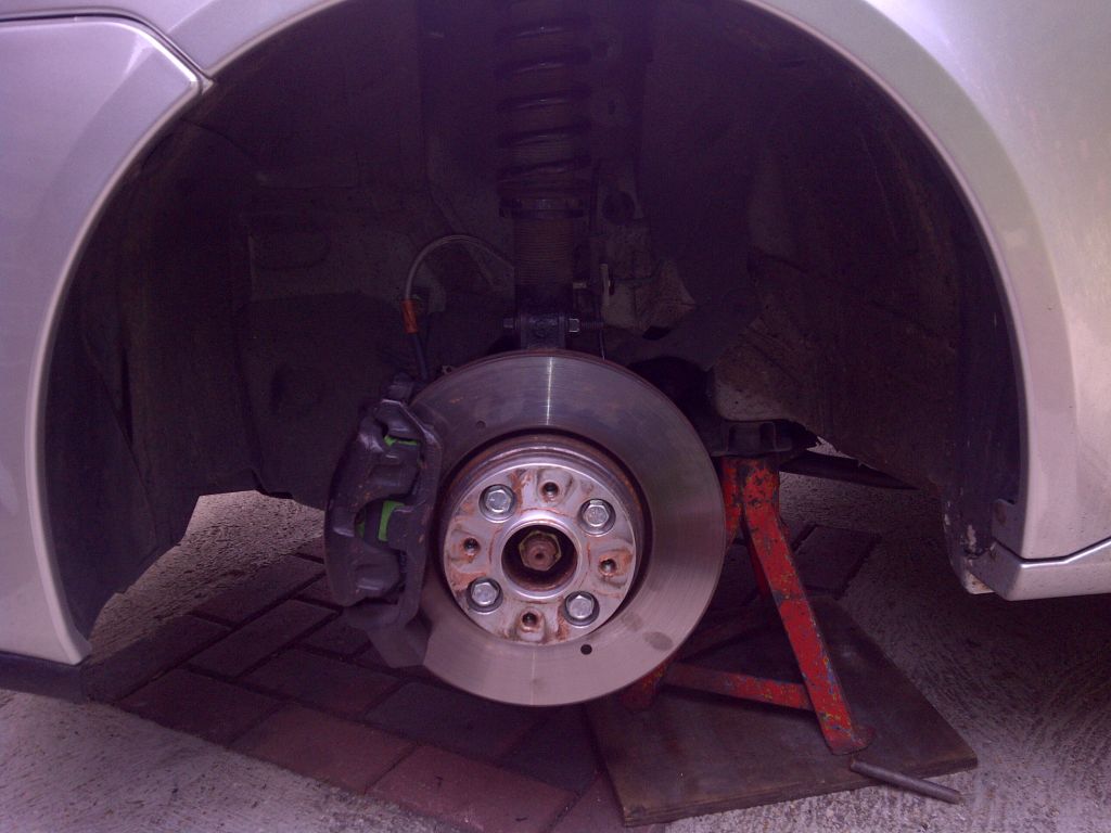

Once that was done. Camber bolts were re-inserted, and both sides were bolted back up!

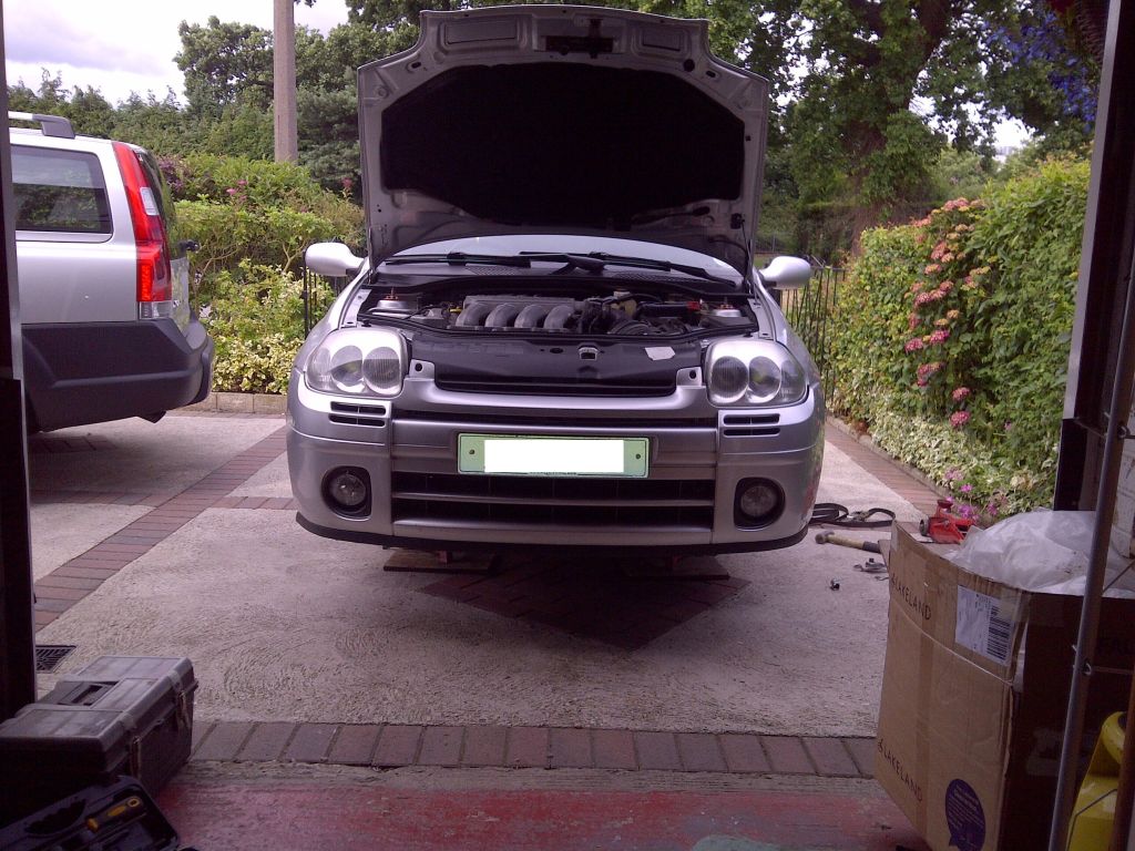

Finished article :eek:
Looking rather mean on axle stands :evil:
Once they were fitted, I put the wheels back on, lowered her back to the ground and noticed that I couldnt remove the jack from underneath..
The car had become lower with the new mounts. Not entierly sure how.. They must have a lower stack height than the Ktecs. I did like the look of it a bit lower though, so went for a test drive, to see if my investment was worthwhile!

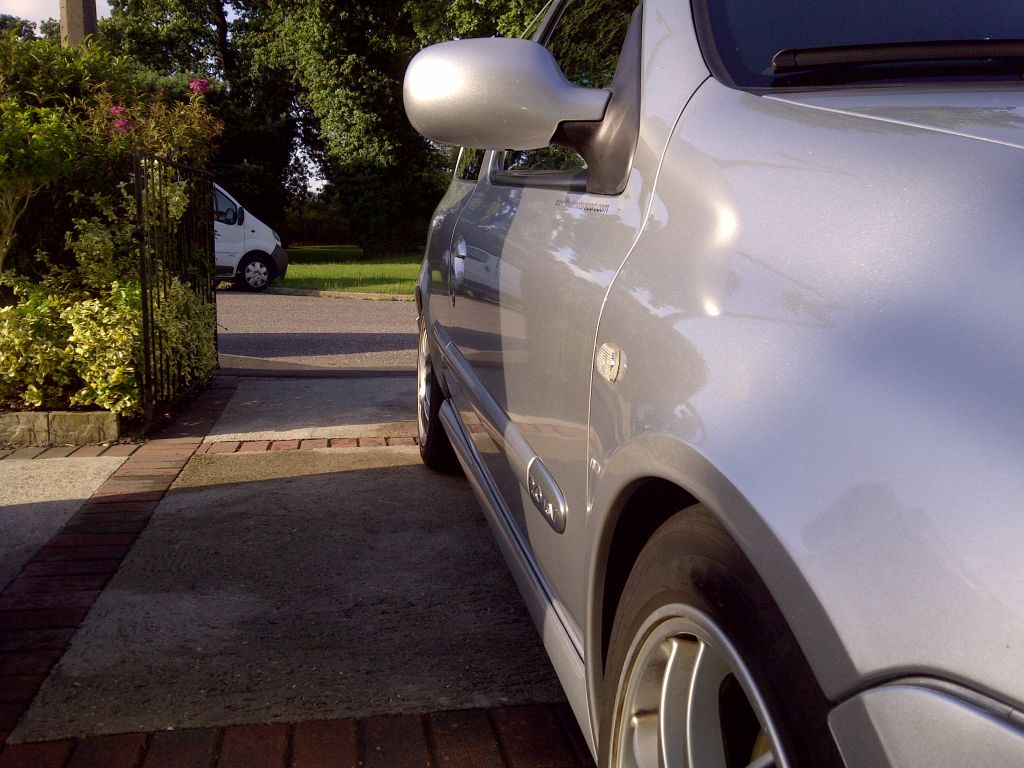

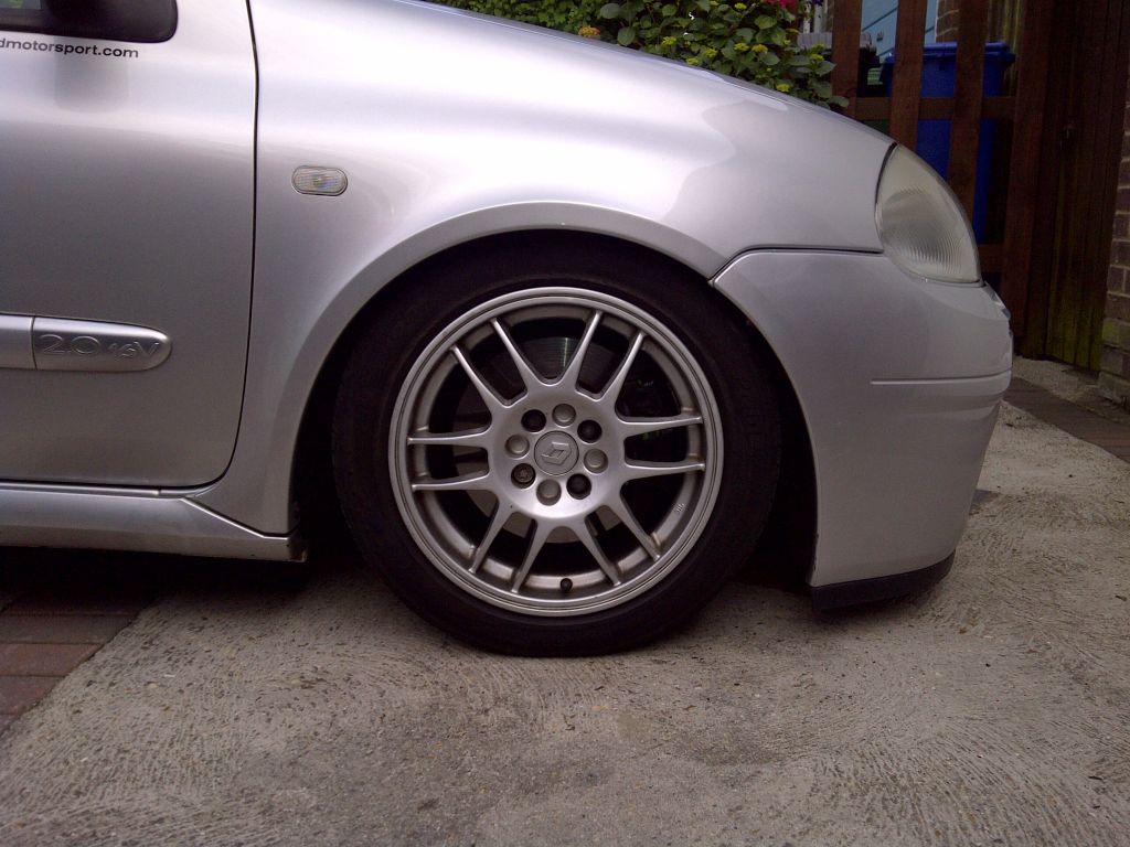

Unfortunately, for the first time in its history with me. The car was scraping..
This was how low she was running..
Only the tyre on the arch linings, but scrubbing is scrubbing, and was unacceptable!
I jacked it back up, and rose the ride height by 2cm either side.
Went out again.
But still, the same scrubbing.
Not sure what elese could be causing it! only happens when turning left and on the drivers side. Both wheels appear to be in the same position in the arch. With the top mounts set in the same position, the camber bolts at equal camber (by eye) and the height the same. Not sure.
The car is going in for a full setup soon, so hopefully that will sort the scrubbing out, but with a little less camber on both front wheels, it looks so much wider and mean! (I will get some good pictures tomorrow once I have washed it).

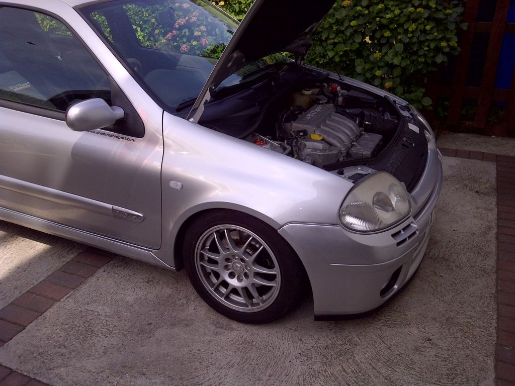

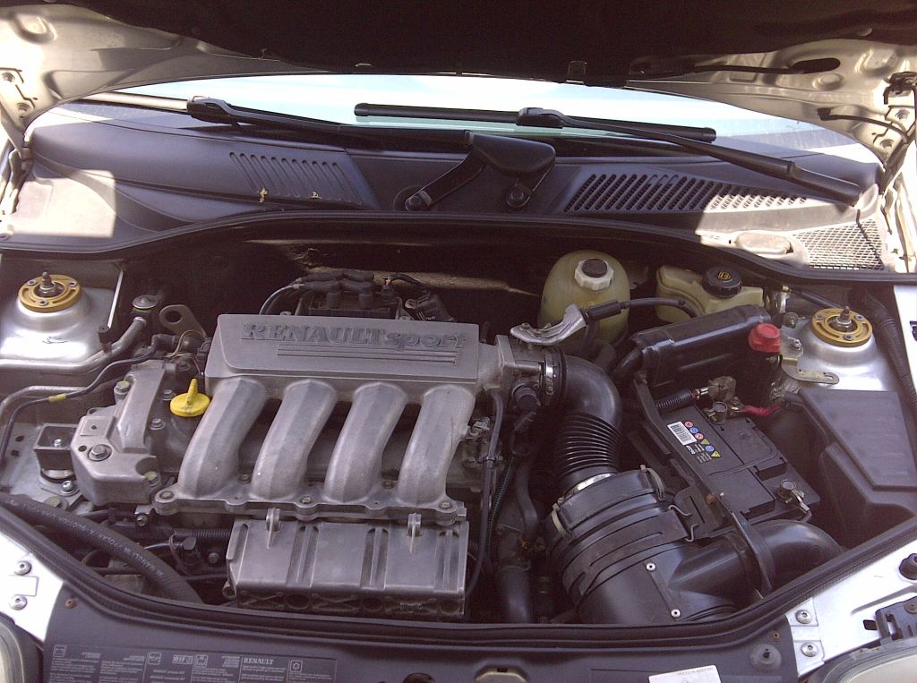

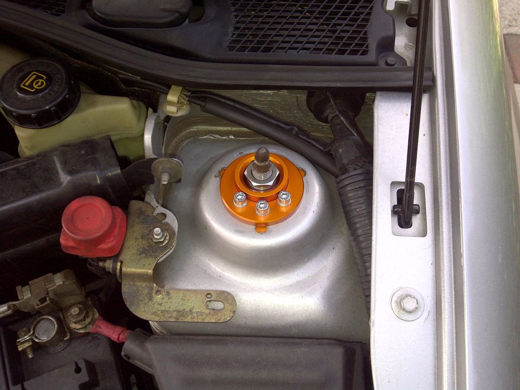

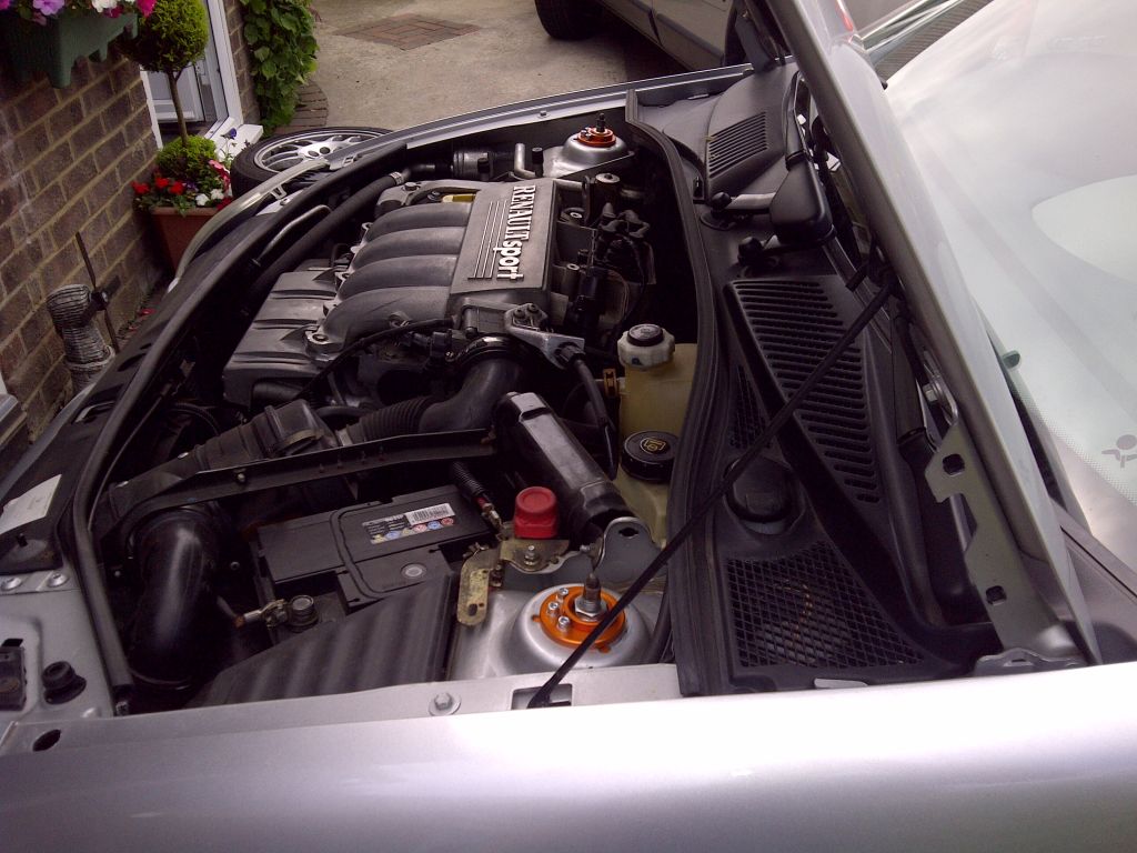

Why did you choose to fit the mounts at the 5,6,7 o'clock position? Got mine fitted at a motorsport garage and they said it was far more beneficial to fit them 6,7,8 o'clock on the drivers side and 4,5,6 o'clock on the passenger side. Said it was for better castor adjustment as the kw's has good camber adjustment anyway.
They look damn good in the engine bay dont they!
Nickson
I fitted them in the position to give maximum positive camber for now, until they get seyup correctly!
I only did that because I read that Clios suffer from too little positive castor :eek:
I'm probably wrong at any rate, but they will do for now!
They look awesome in the engine bay mate, love the look of them!

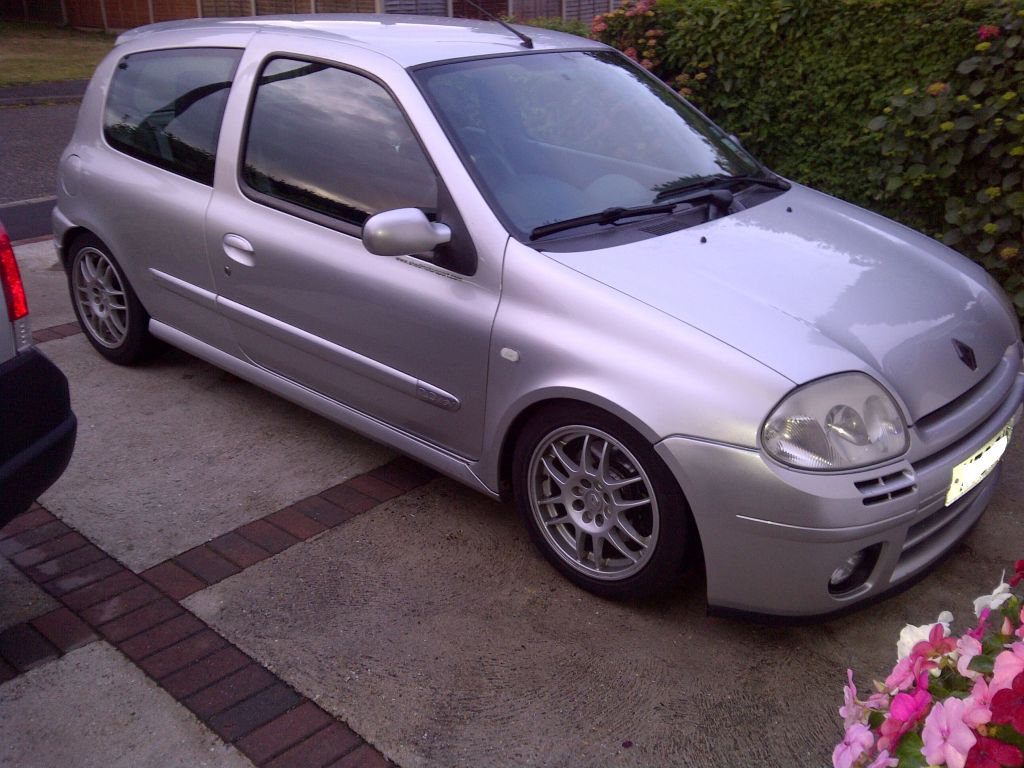

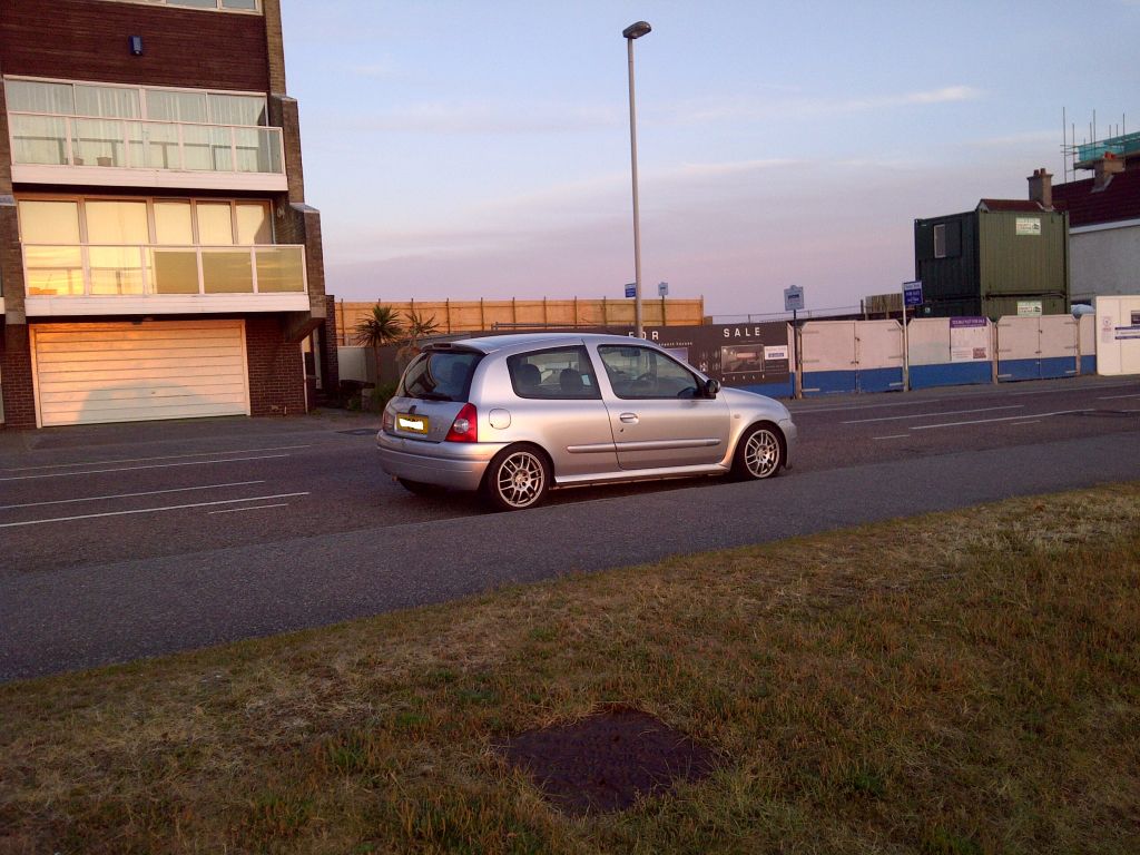

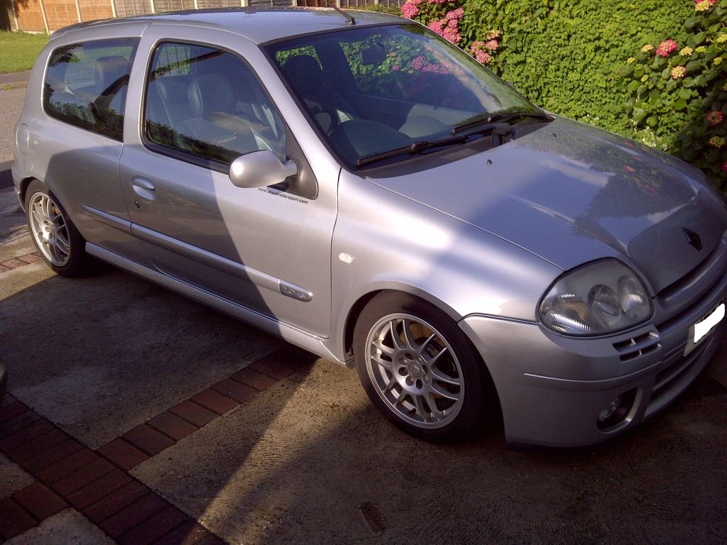

Went out in the evening to watch the sunset, so got a few pictures of the Clio whilst there ;).
I think I have got both ride heights pretty much spot on, few little pictures:

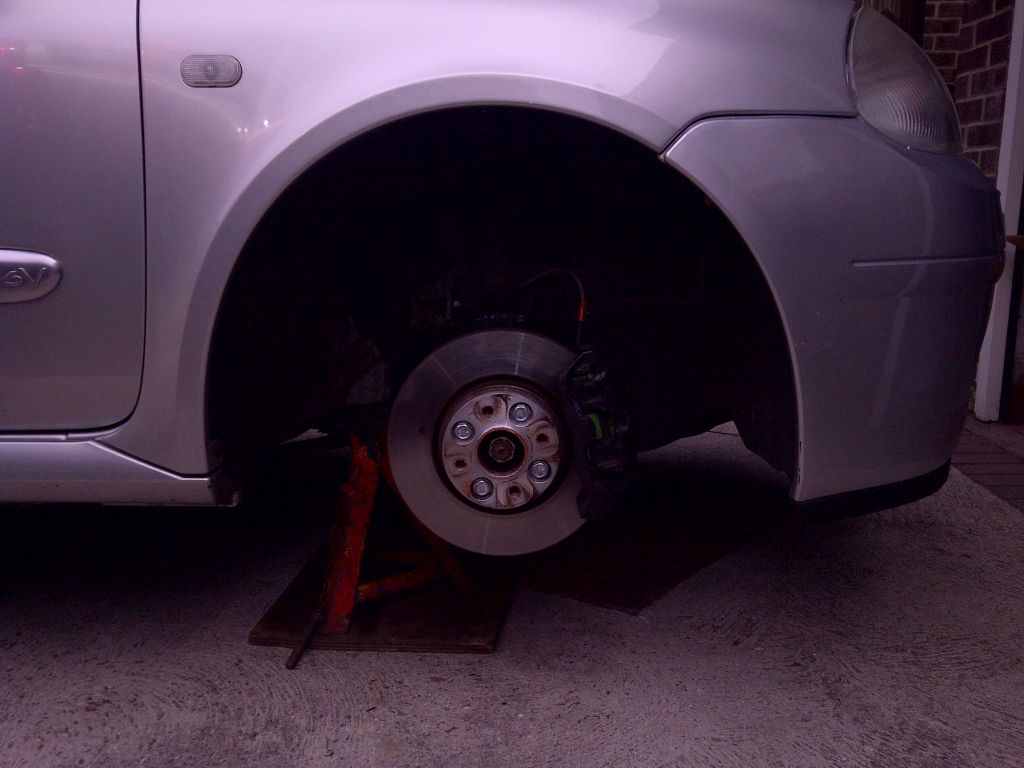

I set about fitting the new bottom balljoints and track rod ends, in an attempt to quash the annoying knocking from the front of the car when going over any type of bump.
The parts that I was to be fitting:
Started work, but with the weather today being absolute shite, we had to keep stopping and standing in the garage for 5-10 minutes to let the rain showers past.
Took much longer than I was expecting to be honest, the balljoints were an absolute b**ch to remove, but we soldiered on in the cold and wet to get it done and out of the way with.
Finished pics, everything bolted up and ready to go!
(Ignore the rust on the discs, I did say it started to rain :eek:)

I have exactly the same issue with my AST's! I may ring Curtis and see if he has an improved bolt setup now as I saw some at JMS with a different bolt setup.
-KarL-
i had the same problem when i bought 20mm spacers, i sent them back and got 25's instead.
also thought about painting the spacers? i think they would look better black ;)
Nickson
I'm glad it's not just me!
Let me know if there is a newer bolt system please mate, it's very annoying coming loose every few hundred meters!
What problem? :p Rubbage? Did the extra 5mm sort it?
Bit of irony really, as I originally bought 25mm's, but the next day I had a phone call saying them didn't have any in stock, would I like to change to either 30 or 20.
Opted for 20's as 30's seemed a little too much poke!
I havent't thought about it if I'm honest. Maybe I'll get them anodised ;).
-KarL-
yeah i dont like the look of seeing spacers behind the wheel.
nah with the bolts being longer than the spacers the wheel was never fully tight
Nickson
Ah right.
Well I could quite easily get them anodised.. Pretty sure they are made from Aluminium.
Ha! It was a bit annoying!
10 minutes with the grinder quickly sorted them problem though :D
