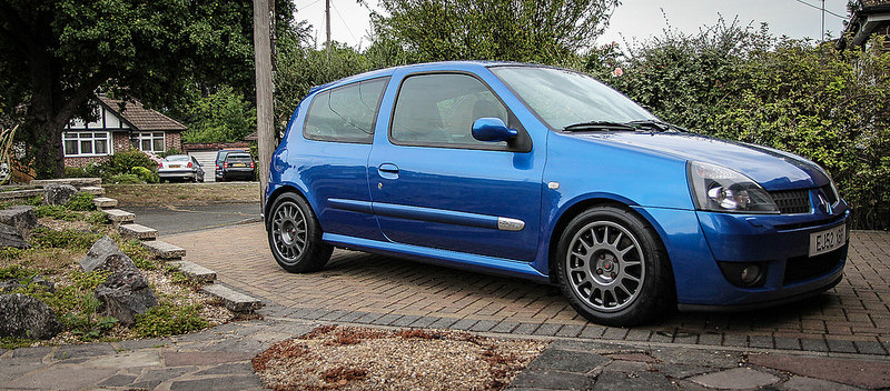

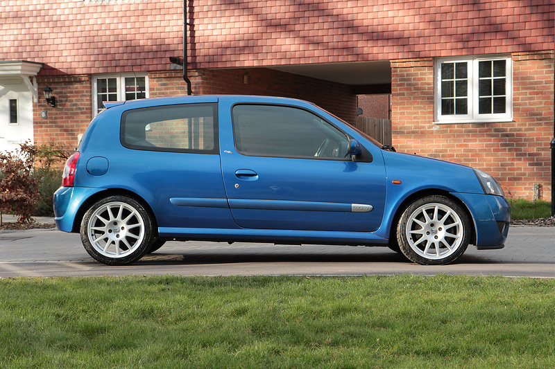

B14 is by far and away the best suspension I've experienced for a road-going Clio.
More compliant and far more comfortable than standard or eibach shocks/springs. And the grip levels were incredible, so much confidence as it felt like the car was planted on the road, rather than perched on top of it.
I had the 'lower' Eibach sportline springs before going B14, they barely did anything.
Clio 172 Cup
by Adam Lister, on Flickr
B14:
Renault Clio 172 Cup
