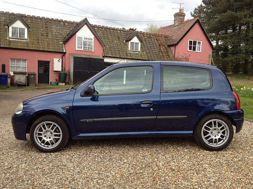

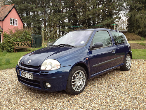

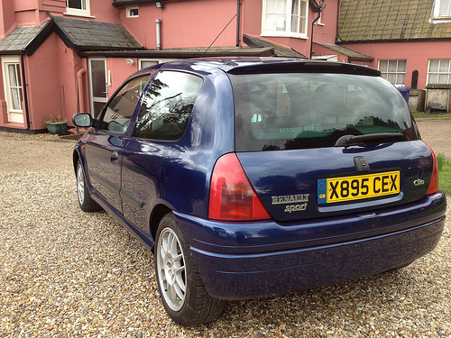

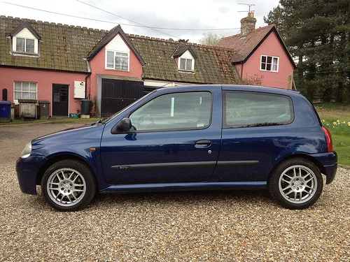

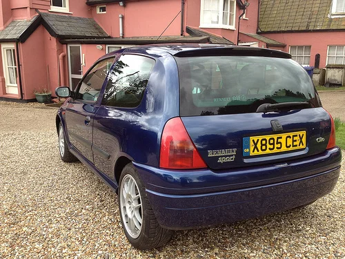

Yesterday I picked up my new project. It's a 2000 Odyssey ph1 172 with just under 90k and only 2 owners from new, oh and it's completely standard:)
Here she is
http://
Untitled by Rhys Beal, on Flickr
http://
http://
Only thing missing in the pictures are the arch linings as I had just removed them to pressure wash underneath the car.

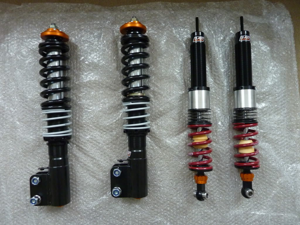

This morning I was offered some brand new AST Sportline 2 coilovers valved for a very similar spec of my car (to be) and at a price that I simply could not say no too:D
Here they are;

Well as you can now see from the post above I have taken the risk!
For me, knowing that I can have them setup up and worked on very local (2 miles away) is the winner for me. I can also buy off the shelf springs if need be.
I really do hope that AST sort their issues out otherwise I will have to use AST in Europe.
I will drop you a text then and yes they will but you will need different collars specific to your coilovers. They are not expensive but I do have some top hats but unsure whether they will fit your springs. I will sort them out and drop you a text later mate:)
Oh my, they're really nice! I can see AST's appearing on the Megane at some point.

Haha that was quick Rhys :) As above they certainly look the business! Cant wait to see them fitted
They wont be fitted for a little while as I want to sort out the front wishbones with PMS's kit.
After going round in Porkie's 172 at Snetterton, I certainly know they perform well:)
