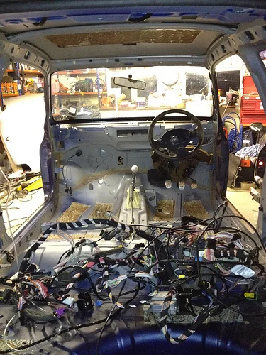

I think the dashboard and windscreen is going to be a pain to remove. Want the windscreen to go back in aswell so got to be very careful
Haha! So why's the window screen got to come out? To get the cage in?
As for electrics, just get 3.3omh resistors and short everything out;)
I won't need resistors to short everything out.........I can do all that on my own;)
The cage has the gusset plates at the front pillars that has to be welded to the shell so the windscreen has to go.
I shall have to look for the guide then, and it's not my fault that progress has been slow...........

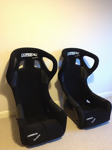

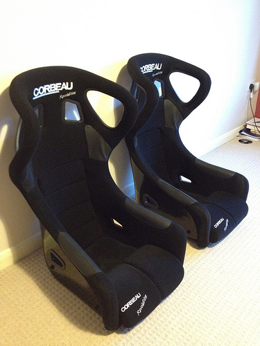

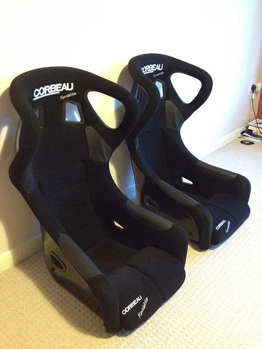

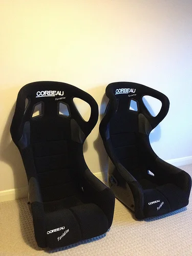

Once again, items keep coming up at the right price! Tonight I picked up a pair of brand new Corbeau Evolution seats. I am a 32" waist and I can only just squeeze into them. Exactly how I wanted it but my passengers will beg to differ!

Lush seats! Where did you find them? As you know i've been looking for new seats for ages lol.
I found them on ebay just outside Stowmarket. The cheapest I could find them on the net was £498 each. I paid £325 each and they still had the polythene on!
I will PM you a couple of links Lewis as I am watching a fair few seats on ebay atm and I hope they are within your price range....
They look awesome! 32" looks like I won't be a passenger;)

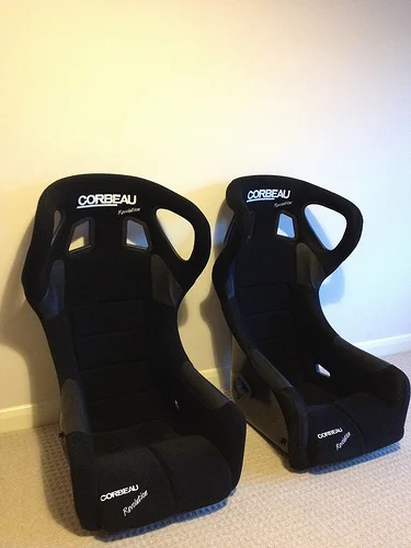

Fat!!! Well jealous epic threadness!!

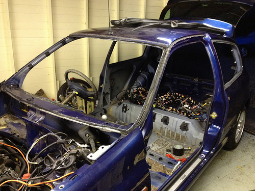

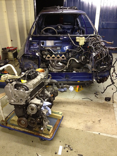

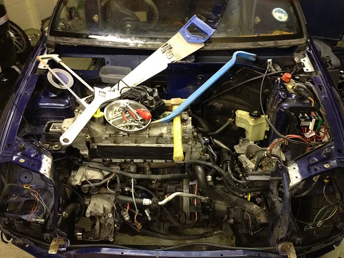

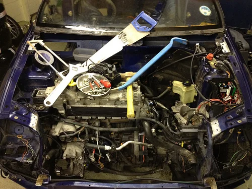

So changes since last time are something along the lines of, dashboard, heater, wiper motor, washer bottle, battery, radiator, condenser, inlets, front bumper, alternator, air con pump and most, if not all the pipes and lines, and various other insignificant bits that I no longer require.
Genuine Orbisoud cup racer exhaust should arrive tomorrow ready for me to do some fabrication work. :)
http://
Untitled by Rhys Beal, on Flickr

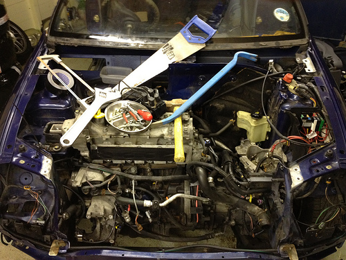

Naturally, I used the correct tools....

Why didn't you picture the circular saw?
Also you need a bigger passenger seat! ;)
lol
I will have the seat bars and brackets put in so that I can bolt your seat in there too so will need to take some measurements from your seats sometime.
What on earth did you use the bahco wood saw for!? Your worse than me haha!
Worked well for removing those "tough to get at bolts".......are they not recommended then?..

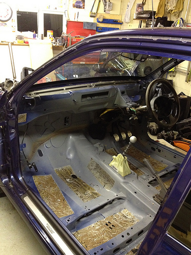

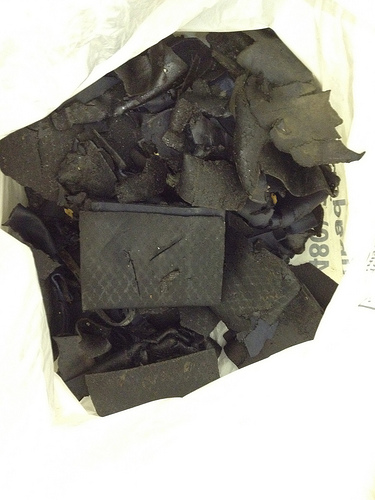

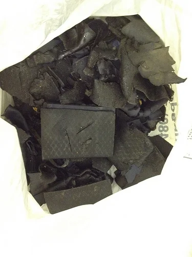

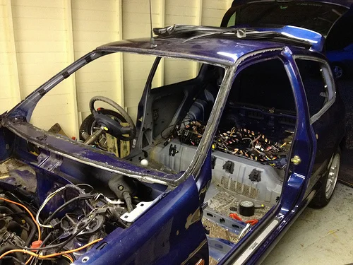

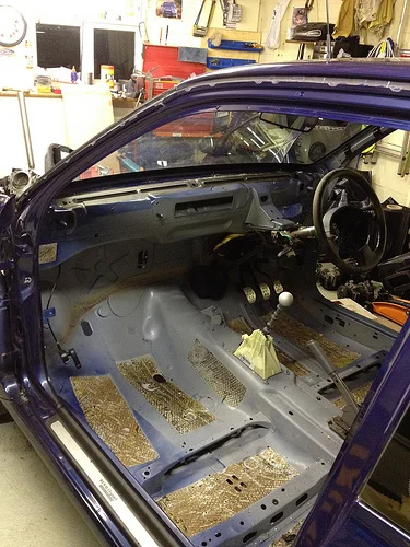

Thanks to Scott and Zack, I now have a very heavy back of tar:)
http://
A tad over 9kgs :D

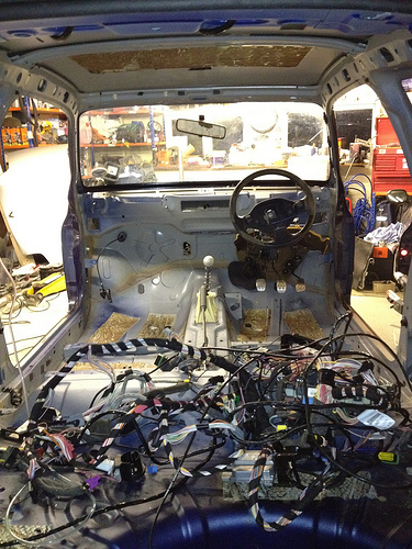

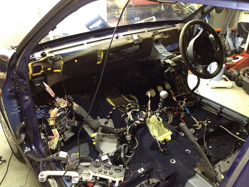

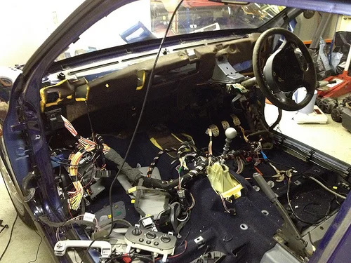

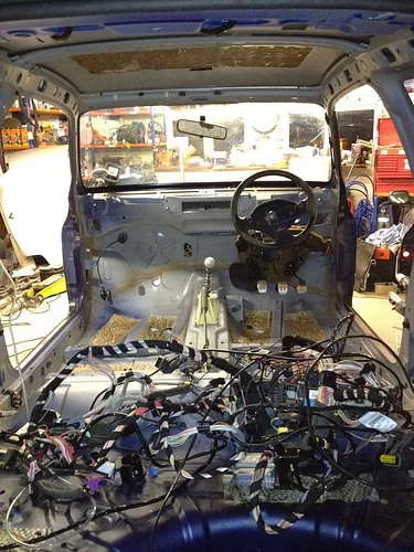

Also removed the loom inside the car so I could finish stripping the carpet and foam.
http://
That was another 10kgs exactly
A heck of a lot of wiring mess to cut down and sort out:S
Anyone that is prepared to work for cups of tea and cheese toasties to cut down a loom?;)

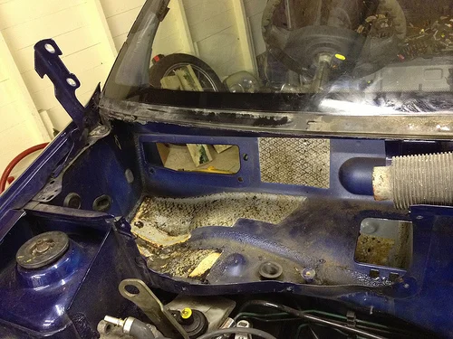

A few more pics of the patches where tar used to be

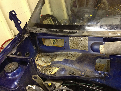

Also removed the tar on the rear upper quarters. Quite time consuming and fiddly = plenty of blood
Got some cheese wire coming next week so I can remove the windscreen and N/S rear window.
Also, Tuesday should see my cage arrive. Hopefully by the end of the week I will have the engine out and various brackets inside removed ready for the cage to be fitted possibly the start of the week after. We shall see.

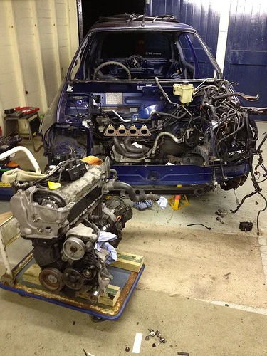

Rear 2 weigh 5.8kgs together, hoping poly's will weigh around 2kgs
All going well I shall have an engine hoist (borrowed) so will whip the engine out
How easy were the rear quarter windows to remove?
They look just bonded in?
Peace of cake with the right gear. Braided cheese wire from ebay, 22 metres for under £6 delivered, make a little hole/poke the wire through, a pair of molegrips on each end and wiggle/pull till it cuts all the way around. Clean off the excess with a stanley.
