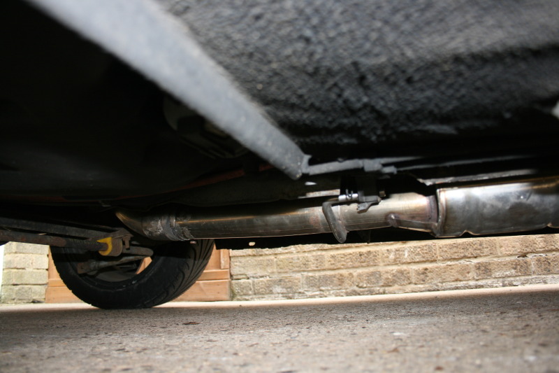

Me and my Dad had a look with a torch when i got in, as he was determined he could fix it. The exhaust is truly battered, I managed to poke another hole through it with my car keys.
Ill get proper pics at some point.

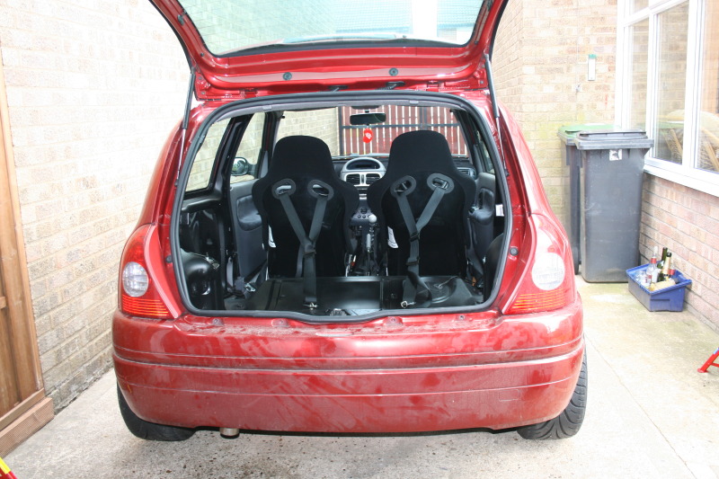

On friday i think im going to fit my other bonnet pins to my boot, as when driving with the window down my boot bangs and shakes since i gutted it lol.

That will make the back end look good, I like them pins in the boot lid:D

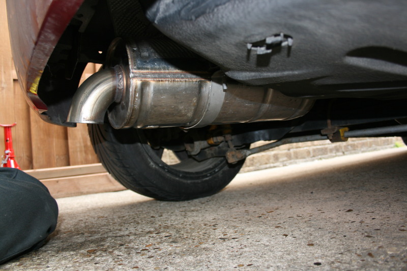

Exhaust is on it's way. If it comes before 1pm I should be able to fit it :)

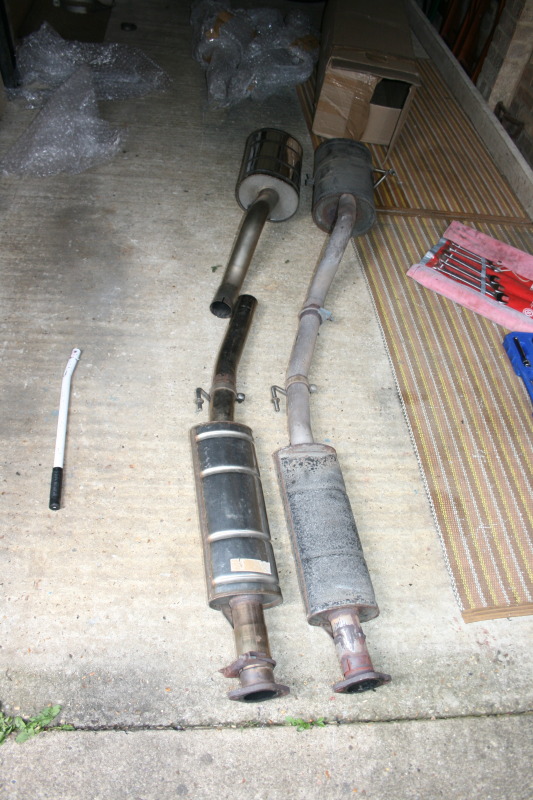

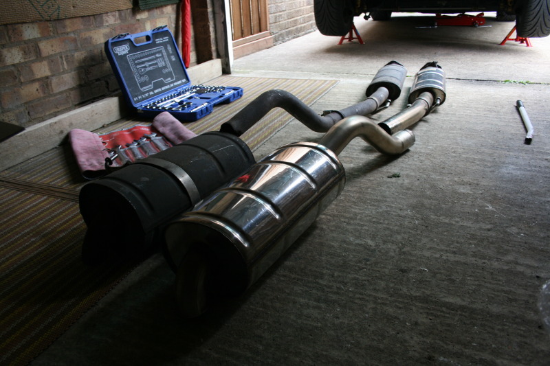

Exhaust turned up at 10.30 this morning. The stainless system seemed alot lighter too.
Old vs new.

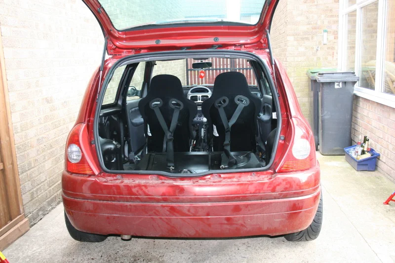

Few random pics of it on.
Sports cat can just be seen.
What it looks like from the back. Can just see it.
As always here are the bad points,
-Vibrating against the heat shield, so ill bend that at some point.
-5th gear isnt going in properly, it goes in but not as far as the other gears. Im presuming ive either knocked something or the gear linkage is catching on something like the second lamdba sensor. Ill try sort this also.

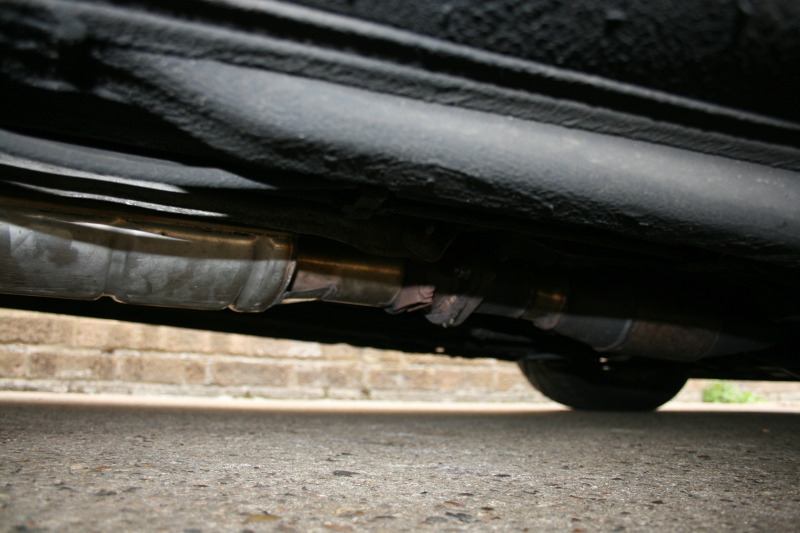

Can't find it in this thread, but whoever recommended the people that welded that sports cat in needs a slap
I have the car currently ;) spent half the evening rectifying the job that had been done. Gear linkage had smashed the crap out of the lambda so it was fully dead. Exhaust and cat fit PERFECTLY now ;) along with a nice new cat fitting kit
Well that does surprise me actually as they did me a silenced decat, admittedly I had alot of trouble with the crappy powerflow silencers that they use so they made me another one but won't be using them again tbh. You get what you pay for.
