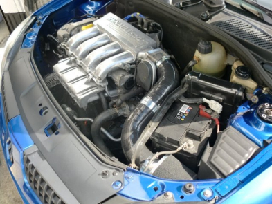

It's two 90 degree silicone hoses and what looks like an ITG filter, eBay for two silicone hoses around £20-30 then an ITG fitter for about £50
Yea just quickly looked on eBay and can do it for 90 quid!
Lol!
That's not even trade prices that K-Tec would get to then sell on, fair enough making a profit but £150 is taking the piss!
it's a single hose for a start, with a breather take off built in, and the insides of the filter are the clever bit. It's definitely not an ITG (LOL!!!!)
Single hose?
Even if you did it with a samco/forge hose with take off and a hard pipe, which would look better, it would still be just on the £100 mark.
What's so special about the filter then? And what make is it?
Single hose?
Ths was an early prototype
So far I see no facts.
To me that's an ITG filter with base sprayed black.
I genuinely cannot see it making a difference of what filter it is down in that part of the engine bay.

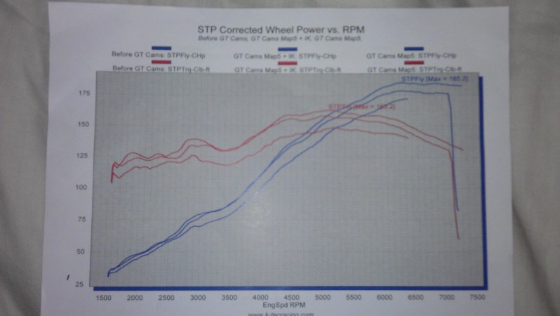

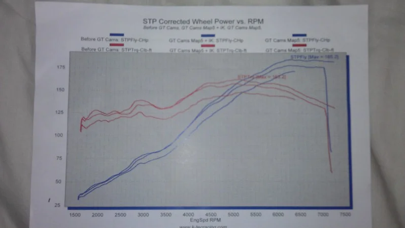

From the graphs I have seen with that induction set up,peak figures are good but it seems to loose you a fair amount of torque in the mid range,would only fit one if you are obsessed with the peak figure if your car.
Glad your happy with your car Dan,will be interesting to see what it makes on FMS rollers now,that's if they are still operating,went there the other week and looked like they may have closed.
Out of interest what did yours run at FMS? Be gutted if they closed down, they were brilliant at the rolling road day, proper nice blokes!
On the graph it gains torque throughout most of the rev range, and the power gain is up top with the induction.
Bottom one is before being mapped but with the cams in, they stopped the test at just after 6k due to overfueling or something, im not 100% sure.
Middle lines my current setup unsure why it drops like that at the end as the car holds power all the way through to the top.
And the top line is with the ktec induction setup.

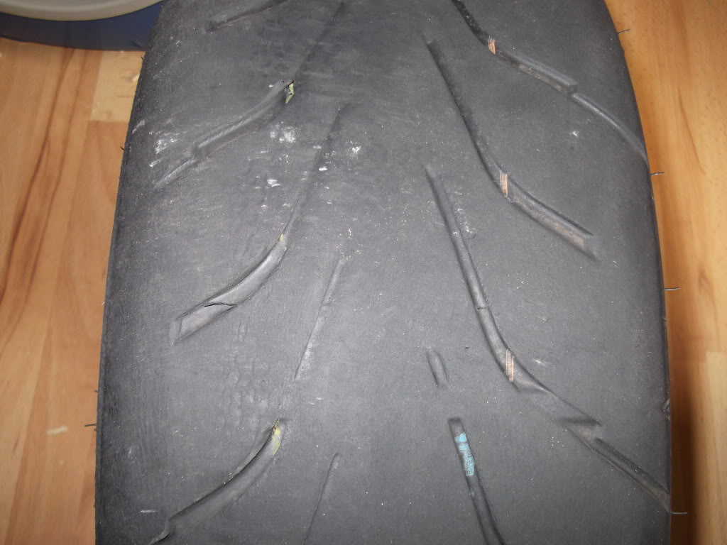

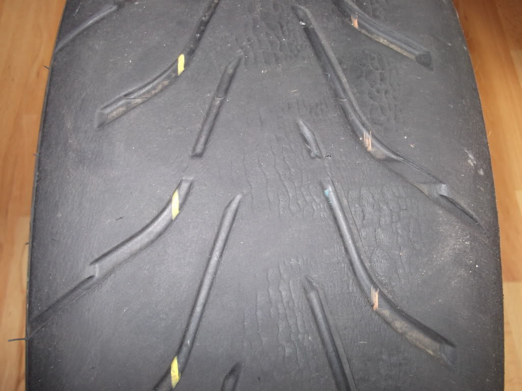

888's are very good,but if you use them to there full potential the fronts will only last about 2 track days,mine had 4mm on the them and I totally trashed the offside front in one day at snetterton,makes track days silly expensive.
Will at Snetterton on june the 14th,its a evening one with javelin.
the tyre in question
The other front didn't fair much better
My parada spec 2's lasted a lot longer,not as grippy but half the price,going to try some AD08'S next hopefully they will be a happy medium.

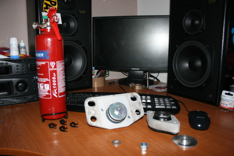

These turned up this week,
Ktec solid enigne mounts second hand, fire extinguisher that I got from work and some p-clips to tidy up some wires.

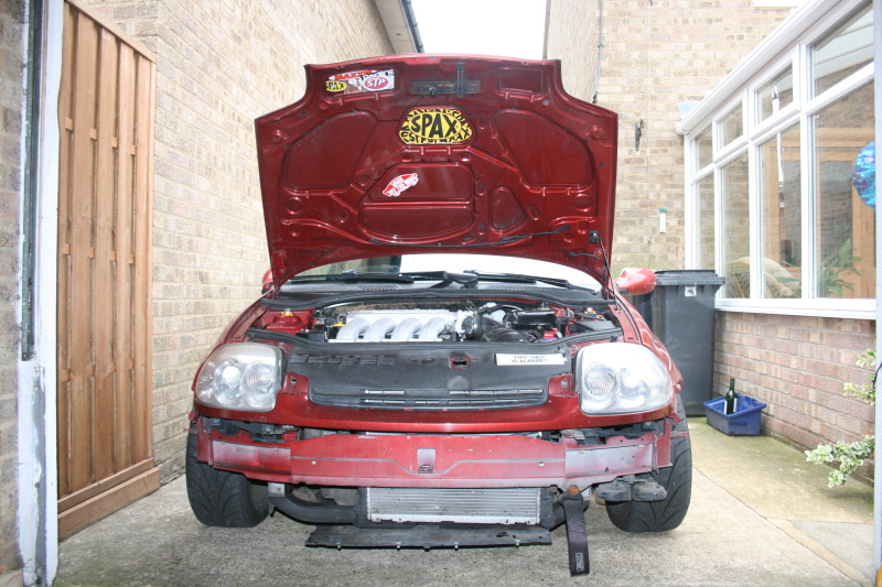

Quick release bumper off in about 90seconds.

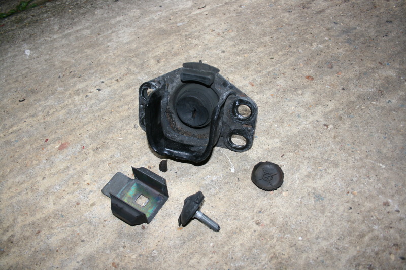

Old engine mount split in two, always had a slight knocking from the engine mount but wasn't aware it was that f**ked untill Dan @ 519 told me :o

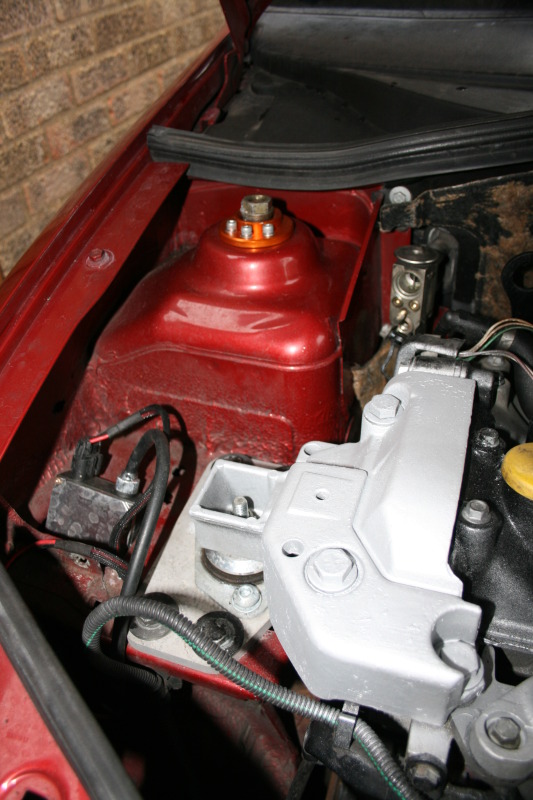

New engine mount, swapped out in about 15minutes. Also painted the cam cover bit whilst it was off.
Can also see my lovely AST top mounts too!

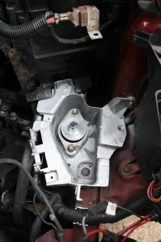

Next up was the gearbox mount, after pestering DannyR by text i soon realised i was doing it wrong.
Un mounted the whole battery tray and bracket to the gearbox, got a electric impact gun from my Dad's work and got it swapped over, havent got a picture of the old one but it was in a bad state also.
Gave it a quick spray which soon got coated in crap from my grubby little mits.

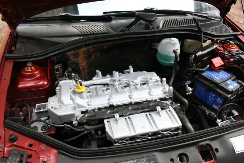

After that i decided I would spray the top of my engine as the whole thing was once painted by someone by brush with black. Tidied it up nicely :)
Can also see my new coolant bottle i got a few weeks back as the old one was weeping coolant.
I forget to get picture of it all back together. Just need to remove the nasty carpet at the back of the engine and fit something better.

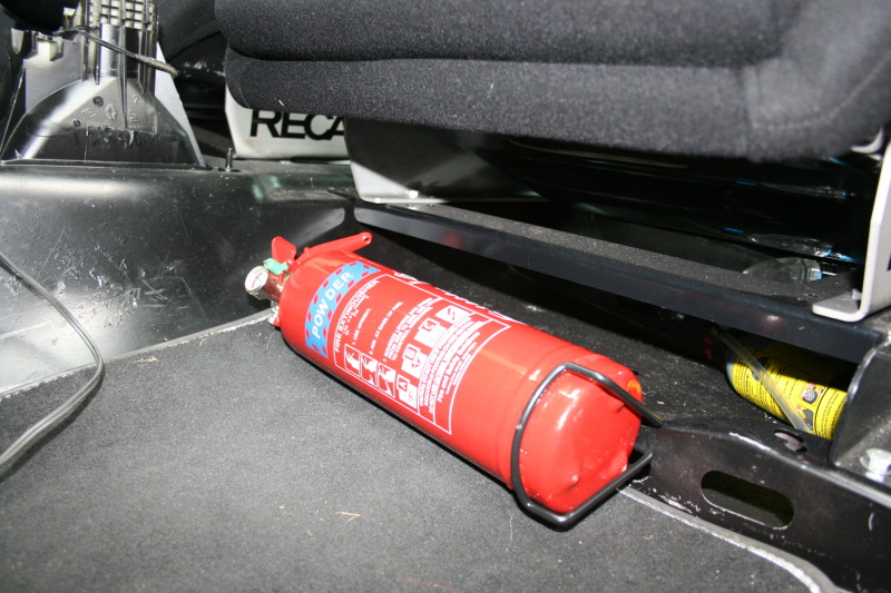

Mounted the fire extinguisher under the passenger seat, I also used the p-clips to hold the wires in place down the side of the car as i removed the plastic trim and sprayed it black (no pics of this)

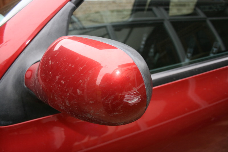

Then did this :(

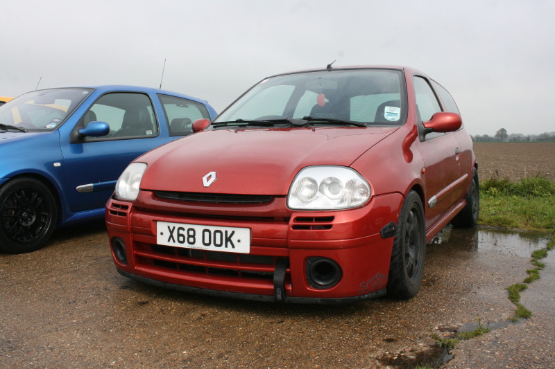

Pic of the car from a meet the other week :)

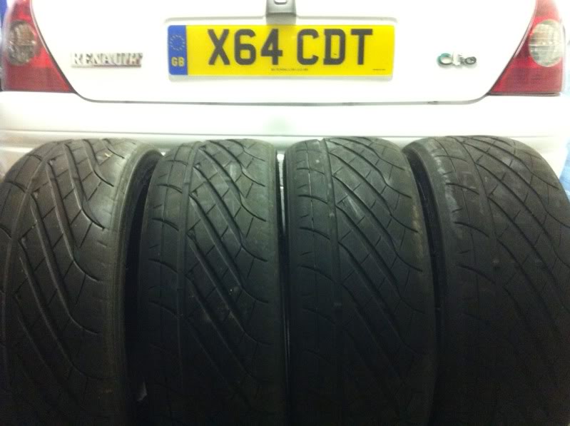

After Lewis offered me a deal i couldnt refuse i headed to Norwich via DannyR's to get some tyres. Got epicly lost which wasnt fun.
Parade spec 2's pinched the pic off lewis.

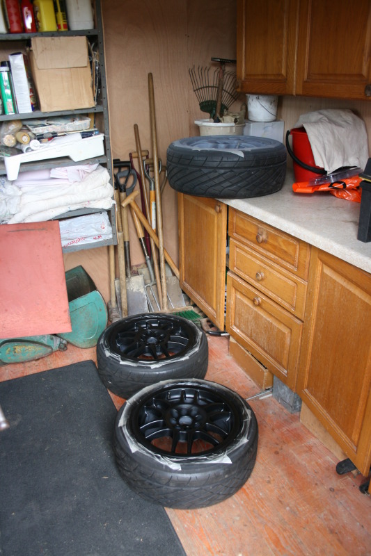

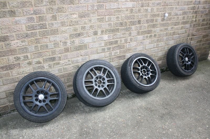

This week i started refurbing my wheels, got the tyres fitted this morning for £30 inc balancing which wasnt to bad :)
Few wheels drying out.

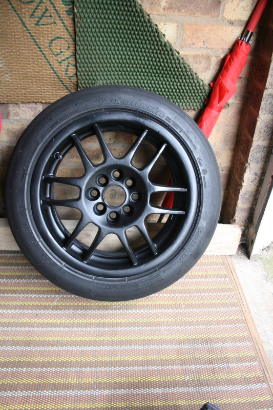

One finished wheel, as you can see the face of the wheel is pretty rough. The wheels need hours spent on them to get them back to being perfect, lots of chips, curb marks and various other damage.
I wasnt bothered about getting them perfect, ive never painted wheels before and managed to do this set using left overs from the past year. Cost me £12 to get some more black paint, so pikey refurb!

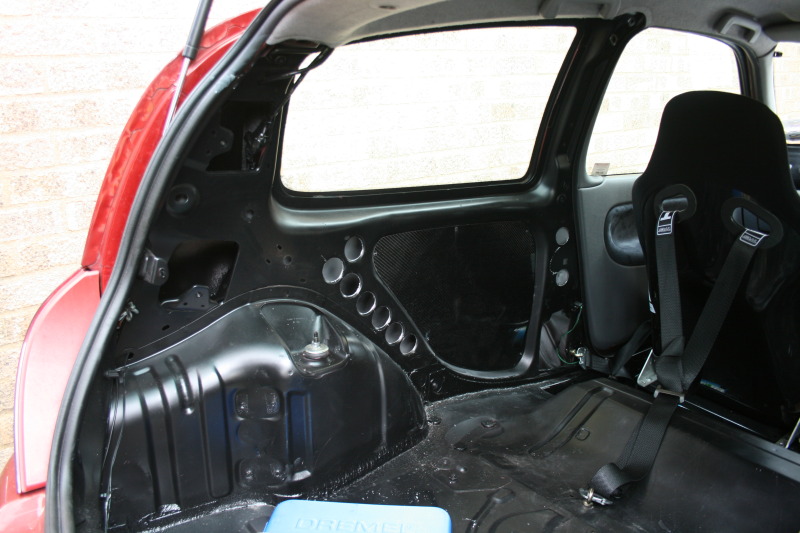

I also got the swager thing from lewis, so attacked the rear pannel of my car today with the whole saw, mainly because it looks awesome lol.
I know the bottom hole in the line is not lined up with the others, had a bit of a moment.
I will paint the interior again when back from the ring, no point doing it yet!
