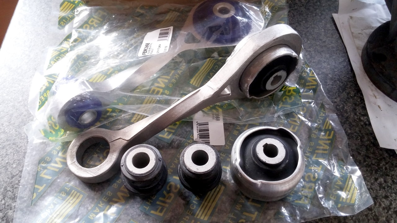

Would you recommend this for OE replacement? Searched everywhere for a febi but can't seem to find a match for my 182 anywhere
Sorry I missed this, they're softer than a 172/182 OE bush, but fine for replacing a shot one, I think I've got half a dozen pairs of these if anyone does want them, I was clearing out earlier and was gonna bin them but thought I'd check here just in case.
