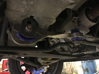

Not sure if anyone else has seen one of these yet, but i am so impressed by it, I felt the need to share.
I recently fitted a new prototype Poly dogbone from PhillipM. This is really quite impressive, much improved gear selection and control of the engines torque reaction. However absolutely zero increase in NVH. Similar to his honeycomb exhaust mounts, he has developed a dogbone/bush setup that actually seems to work with the engines vibration harmonics.
Phillip explained it has an internal honeycomb structure and voids similar to that of an OEM mount, yet is actually made of Poly that's harder than most other Poly mounts.
Sceptical, but willing to try it out, I brought one for my 182.
Now I've driven on it for a while I feel I can comment that this is a genuine significant improvement over the OEM item, but has absolutely zero increase in NVH. I've been modifying cars for over 20 years now and cant think of many modifications I've fitted that have not had some form of detrimental trade off.
Genuinely impressed with this, well worth a look if you want performance without a buzzing cabin. :)

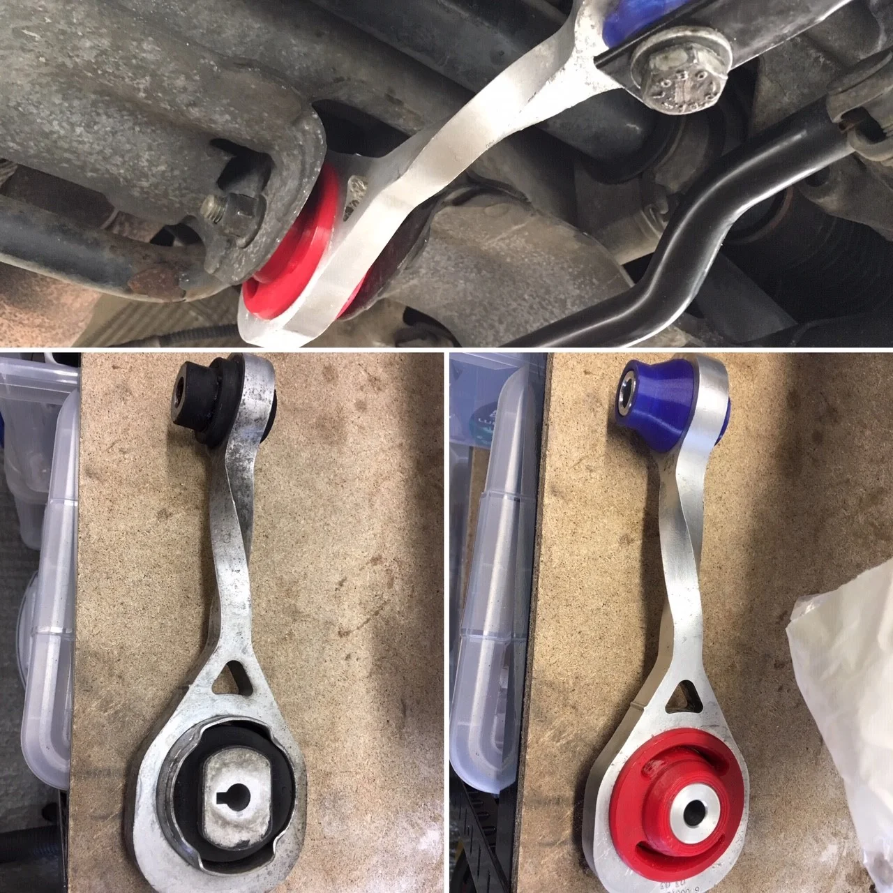

Just to echo the OP’s comments about this solution from @PhillipM
I can’t compare to other Poly mounts, but I had fitted in around 40mins and it’s a huge improvement over my stock dogbone mount with very minimal vibrations afterward.

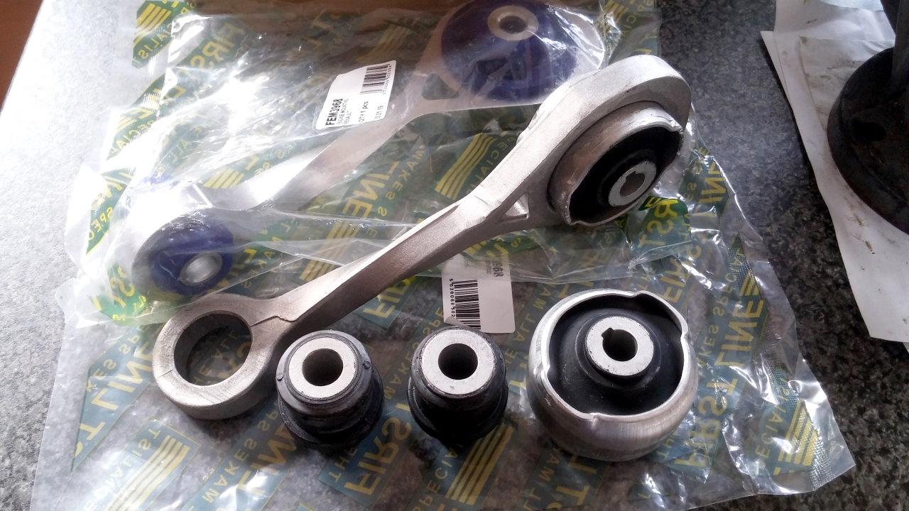

Anyone want some brand new Firstline bushes? I only bought them to use the housings, have two sets. Free if you collect 'em, or cover the postage.

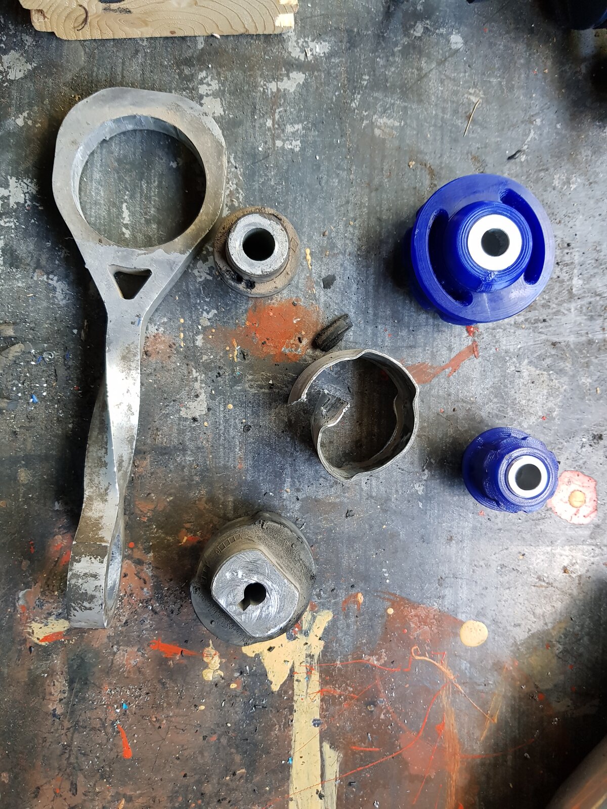

I've got the old bushes out with the usual amount of swearing and tool abuse. Does anyone know if these PhilipM versions ok to just push in? Can they be heated up with hot water to soften? Any lubricants to aviod?
The powerflex ones just push in with a bit of fairy liquid on. These should be similar.
Yes, they're printed Bankrupt - there's actually internal voids/geometery in there that would be pretty much impossible to replicate otherwise.
For everyone else, heating them to help with fitting is fine - use a heatgun or hairdryer is better than water though as you can keep it warm as you push it in - no hotter than about 90-100c max though (they get annealed at 110c before shipping) however if your mount has been prepped and is smooth and clean they should go in without.
