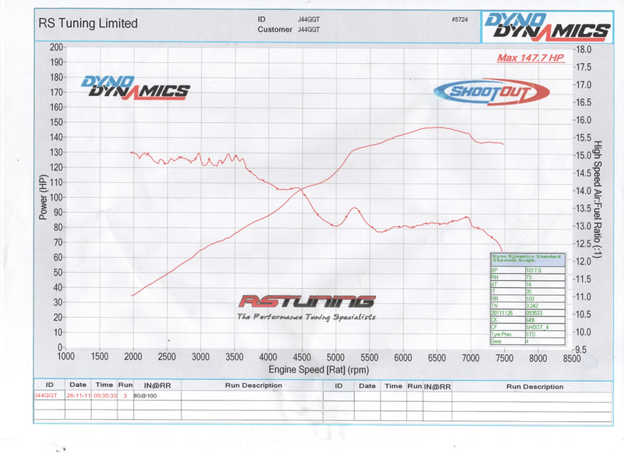

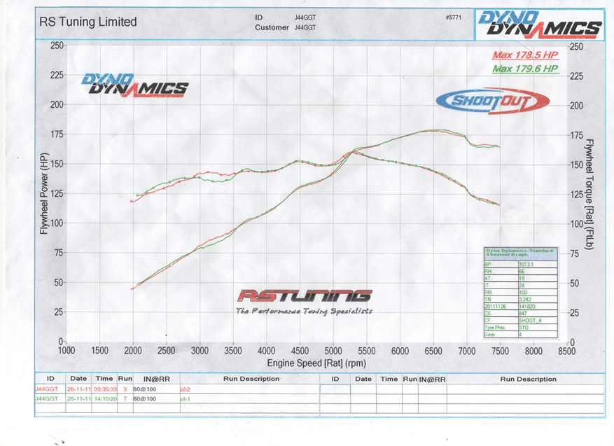

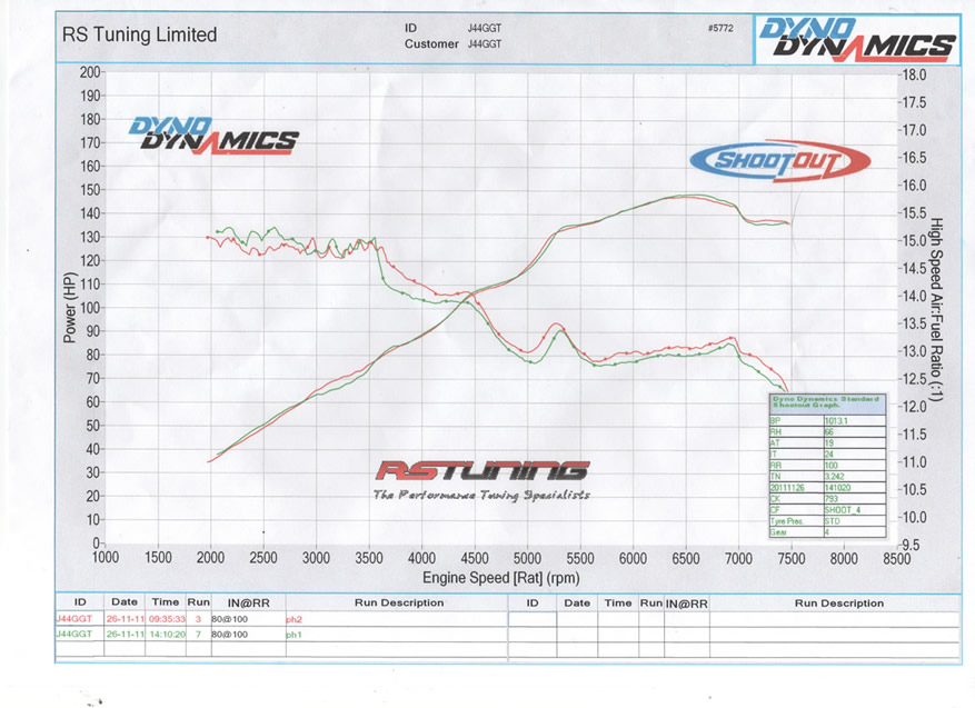

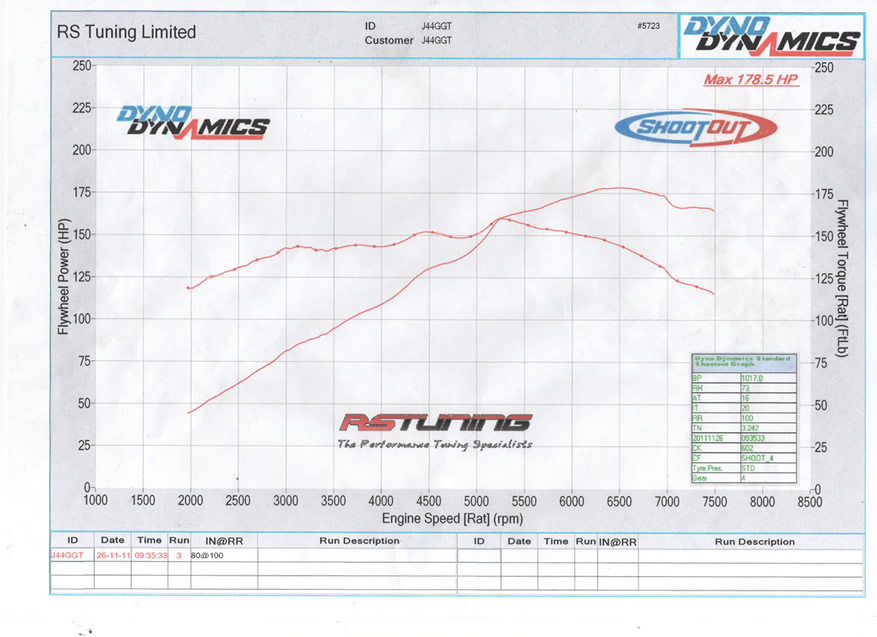

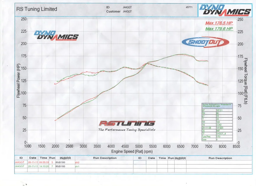

Here are the graphs:
Green is PH1 airbox
Red is PH2 airbox

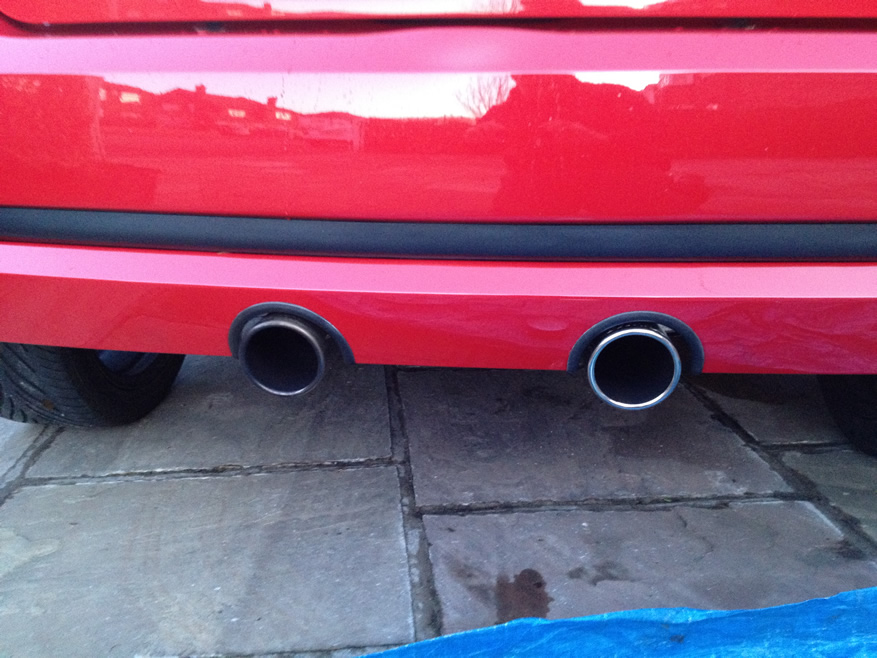

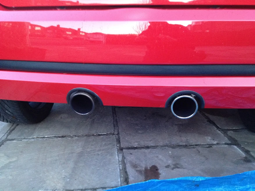

After seeing Ed's exhaust after he bought some Megs all metal polish, I popper round to borrow it off him to try and get some of the crap off my next to new system.
I was pretty pessimistic at first because I'd tried before and not been able to shift it. This stuff however was great. No fantastic pictures as I took them on my iPhone, so here's a comparison I'll get some proper ones when the weather is better.
As you can see it was a right mess before, looks next to new now.

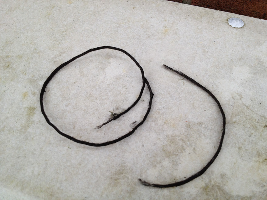

My aux belt was never sat on the pulley 100%, was just off the edge of the pully by one rib. Didn't think much of it as I knew I'd be replacing it ASAP. However I went for a drive on day and long story short, it got caught in the sound deadening next to the pulleys causing it to fray. As it wasn't snapped and I was only 2 miles from home I risked it by nursing the car all the way. Got home fine, parked up on the drive and went to check it while it was running. Bad idea, as soon as I opening the bonnet the engine started sounding rough so went to turn it off. Before I could get there the engine cut out, tried to start it once and did nothing.
Had Jonff round to have a look, we cut the aux belt off, checked the cambelt (which was fine) and tried to turn it over by hand which we couldn't do. Quickly arrange to get it transported to Birchdown as this was the only place I wanted it to be looked at. Due to them being very busy it took a while to figure out what the extent of the damage was. By the looks of it, the aux belt had slapped the cambelt and knocked the timing out, causing 16 bent valves. Happy days.

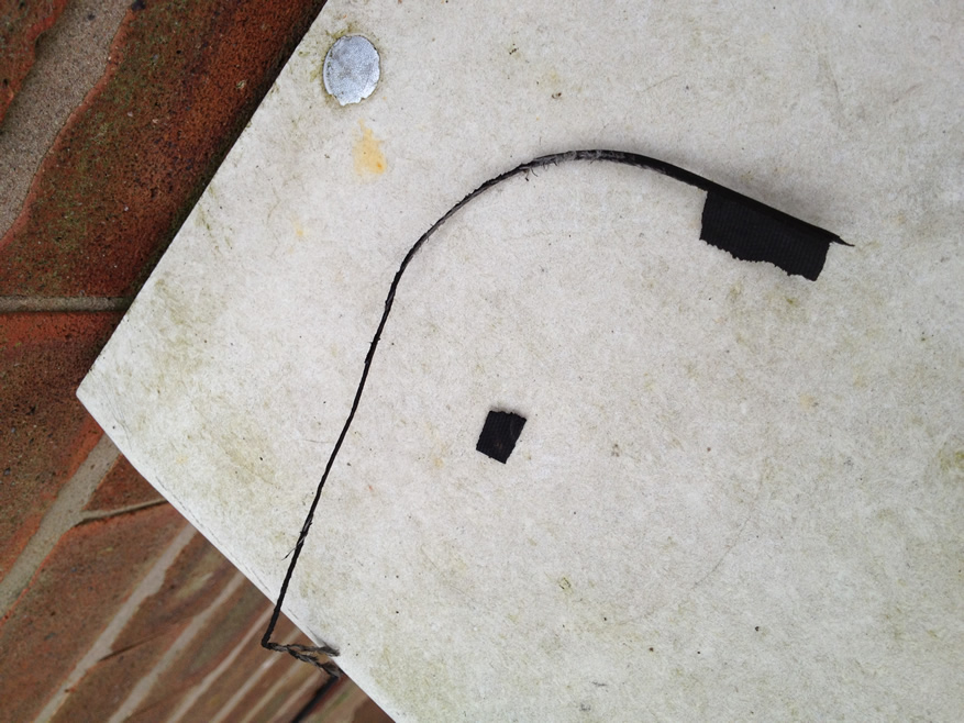

Couple of pictures of bits I picked up from the aux belt:

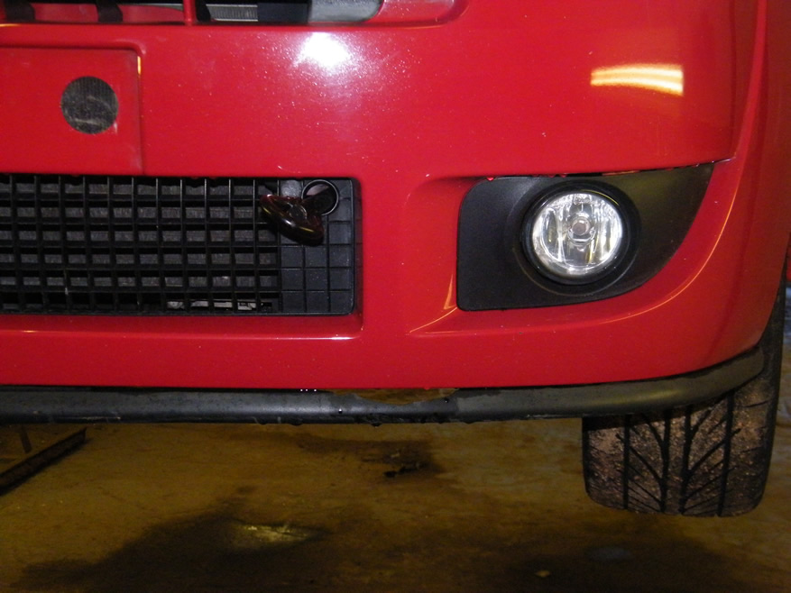

Unfortunately, the 'mint' original splitter that was on it got snagged on the transporter, causing it to crack. So I've ordered a Skoda replacement as they are much more flexible.
Picture of the crack:

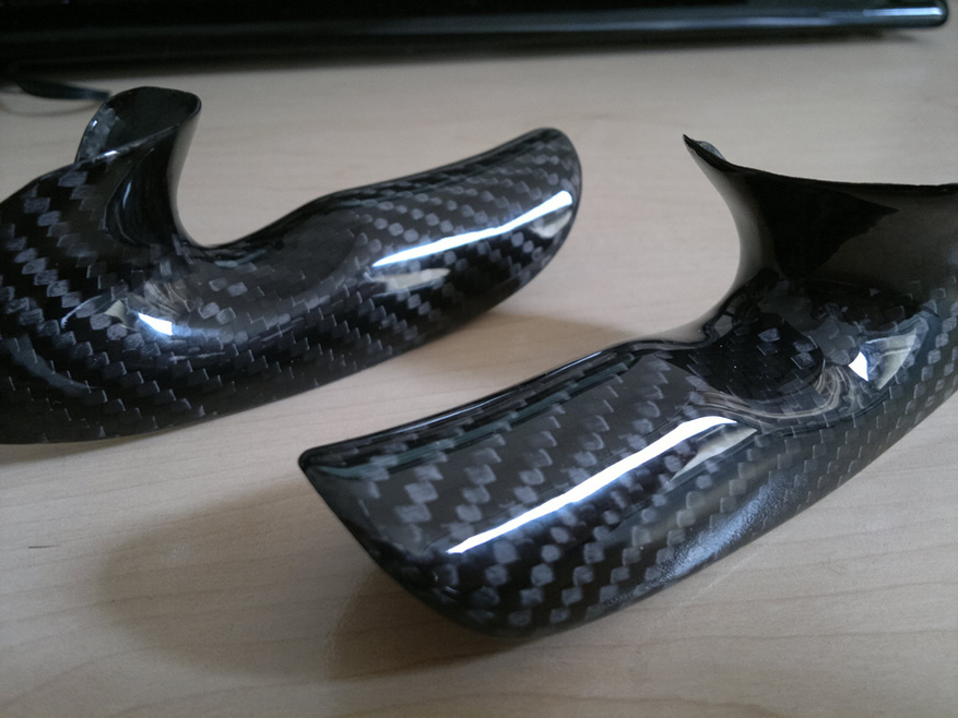

While it was away, I managed to grab these too:
Which are bloody awesome! They look and feel amazing. They fit over the current thumb grips without bonding which is great too!
