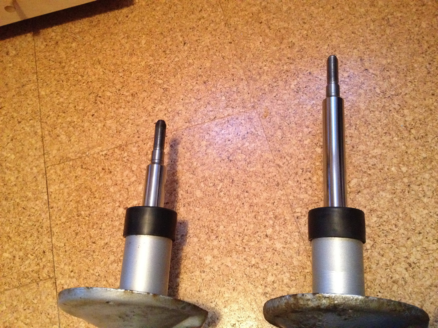

On another note, It looks like the Passenger side damper as packed up AGAIN. So I'm currently in talks with Ben at BG Motorsport as to what we are going to do with the damper as it has failed only 6months/5k miles after it was refurbished.
Its knocking over bumps and its VERY soft when you press down on it.

I've spoken to Ben today and there records showed they had replaced the passenger side piston when the first went in to be refurbished. However as you can see earlier in this thread, they actually replaced the drivers side piston. I sent a load of photos to Ben showing their condition before and after with pictures of the seals, markings and the new piston (in the driver side damper).
Ben and I have come a brief conclusion that the piston was possibly replaced on the wrong damper, as he confirms that the passenger damper was not functioning when it went into them. With this in mind, he has asked me to send both dampers back to him so that they can inspect, report and repair the passenger shock and also dyno test the drivers side to ensure a good balance. Ben said as long as everything they find on the shocks backs up the theory all this work will be carried out free of charge.

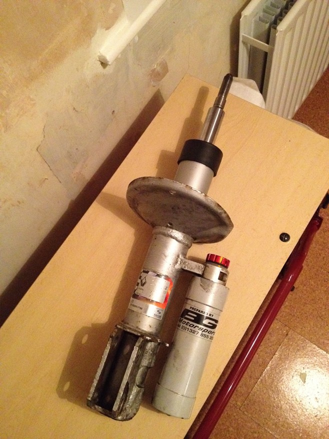

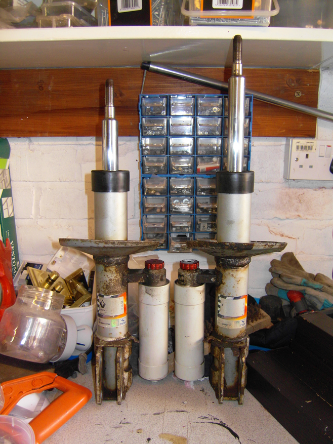

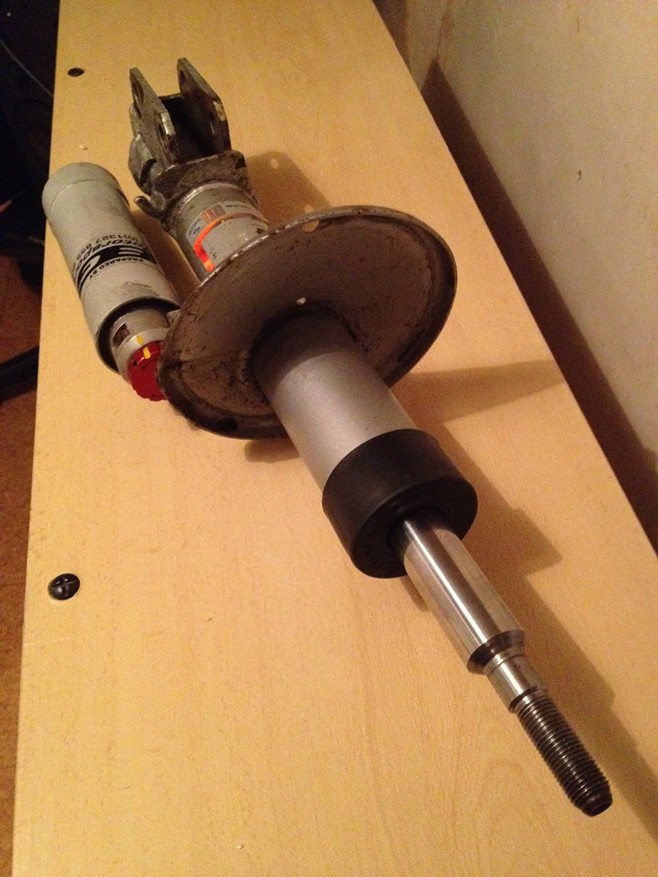

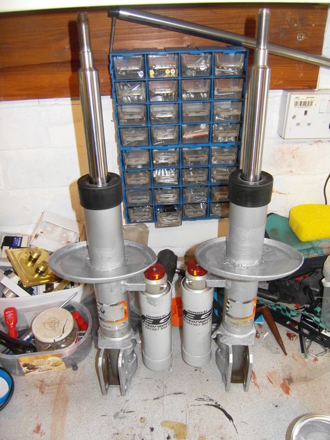

Onto the problem in hand, the said passenger damper. Below is a series of photo's of before the refurbish (Last august) after the refurbish and the current state of the damper. It is pretty obvious that the service has done nothing what so ever, Hopefully Ben will fully agree with me and replace the piston FOC (which he said he was doing in the first place)
Before the service (note the passenger side piston dropping):
after the service (pistons back level, but the wrong piston was replaced):
and the current state of the passenger side damper:
Obviously this is the cause of the knocking and the very soft suspension on that corner. Can't actually wait to get them sorted and be able to enjoy this car for summer!

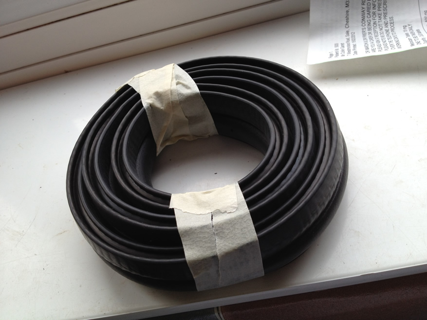

Ordered a few bonnet seal from a lad on ClioTrophy as mine had split in two. Must say the new one is much much better quality so got that fitted in all of 10seconds.

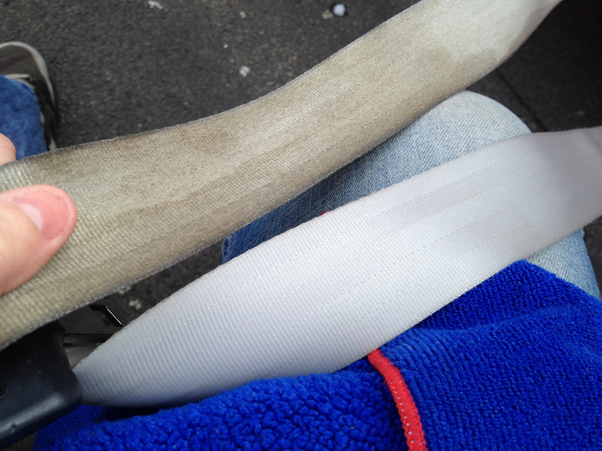

Decided on Yesterday that I would clean my seatbelts as I've been meaning to do them forever. Using a combination of AutoGlym Interior Shampoo and Zaino Z7 Car shampoo with a brush, results really are excellent and even surprised myself, Couple of before /after 50/50 shots:

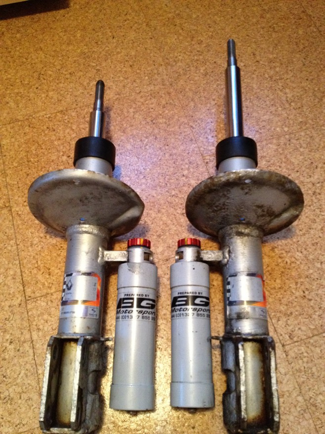

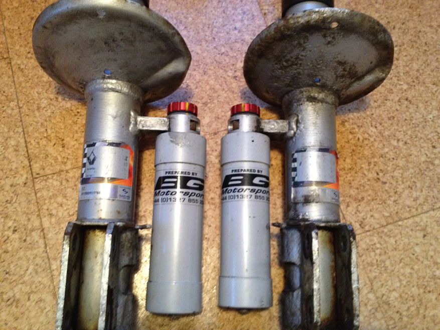

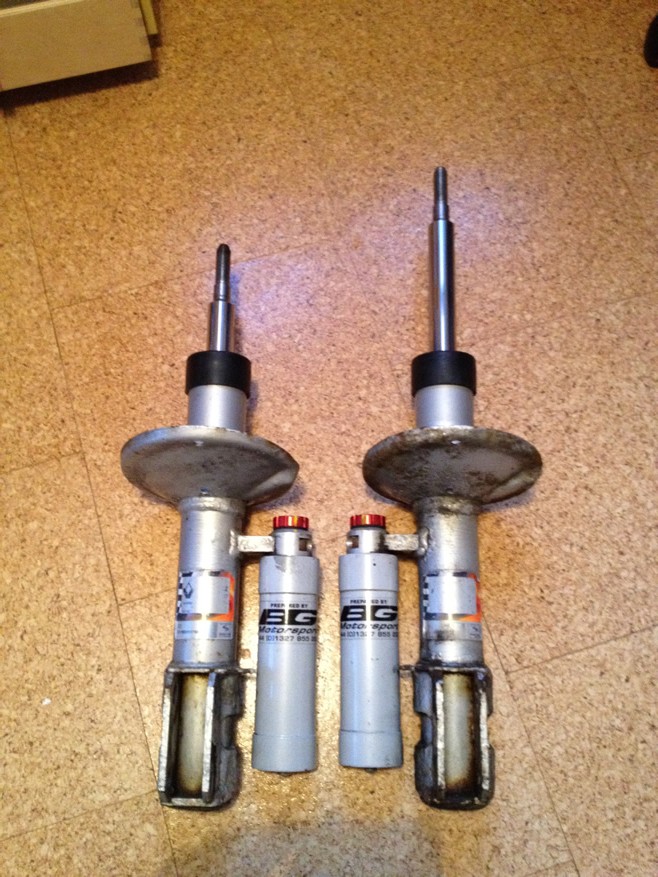

Lastly, took my remaining SACHS damper off today ready to go tomorrow. As can be seen this one is still mint. Few pictures of them together and boxed up:
You can really see why the passenger side is broke, its EXACTLY the same as it was before...
Boxed up:
Ready to go tomorrow...
