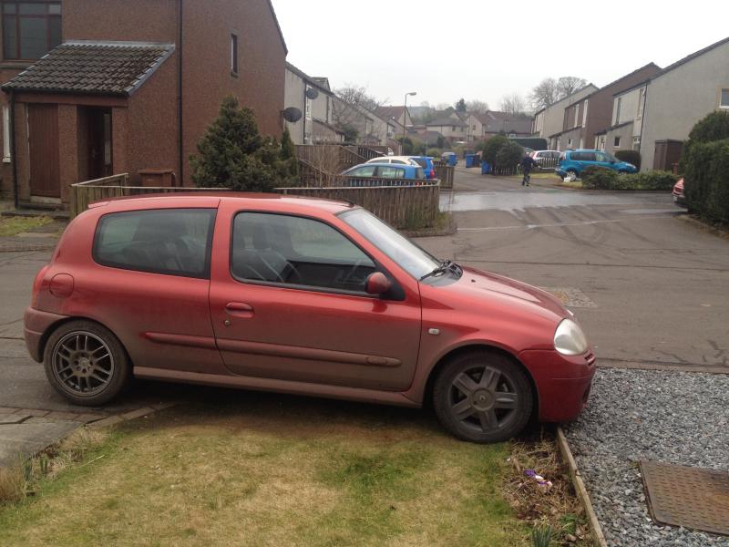

The front end is pretty poor now tbh. This year was meant to be the year it got painted but more important things to spend money on come June.

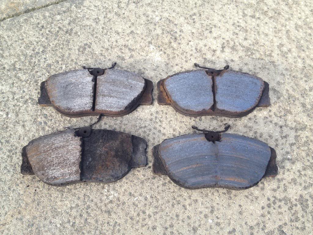

The brakes started to feel quite s**t all of a sudden this week. Ok on gentle braking but on anything mildly harder it just made no difference.
They've done 3 track days but none since July last year, only road miles since so its a bit odd. Glad I checked them though
DS2500 btw. And with plenty of space to move about the calipers so I'm surprised if they overheated. But who knows.
Anyway, £14 Apec ones from the local factors now in and will do for now.

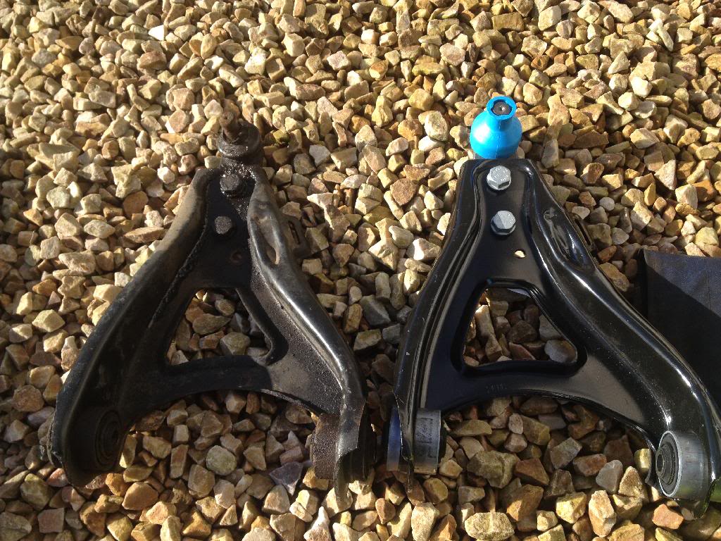

The end of a busy week for me and the Clio. As well as fixing my mums and my brothers clio I did the work to this too. Not gonna lie, the bushes were a pain in the tits! Will be quicker next time though.
Didn't take a huge amount of pics as I rather just get on with it but got a few.
Started with the wishbones, the old ones are 60k ish old and tbh, not too bad but saw no point in not changing them

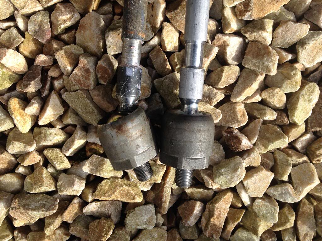

Then I went onto the track rods and rod ends, thanks to @mad in general for the loan of the tool, it made it a cinch!

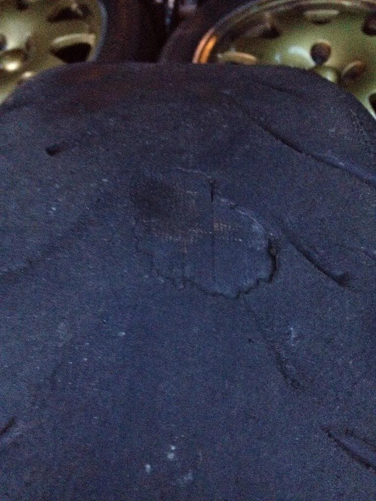

These were pretty worn, which I always like, hate taking off parts to find they are fine!

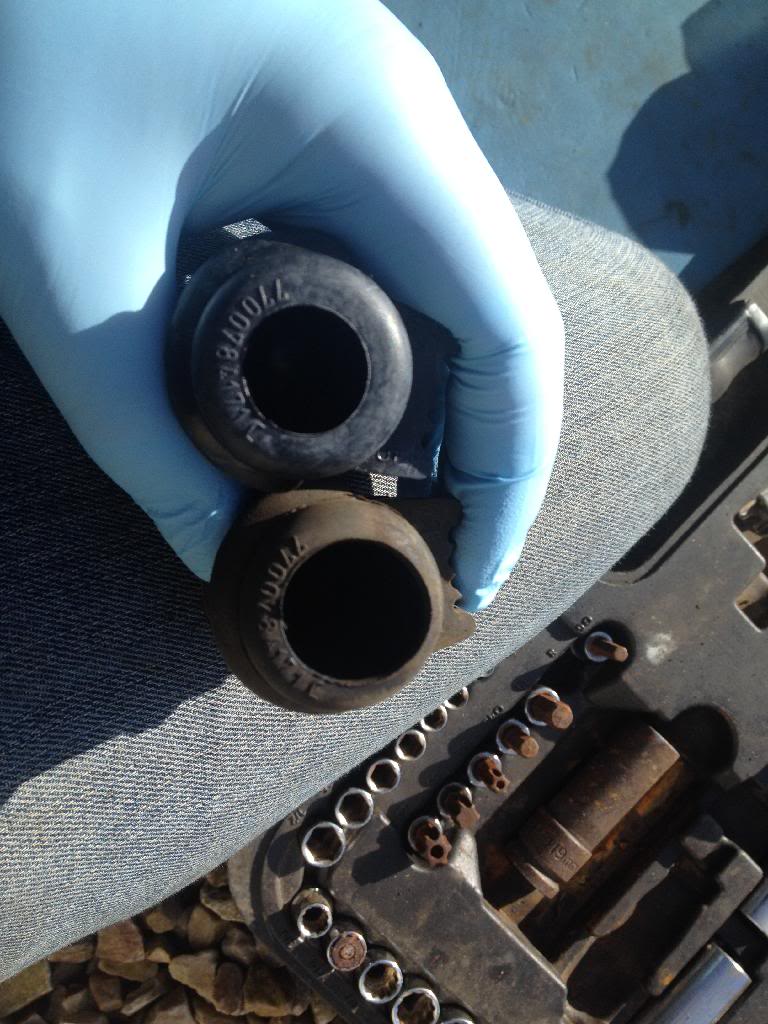

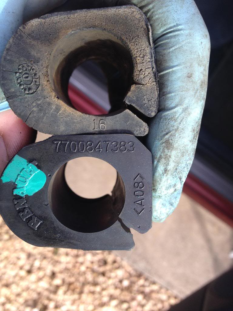

So then it was onto the ARB bushes, the outers were defo spent!
And so were the inners
Managed this whilst refitting the inners

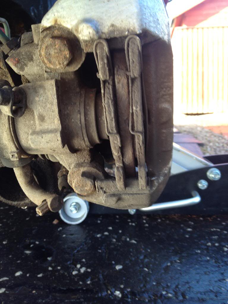

Still, it drives straight and tight so onto the spanner check for the 4 hour OPL at Knockhill. This is when I noticed the rear pads were finished
So off I go to buy some £9 cheapies from the local factors. Come back home to fit them and notice the wheel well is soaking wet, figure its been a wet day but thats very wet. Fit the pads and then connect the eezibleed as I may as well flush them whilst I'm here. Thats when I see brake fluid pishing out of the pipe just where the handbrake cable runs over it. f**k! No decent pipes anywhere to do a straight swap but @Fraser.J. very kindly came over from Fife with a brake flaring kit and joined a ph2 pipe I had lying about to the good bit still attached to my car. Got it all sorted and the track day was back on, I'd call him a true gent but we all know thats a lie x
Get the other brakes bled and call it a night about 8, or 1 hour after the family dinner was meant to start!

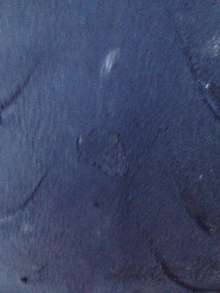

And it would seem we stopped just at the right time! The front left did not have long left at all!

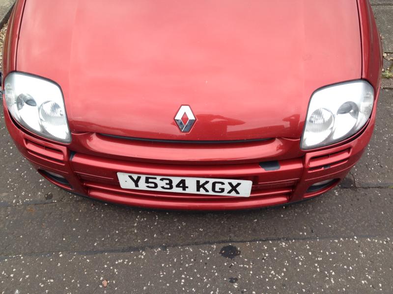

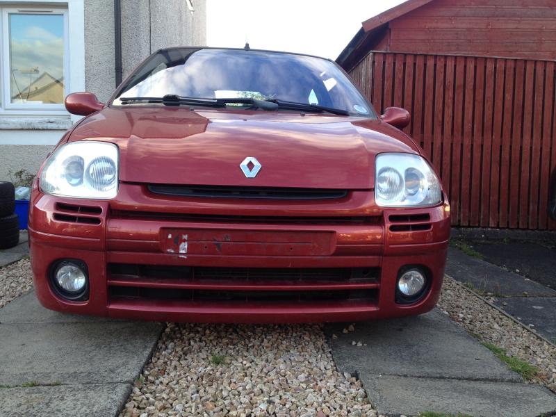

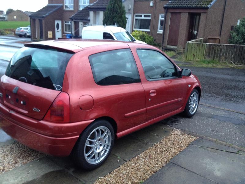

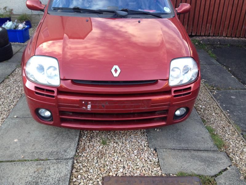

Finally got round to fitting the bumper the other week, it's not perfect but its a lot better than the old one.
Started as this
And now looks like this
Obviously it now has a number plate but I want to fit a less scuffed splitter so will do that soon.

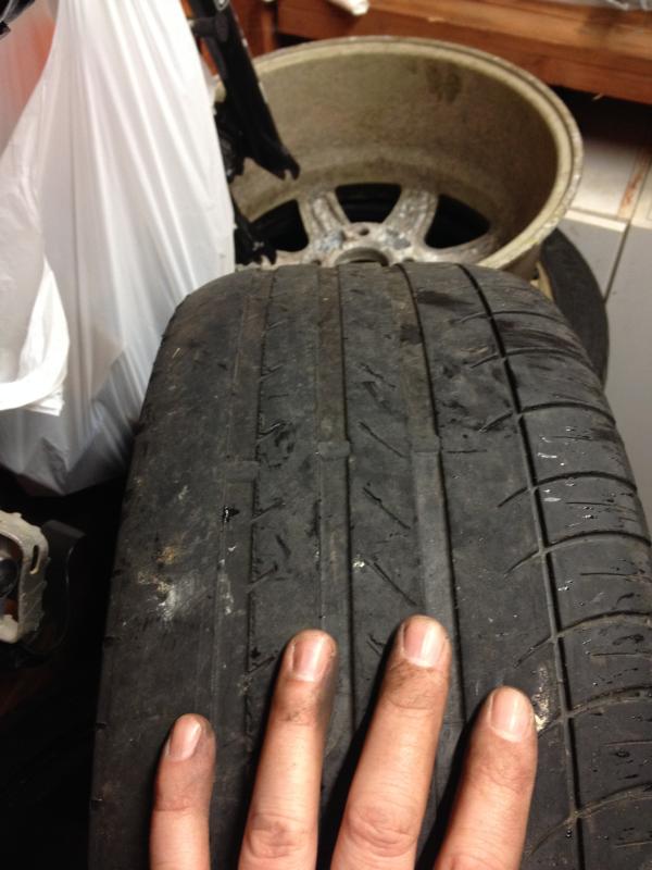

It also needs a mot which means it needs tyres that still have a pattern on them fitted so for the first time since march it looks like this
And I clearly need to sort the camber out ASAP!

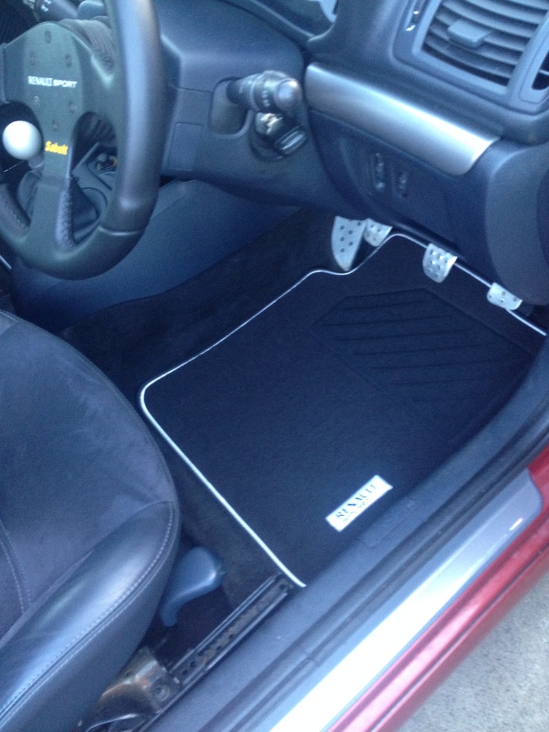

Got some in the footwell! Aye it's a tiny bit darker but it's way better than it was!
Now MOT'd too :) took the long way to work this morning kicking it's head in and laughing for most of it! I should really grow up but I don't see the incentive!

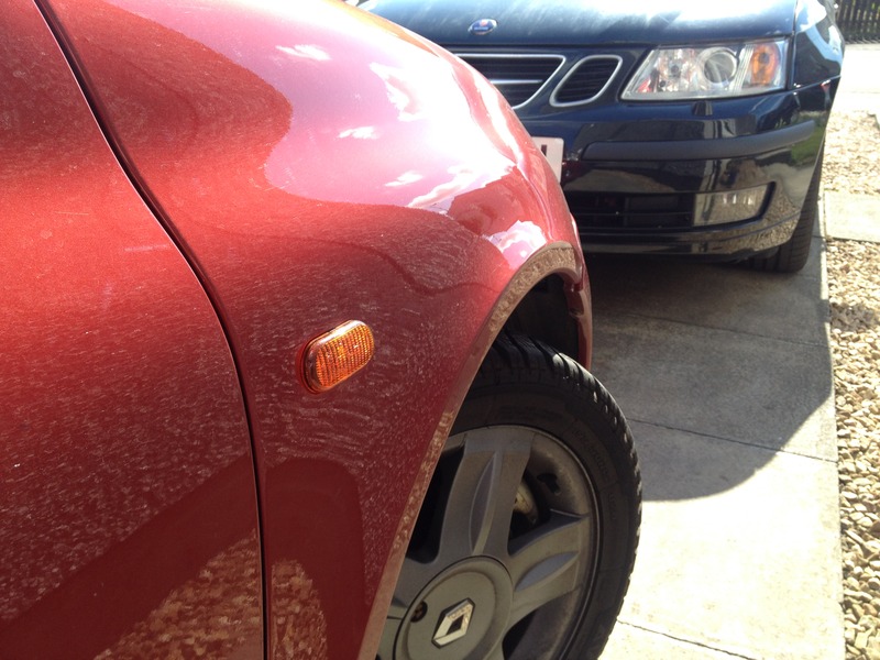

Had enough of the cheap shite aftermarket clear repeaters (free to anyone who collects them)
and went back to the standards
Think they work better on flame anyway. Funny how tastes change over the years.

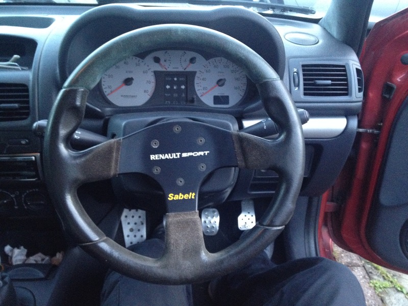

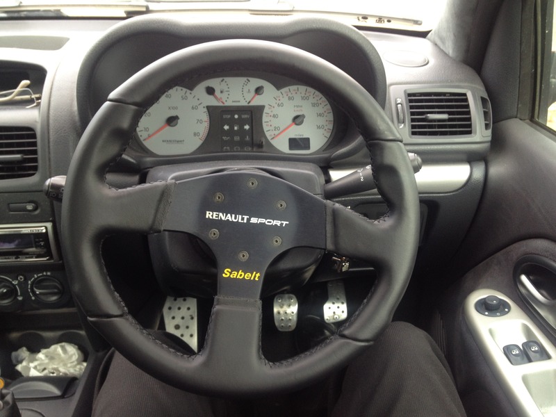

Also been planning on getting this retrimmed
But then a ready retrimmed one came up for sale so that got bought and the old one sold, made for a cheap retrim for me even if its not exactly what I was going to have.

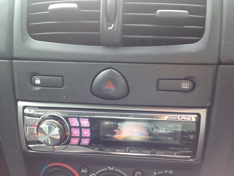

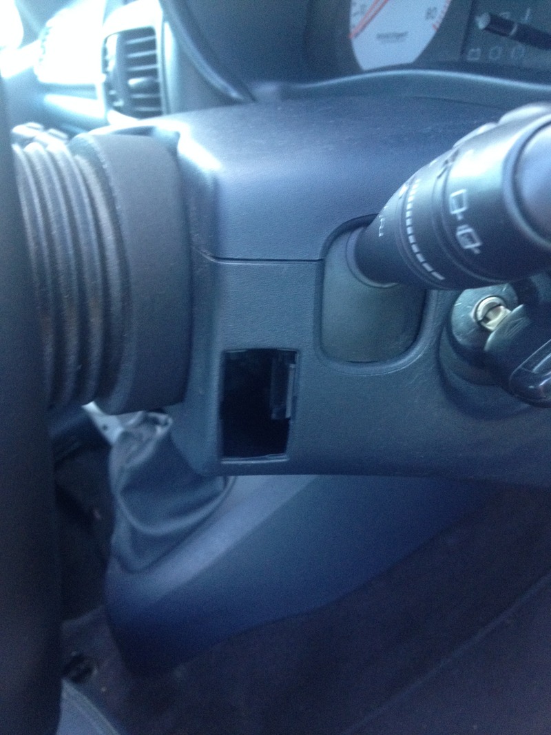

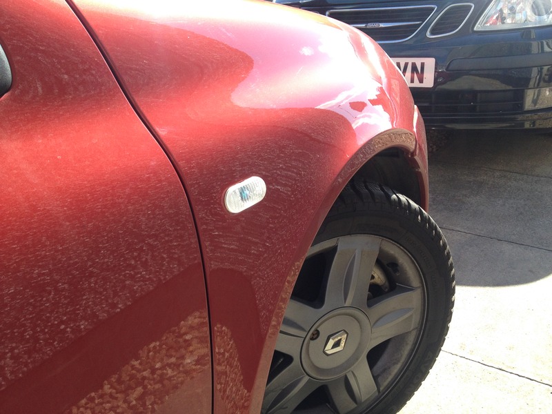

And after a mere 2 years and a month since I broke my hazard switch I fixed it and refitted it!
This has annoyed me since doing the conversion but never knew there was anything I could do about it until recently.
So for £3 I know have this

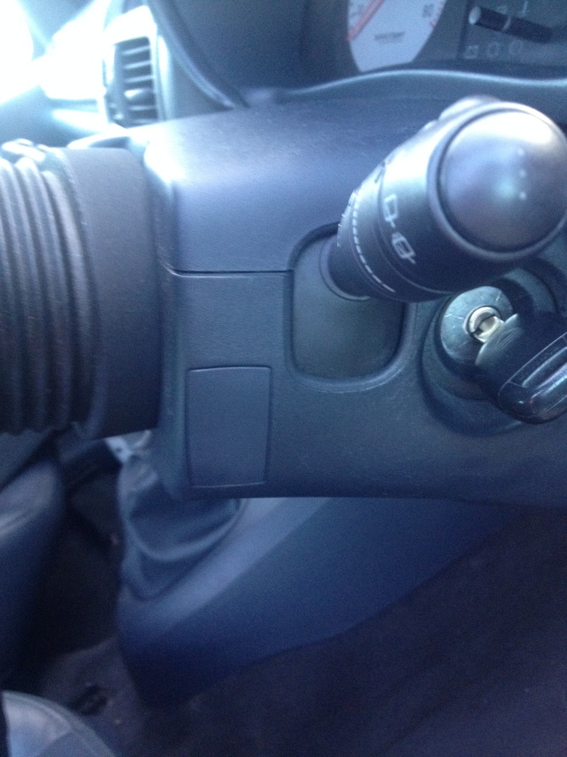

How did you manage to get your Ph2 steering surround to fit so perfect? Mine just wont line up no matter how much i push it into place
Just ordered a blank too :)
Djw John
Scotland - South
I'm not 100% happy with it tbh, it's not quite right but it's more on the other side that you can tell!
There are a couple of small bits of wood hidden behind there that it's screwed into!
Djw John
Scotland - South
Maybe you can only get one side right!
My left side sits slightly too low. Not by much but enough to irritate me.
Dunno what advice I could give tbh, it's been about 2.5 years since I did it!
