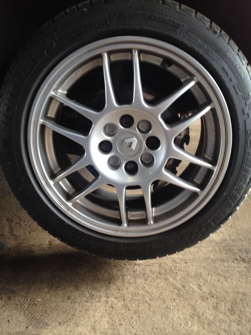

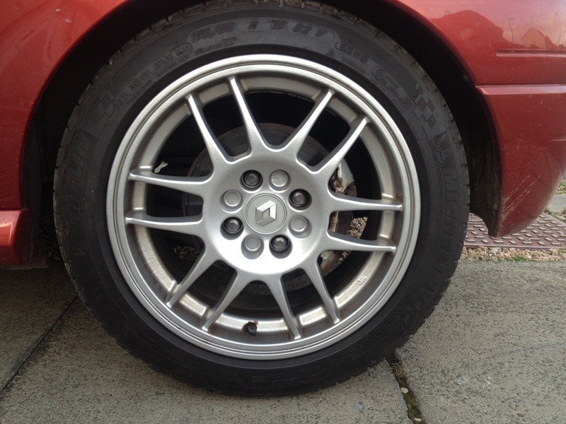

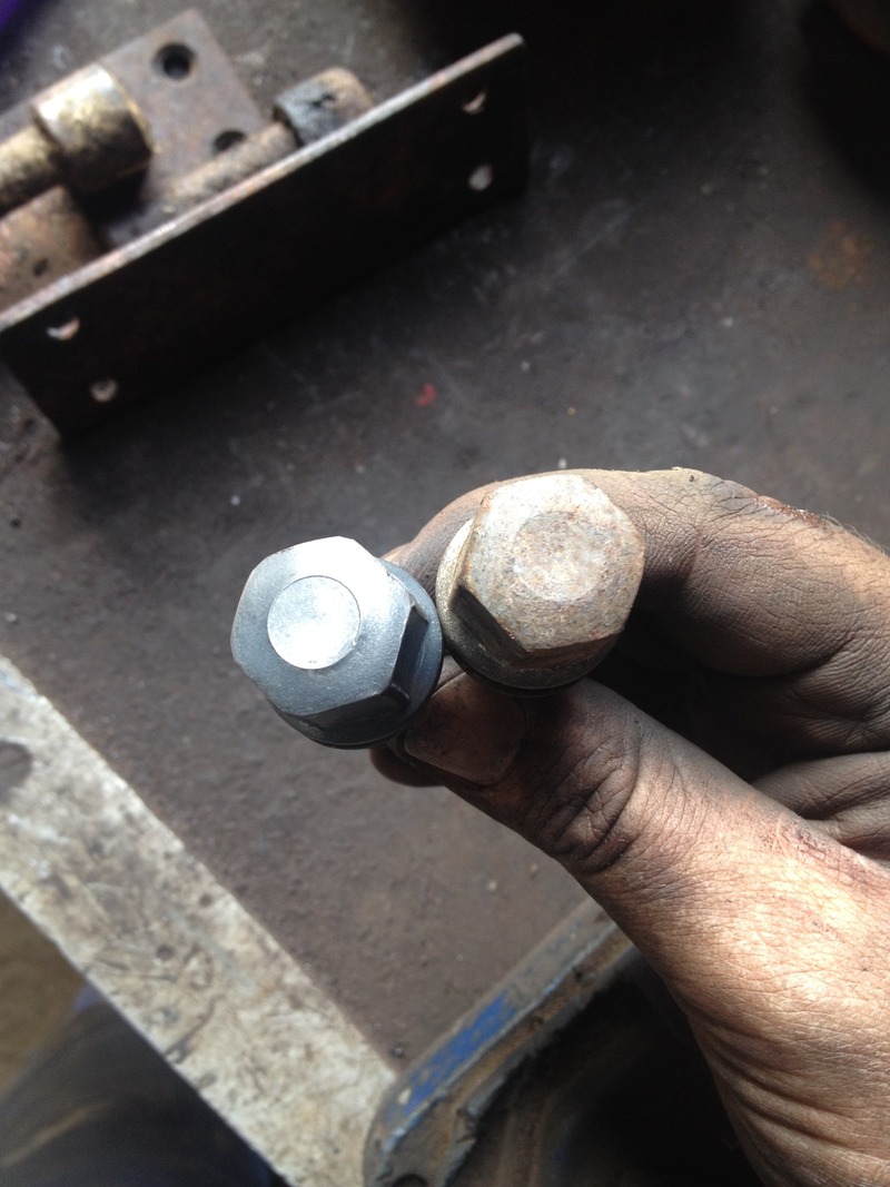

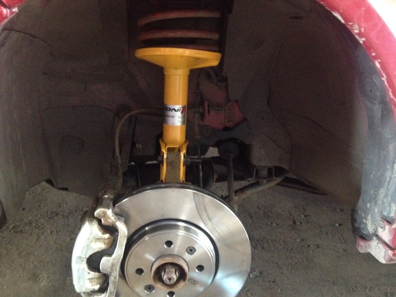

And then took a half day today and popped along to Djw Daves work to use the air tools and get the shocks changed on the front (rears were done last year iirc). Glad I did, 7/8 years since I put them on and the gun struggled a bit on the shock/hub bolts, would've been a pain in the arse at home. Also chucked new front discs and my DS3000 track pads whilst I was at it and my camber bolts. Took my chance to use the bench grinder that has a wire wheel on it too so I could de-rust the wheelbolts, made some difference.

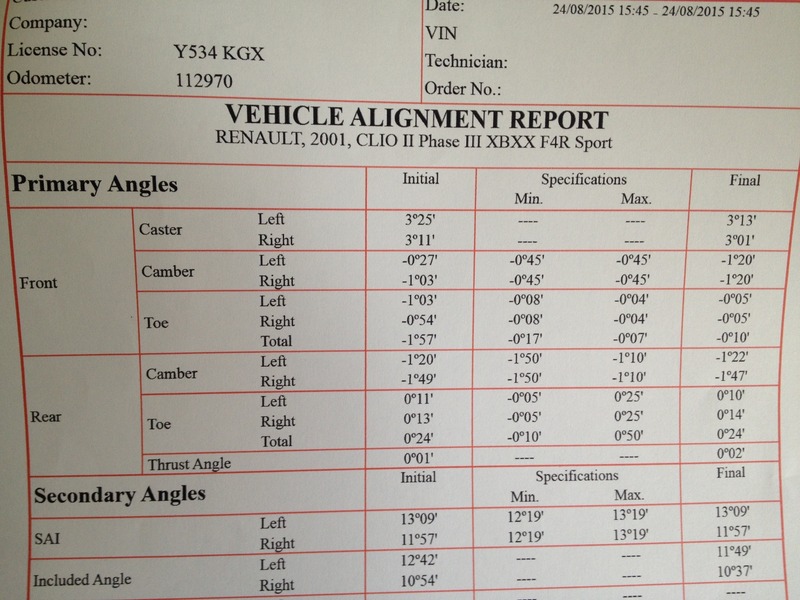

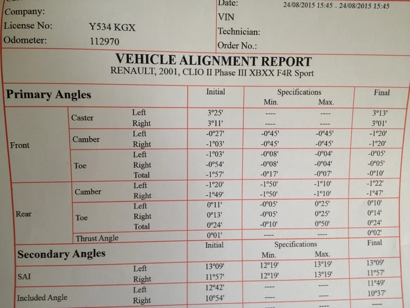

Got the alignment done today after all the recent work
Still to bleed the brakes, change the gearbox oil, PAS fluid and get my track tyres sorted out as well as a full spanner check. Fingers crossed!

Is the pic upside down for you? It is for me but right on photobucket!
Went to CLCM again, they're exactly a mile from my work so its easier than pro-grip. Shame Wullie has retired though. £55, £40 alignment, £15 for camber.

Oh also, you got cup wishbones on that? Just looking at the caster angles there compared to mine.

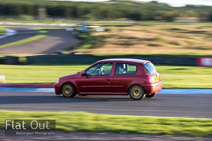

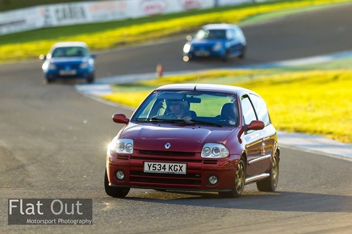

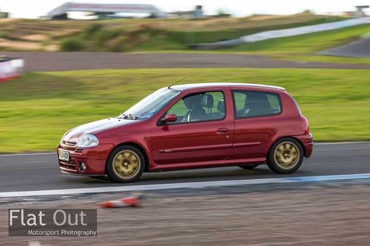

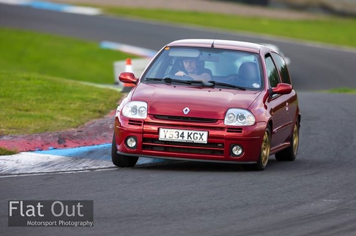

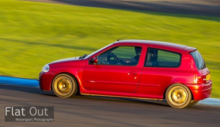

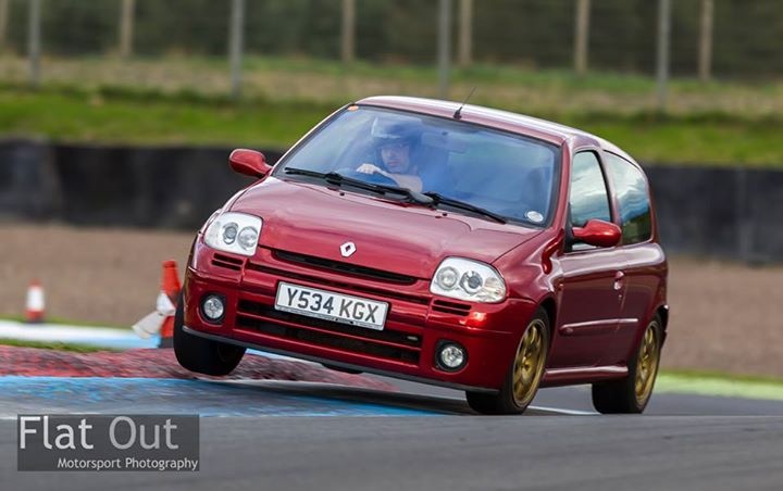

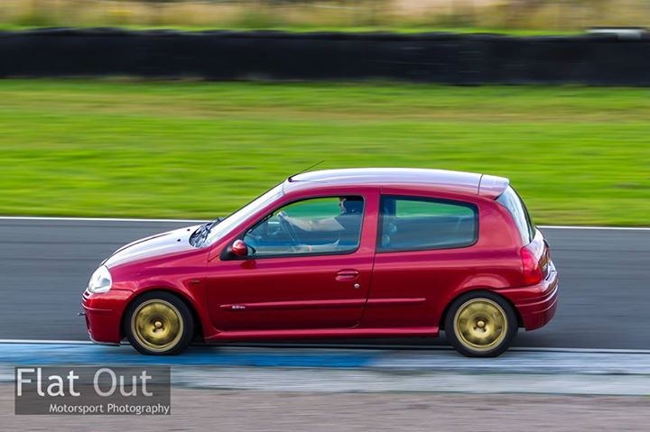

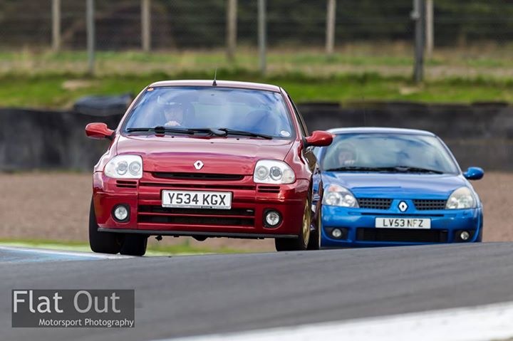

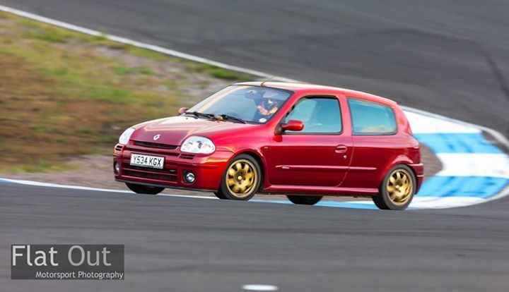

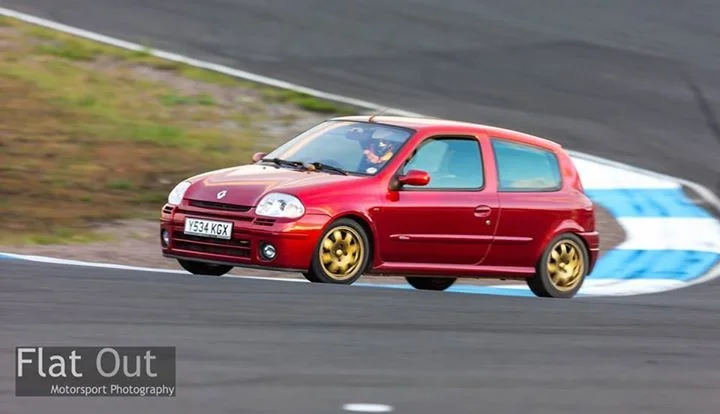

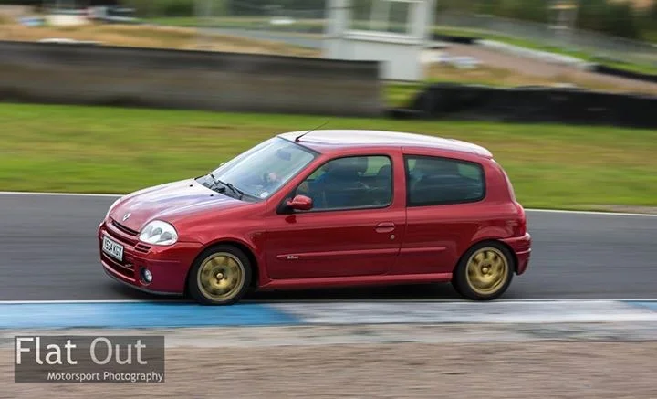

Superb night last night, made all the prep worth it. Tyres wore really well but the ds3000s have had it, 2 track days is utter pish for the money so I won't be buying them again. Car was going really well until something happened and now both wheels are toeing in a lot. So either something is loose, broken or bent from keen hoping. Ah well it'll get fixed.
John from flat out photography was there and took the below pics
Sacked work off early and came home
To investigate the issue. Turns out the paint on the shocks melted with the heat which meant that the bolts effectively became lose so my tracking and camber where constantly changing. I'd hung off them before going so it's just one of those things. I need to replace the dust covers and bump stops anyway so it would need alignment done again anyway before the years out. At least nothing is bent.
