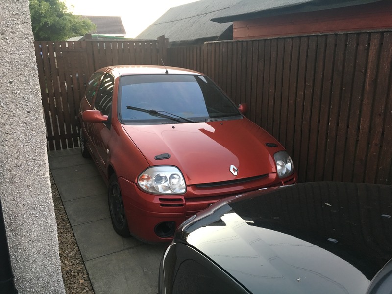

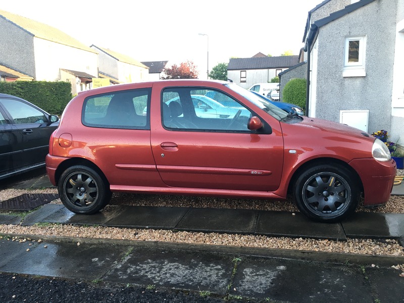

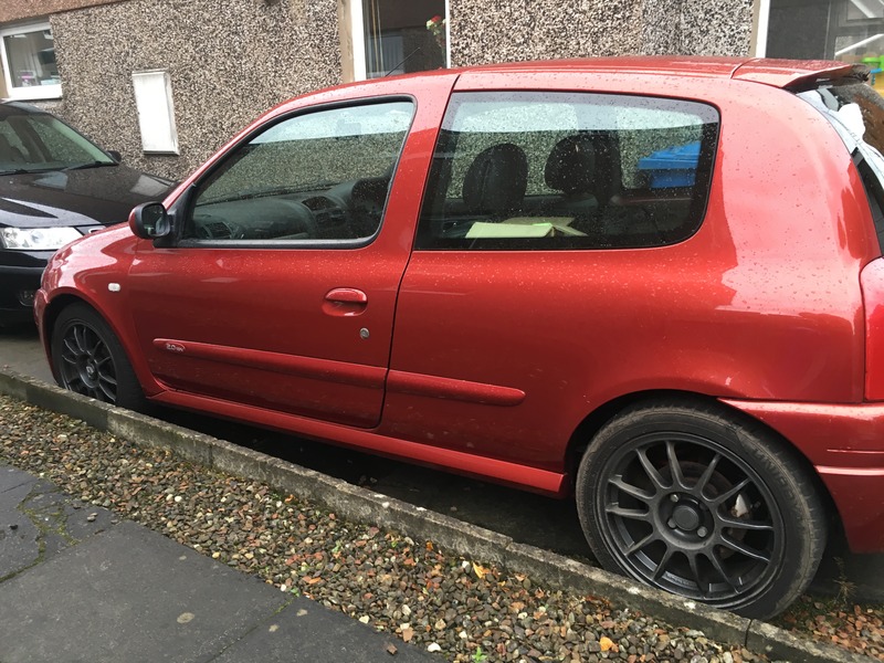

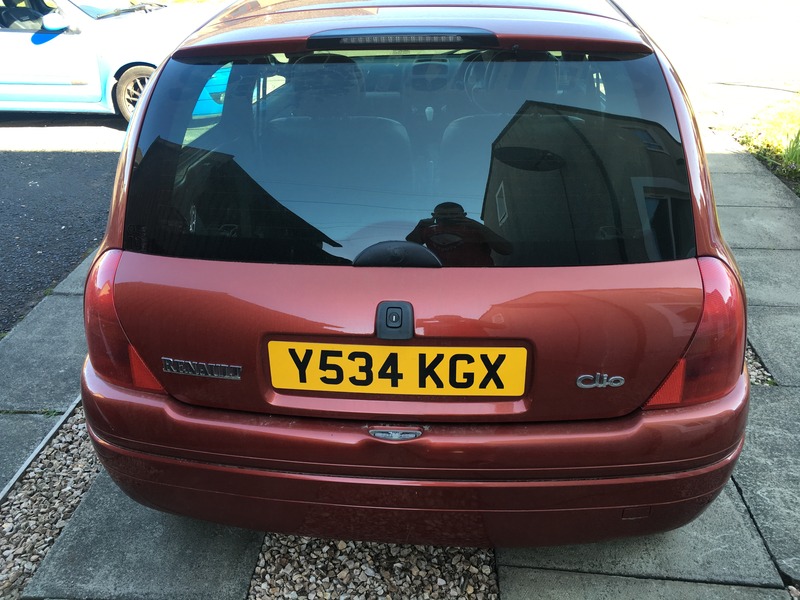

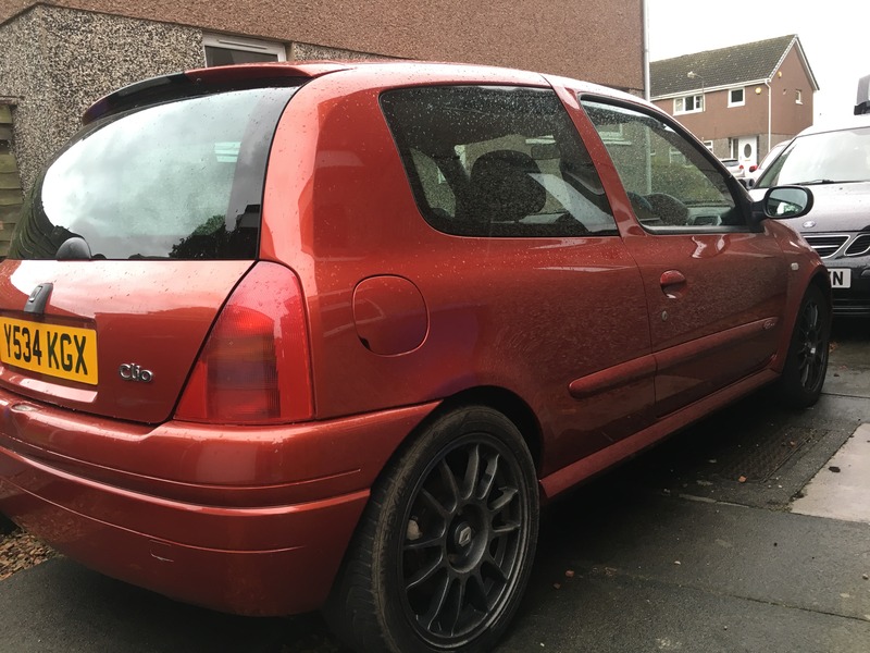

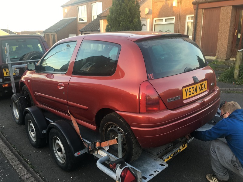

Right, well, as I seem to have some sort of disorder I now own this again. Surprisingly the wife has given me less s**t than @Djw Dave or pretty much everyone else I know! I've turned it down easily 4 or 5 times since selling it but then the price matched what its worth in the end so why not eh?
It would be fair to see its not had the easiest 4 months, or more accurately month since wee @Stu. sold it

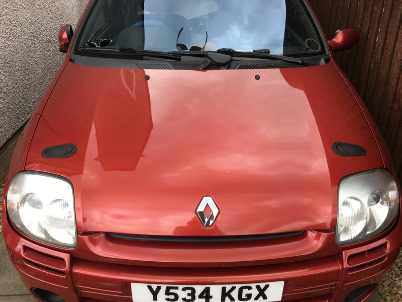

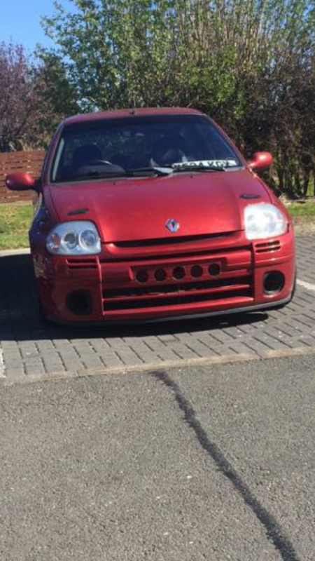

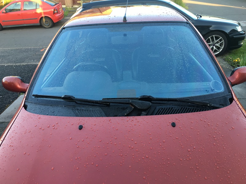

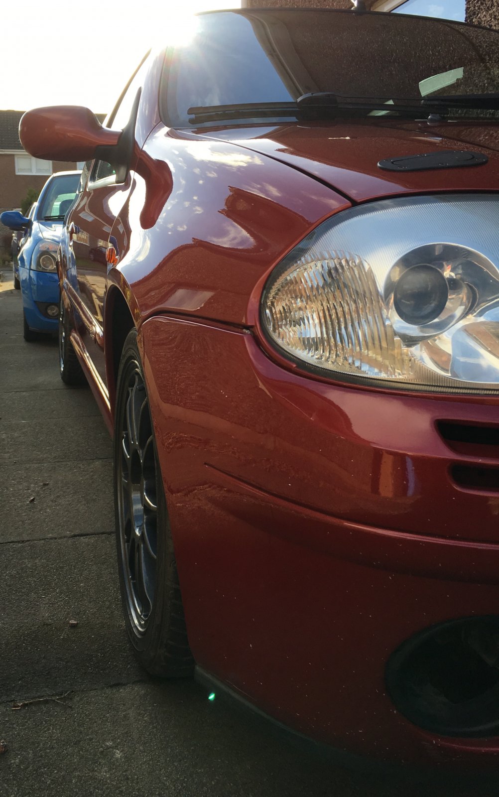

Got a closer look at it today in the sun and its filthy! But its more the standard of work thats been done to it that needs rectified

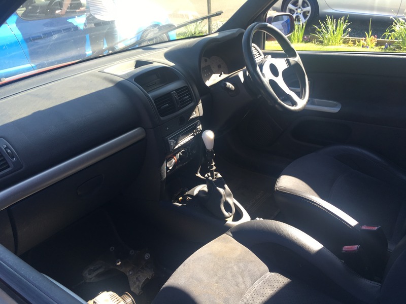

The IK is horrific!

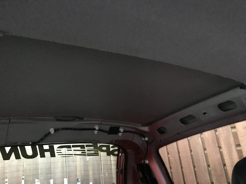

And obviously the headlining that someone has also scratched a c**k and balls into!
One bonus though is the scenic shifter thats been fitted

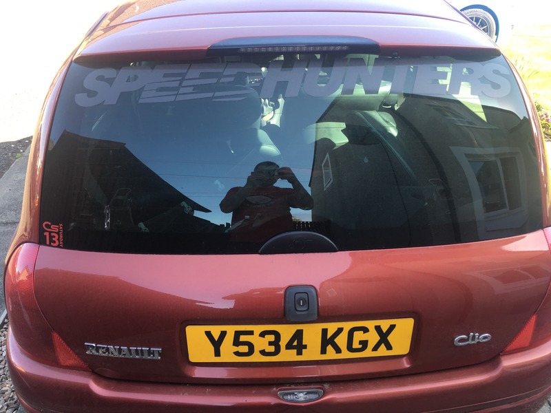

Removed the Speedhunters sticker, the sunstrip and my old CS Saturday 13 sticker as well

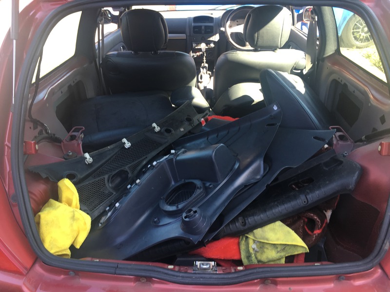

And also removed and binned all the s**t that was in the back
Fitted my 3 anthracite willy wheels and my 1 winter dynamique

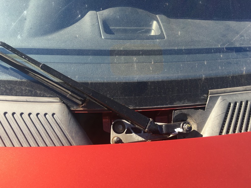

Put a spare scuttle panel and wiper arms on, kept the better condition ones off so I can satin black them

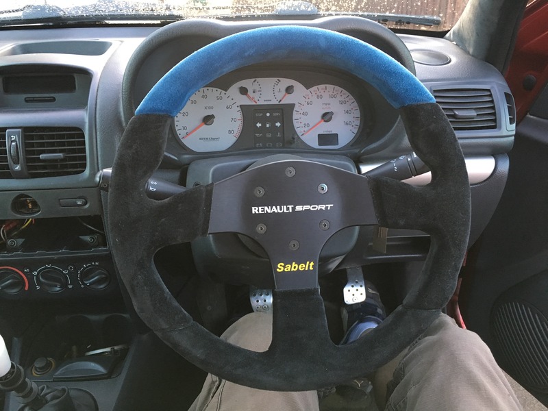

And fitted my sabelt

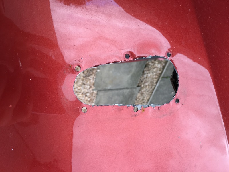

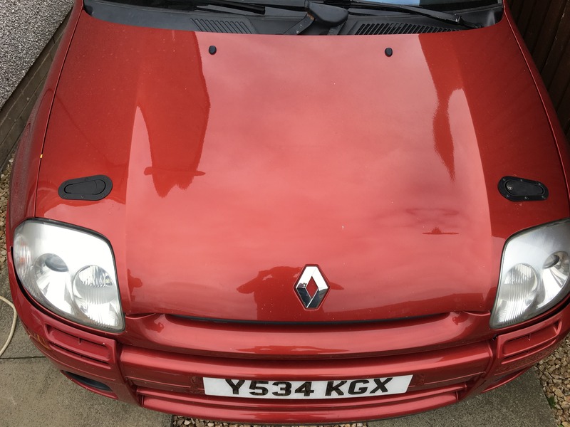

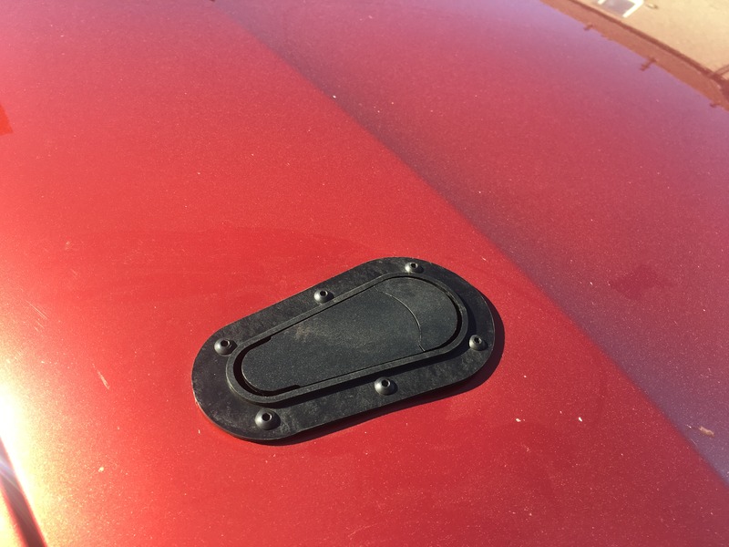

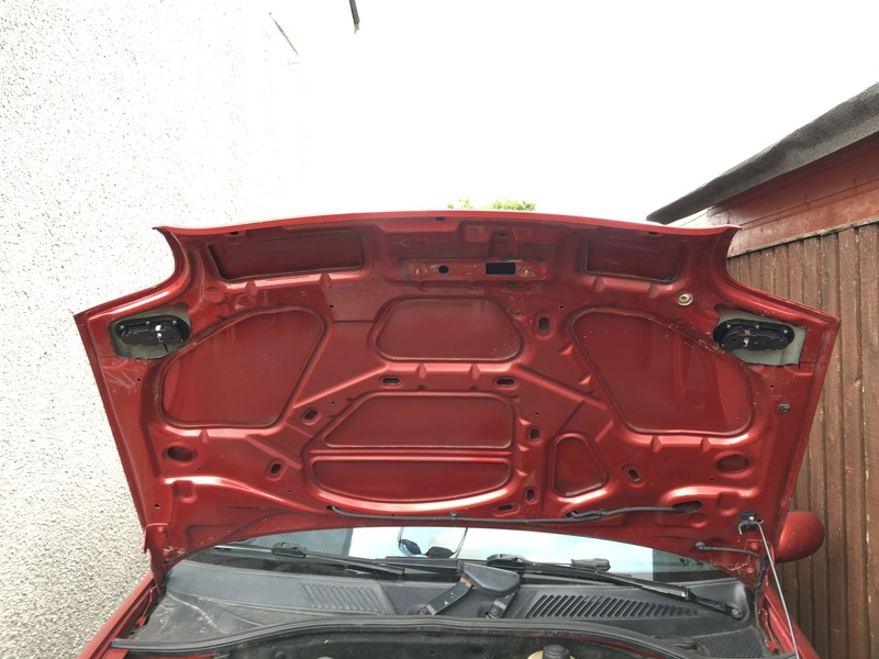

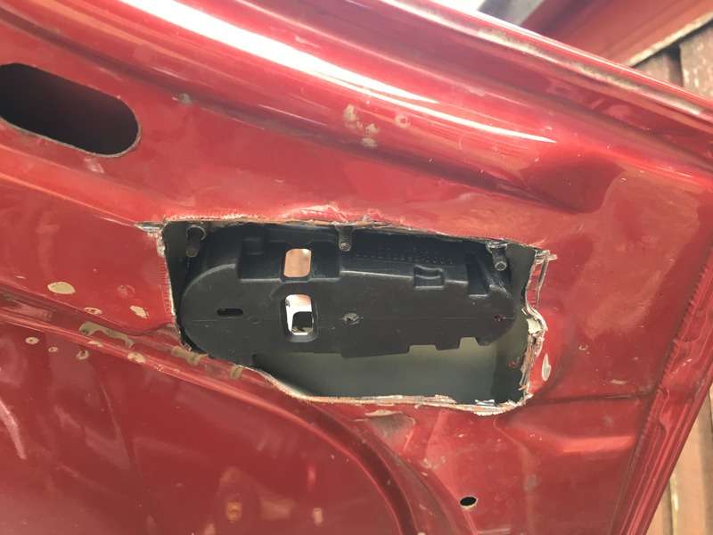

The main aim was to fit the new aerocatches and try to clean up the previous job as best as possible. This is what I started with
Halfway through
Finished, it won't ever be perfect without a new bonnet so this is about as good as I can get it

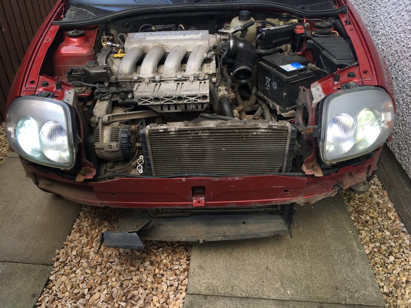

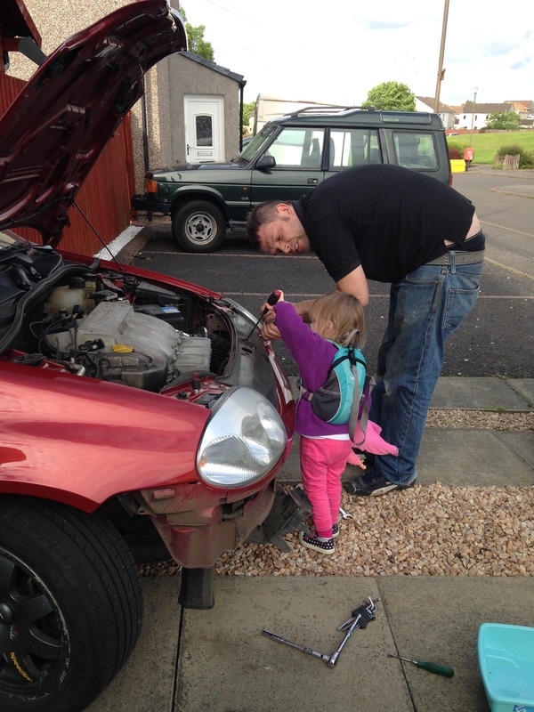

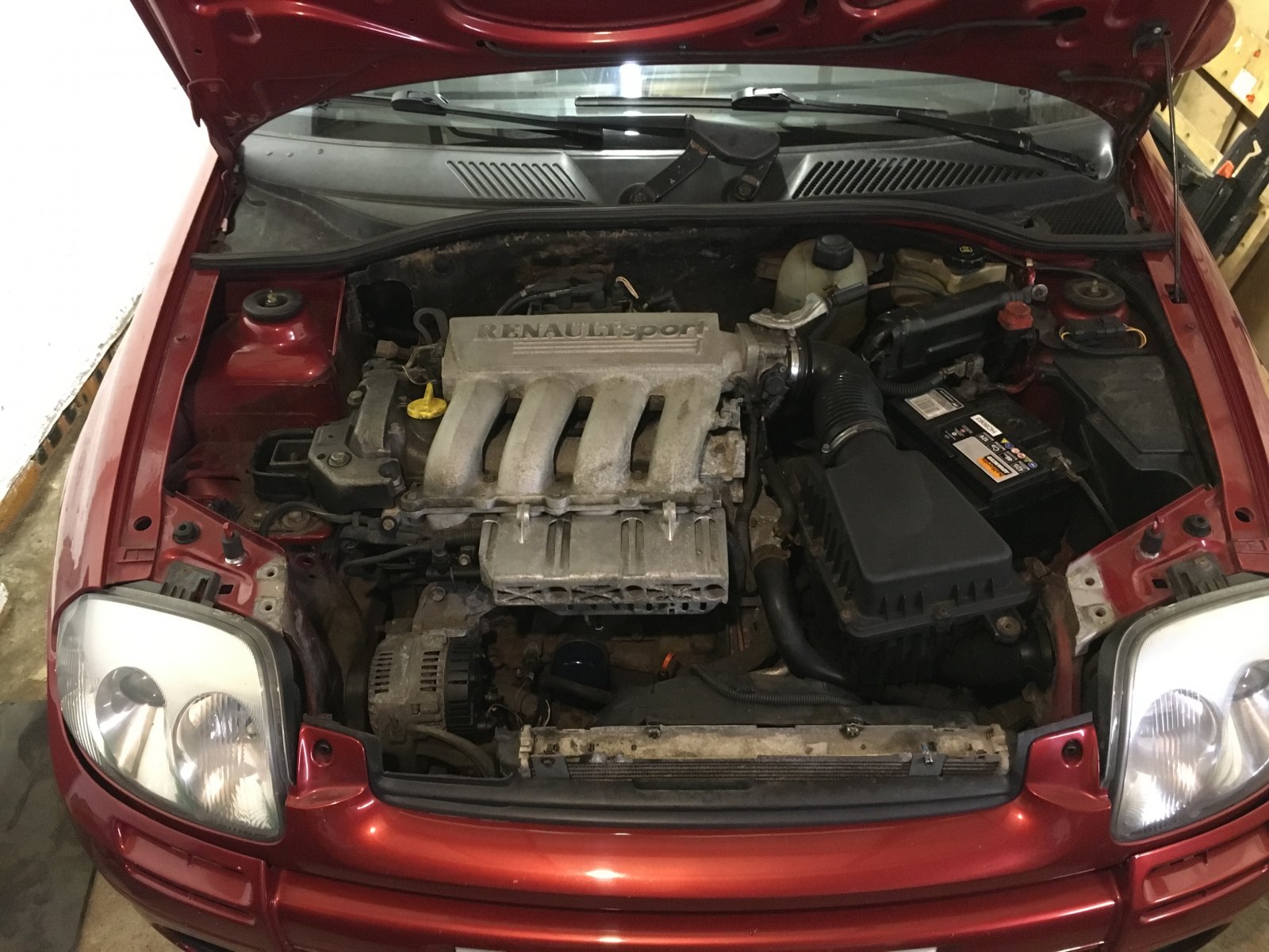

And then removed the slam panel and all the aircon gubbins ready for fitting the cup alt setup. Also fitted the hid kit I bought from @Dr Jekyll ages ago!

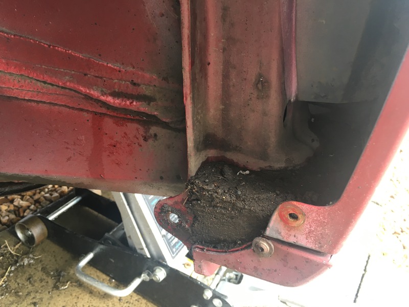

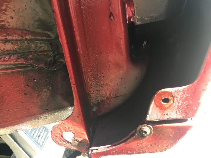

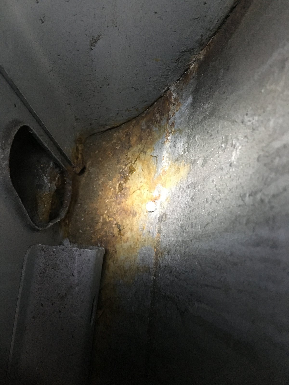

Jacked it up on the pass side to get a decent look underneath and find any other concerns with it so gave it a clean inc the arches. Not one of those nonsense cleans where you make them spotless and get scared to drive it, more a 'get rid of all the mud and see if there's holes anywhere' sort of clean.
So after doing the arches and underside I popped the inner arch guard off and found the usual
But after a quick clean out it looks fairly solid at this end. So hopefully it's just the jacking point at the front and inner sill at the back on this side.
But we'll see. No massive holes is a definite bonus at least. Hopefully do the driver side in the next couple of days.

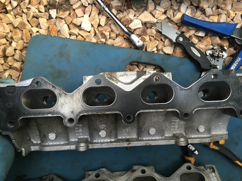

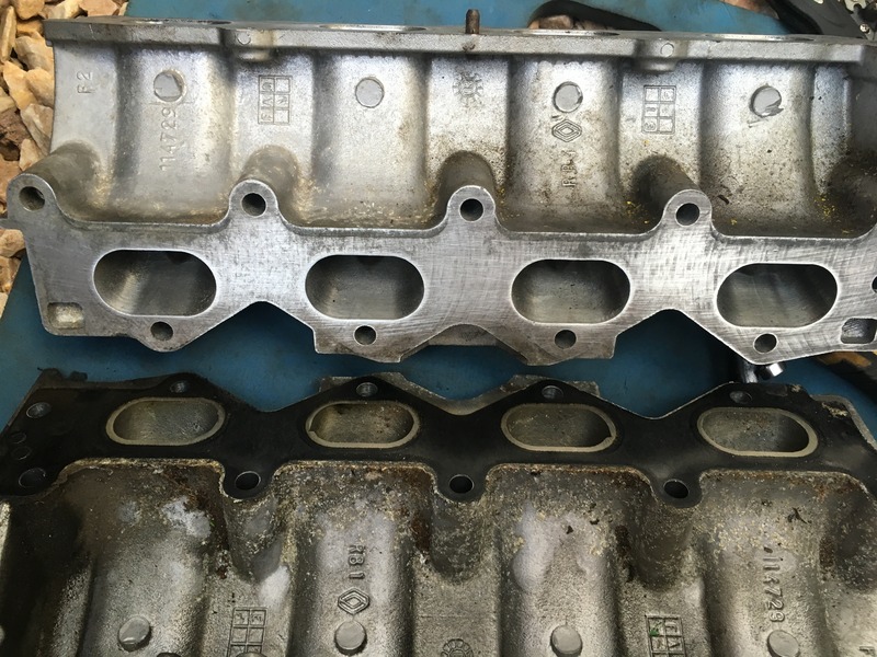

But tonight I realised I need to have it in a better state for moving it so got the pas belt on, sorted out the alternator wiring and swapped the lower inlet to one that has been matched. Only pics I took where of the inlets but I also put the bumper back on, note that I didn't say refitted...

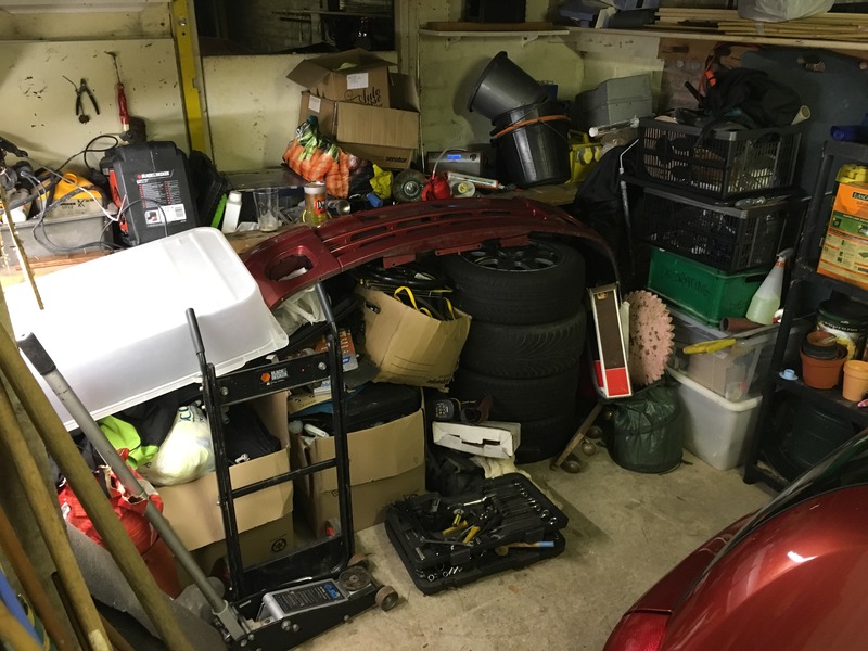

Still nothing happening with this bar got round to the new house but the garage is full of s**t from the move that it's not in yet. It will be soon though.

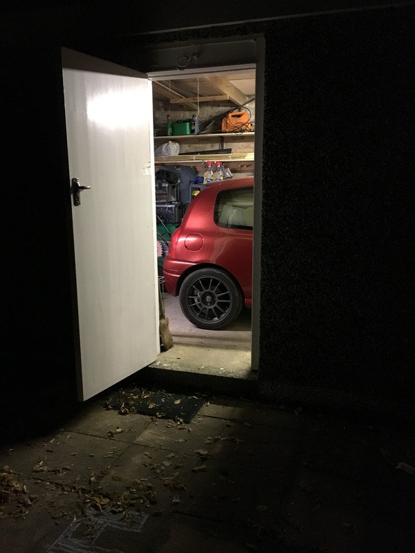

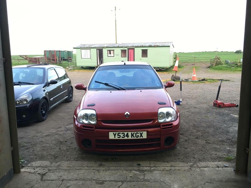

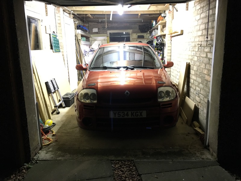

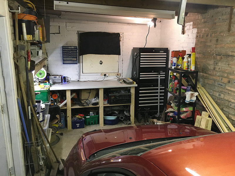

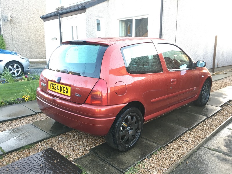

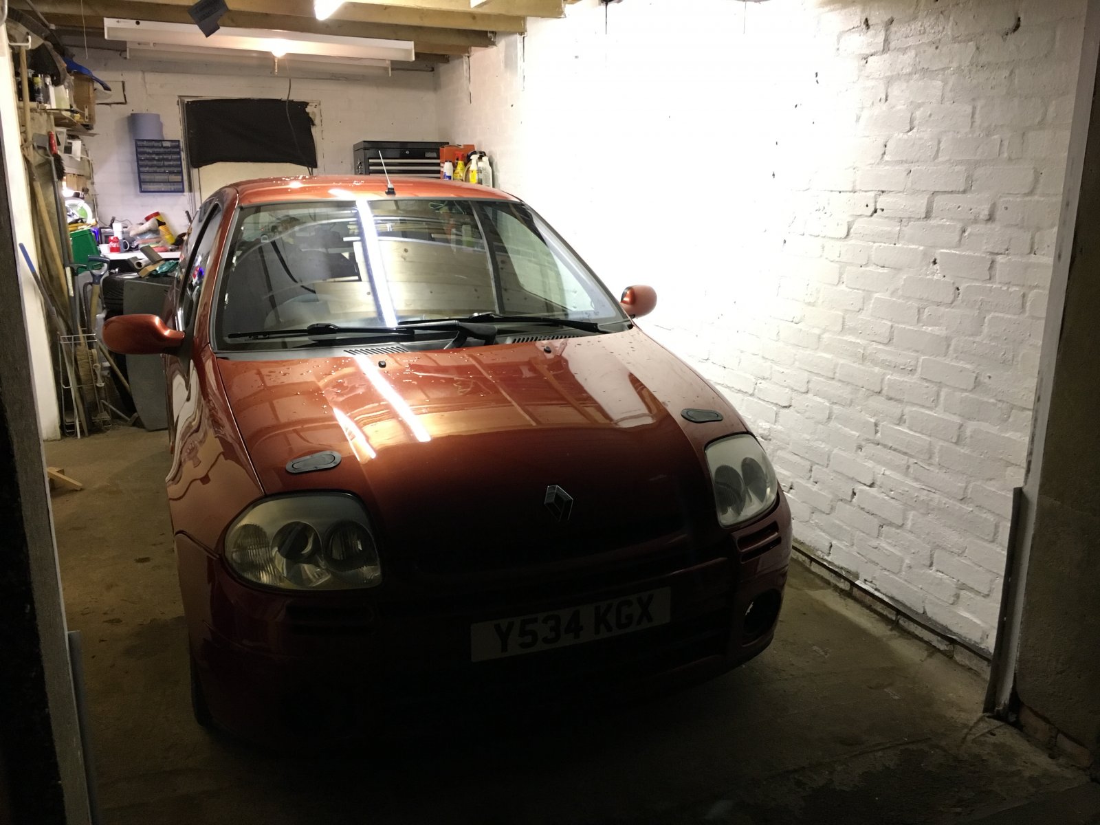

Well this isn't much of an update really but for me its momentous! For the first time in my life I have a garage of my own and the clio is in it! Absolutely surrounded by shite but in nonetheless. Got it quite far over to 1 side but I think I'll have enough room to work on both sides when its in the middle.
Its definitely long enough anyway

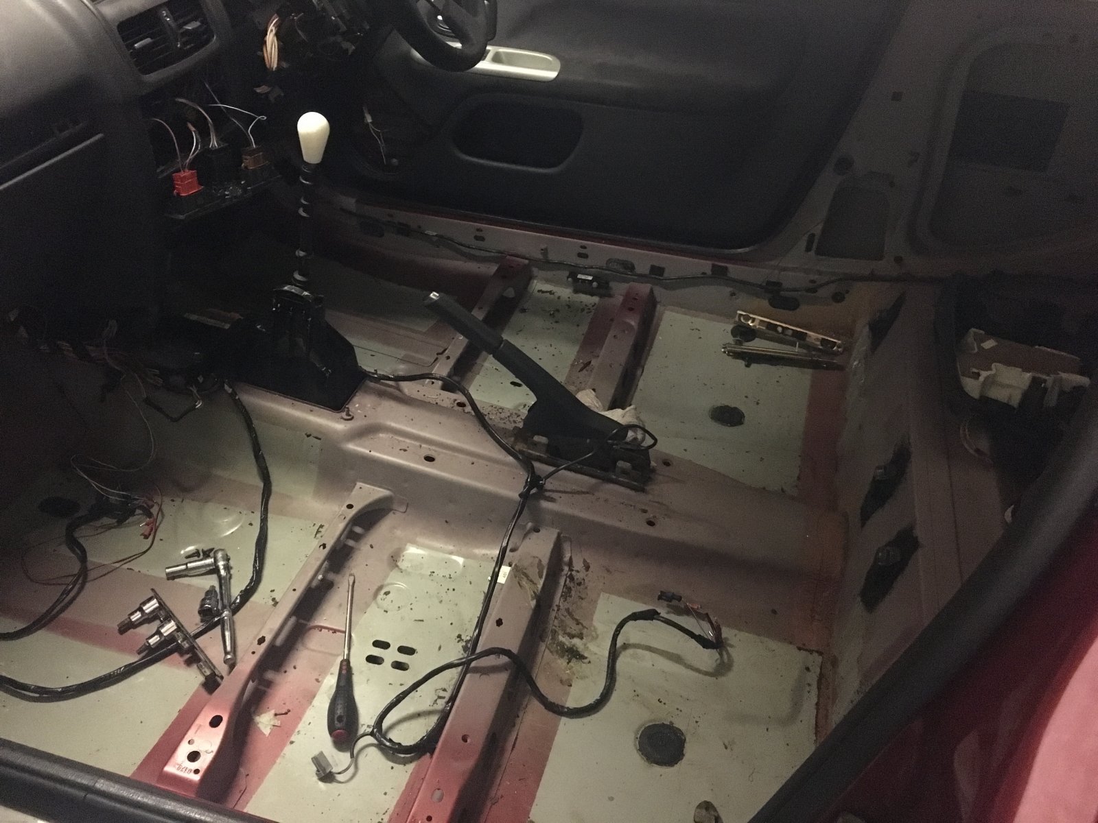

Got sent out to the garage tonight by the wife cos I was too nice and warm on the sofa so I decided to poke at it. @Djw Dave gave me a non aircon bulkhead panel last week so figured I'd chuck that on. Ha.
2 hours later the whole cunting heater box was out the car, forgot about the 2 bolts inside and accidentally broke a bit so had no choice but to get it out. Tbh I'm not that bothered about weight saving like that but it forces my hand to get a non aircon heater box so I guess it's not a bad thing. Hope the connections are the same!

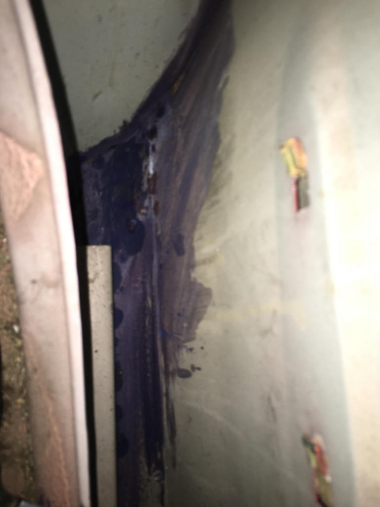

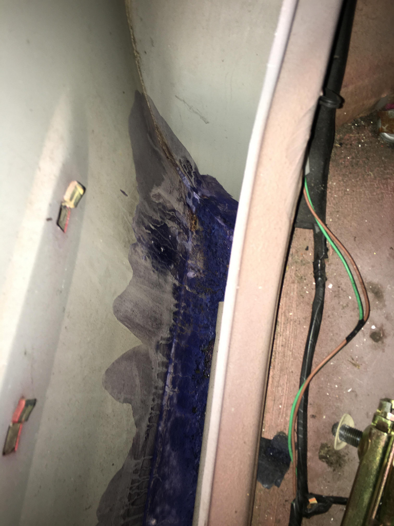

After that nightmare I thought I'd cheer myself up and finally get more than a cursory glance at the rust in the sills. Having seen the pics of @doug6488 flamer I have no intention of removing anything or grinding away to see the proper story, f**k that, ignorance is bliss!
So I chucked most of a bottle of hammerite kurust down both sides and brushed it around. As a bonus it's now also protecting one of my axle stands.....

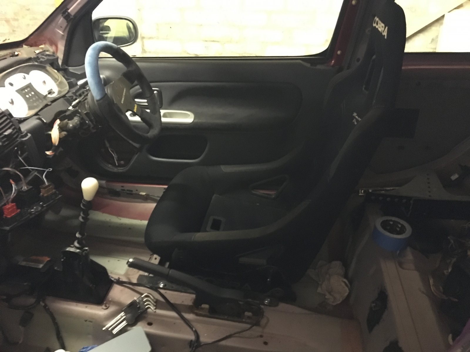

So after making and fitting shelves in the house I went out to the garage and trial fitted the seat. I need to get the right bolts as it's just standard m8 and m10s I've got.

This is my approach to the possible rot issue...can't see it then it's not there.....haha
Although looking at your picture of your inner sill this is similar to how mine were last summer. I decided tho treat them with a bit of Kurust and hammerite paint. Although I know it wont solve the issue but as it was slightly orange and not soft I thought I might as well.
I know I need to take my front arch liners out and have a good clear out of the crud like you did on yours and then sort my front jacking points out as they are a bit like cheese and non-existent, so I am hoping I don't ever need to use my boot jack!!

@KitsonRis Yeah I've poured a lot of kurust onto them and brushed it around a bit. Good news is my garage floor won't be getting rusty anytime soon...
Aye front jacking points have been fucked for most of my ownership tbh, never use them so never been bothered and now I'm too afraid to try!

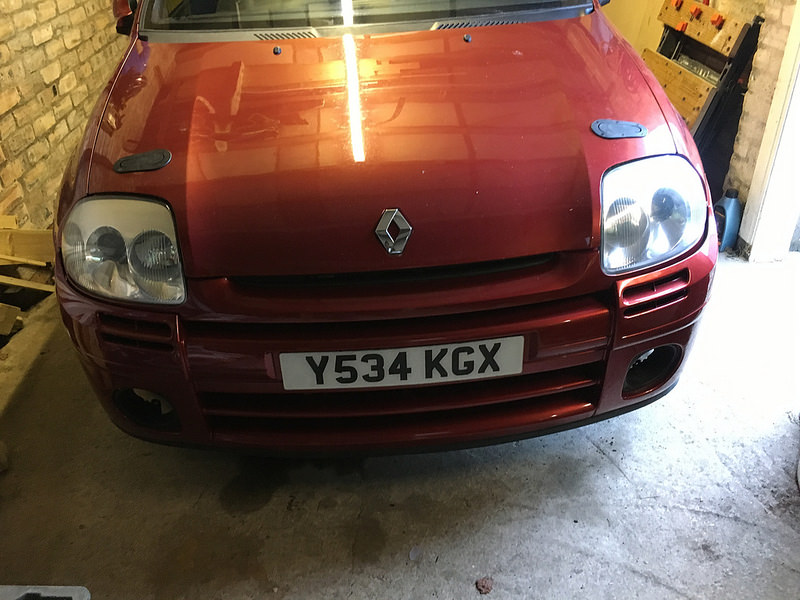

Today @Djw Dave came round and after procrastinating as long as we could we started poking at the clio. We swapped the rad over to the one I bought a few months ago, gonna get some Type D in the next day or 2, since they slam panel is removed we weren't happy with how much the rad could move around, especially at the top. SO we cut up my wheelbarrow and made some mounts! Dave also made one to secure the grill onto the driverside headlight. Then it turned out I don't have the right bolts (or more accurately cant find them! And the only M8 ones I had of a suitable length are 12.9 spec for seats! So now its probably the most secure ph1 grill around! Also trimmed the black grill down a fair bit.
The bumper needs a wee tweak on the passenger side but the front end hasn't looked as good as this since I hit a pigeon in about 2010!

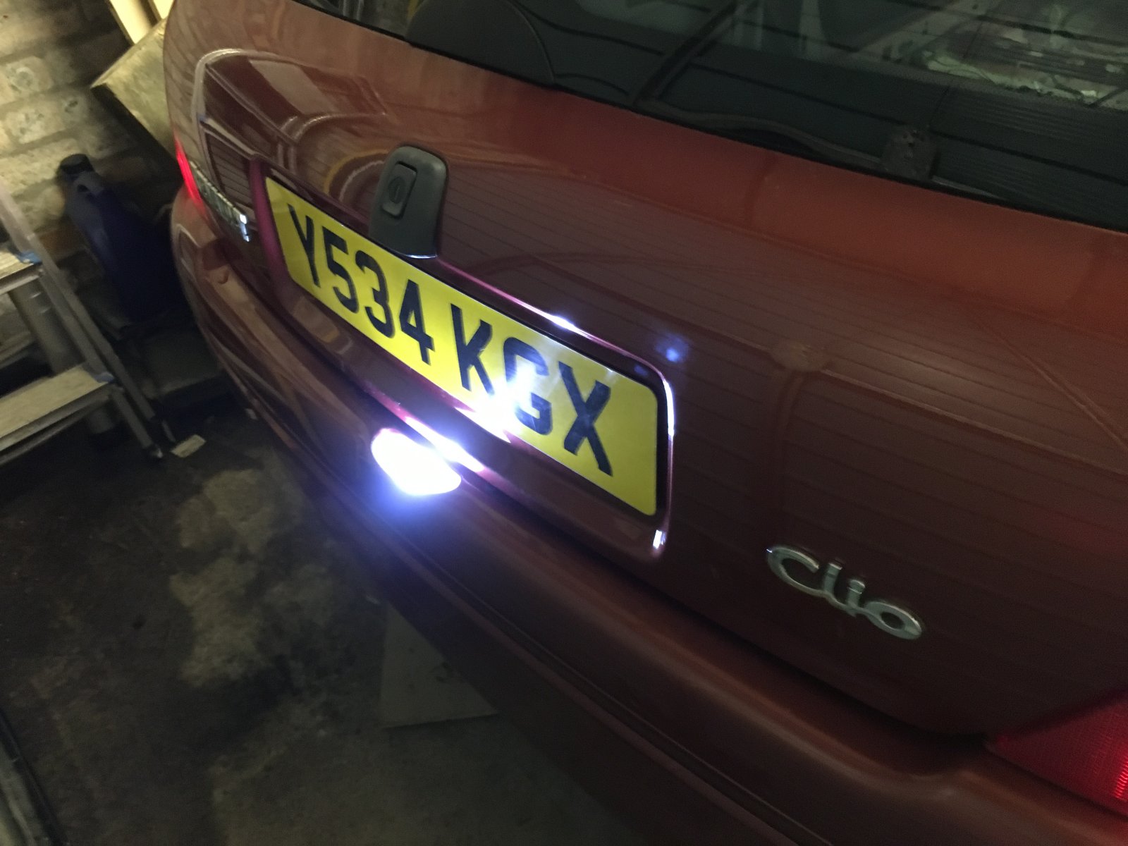

Got the reg light fixed after many years sanding the connections.

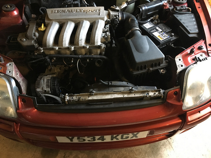

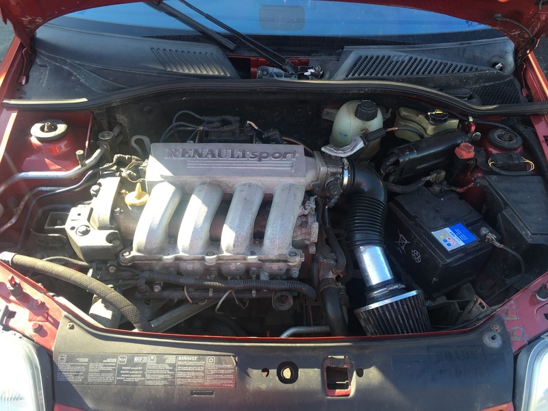

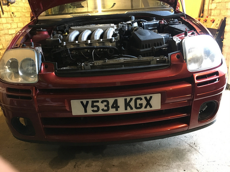

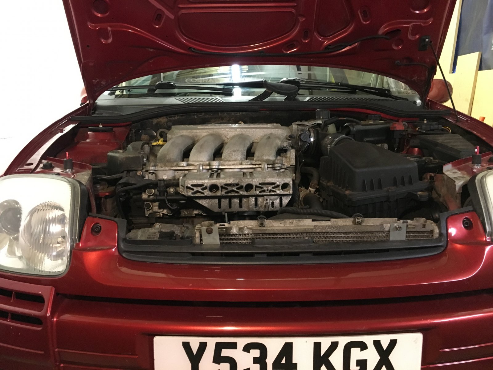

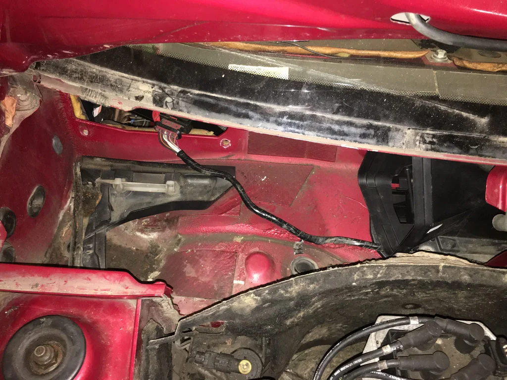

And retook the engine bay pics since they were so terrible last time!
