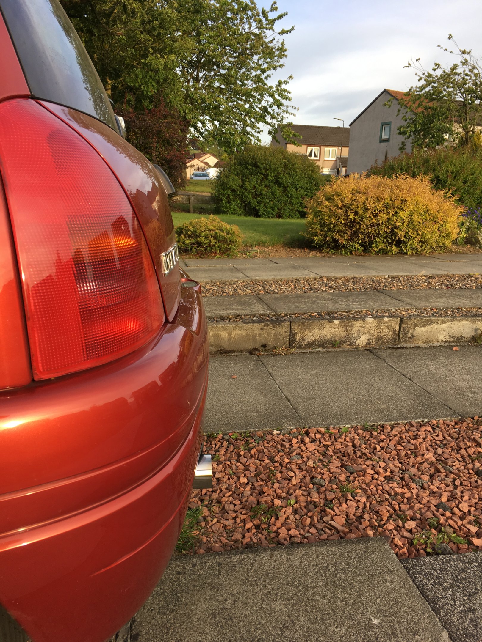

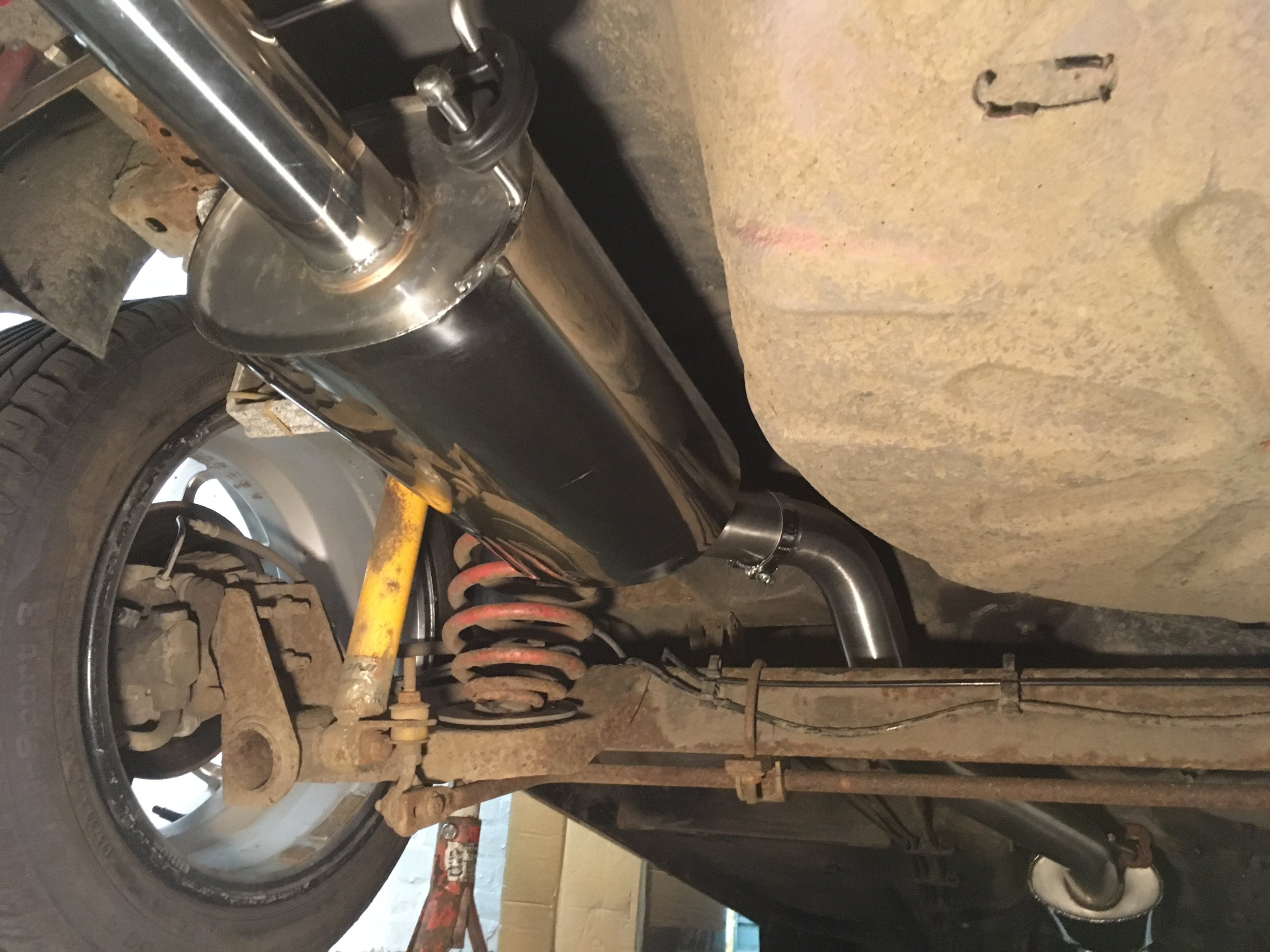

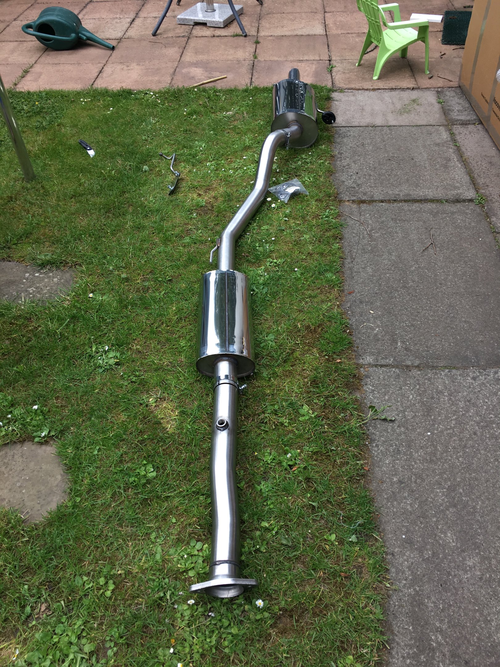

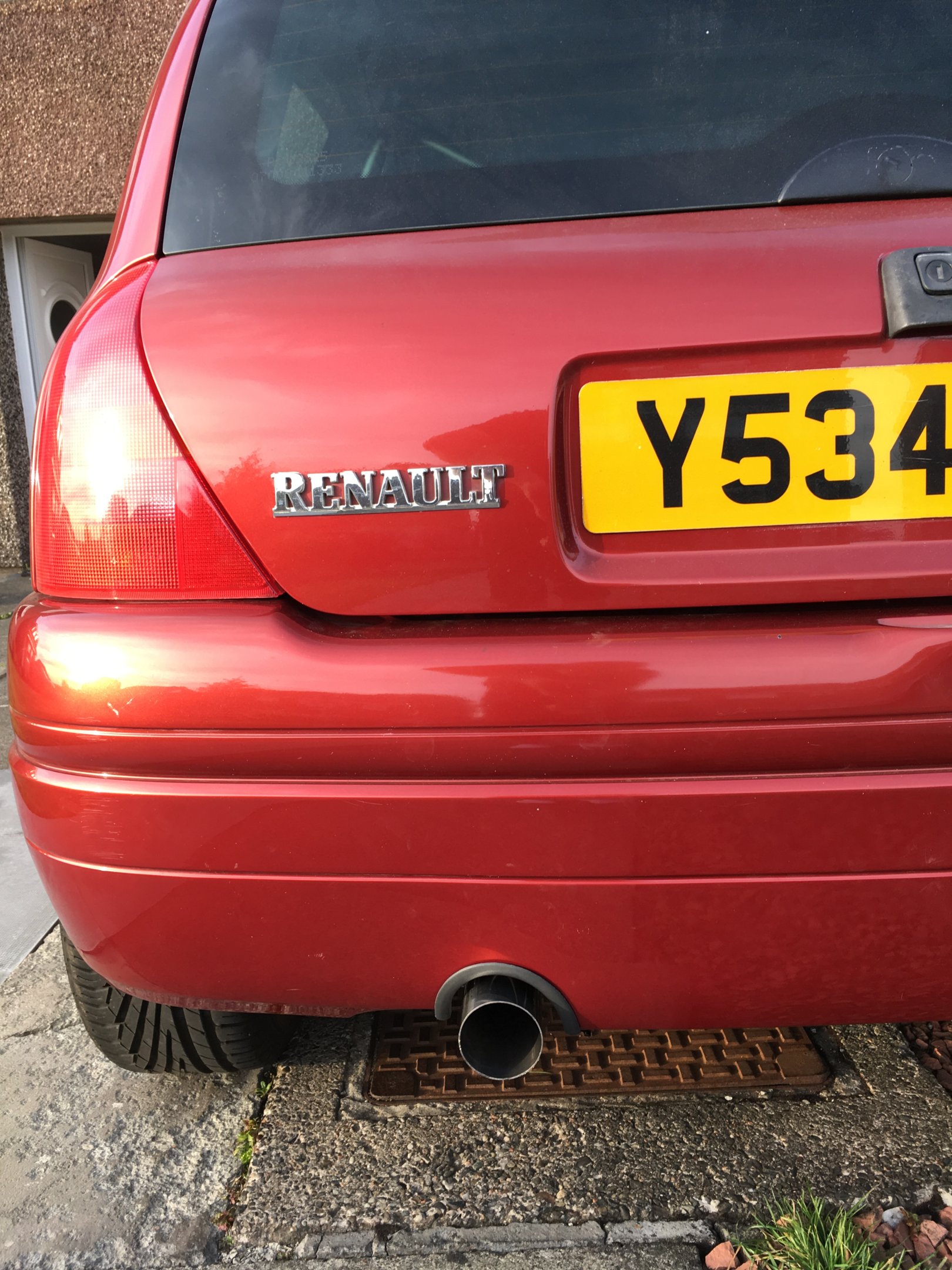

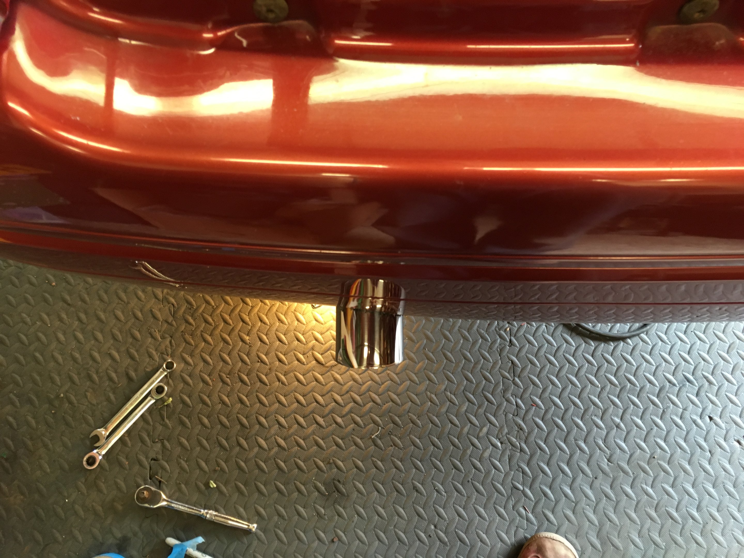

PMS Racing exhaust for a 182 manifold with centre silencer. Big big thanks to @Djw Dave for all the pedantic cutting of the tailpipe and bumper.
Unfortunately the tailpipe was damaged in transit and PMS are currently out of stock. So rather than sending it back for repair (I'd have preferred new but need the car/exhaust for FCS) we took the decision to cut the dent off and go for a straight cut rather than slash.
I'm not very bothered about slash or straight cut but what I do love is that it's just a little bit shorter than it was.

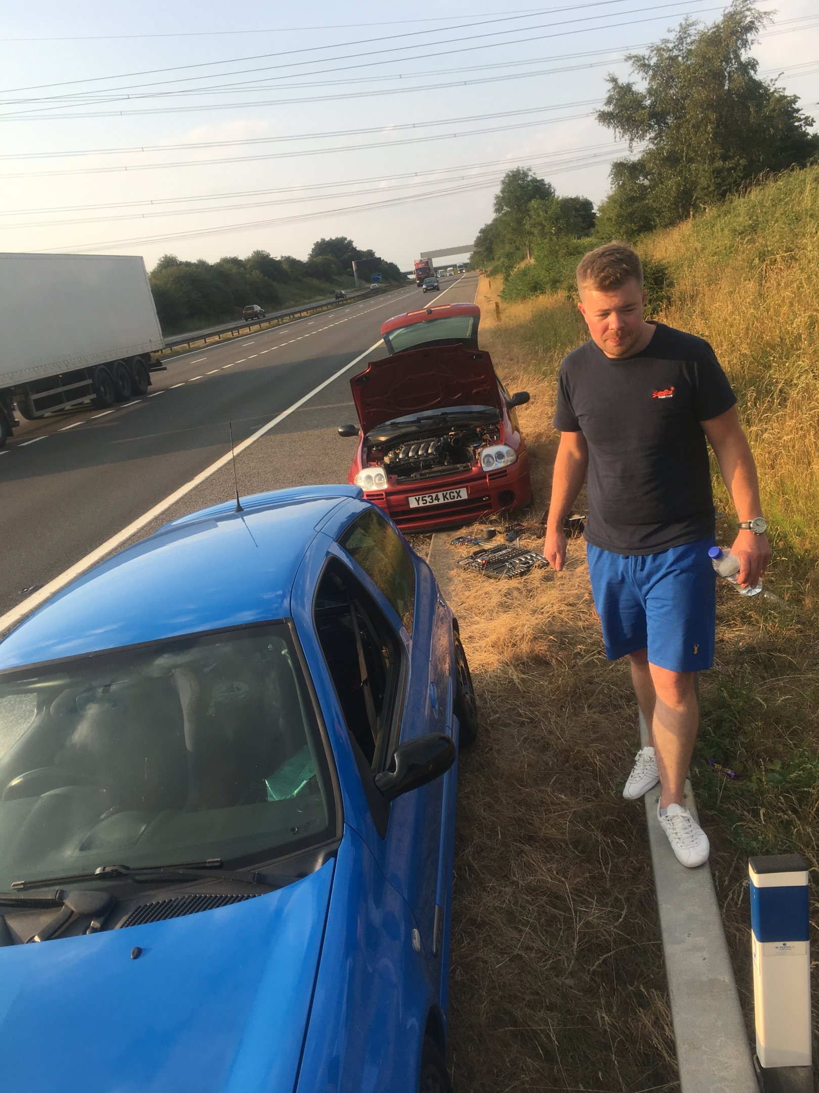

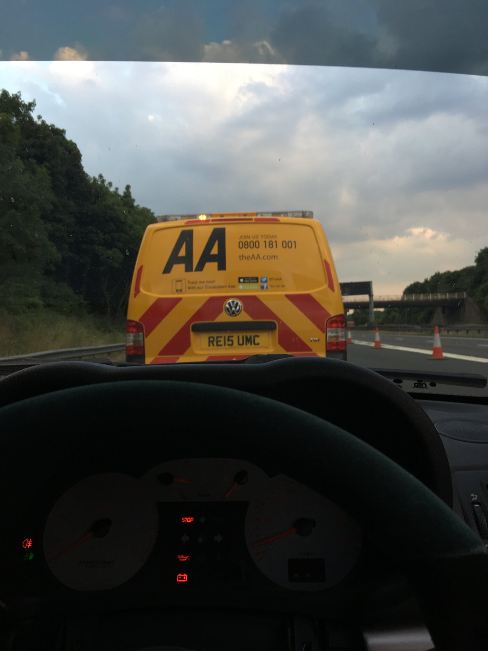

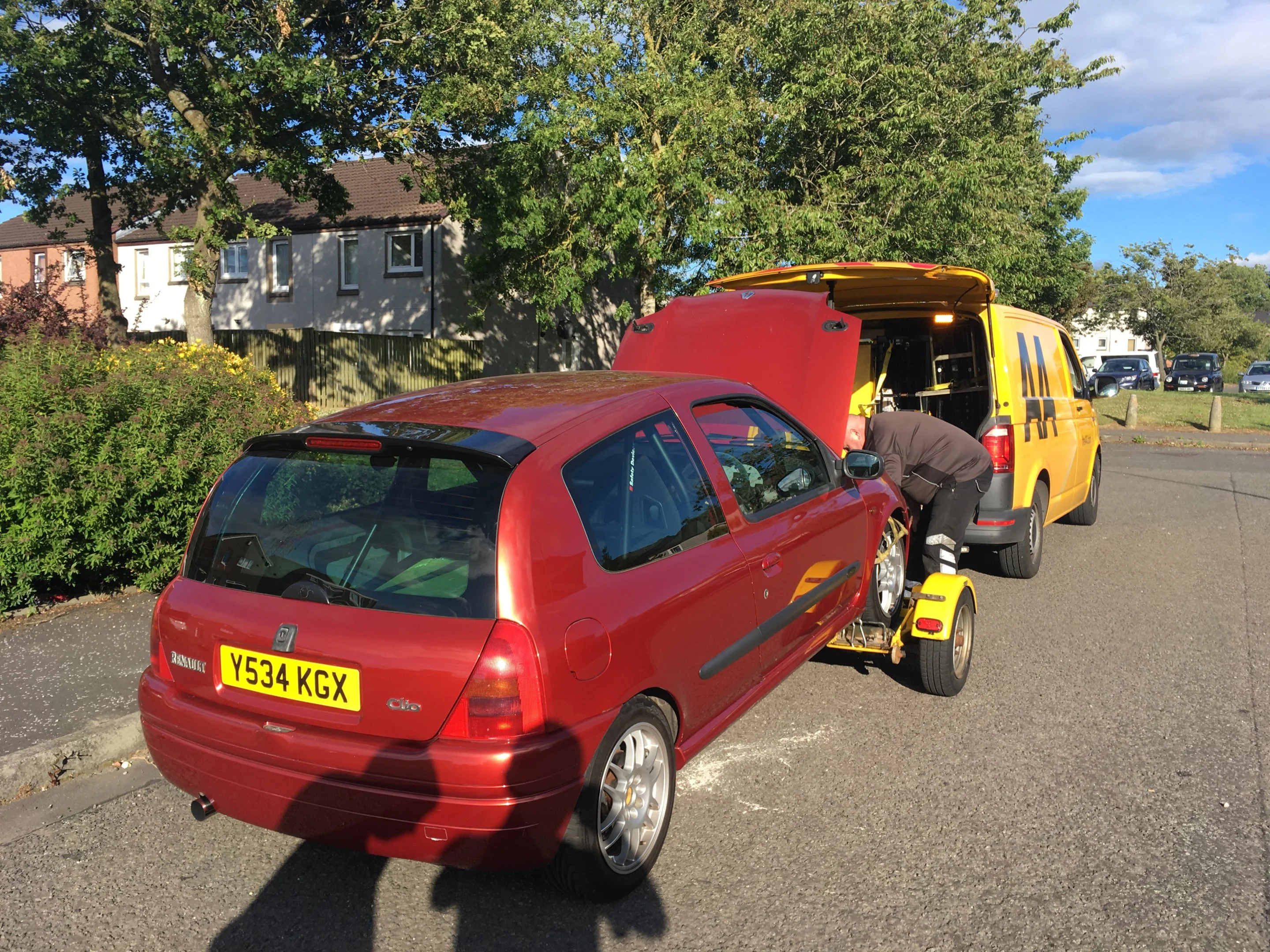

Dave can't help but catalogue pose 24/7. Broke down with no warning at all just where the M18 joins the M1, since we had a fair amount of spares with us we spent a hour trying everything before giving up and calling the AA. They diagnosed it as a seized fuel pump, certainly no fuel was getting through and he said he heard and felt it prime but then stop. We'd already sanded the relays down to no avail.
Given that Dave only had 1 seat in his car it left us with a bit of an issue, either I could go home with the car or we could overpack the RB and move the seat over. The patrolman was sound and said he'd flat tow me to Rotherham where we could do what we needed to do.

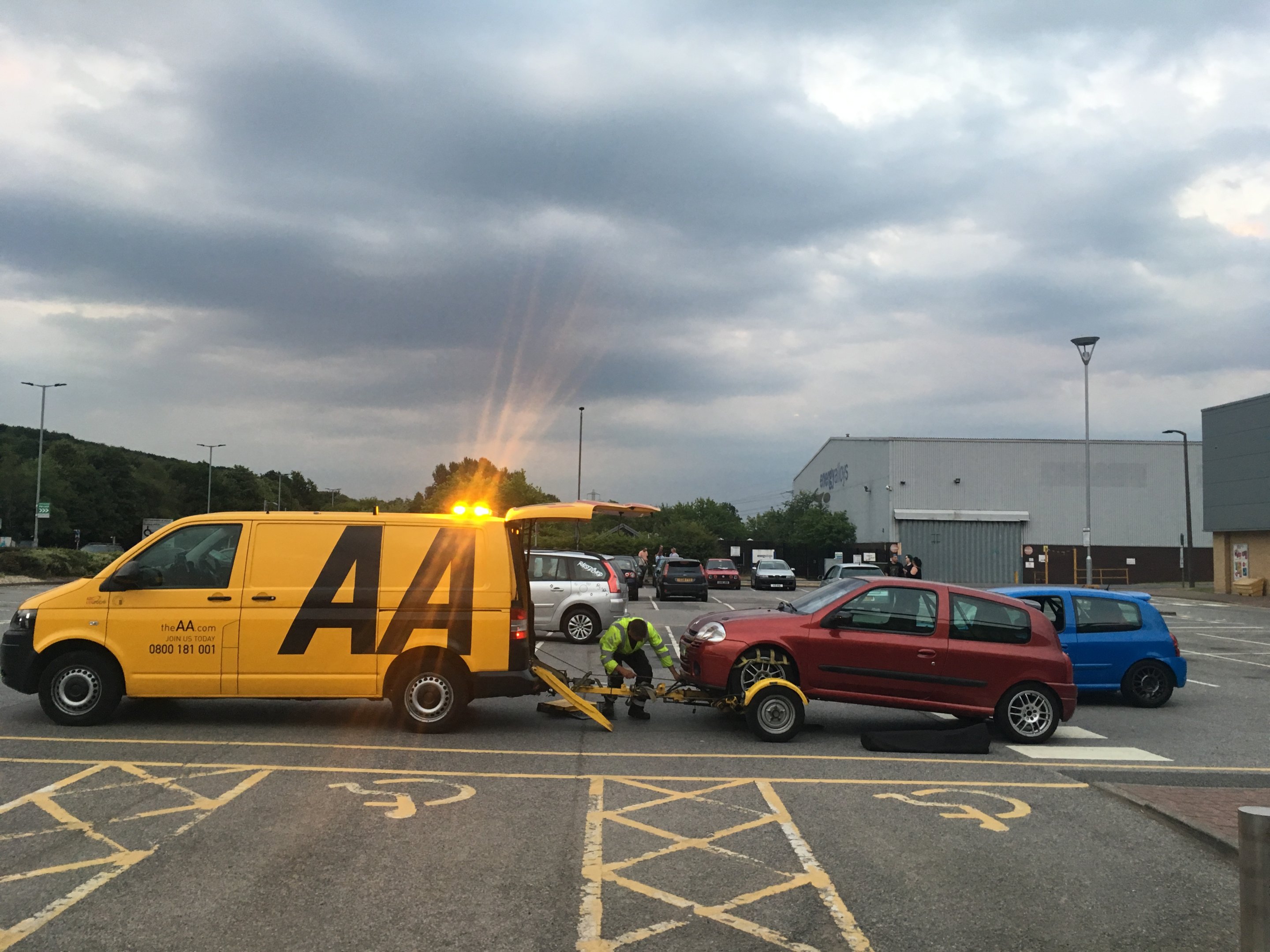

So he did, towed me straight into the Halfords car park which had a cruise happening. Mildly embarrassing with all the cheers on arrival!
But we quickly did what we needed to do and got back on the road at 2145, having had no dinner and still a hour to go.

And after all that, it was the fuel pump relay, cleaning a broken one was never going to fix it. Kicking myself for not packing 1 but thats hindsight for you.

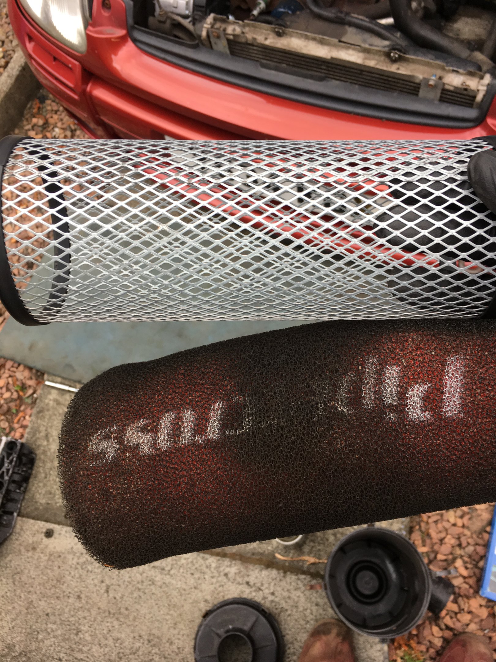

First thing is a simple one, time to buy an ITG filter!

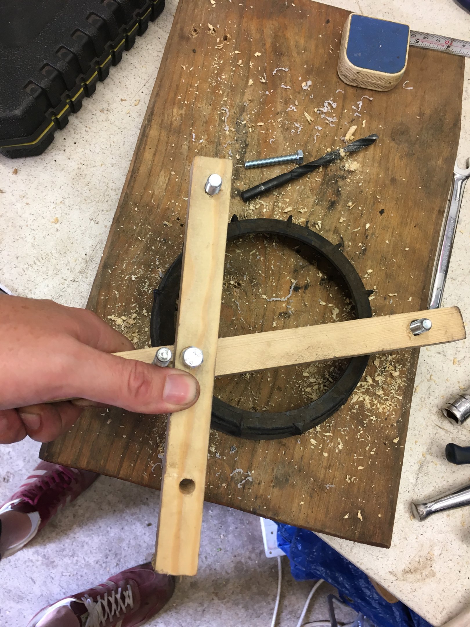

Diagnosed that the fuel pump was definitely not happy so swapped that out, didn't want to mash the locking ring and it wouldn't budge with the usual hammer and screwdriver method so went all Ed China and made a tool
If it looks s**t but works then it isn't s**t!

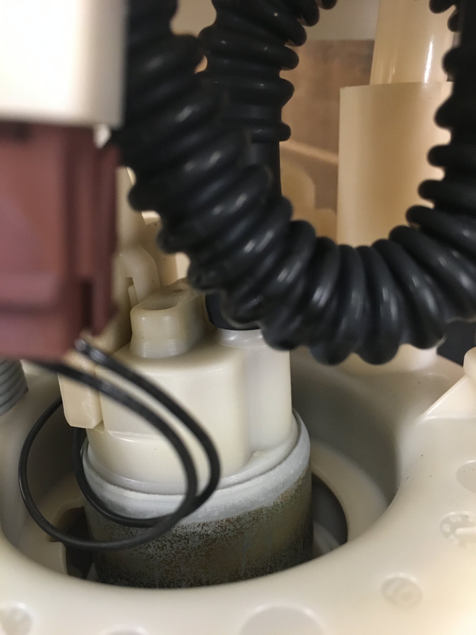

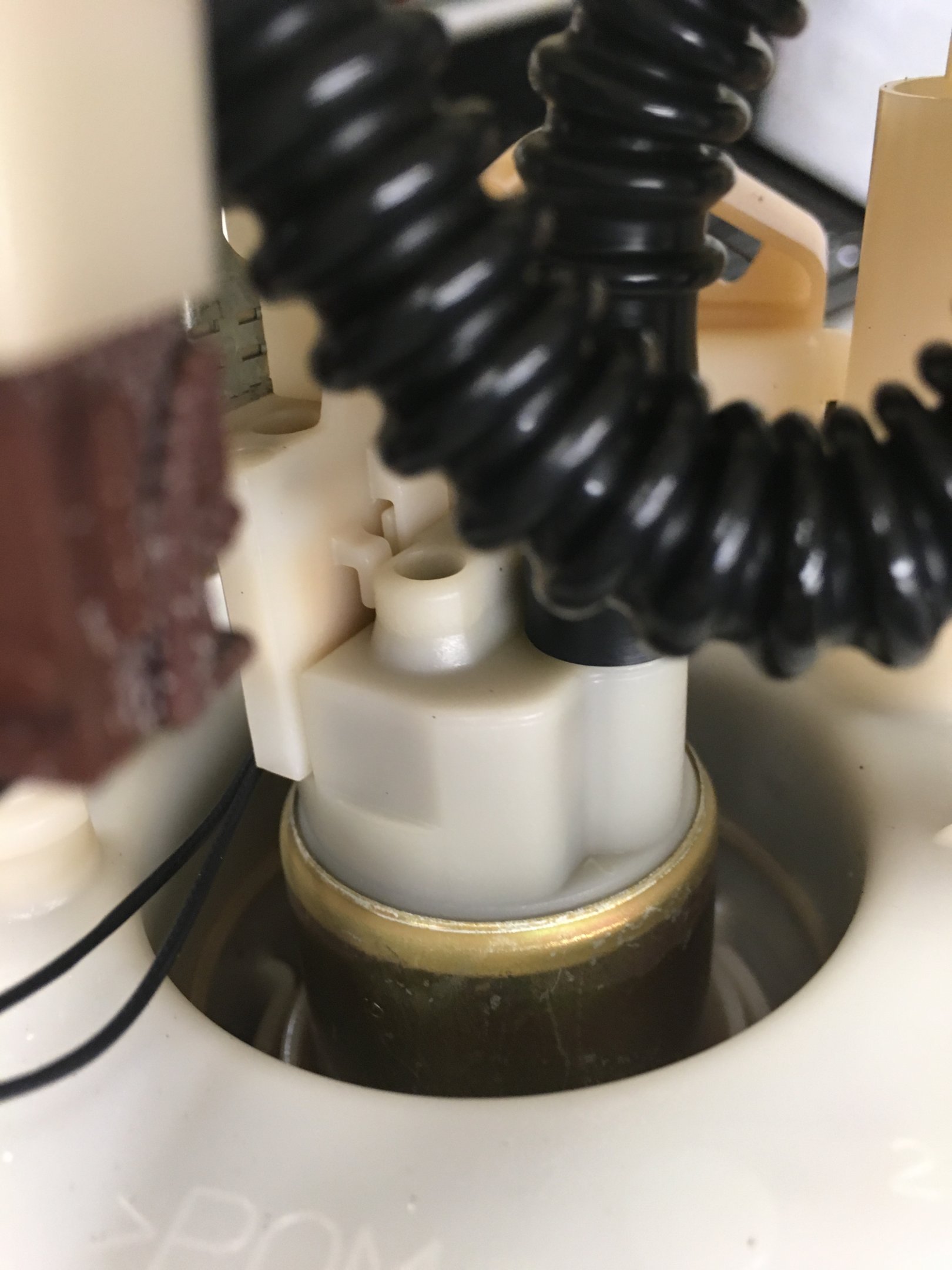

Confirmed that the fuel pump has had some corrosion over the years, I've put this down to 2 or 3 winters of not being used and a good year off the road all with very little petrol in it
When you compare it to the newer one you can see the differences

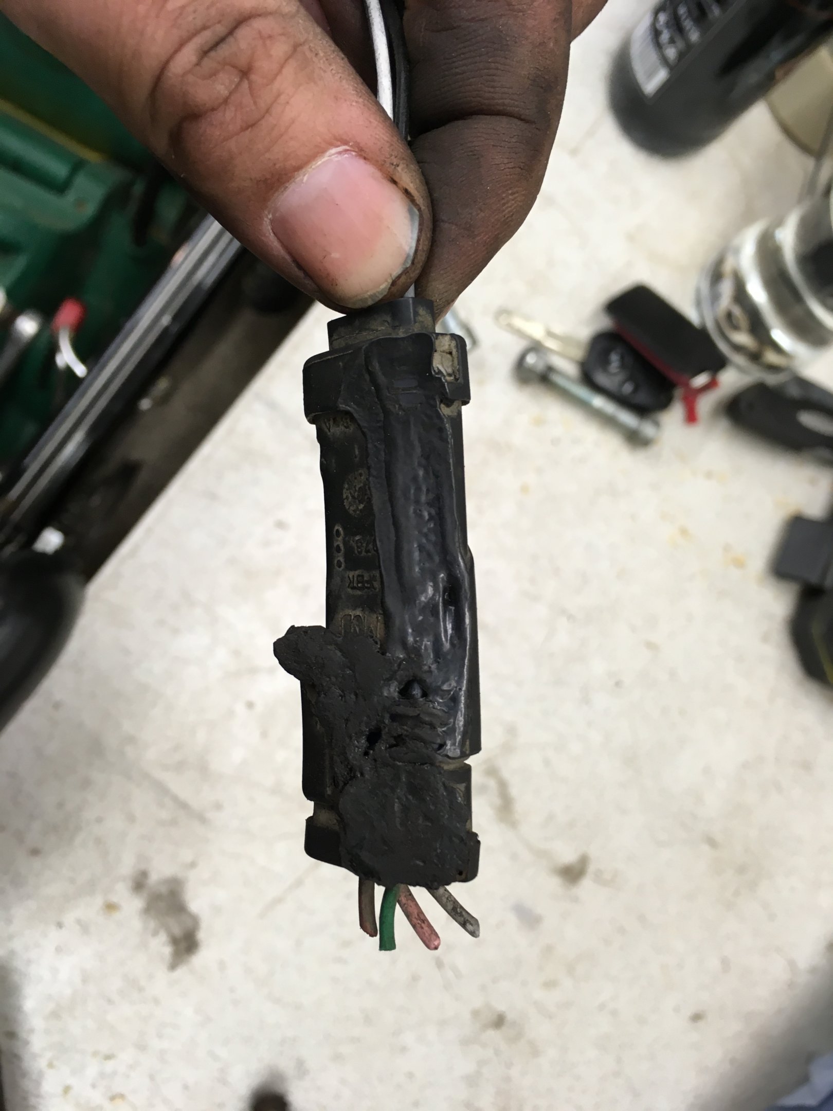

So now the fuel pump was basically silent and sounded much much less fucked I thought all would be good. But no. It did 1 successful journey and the next day it started misfiring like a b*****d once up to temp. Was beginning to suspect the first lambda when the EML flashed on and then confirmed it.
At this stage I was still putting it down to a bad batch of fuel. That was until I saw this.
So what I think has happened is that yes, the fuel pump seized and blew the relay. When we first replaced the relay it still wouldn't work, then a hit with a rubber mallet kicked it into life. But at the side of the road we checked pretty much every bit of wiring that we could, at some point I must have moved the lambda plug and its rested against the manifold. Once I'd fixed the fuel pump and taken it a drive its been fine, then the plug has melted and caused the next problem to run consecutively. Replaced the lambda and wiring thanks to @Djw Dave for donating to the cause and thats got it running again.

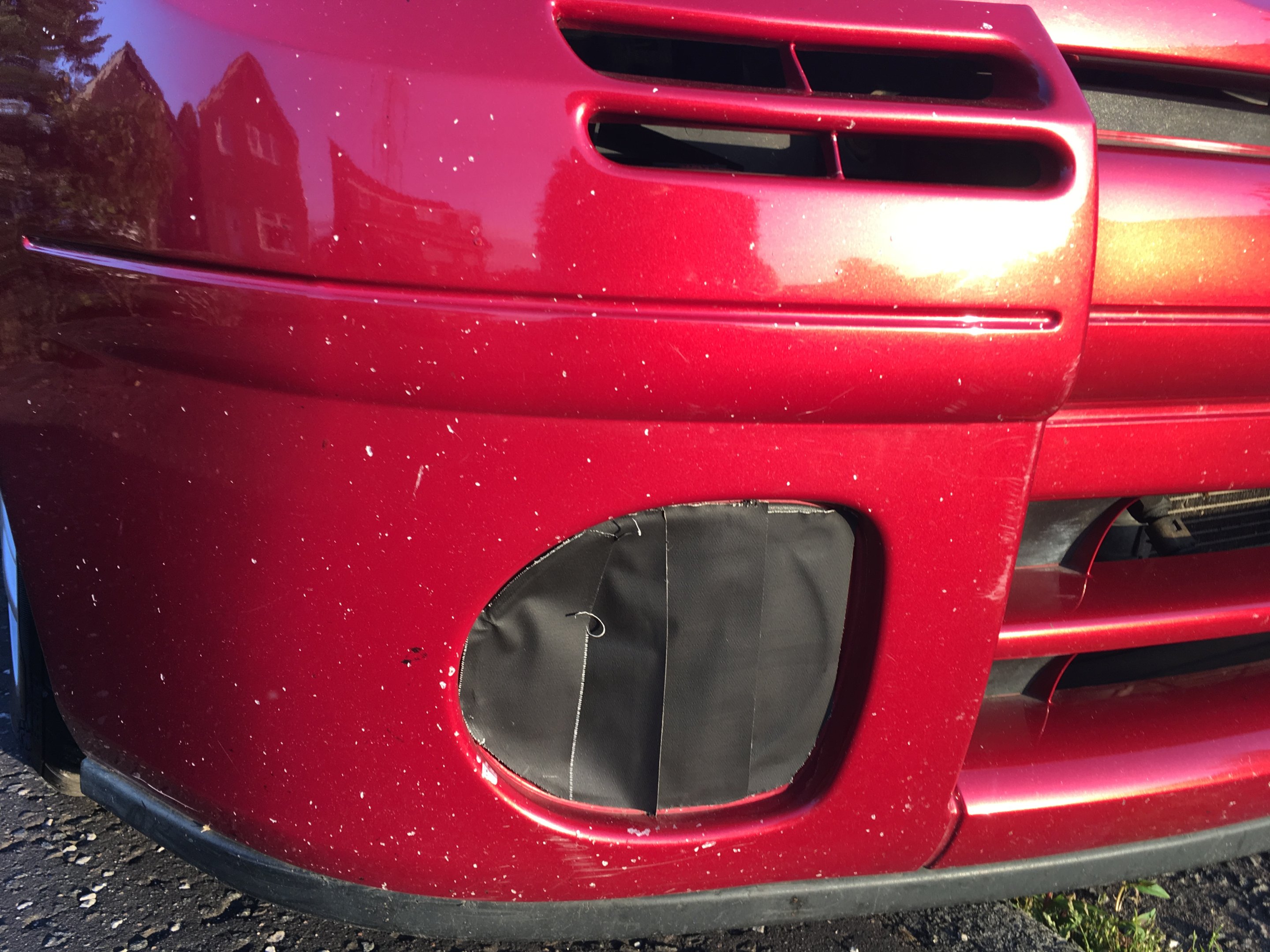

After the brake bleeding and swapping and clean on Sunday I remembered that DS1.11 squeal like f**k, especially when cold. So, every little bit of heat helps...

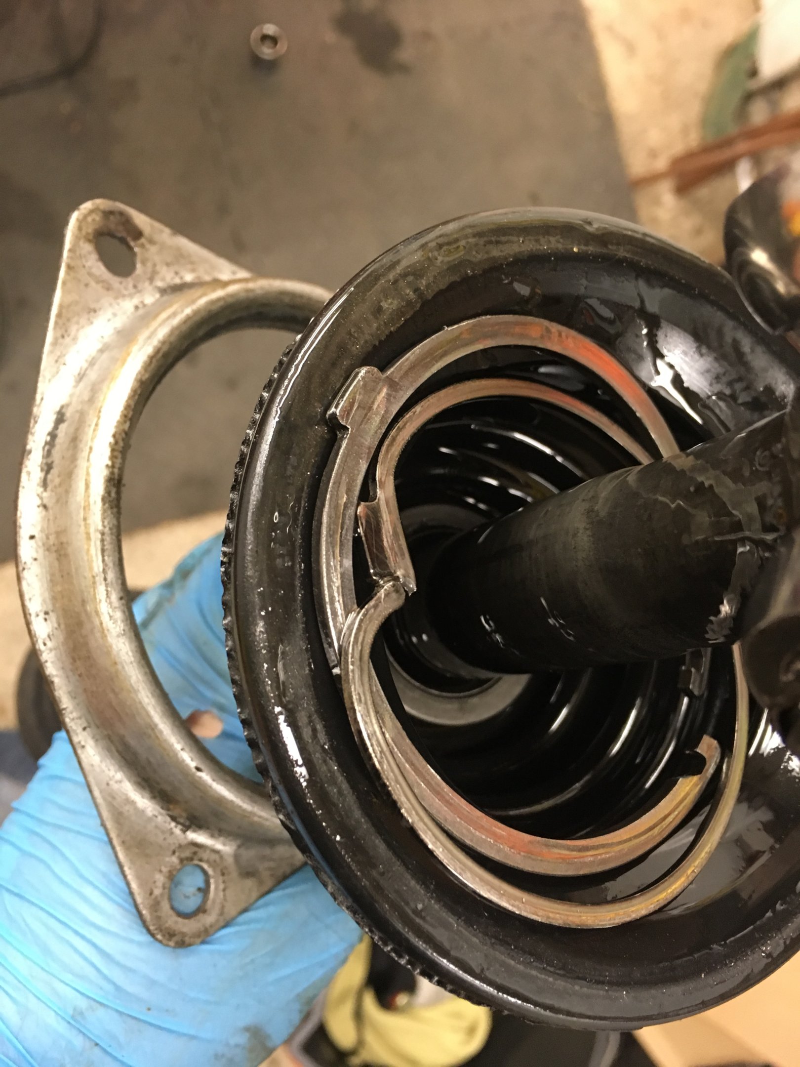

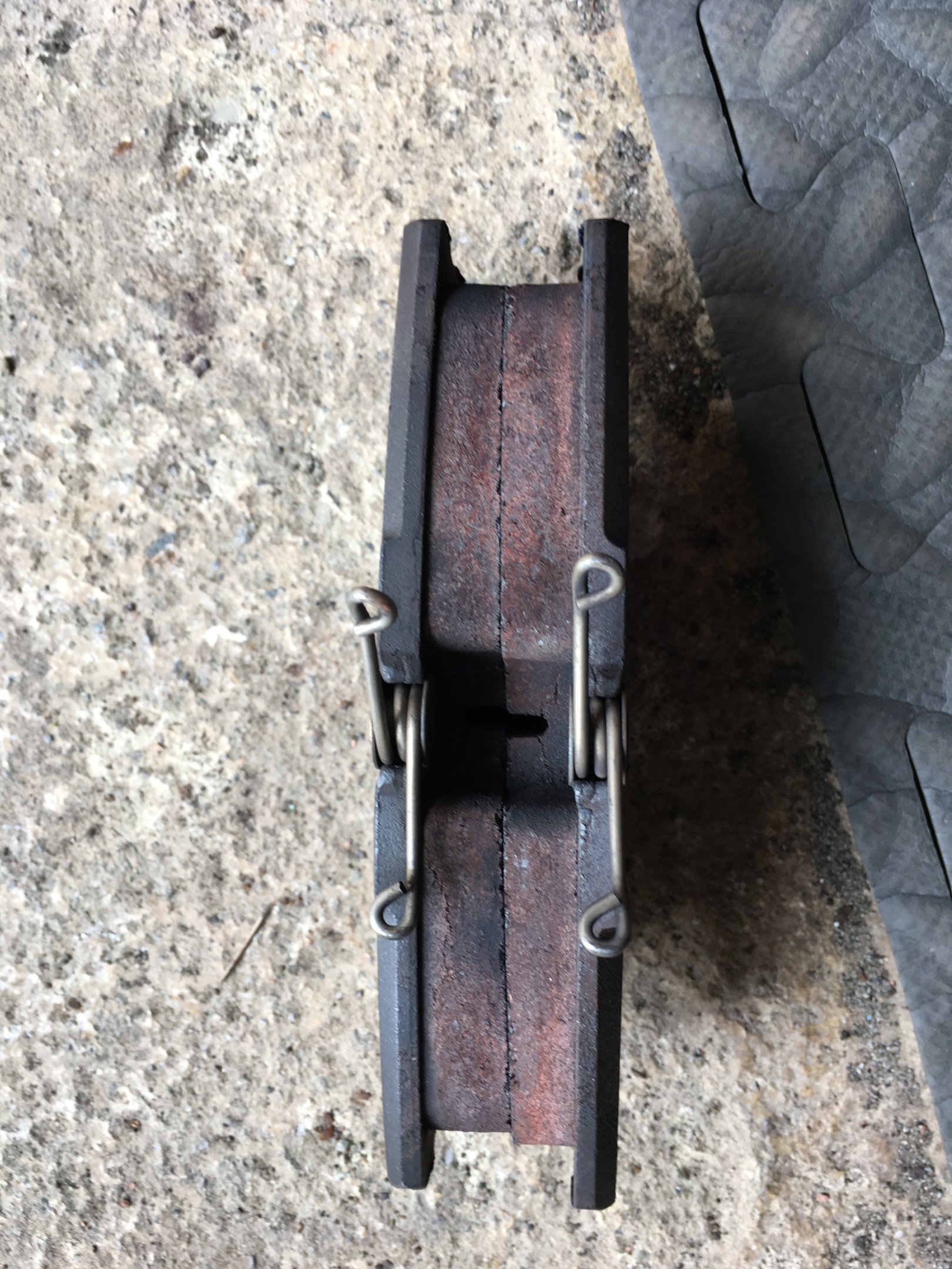

I've done 3 days on the DS1.11 now and I'm really happy with how little they wear and how well they hold up. But, they're wearing a bit funny. I've been religious about making sure they're always used in the same position. Anyone any ideas? @George@RTR_Parts ?
I think I'll swap inner and outer for the next one and accept they'll feel a bit crap until they're level again.
My CL5 did this and I ended up finding a pair of low mileage caliper carriers and fitting new pins to get rid of the slack.

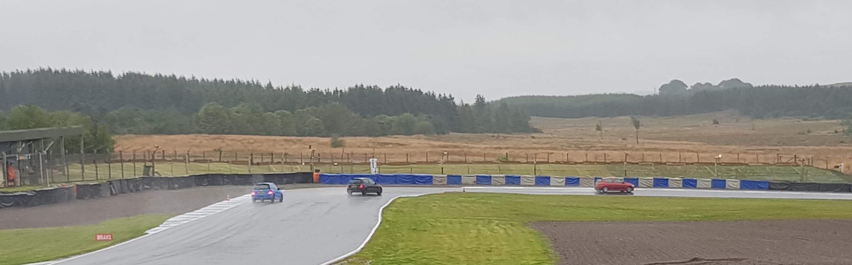

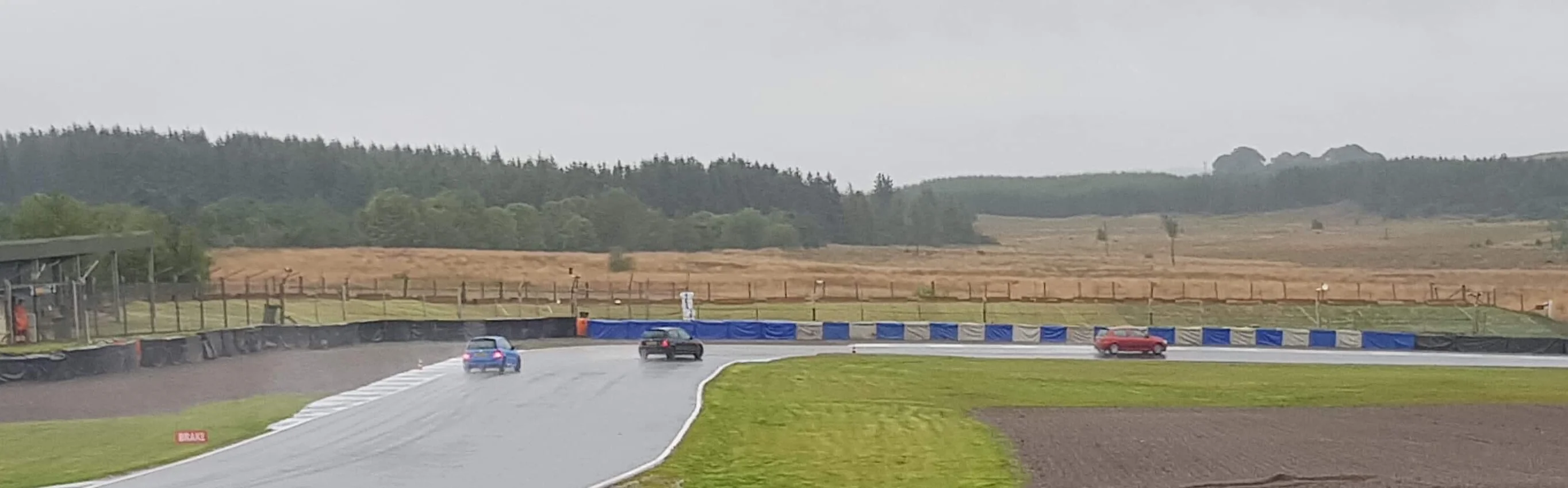

Well, it and I survived an absolutely sodden track night! First wet one in about 3/4 years I guess and the confidence just wasn't there for some reason. @Djw Dave was on fire though, probably going as quick in the wet as he has been in the dry!

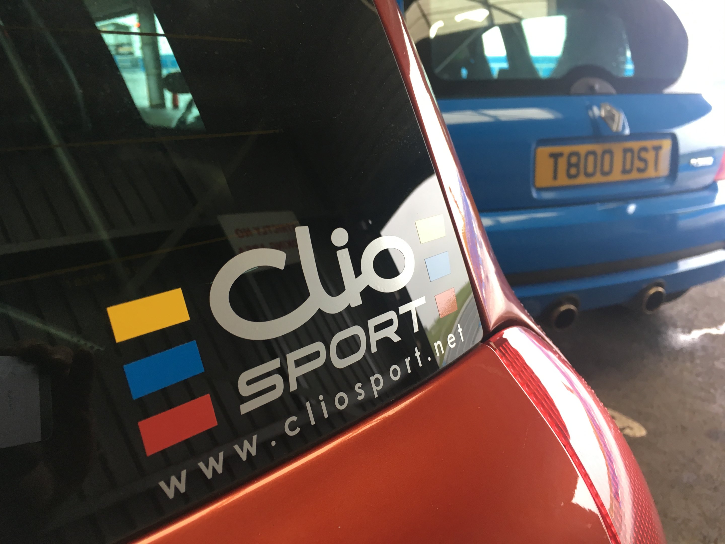

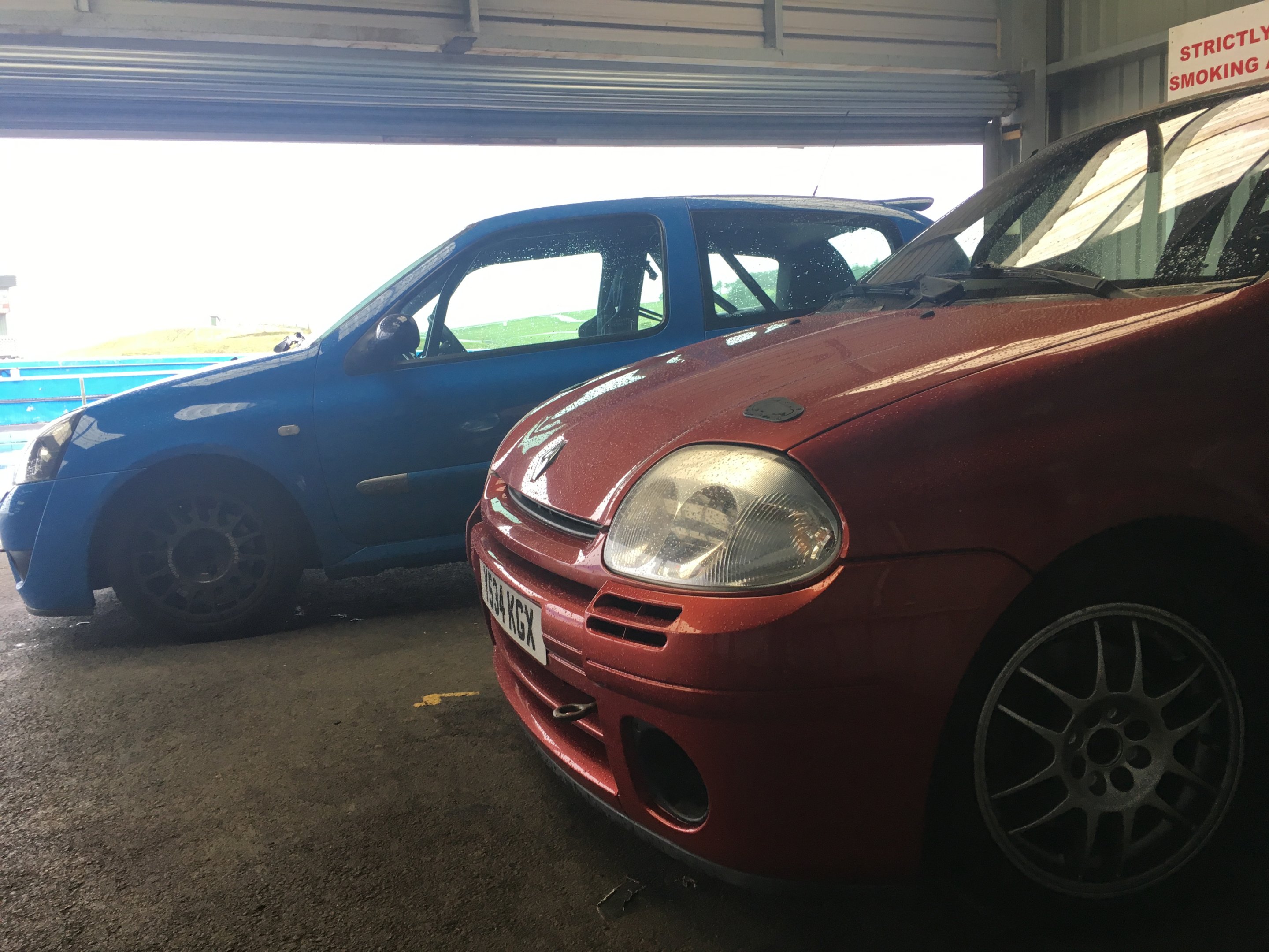

We got there pretty early and hid in the garage out the pissing rain. With no wheels to swap over we emptied the cars and I got Dave to fit my sticker I bought at FCS
And then just pottered taking a few more pics, hopefully some on track ones appear soon

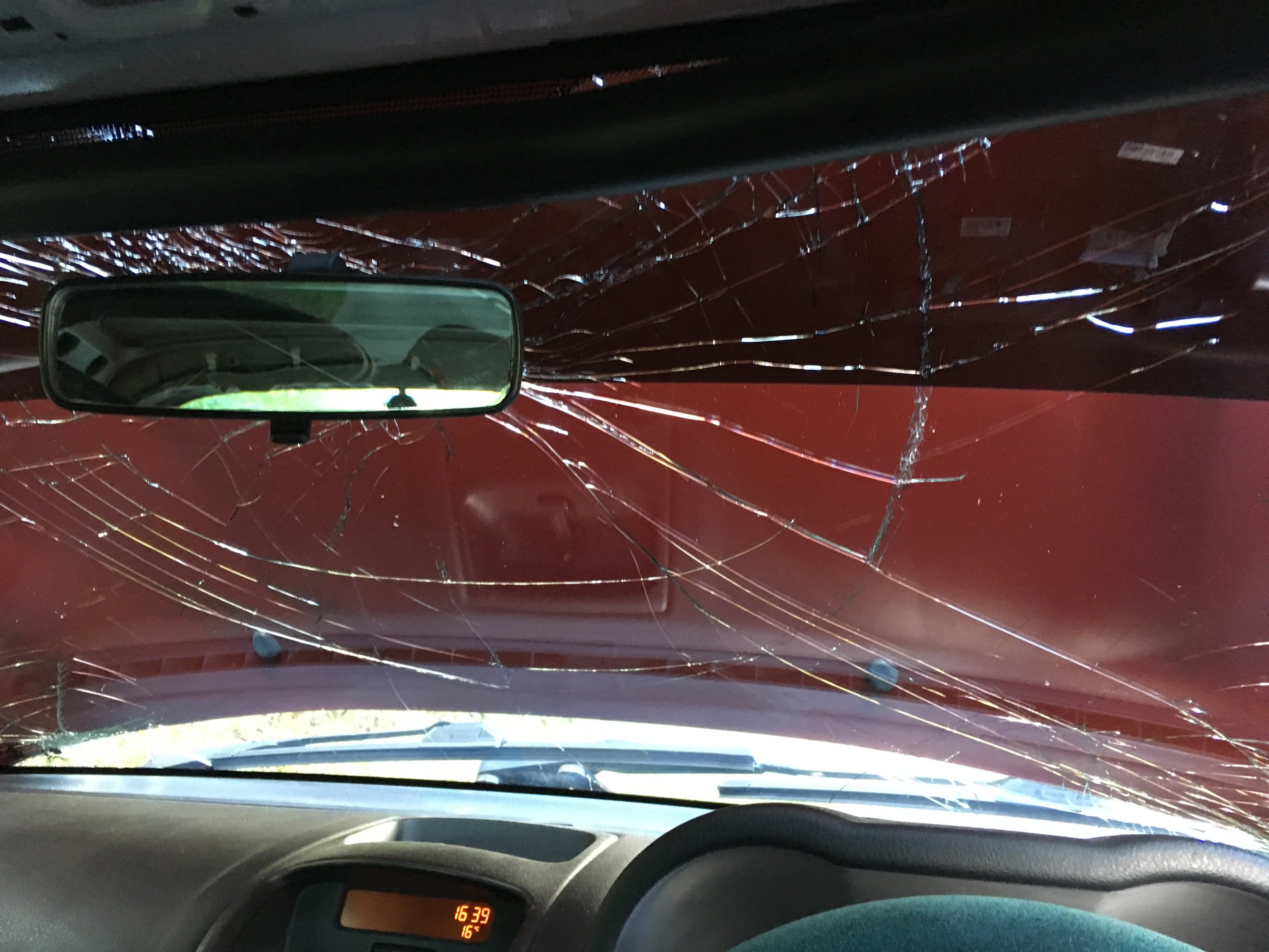

And now for the not so good update.

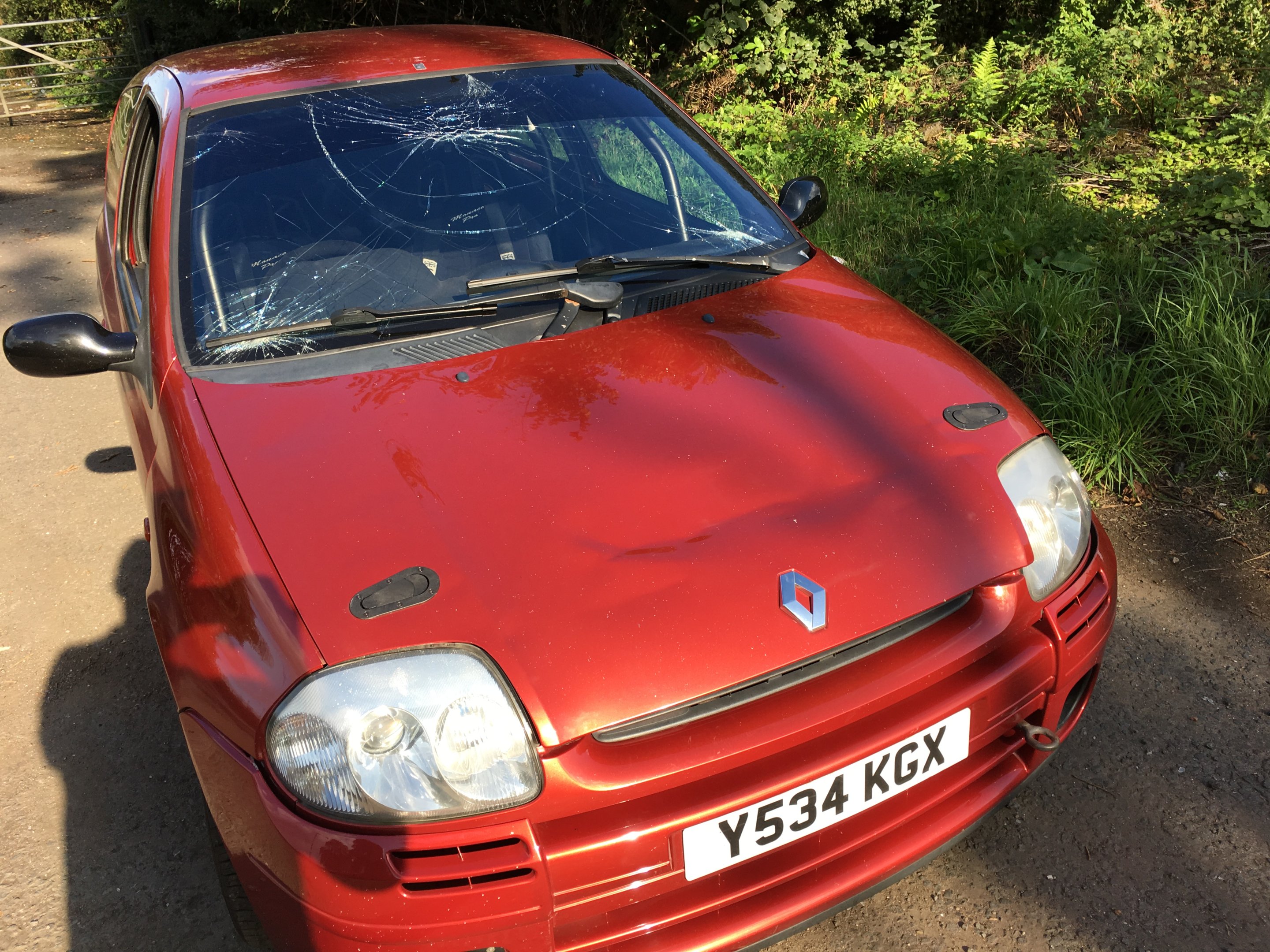

I forgot to lock the bonnet down and it flew up at 45mph.
So then I was annoyed and once I got it back down and secured I did the biggest wheelspin of my life. And then I had no drive. Yay. f**king idiot.
So @Djw Dave was chief damsel in distress rescuer and dropped everything at work and came towed me home. Massive thanks to him and his boss.
So after sulking and having a couple of beers I couldn't just sit in the house anymore and went out to the garage about 9ish.

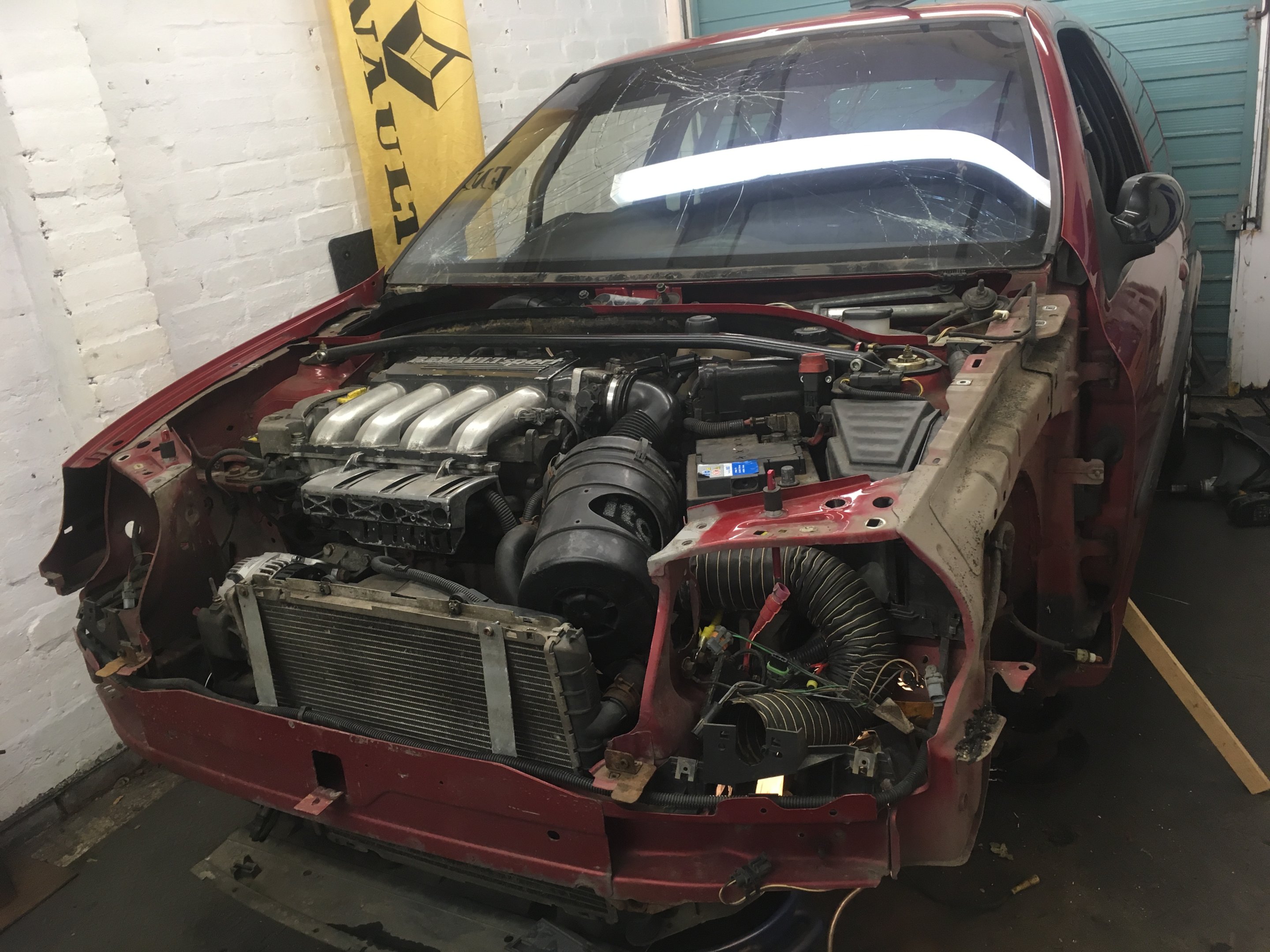

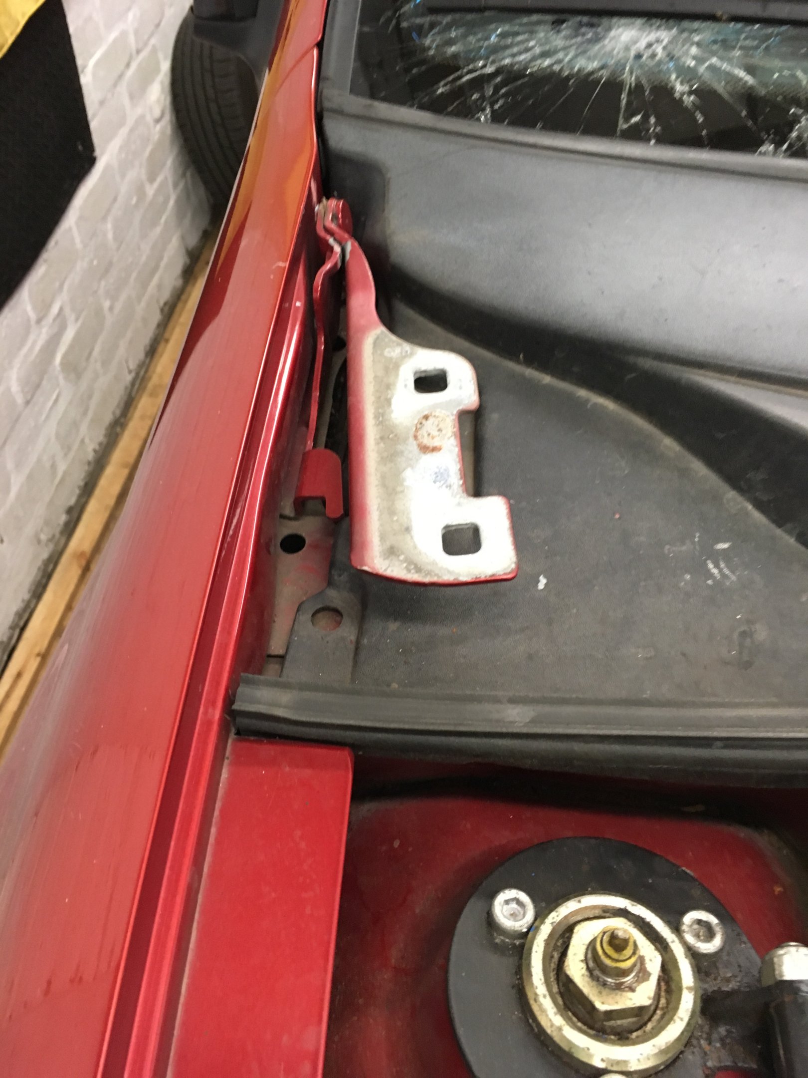

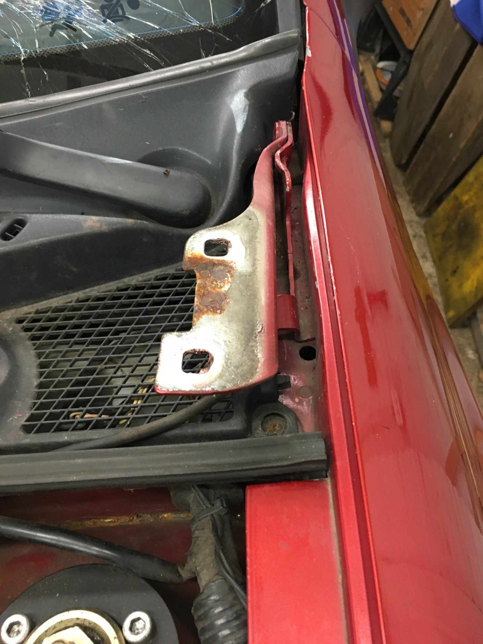

First thing off was the bonnet, look how fucked the drivers hinge is, passenger one is only a little bent.

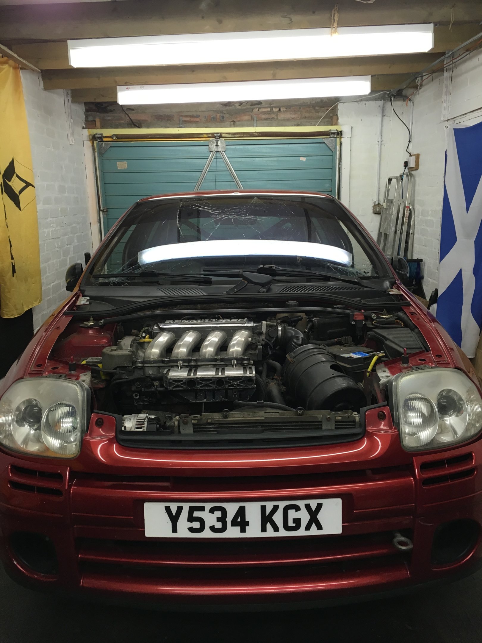

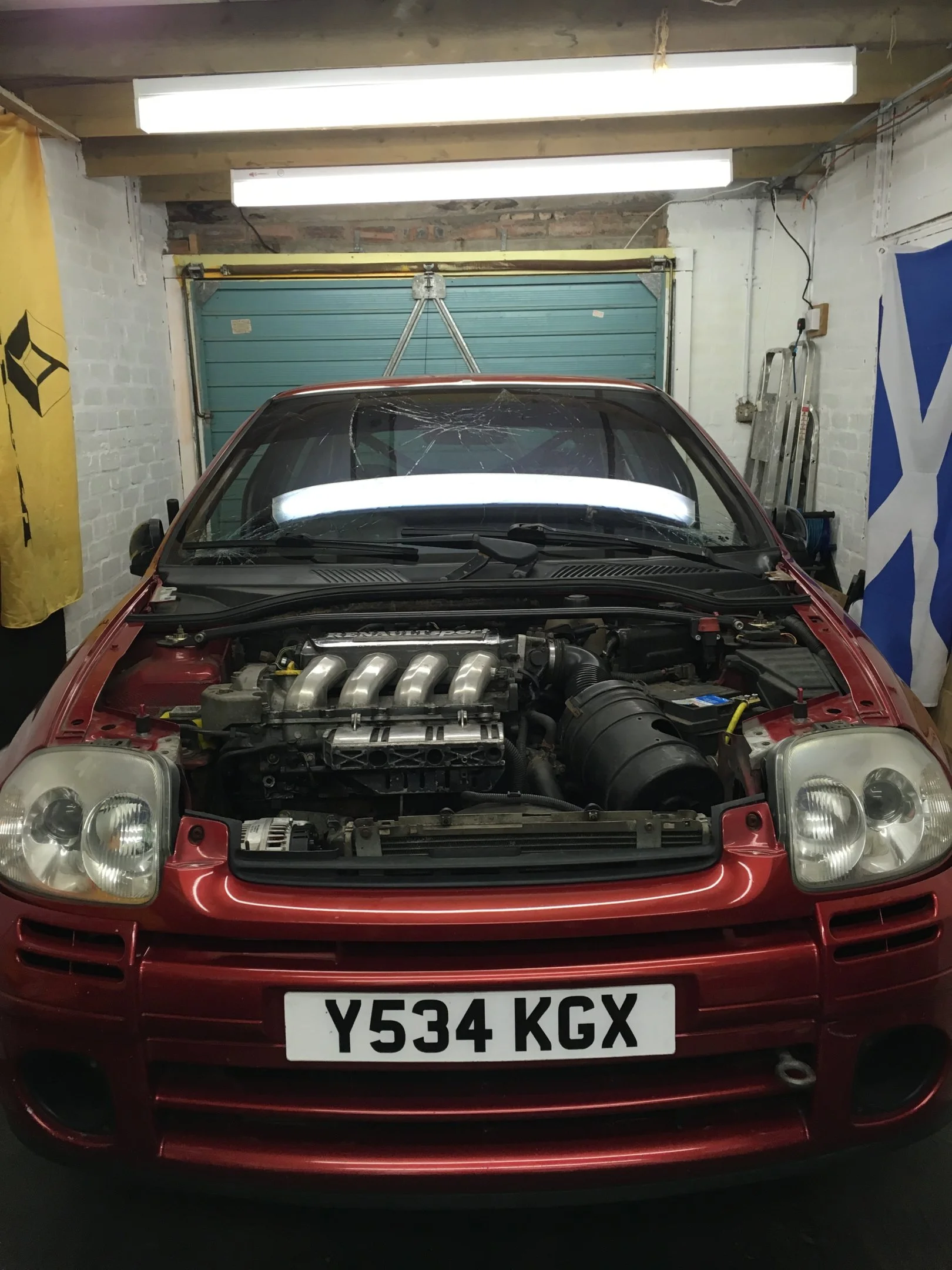

Then it was time to find out why it wasn't moving so a quick strip down on the passenger side confirmed suspicions
Hopefully that's all the damage I did. Left it looking pretty sorry for itself by about 11

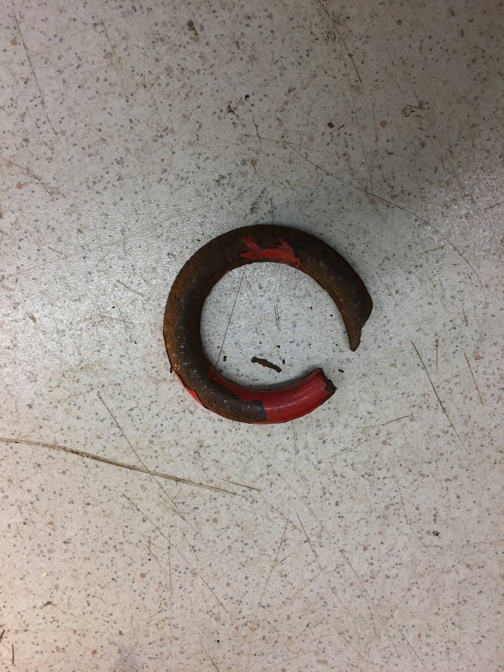

My circlips should've arrived today from RPD but ukmail are f**king me about so nothing doing until Monday now ?
