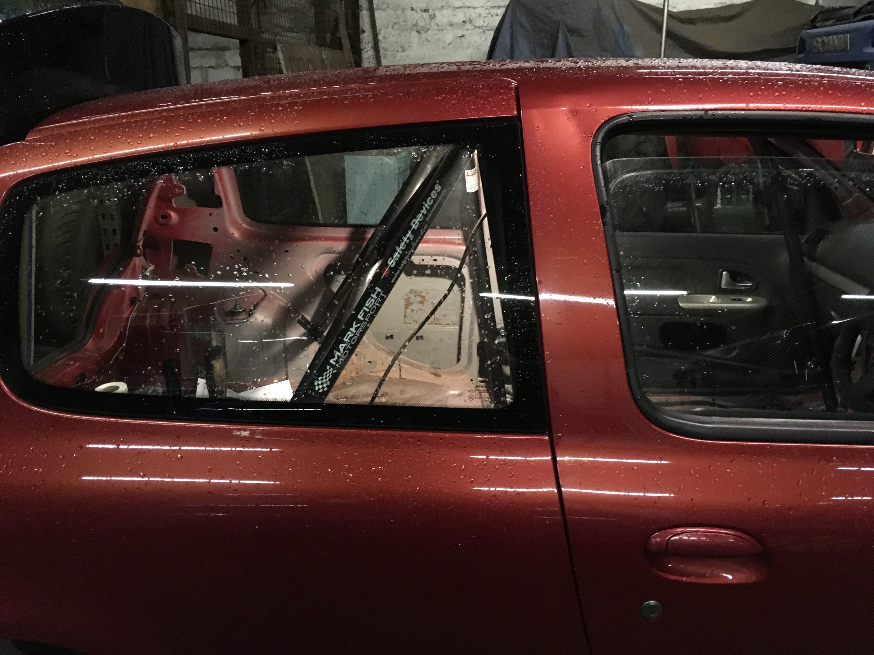

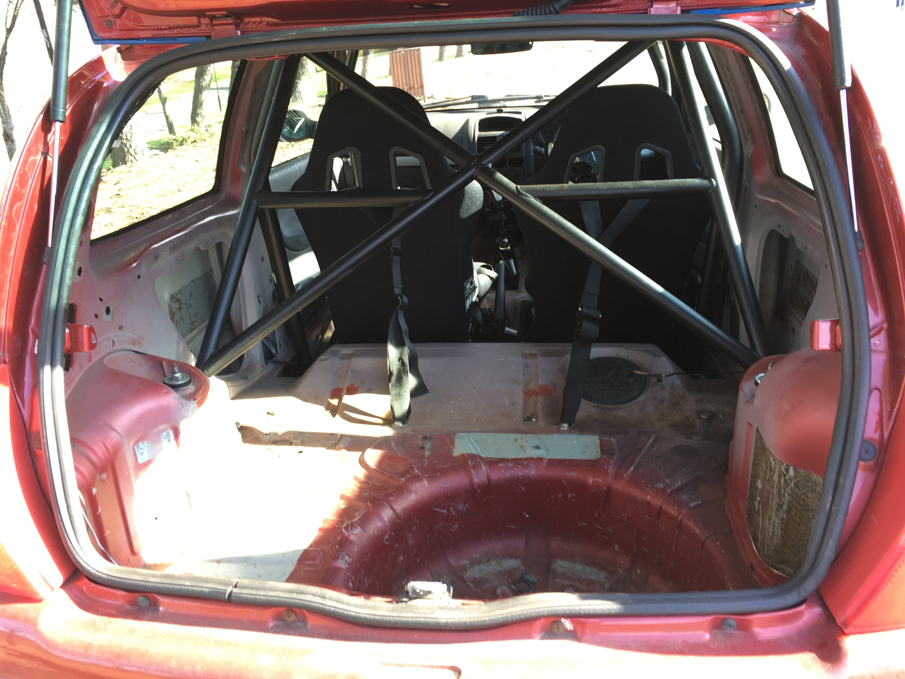

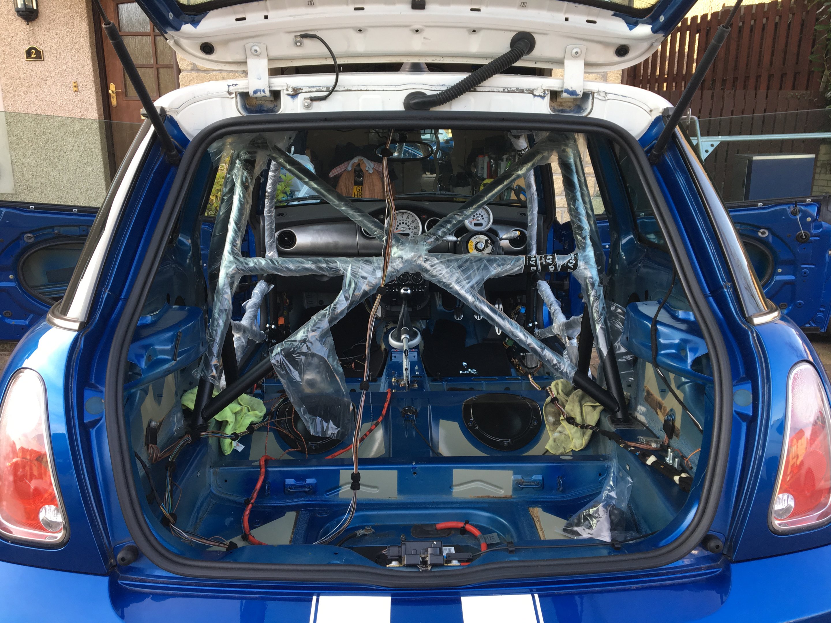

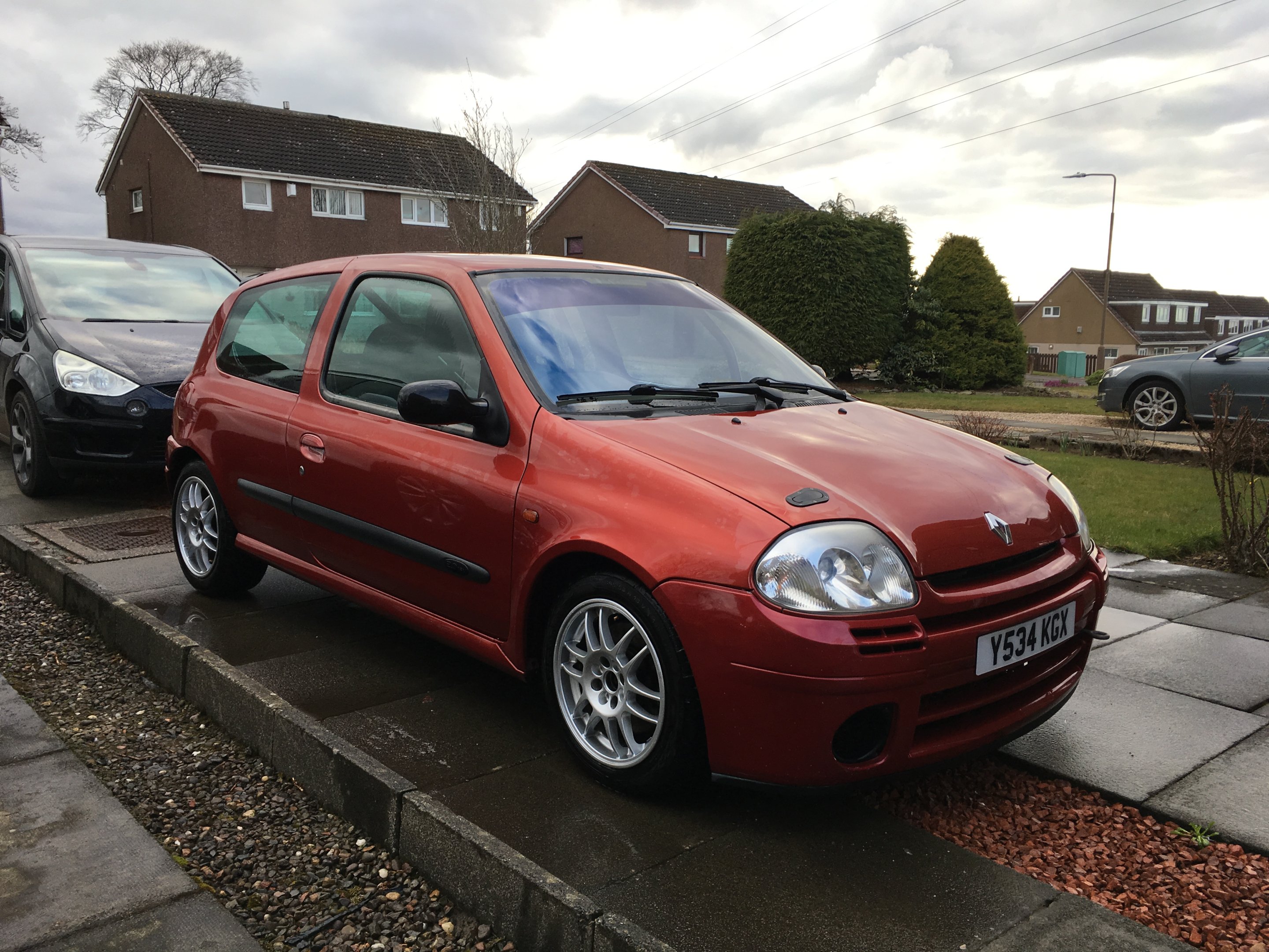

Figured I really should take at least 1 pic showing the roll cage, so here's 2 crap ones instead
Recently I've been using it for commuting more than any other car due to some family car issues so its a bit filthy at the moment. Bar a charging issue its done it well. Need to get a new alternator on ASAP actually.
It's pretty dirty on the outside but it's not a show car and without putting about £100k into it I doubt it ever will be!

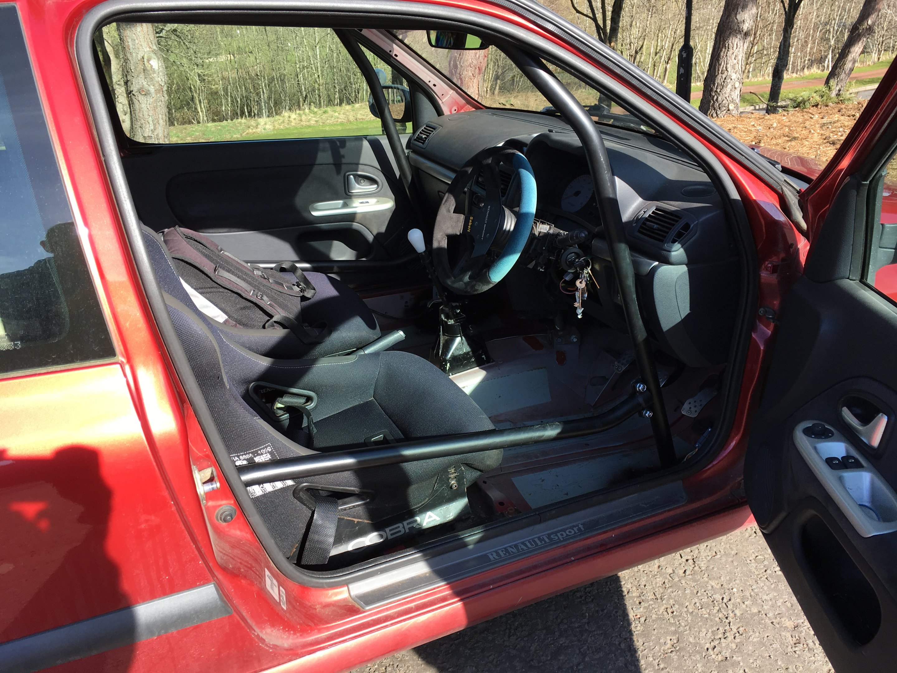

Don't think I've ever done a spec list for it so here goes
Mechanical
Ported and polished cylinder head
182 manifold
Yozza decat
K-tec mk1 stealth exhaust
ITG panel filter in ph1 box with duct removed
Stainless brake lines
DS1.11 pads (track only)
Koni dampers
Eibach Sportlines
Whiteline ARB
Eibach Camber bolts
Cup wishbones
Cup alternator setup
Interior
Safety Device R017 6 point cage, double cross with single door bars
Monaco Pro seats
Cobra 3 point harnesses
Renaultsport Sabelt wheel
Ph2 dash conversion
All bracktery removed
Exterior
Aerocatches
Brake ducts
Ph1.5 rear lights
5000k HIDs
PB Mirrors
I think that's about it but I've probably forgotten something. Interesting writing it all down, I don't ever think its all that well specced but its not bad at all. Few things I want to change on top of regular maintenance, would love a PMS exhaust and some new seats and harnesses. Won't happen soon but hopefully it'll get there 1 day.

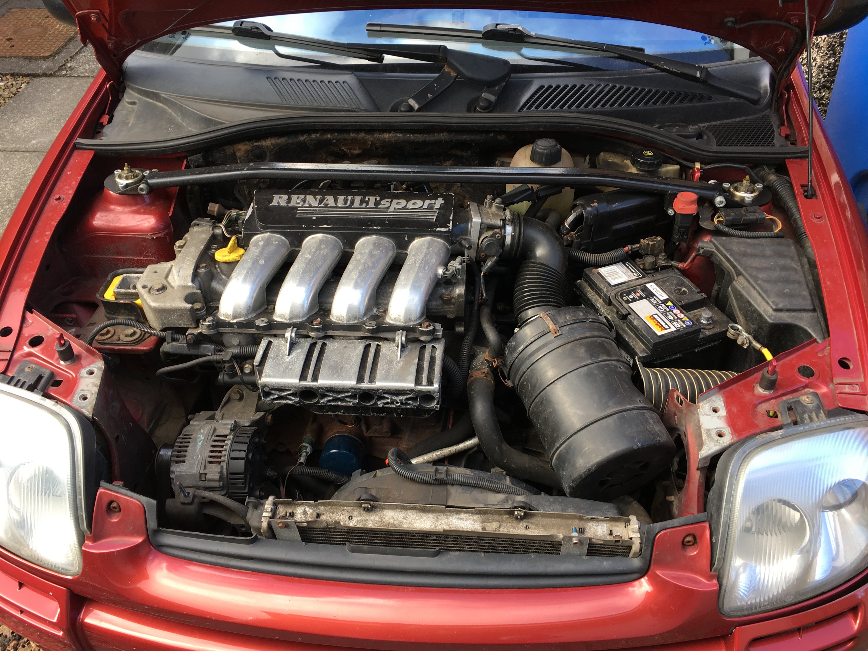

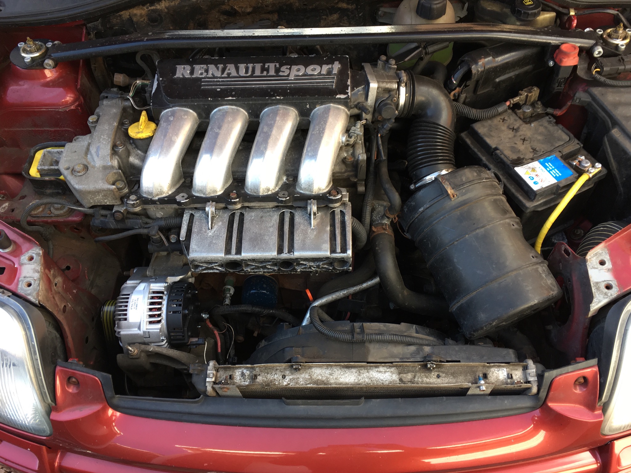

Not the most exciting update in the world but had to do the alternator in the end. Swapped the battery for the one from the BG as well. And changed the negative lead since that had been upside down for over a year and had eaten into the terminal.

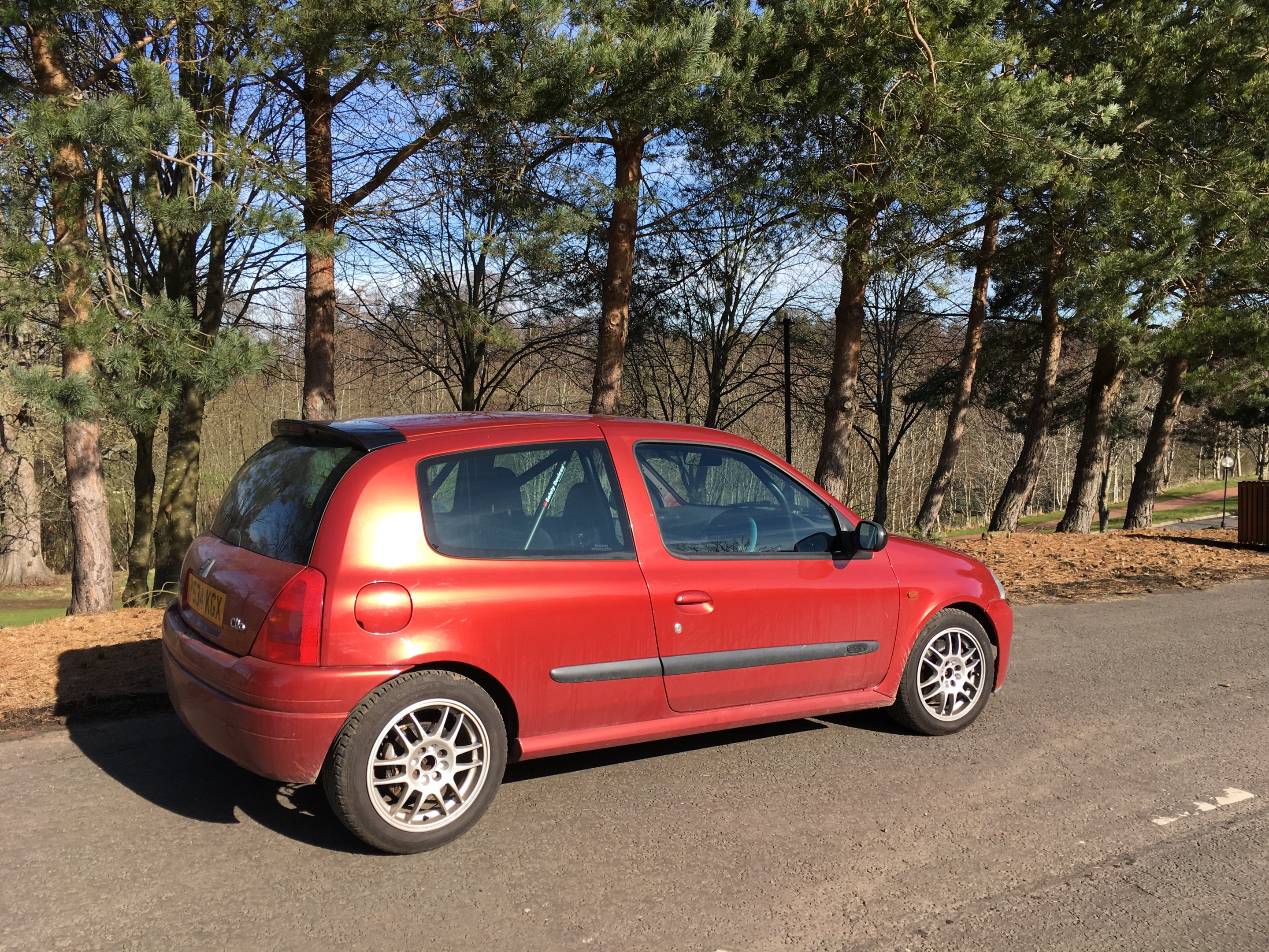

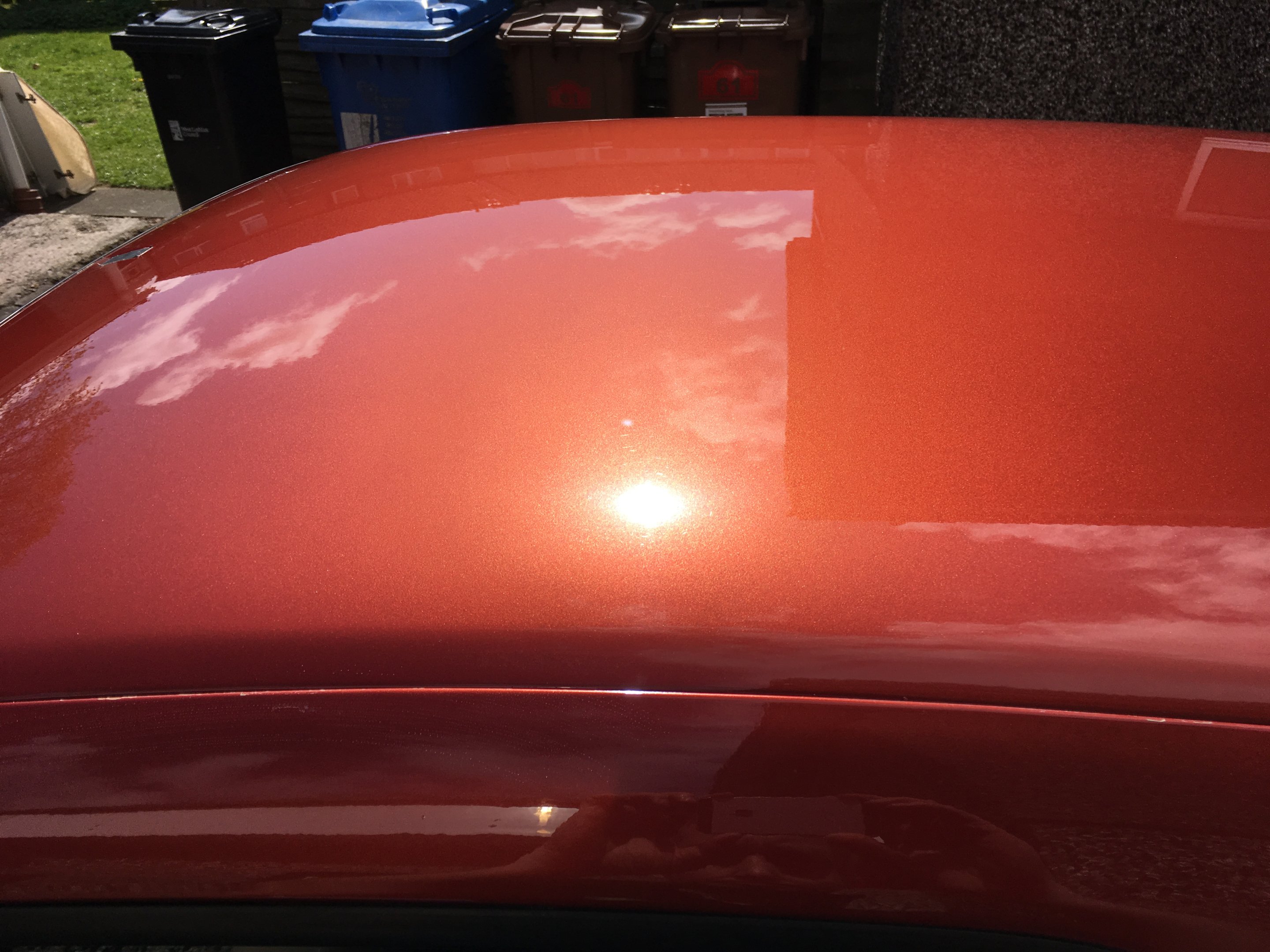

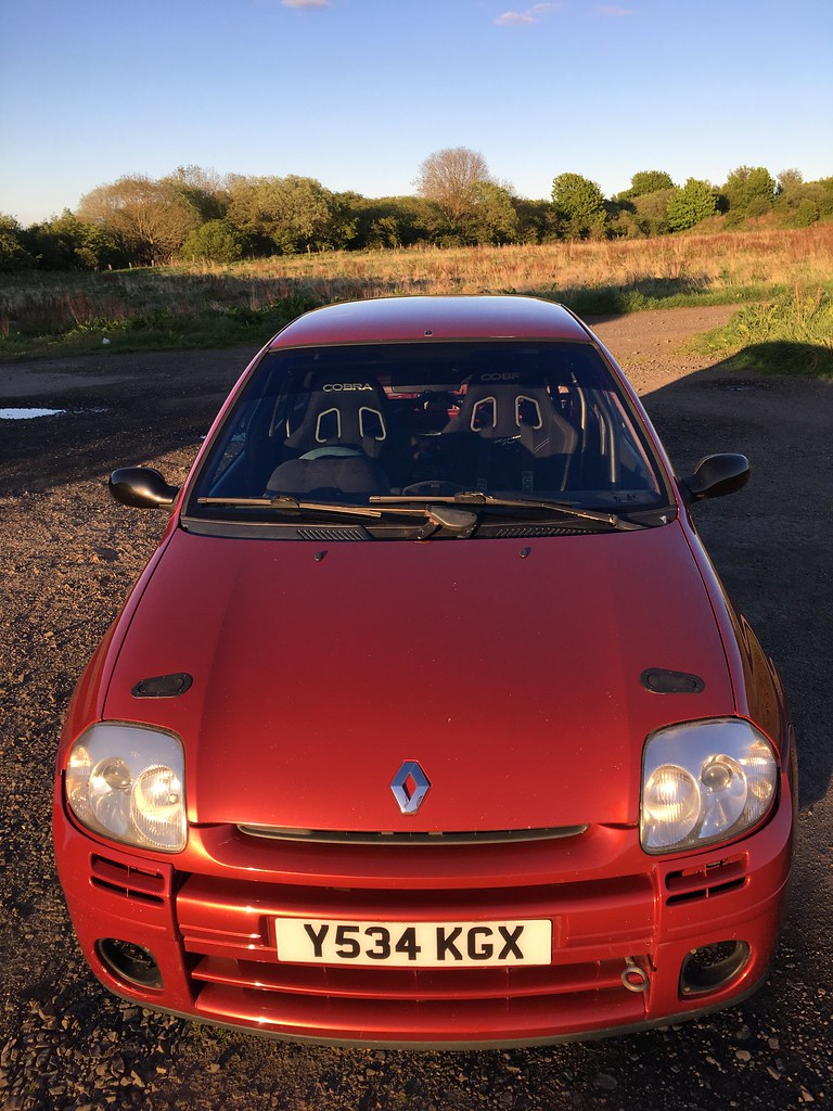

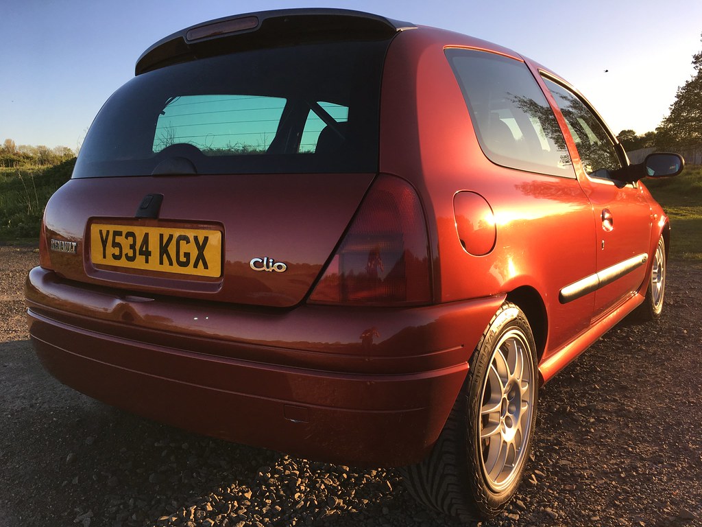

Time for another wee update after a busy time with the flamer recently. You may have seen these pics in another thread but I like to keep them together here too.

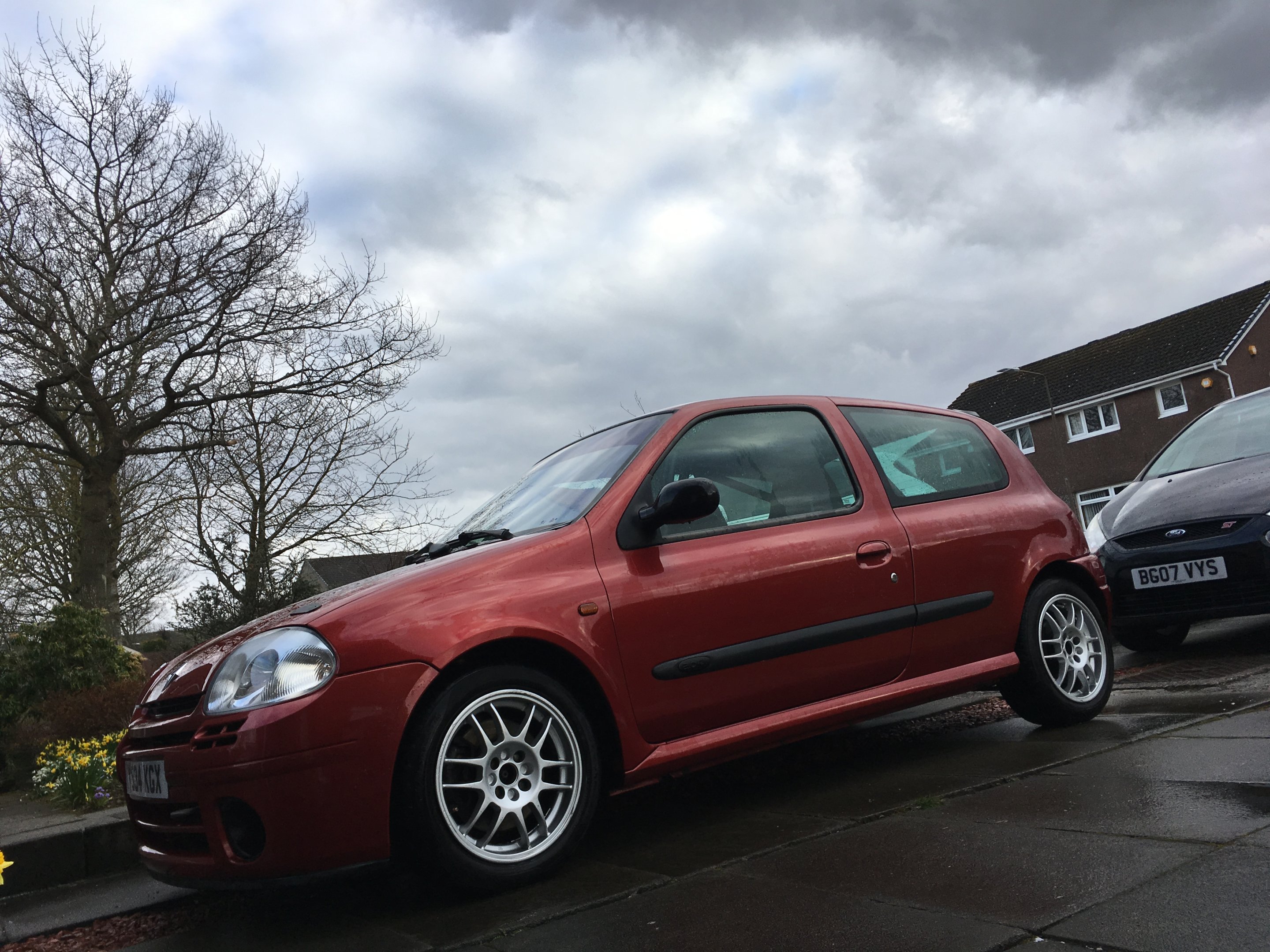

Recently I used tar and then iron remover, clay and the Auto Finesse rejuvenate kit on the paintwork and its come up lovely, all things considered

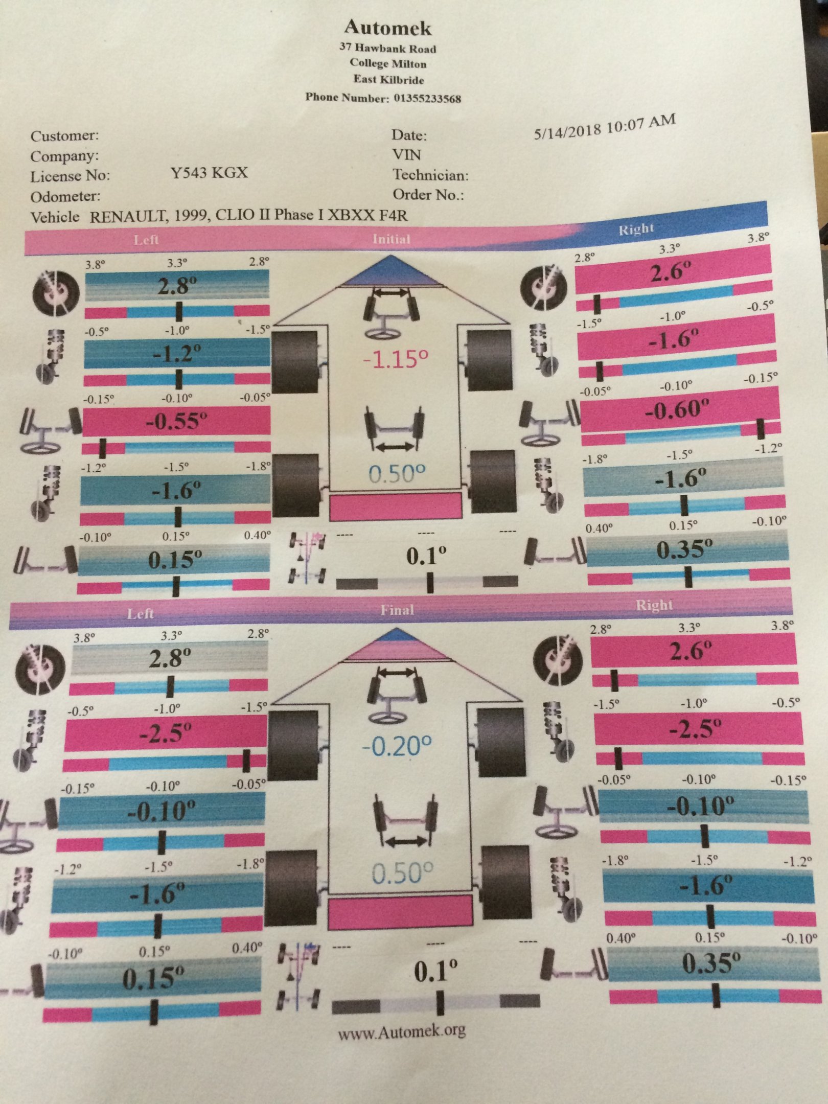

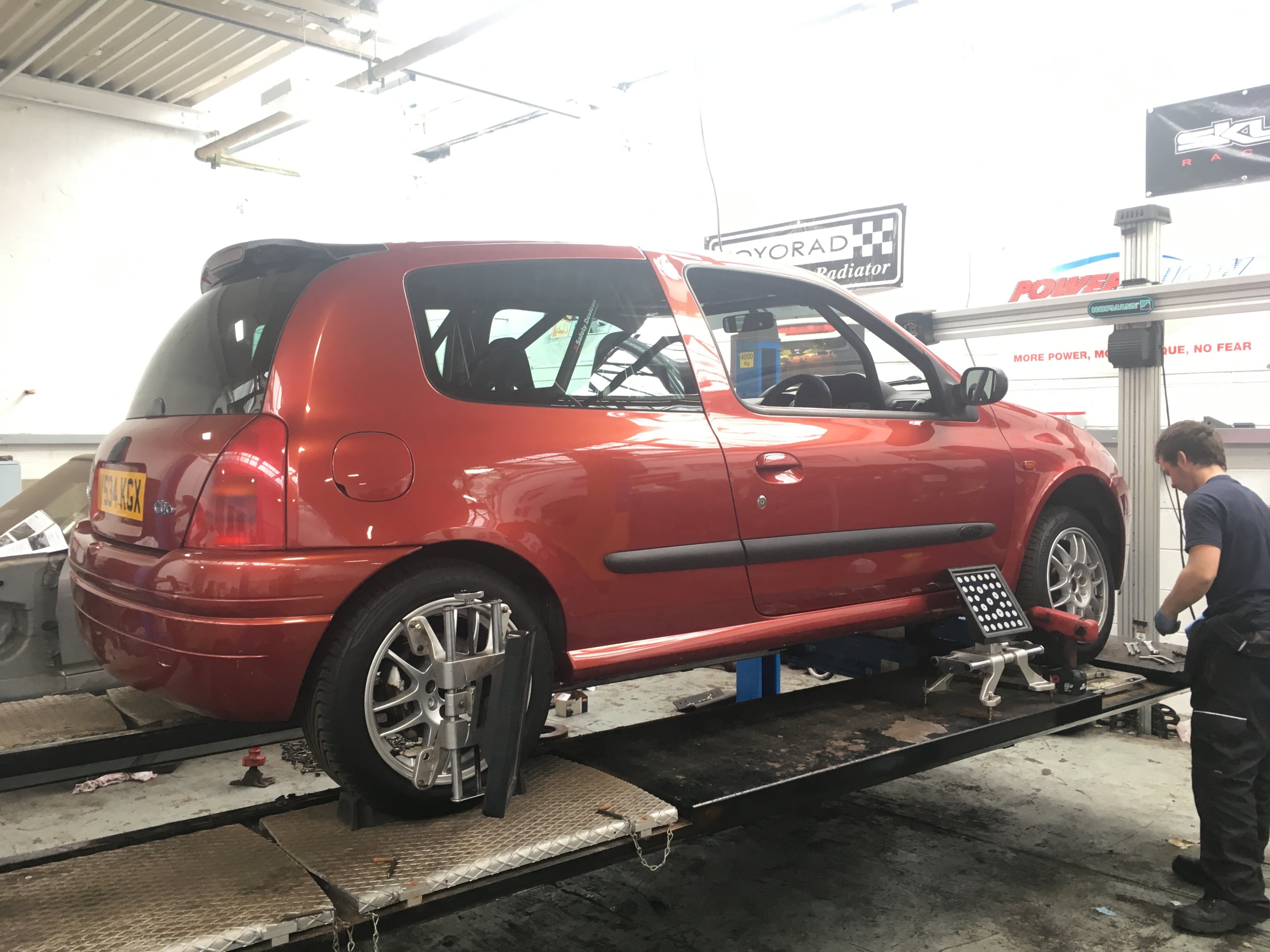

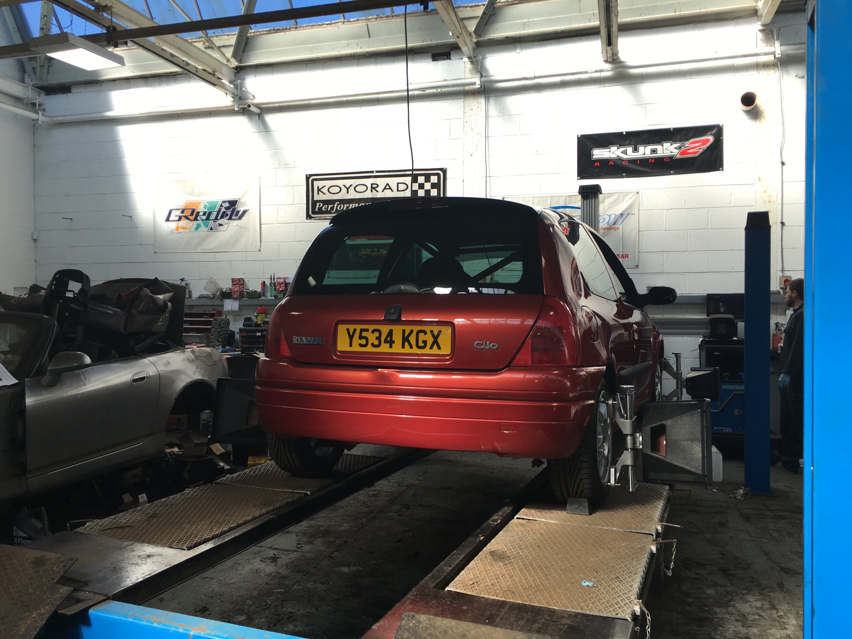

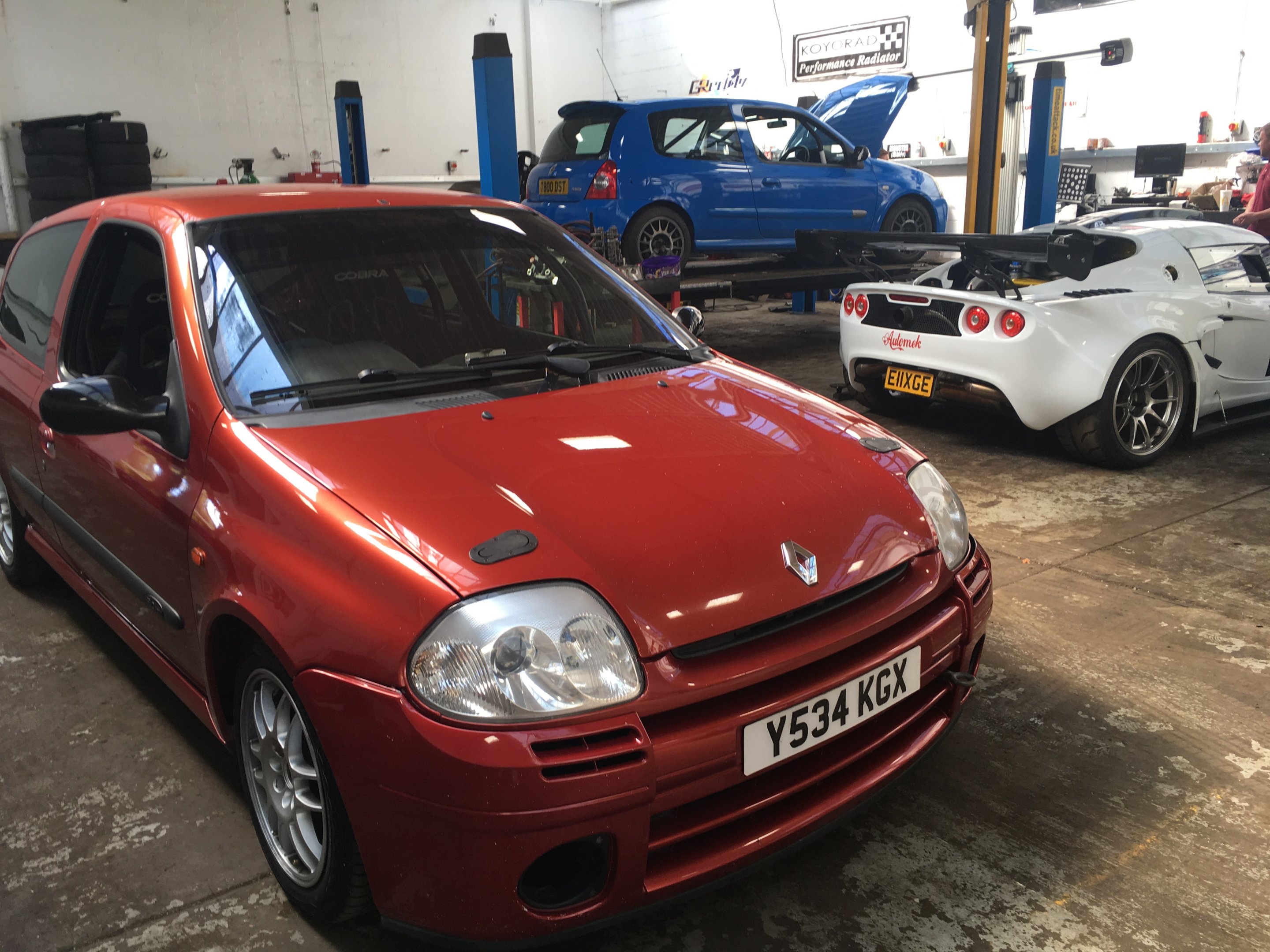

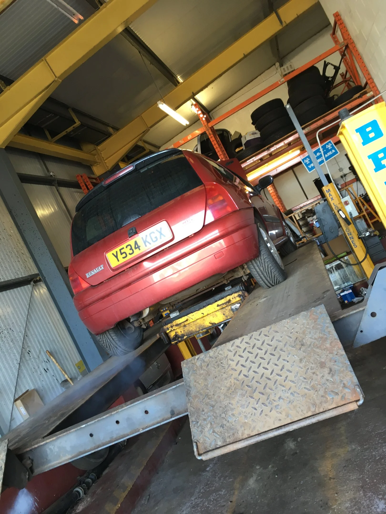

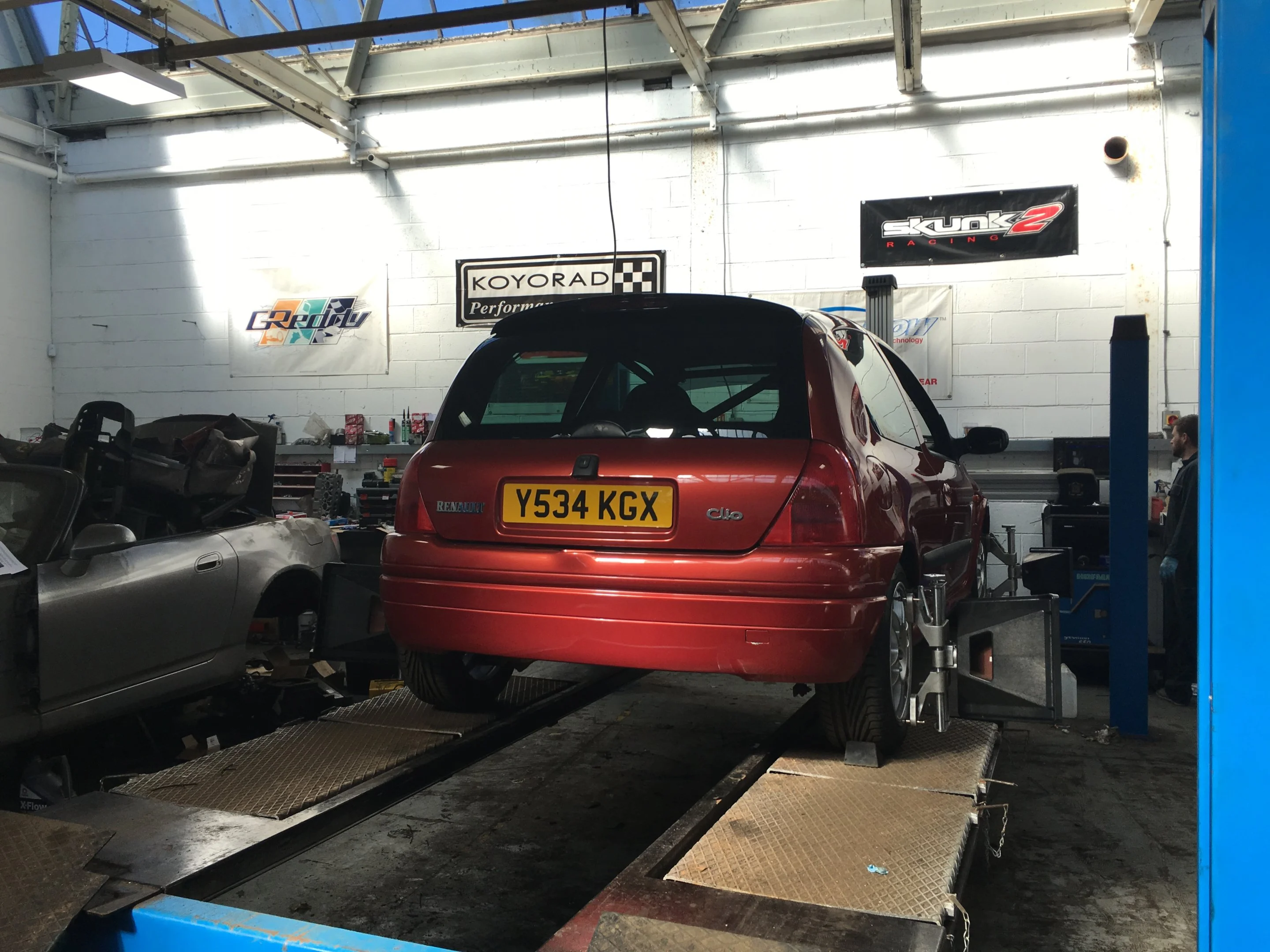

The day after these pics @Djw Dave and myself headed off to Automek in East Kilbride to get the alignment sorted
Thats about as good a rear axle as you'll get on a clio! No shims or anything like that.

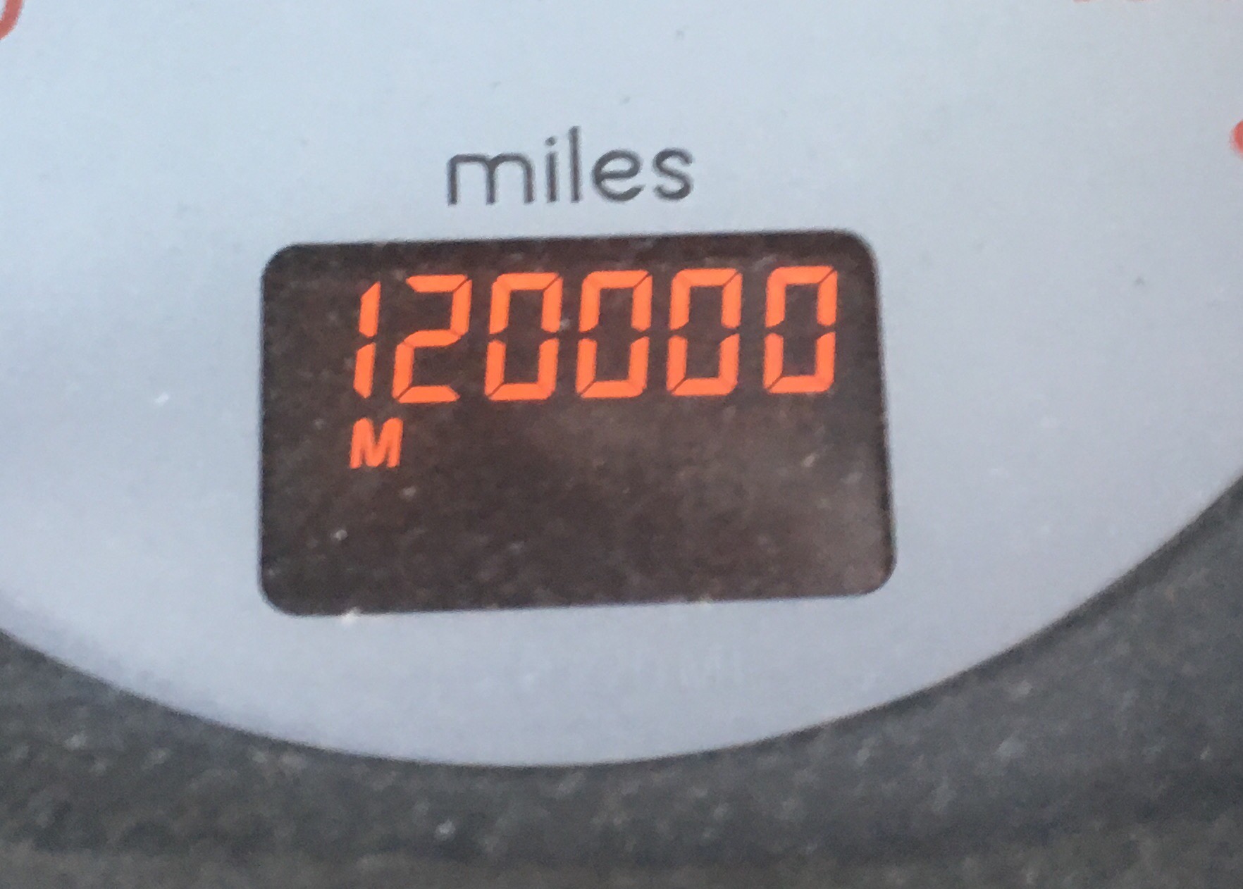

Rather annoyingly the very small box oil drip I had became quicker, then it became pouring and it lost about half a litre of oil overnight thanks to a tear in the inner CV joint which meant a change had to happen. Since the camber had been set I didn't want to be touching the strut bolts at all but after 120,000 miles, 17 years and many track days the driveshaft is basically welded to the hub and no matter how hard I hit it I couldn't loosen it. So had to strip it all down and put a spare hub on. Dave kindly gave me a driveshaft and out the 2 of them I made 1 acceptable one but it has some small tears in the outer boot. So I've bought one from @Fraser.J. and will redo it all again and get the alignment checked, I think I've added just a smidge too much camber when rebuilding it.

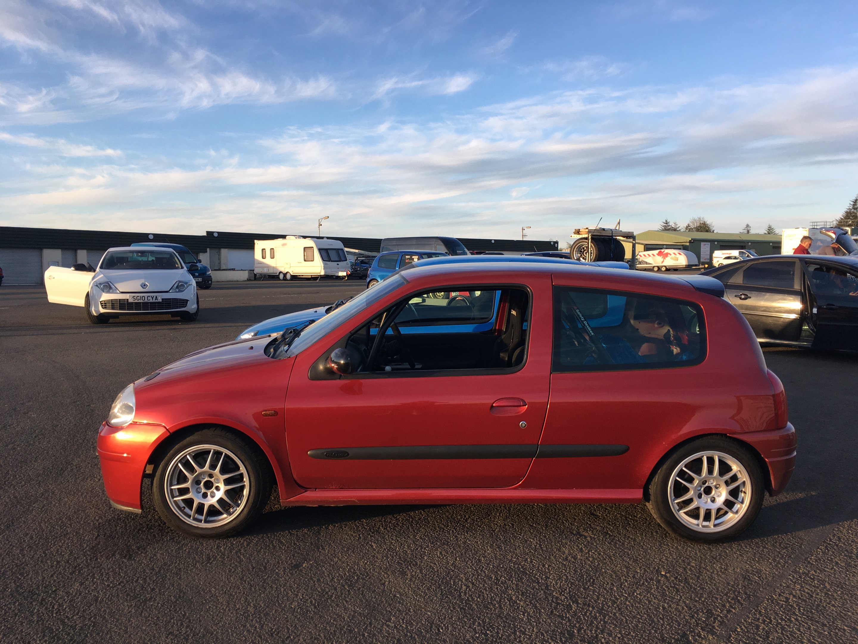

The important thing is it held for lasts trackday. Great to get out again after about 7 months, nerves were raised though! Car went really well and I'm down to failry consistent 62 second laps with the best being 62.2. The new track defo helped but I'd like to think I've improved myself and the car too! Did have the biggest moment of my life but didn't hit anything or roll so that was good, shame I don't video my laps anymore!

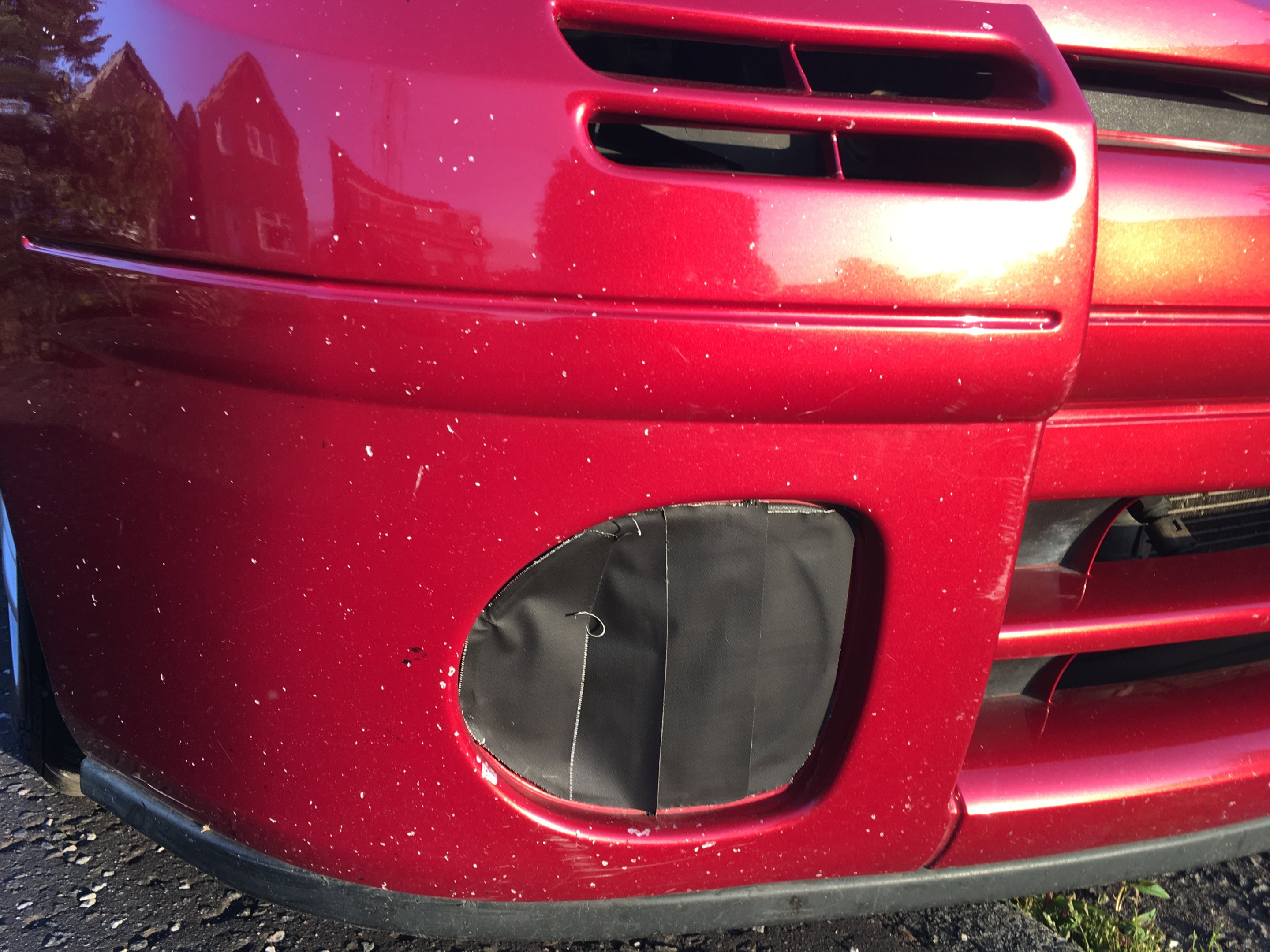

After the brake bleeding and swapping and clean on Sunday I remembered that DS1.11 squeal like f**k, especially when cold. So, every little bit of heat helps...
Professional to a fault I tell you. Then back to automek for an alignment check as I was sure something had moved during my high speed off roading session.
I was right! So with that sorted there was nothing left to do but track it! It was touch and go if it was going ahead with the amount of wind we had yesterday.

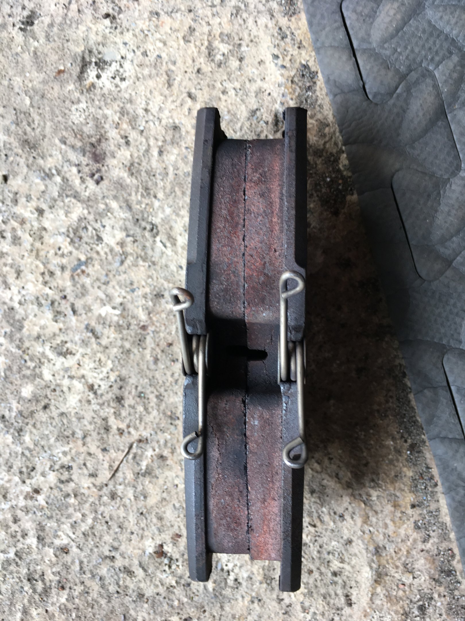

I've done 3 days on the DS1.11 now and I'm really happy with how little they wear and how well they hold up. But, they're wearing a bit funny. I've been religious about making sure they're always used in the same position. Anyone any ideas? @George@RTR_Parts ?
I think I'll swap inner and outer for the next one and accept they'll feel a bit crap until they're level again.
